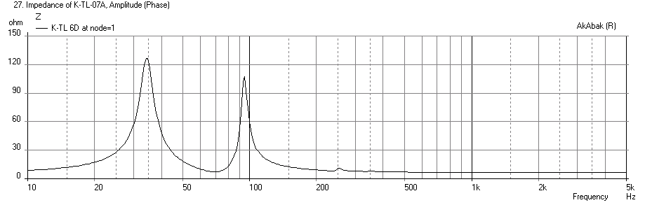

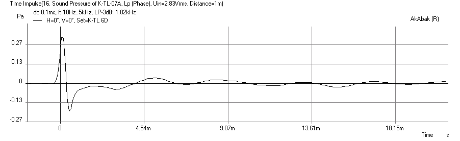

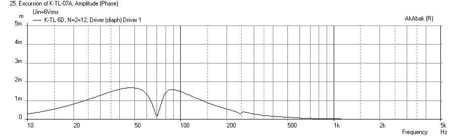

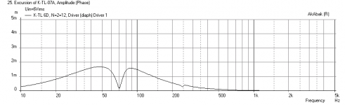

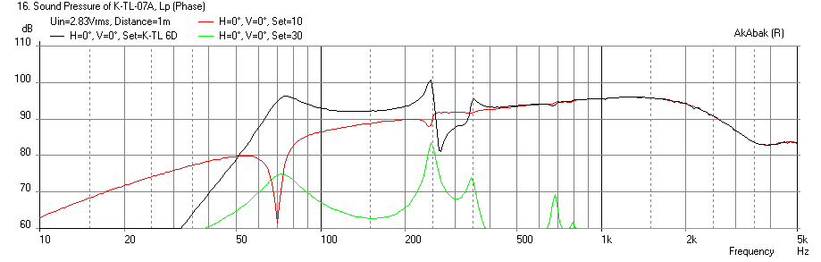

FE168ESigma in 0.6x scale Karlsonator
Here is the sim of the FE168ESigma in a 0.6x scale Karlsonator. It seems like it can work - very sensitive driver. You have to be careful with max cone excursion though - I would recommend a 65Hz 2nd order high pass filter to control cone excursion - you put 6 volts rms max and this is circa 100dB. This might indicate that the motor for this driver is too strong for this particular cabinet with just simple scaling. The dynamics should be very clean as the impulse response looks quite good.
Freq Response, Impedance, Cone Displacement w 65Hz HPFat 6vrms, Impulse Response

Just for disclosure - the 'Karlsonator 6' plans I linked to are essentially a .67x scale Karlsonator, though it's fudged very slightly wider for slightly more volume. I forget why, probably because it looked nicer with the FE166.
RE excursion - it's an issue but probably fine for most home users. They could always be highpassed to a TH sub built under the couch.
