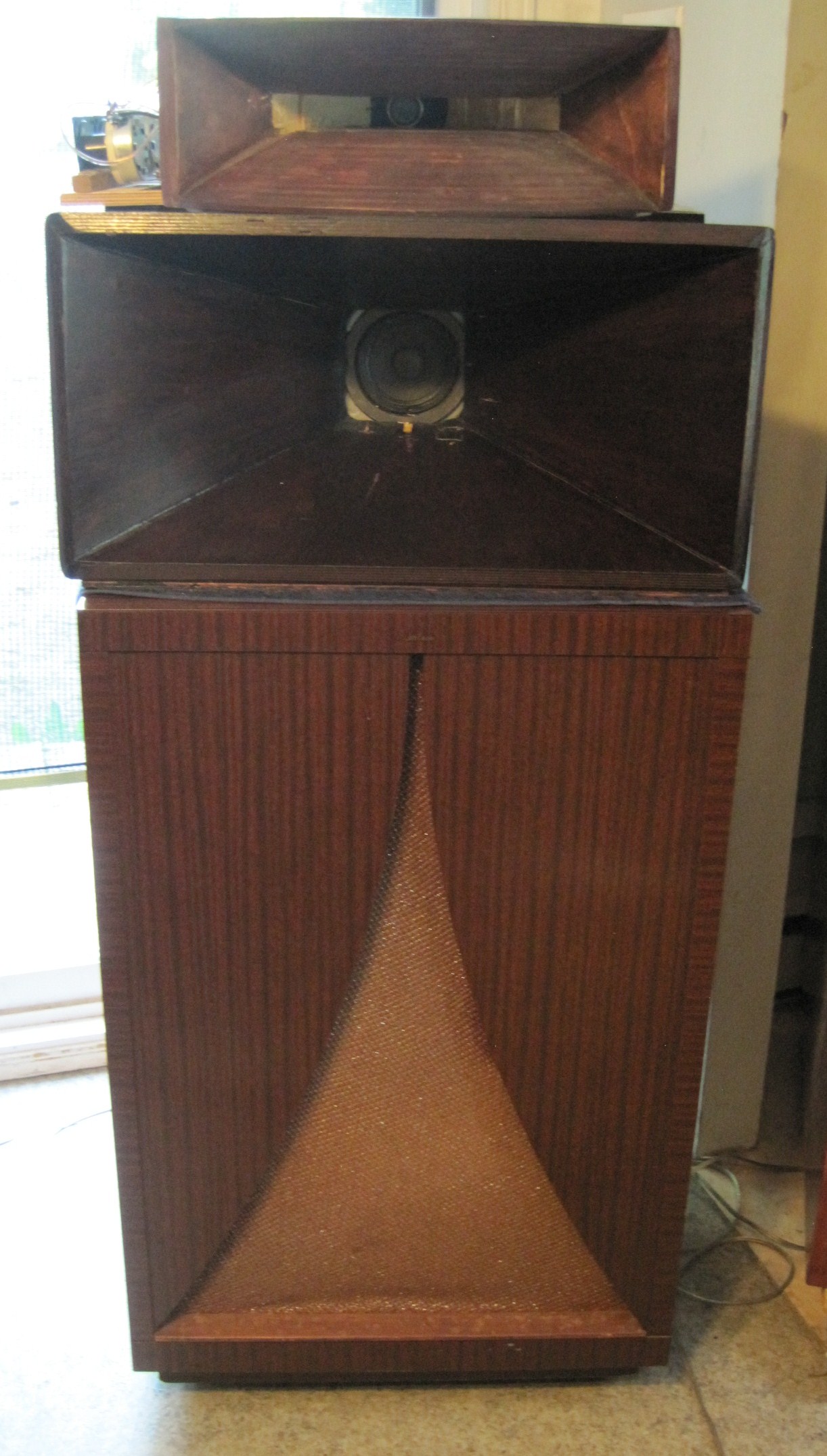

Trio T15 in Karlson
I try many speaker on the Karlson K15, recently I put inside a 10 inch Trio T15 I'm very surprise that his sound very good I have nice bass, beter that many 15 inch. I put a Phi Horn for mid with a 4 inch and a Iawata Horn with a 1 inch driver.
hi achille49 ,
that's a fine looking factory K15 and beautiful horns (especially Iwata) on top. horn
What 10" driver are you using? Does the Phi ("Pi"?) horn have a back chamber?
Where are the approximate crossover points?
fwiw I tried the late Bruce Edgar's LE5 tractrix horn on top of K15 but it didn't merge well. I did like a wide radial horn rolled in around 700Hz plus ring radiator treble.
I'm hoping for an alternative to horns - maybe for smaller rooms.
https://i.imgur.com/c5lTDQu.jpg
Hi Freddi
I put a Trio T15 it's a coaxial speaker it's was design for Trio/Kenwood LS 770 box, I don't use it in full range on the Karlson K15. I had no expextation about the T15 in the Carlson, I just try and it's the best sound I have in this box,
I built the Iawata and the PHI horn few years ago, the Phi horn have a back chamber 7X12X22, it's was dessign for a Eminence Delta 10, for a 500 Hz crosspoint a smaller back chamber was OK.
the crossover point are 500Hz and 5000Hz
For the top I try a Tang Bang W5-2143 it's just a 90 db sensitivity the trio T15 it's more sensitivity around 98 db on the Carlson, after I try a old 8 inch Tesla ARO666 with Fountek Neo CD2, not bad, the Tesla his rating at 5 watts it's a litle bit fragile. The wood horn give a real presence at the sound I prefer wood (birch plywood) horn than metal or plastic horn
