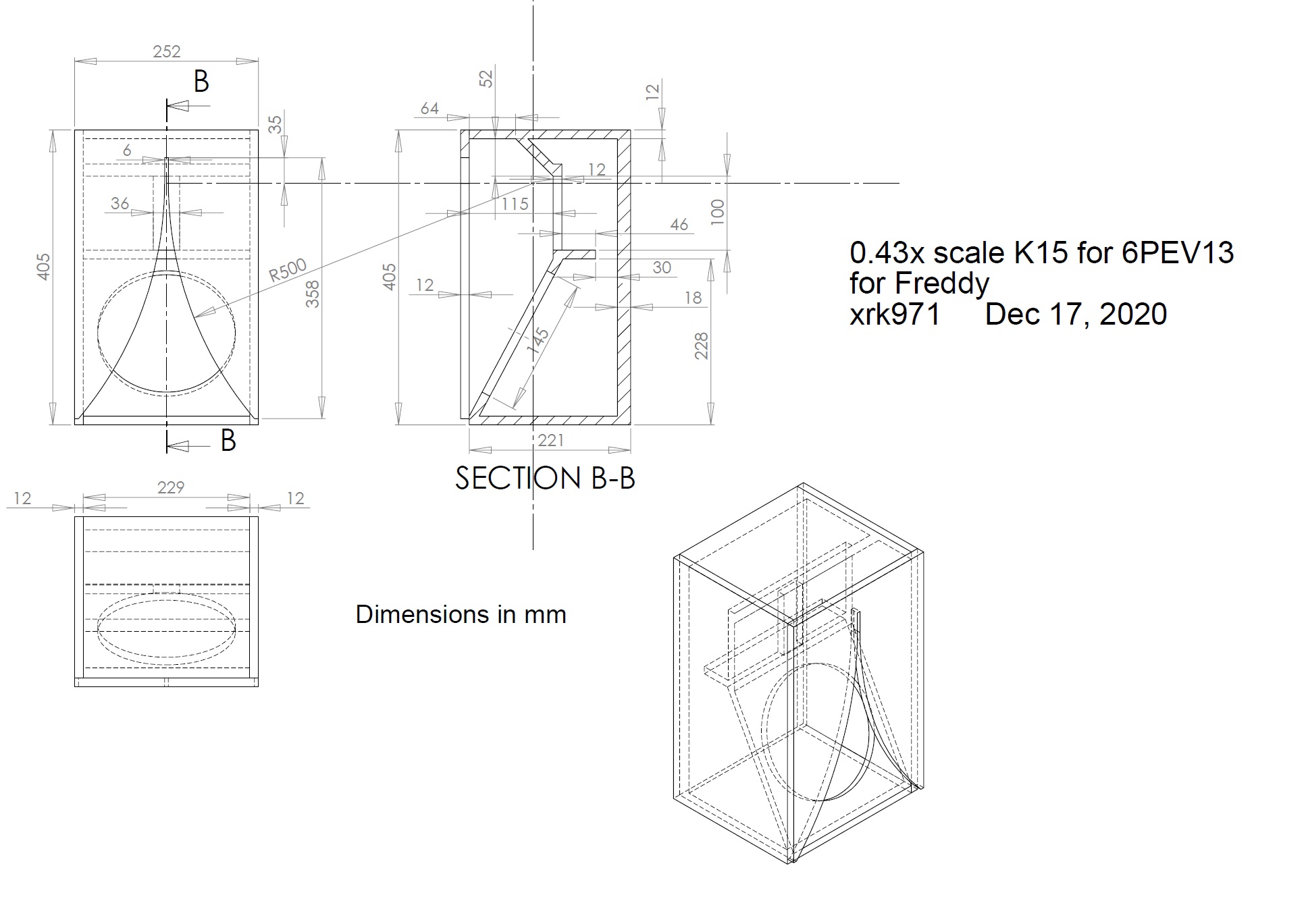

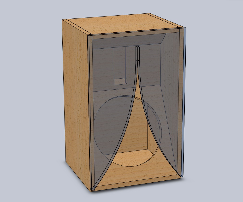

I had a request from Freddy for plans for a 0.43x scaled K15 to use with 6.5in drivers. In particular, an EV 6PEV13. So here is a PDF plan in case anyone else is interested.
