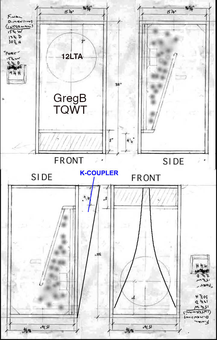

Basic Karlsonator physics?
I ended up in this thread searching for an explanation of the Karlsonator design. Did I understand correct that at its basis, Karlsonator is a driver coupled with a quarter-wave tube. But the tube is special in that it's topology allows it to behave like a quarter-wave pipe over a range of frequencies rather than just one fundamental frequency?
GregB came up with the Karlsonator as hybrid of TQWT and K-coupler.
The wedge shaped front chamber is excited by the driver, which is at the "bottom" of the wedge where chamber volume is nil and aperture widest. The top of the chamber is driven by the TQWT vent.
The narrowing width of the aperture tends to spread horizontal dispersion.
If the front chamber is sizable enough to resonate at harmonics of typical musical bass instruments, then the front chamber can reinforce those frequencies while reducing cone excursion vs direct radiator.
XRK971 may elaborate.
The image below shows GregB's TWQT for Eminence's Beta12LTA. A simple K-coupler
is added to the front and voila - a "Karlsonator".

Thanks for the intro. K-coupler physics explained a lot.
