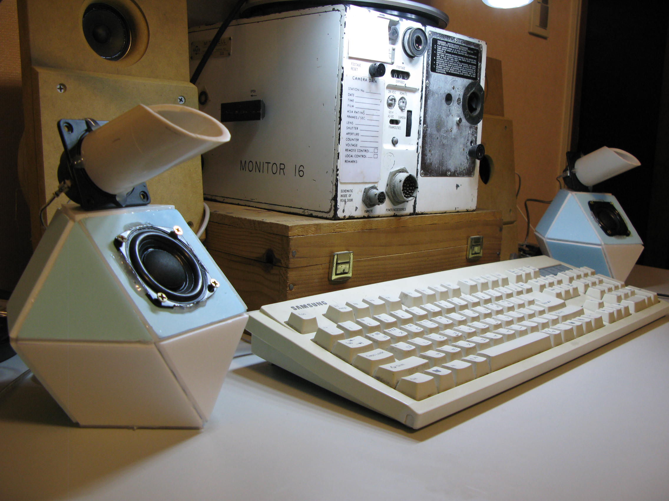

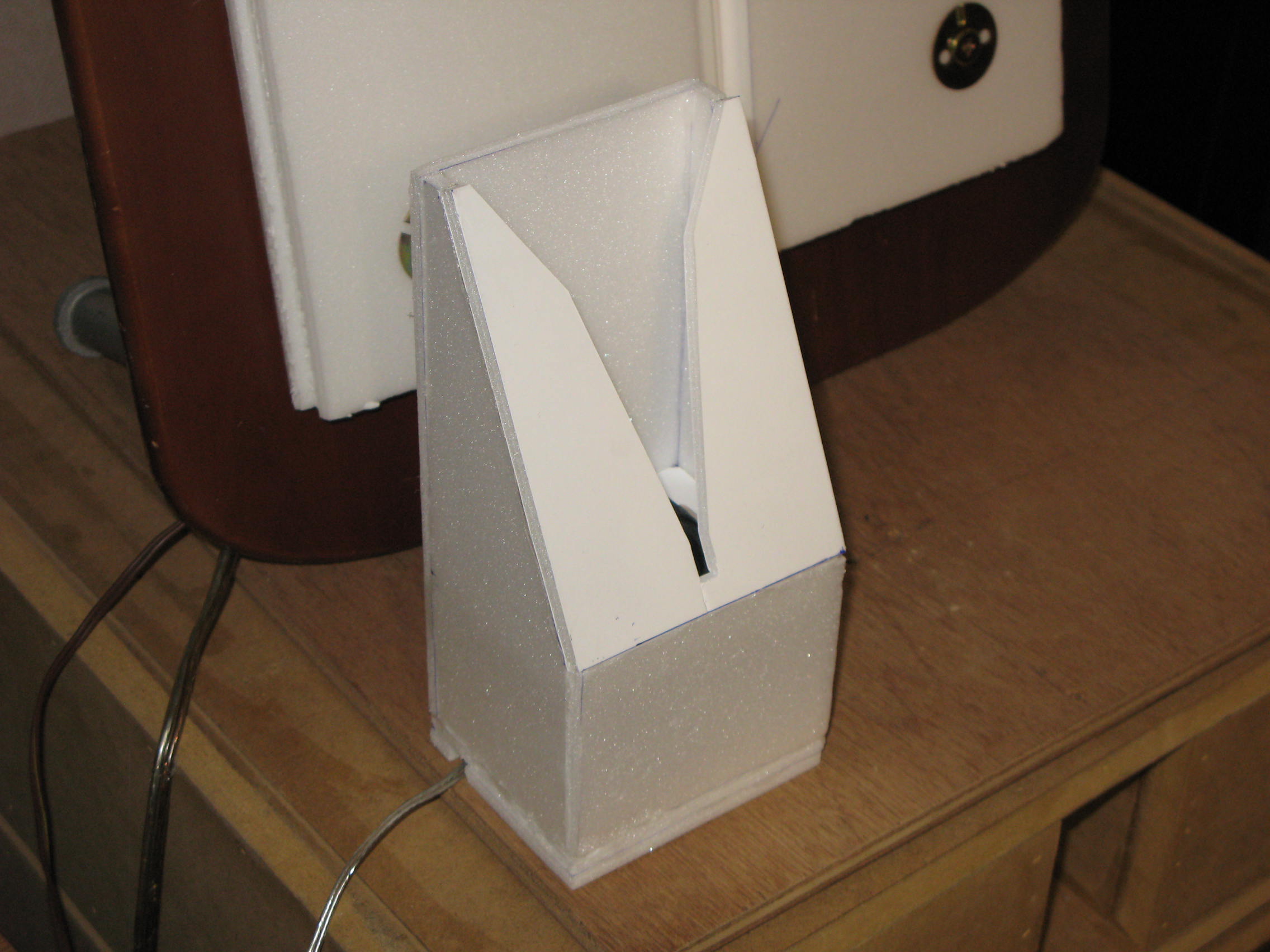

And also 2 inch ID tube with 3 inch fullrange for midrange, and the 2 inch foamcore mini Klam...
(as you can see, I find this K-technology fascinating... 😎 wonder why more people aren't using Karlsons?)
Ultra noob here, and I'm probably doing something wrong most of the time, :scratch1:
but this DIY thing is supposed to be fun... and I'm having a great time.
Thanks to you guys!

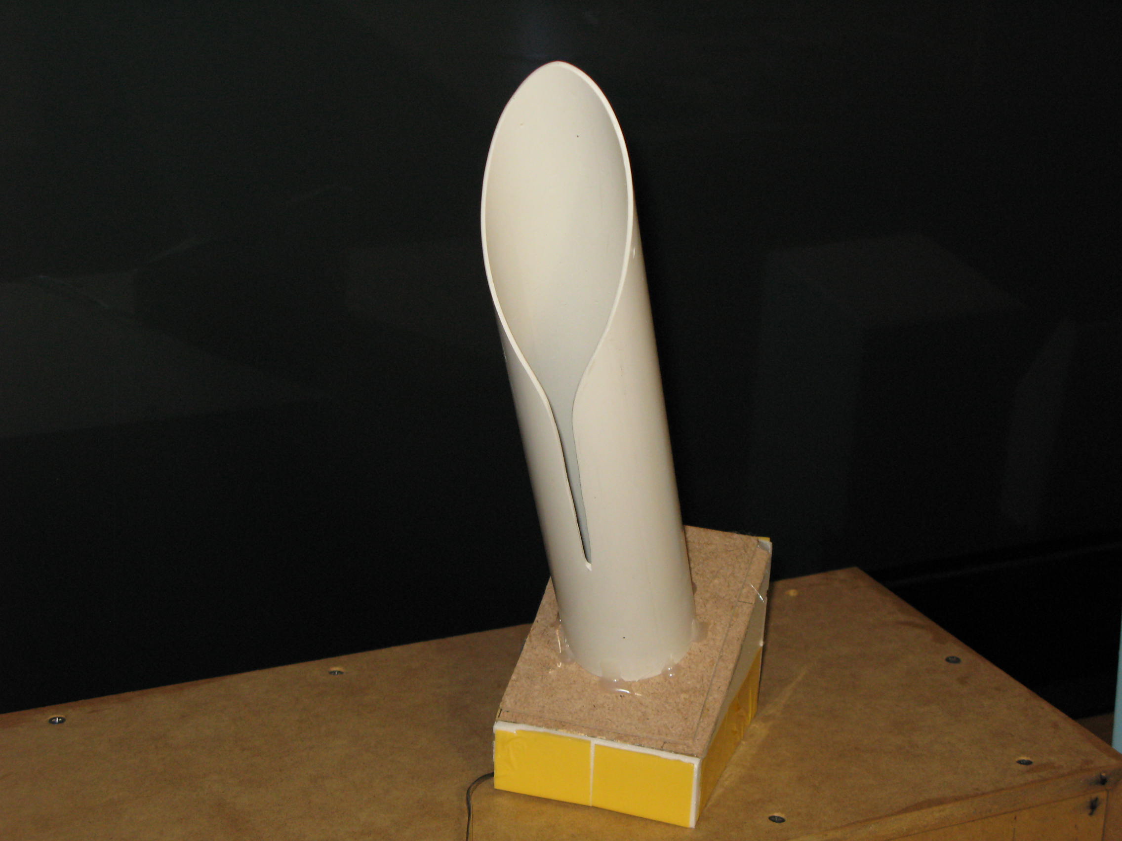

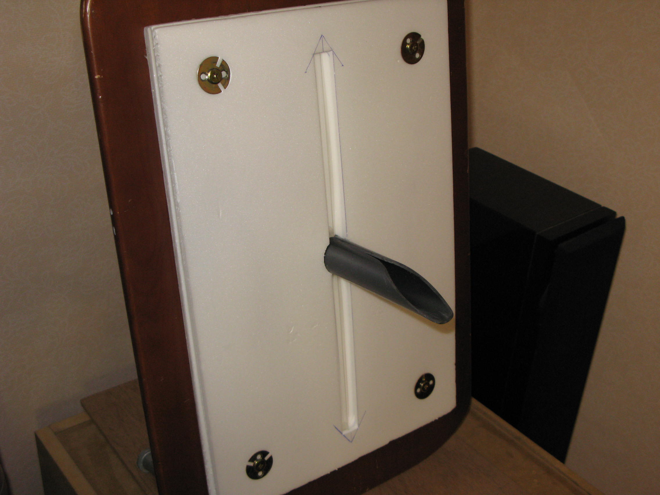

that is a fabulous K-tech exhibition ! - what are you using for drivers with the short/fat tube and the tube below? -- - also - what's happening with the relatively tiny tube in the middle of the rectangular Synergy horn? is there a dynamic compression driver or did you get a piezo driver to work well?

The drivers are just normal tweeters I had around the house.
I'm using all sorts of tweets I can get my hands on.😀
I'm just having fun before I get me some proper compression drivers.
(The ones in the synergy horn are tweets I got out of my Klipsch Promedia speakers)

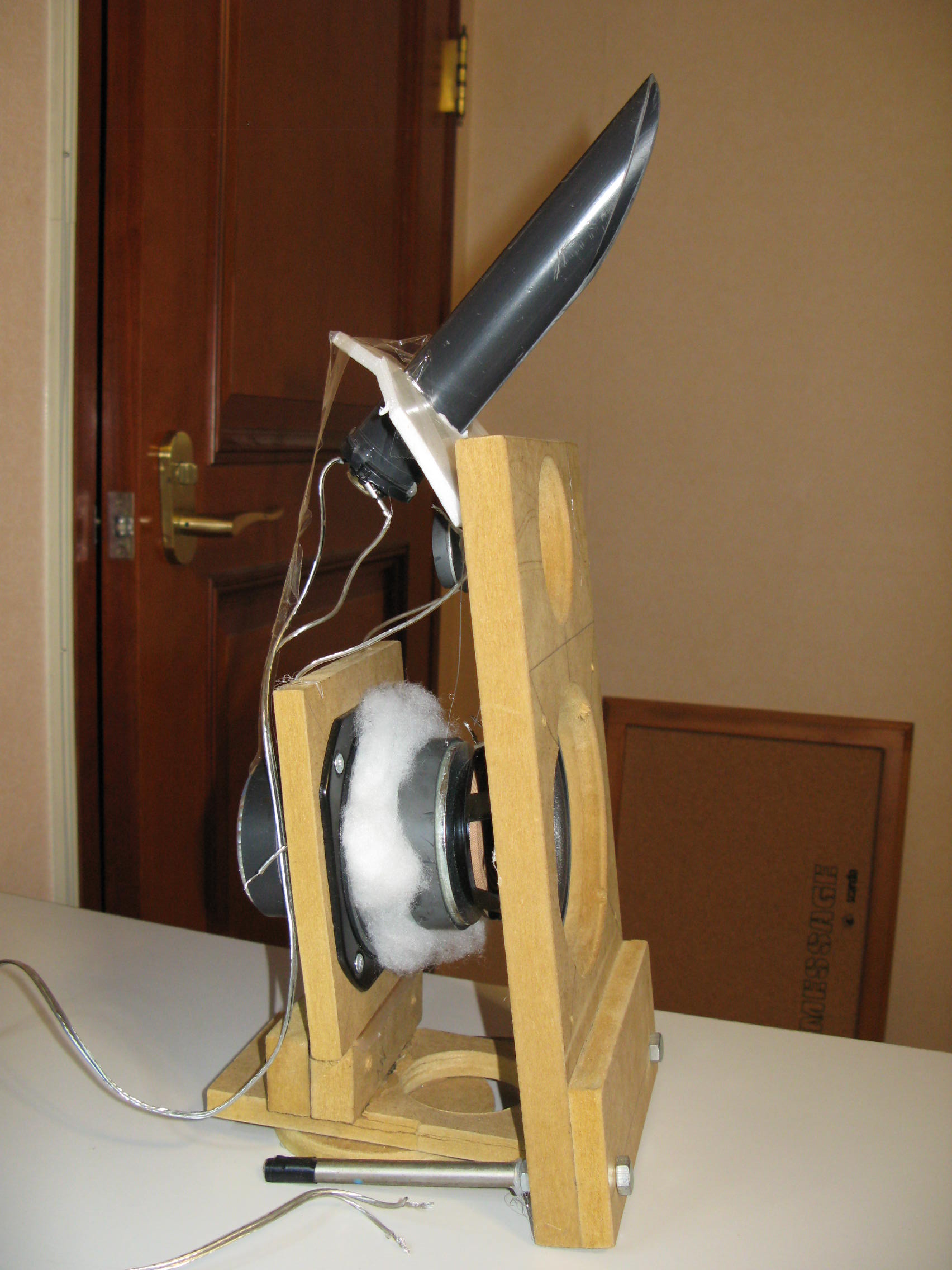

My first attempt at K-tube synergy horn... 😎

you could make some foam core mini - Karlson - play with the upper reflector and compare to the klam type.

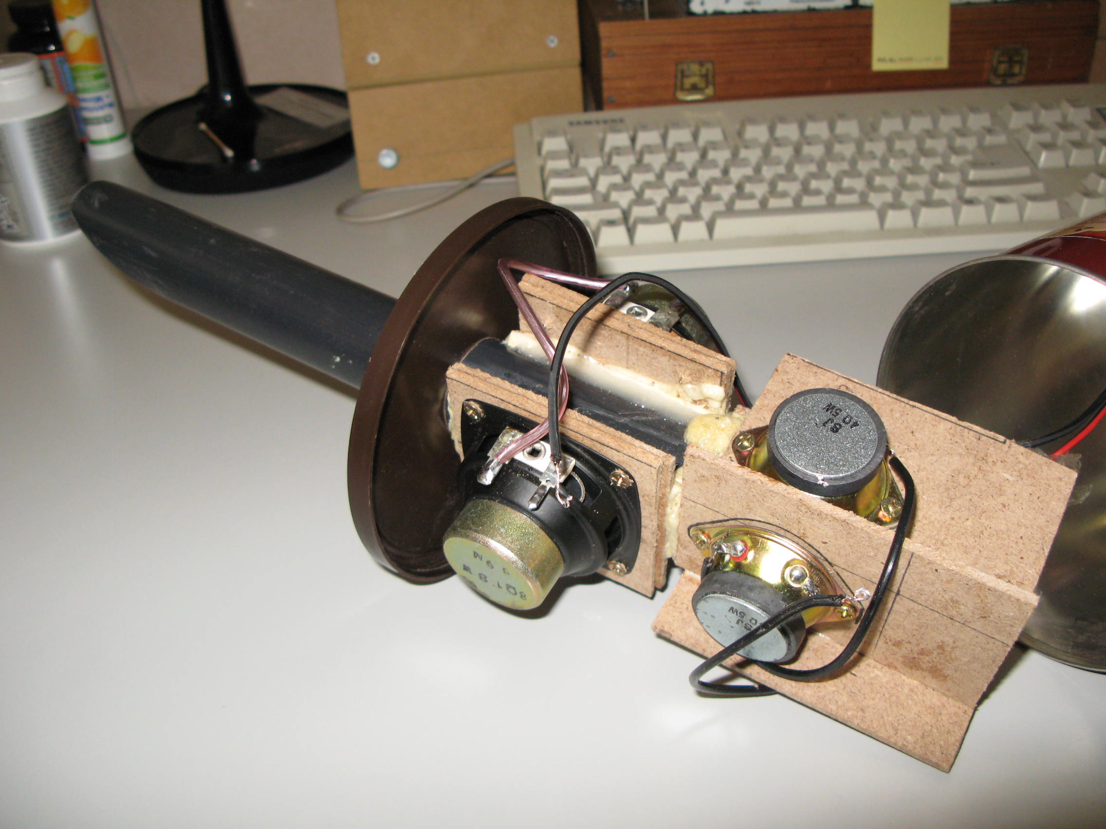

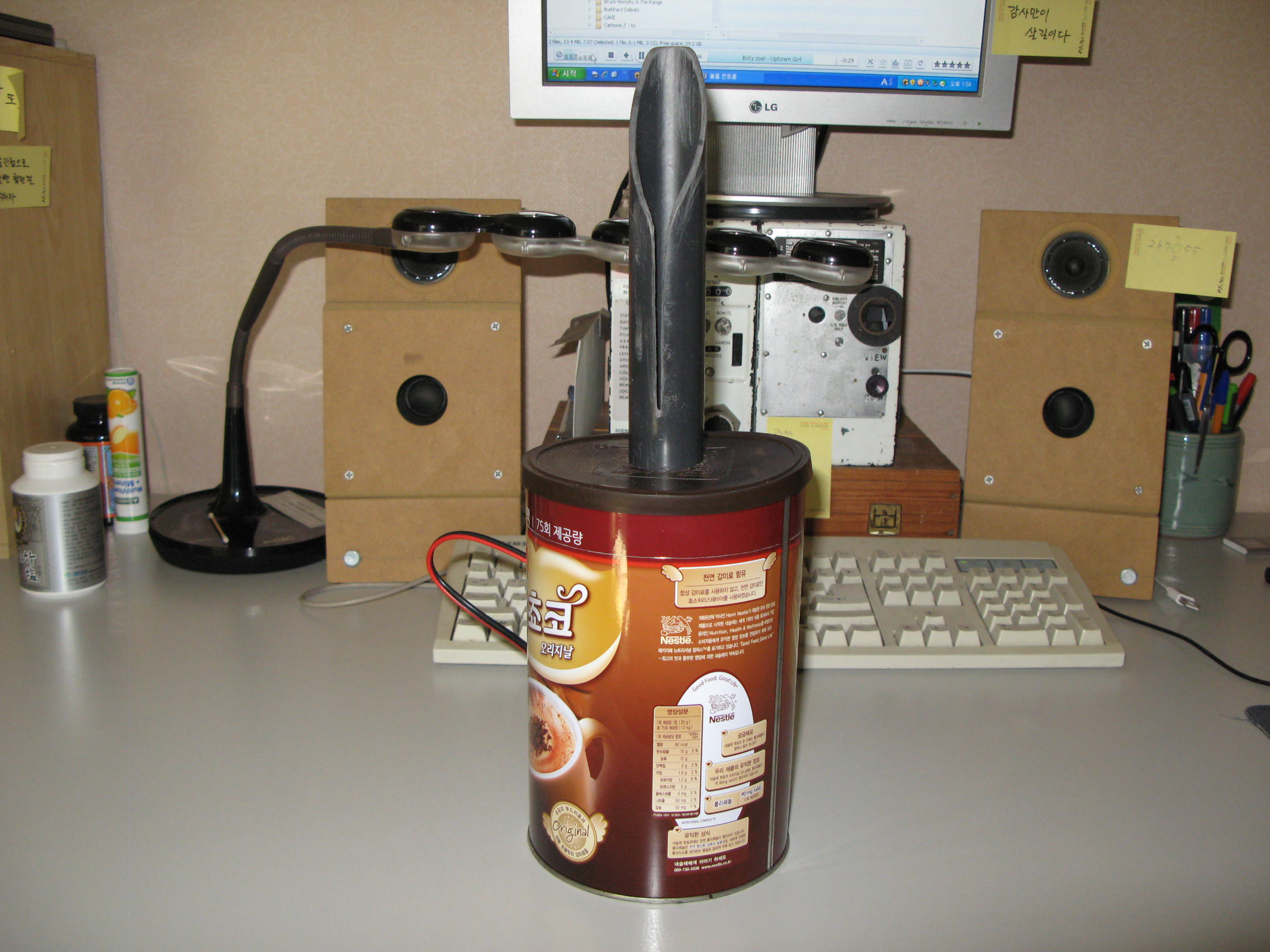

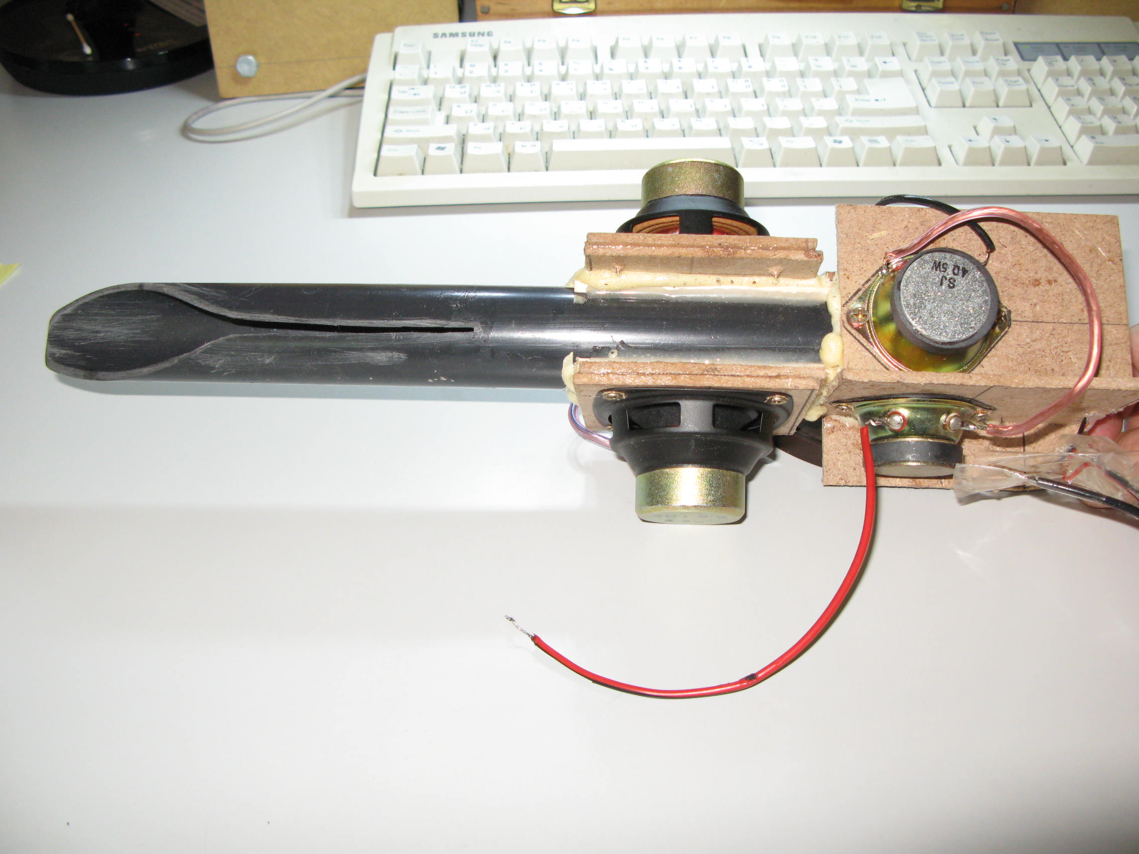

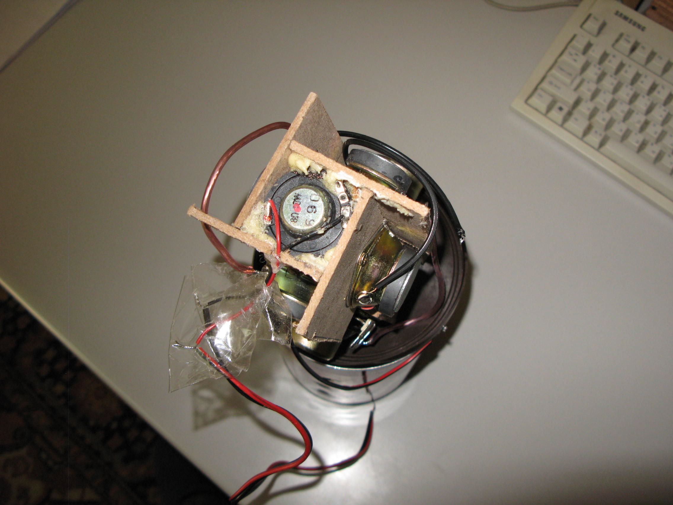

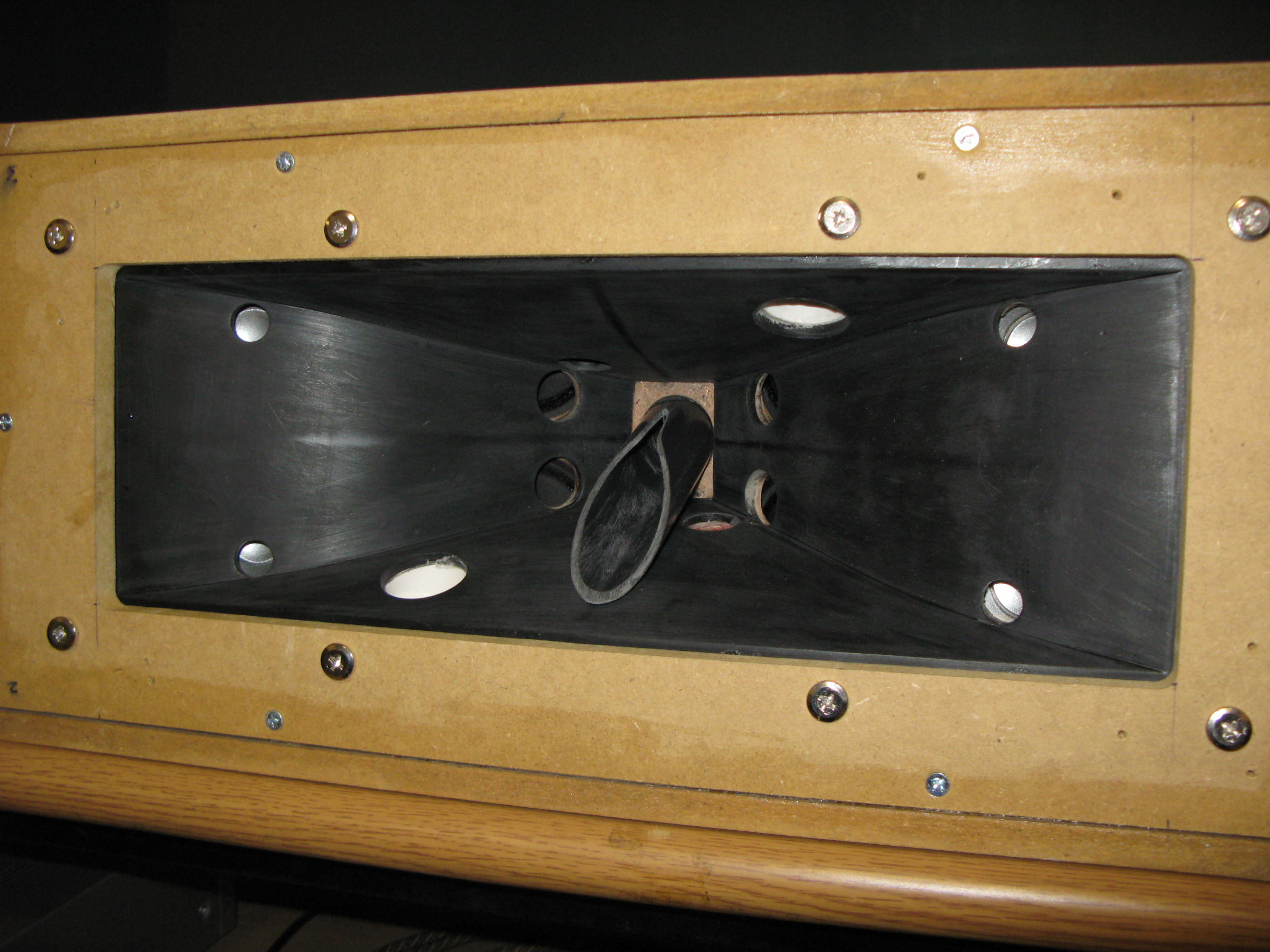

Bolexsbm,
Very cool with the K tube synergy. How does it sound? Are you using active XO or passives?

Bolexsbm,

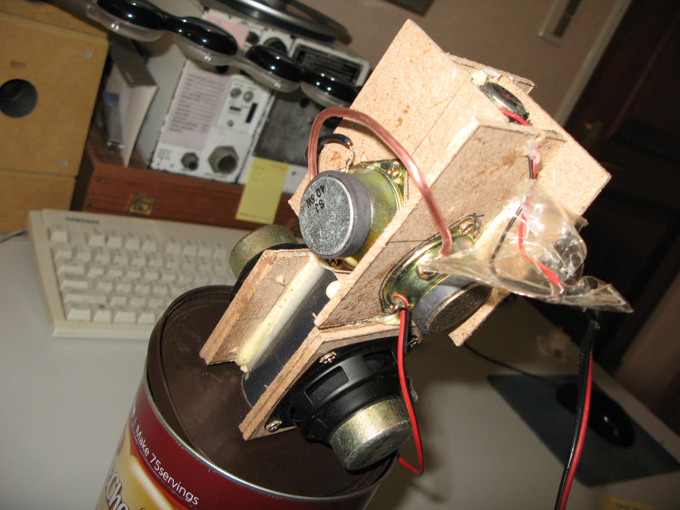

Well, I know this is a fullrange forum, and also a Karlson thread, but since it's about the K-tube...😉
The K-tube synergy was just a test. I wanted to see how much bandwidth I could get out with a enclosure the size of a hot chocolate can(!).
At the tube's end(or apex?) I mounted a tweeter from a Klipsch igroove.
And for the midrange, I stuck four 1 inch cone tweeters with sealed backs(tip from Patrick Bateman - he used Goldwood tweeters as mids with success) around the tube.
The 2 inch woofers were from igroove also, and I managed to attach two on the pipe.
I'm using two 2-way stereo/3 way mono active XO's for now.
(Trying to choose between MiniDSP and Beringer 2496...:scratch:)
As for the sound, it wasn't bad down to maybe 5-600hz.
But I felt I needed a bigger woofer for more bass, and there was no way I could make big woofers fit onto the pipe.
First of all, the bandpass holes won't be big enough, and secondly, the units won't fit into the can. 😀
But from the 'Square Pegs' thread, I learned that the big wavelengths can't form where there is no adequate space to form, so I wonder whether the K-tube synergy concept will work down to maybe 150~100hz if one figures out how to get big woofers on the tube.
As for the next step, I'm thinking a 'pipe in a pipe' concept. The inner pipe will be for the tweeter, and the outer pipe(or maybe a Klam) will take care of the mids and the woofs.🙂
