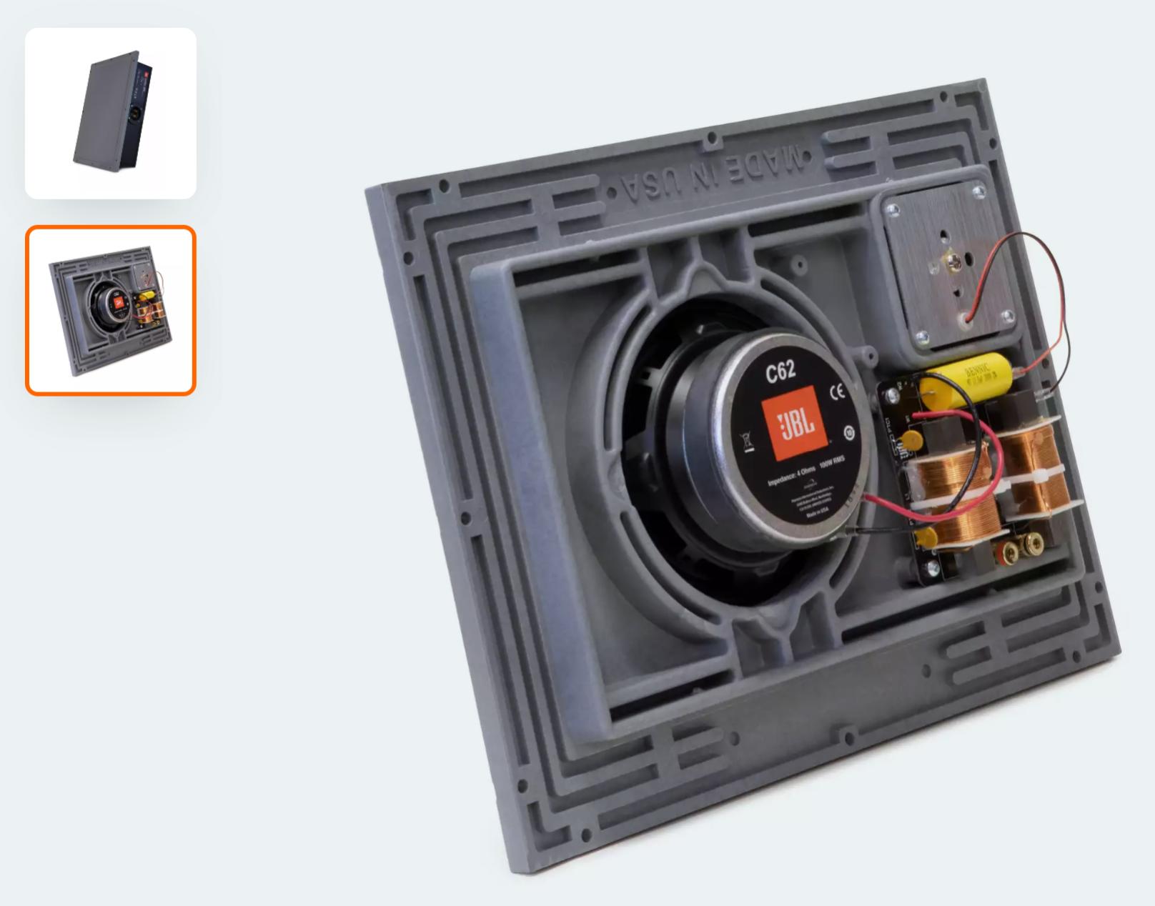

JBL Synthesis Conceal series. I probably posted this before but in case I forgot here is a link. I don't know for sure if these are DML/cone hybrids but they sure look like they are.
Conceal C62 | 6.5-inch (165mm) 2-element Invisible Loudspeaker
