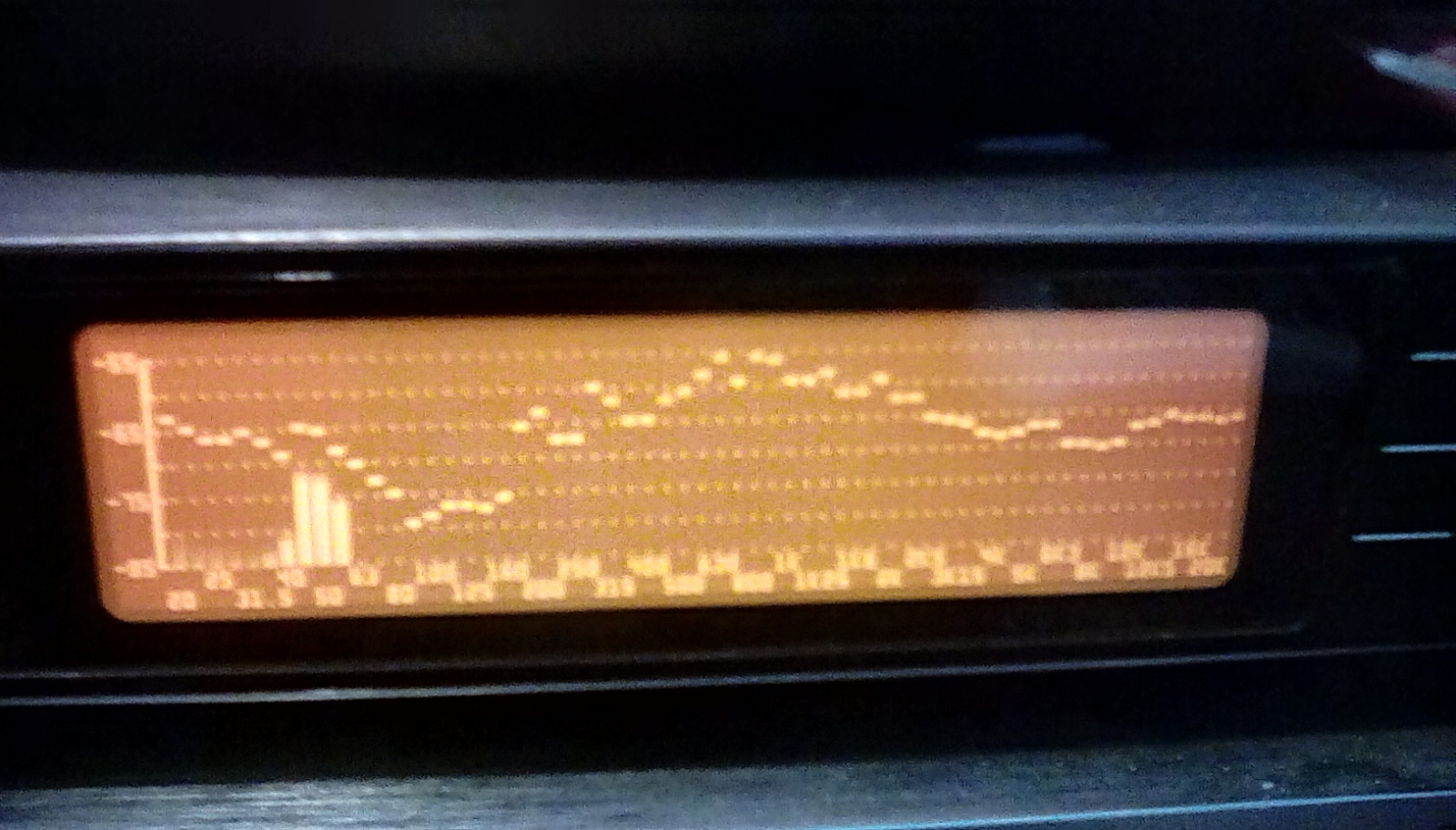

card panels only
thought i would quickly record the panels only ,from the same position as before 0ne mtr in front,they have good response down to 160hz with lower response down to 40hz.
i used the same tracks as before for comparison ,just for interests sake.
steve

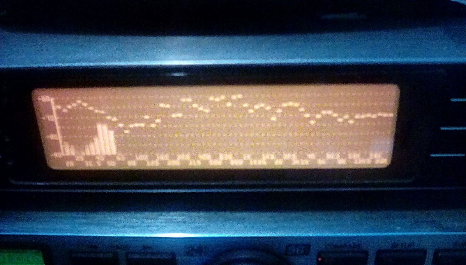

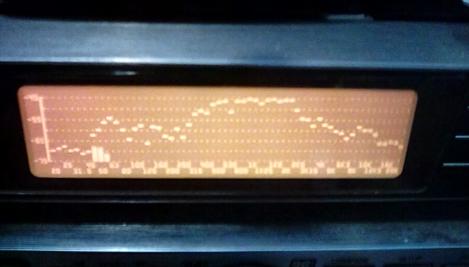

Actually these are probably more accurate ,I was kneeling down out of the way,I thought! But was affecting the response.
The two pics are one static and one with the mic swinging from left to right +- 10inches ,they look much the same.
Steve
Steve

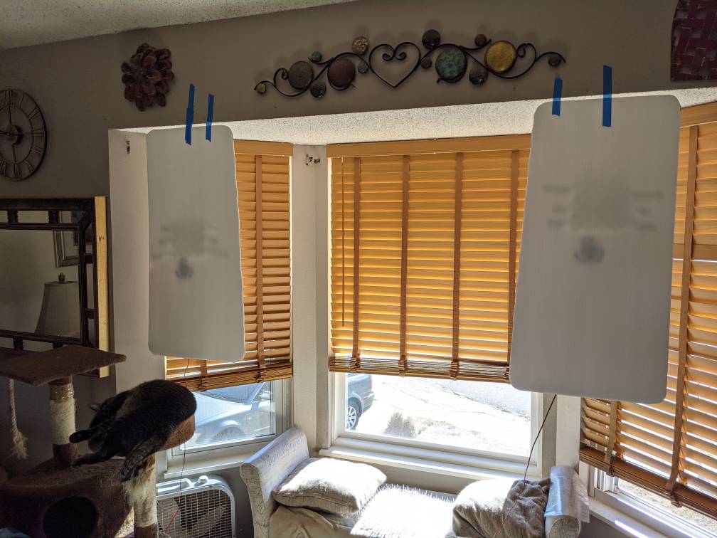

Ok... Just received a pair of exciters from parts express, mounted them to a pair of 18×36 pieces of 4mm thick Coroplast..... Pretty amazing really..... Not a ton of low end but mids and highs are startling.....
View attachment PXL_20201006_204121839~2.mp4
.... Now buy more of these..... and EXPERIMENT.

After days of listening to these.... 18*36 Coroplast with one of these Amazon.com: Dayton Audio DAEX25 Sound Exciter Pair: Home Audio & Theater mounted to each panel.... Jazz,Blues and classical sound pretty darn good.... Rock not so much
![PXL_20201009_154518386.jpg PXL_20201009_154518386.jpg](https://www.diyaudio.com/community/data/attachments/800/800500-388439969575977e4991f4541039cd8c.jpg)

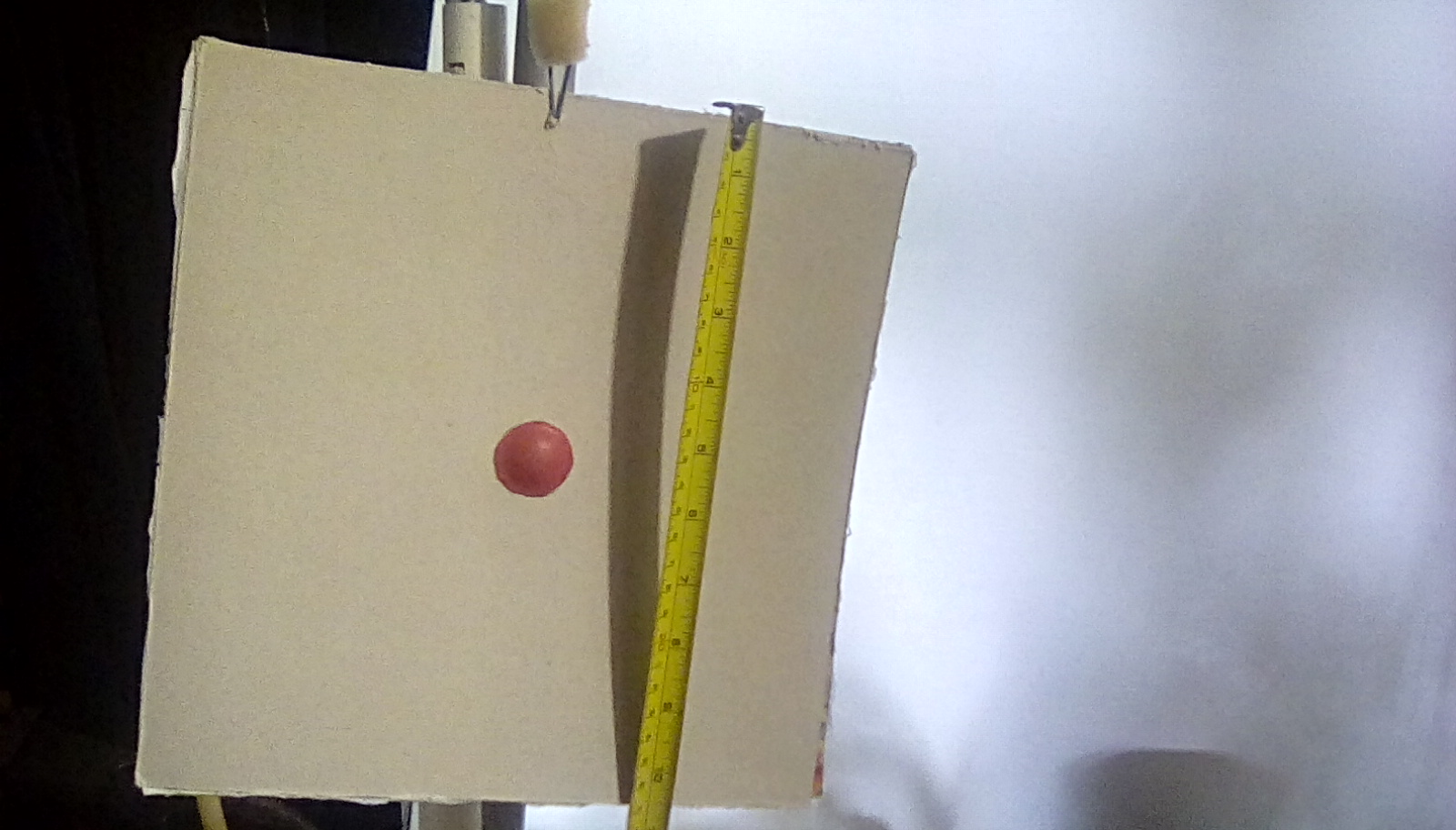

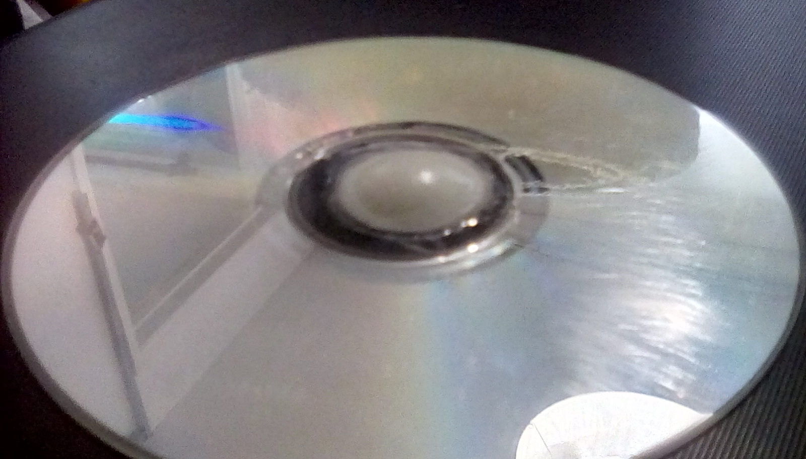

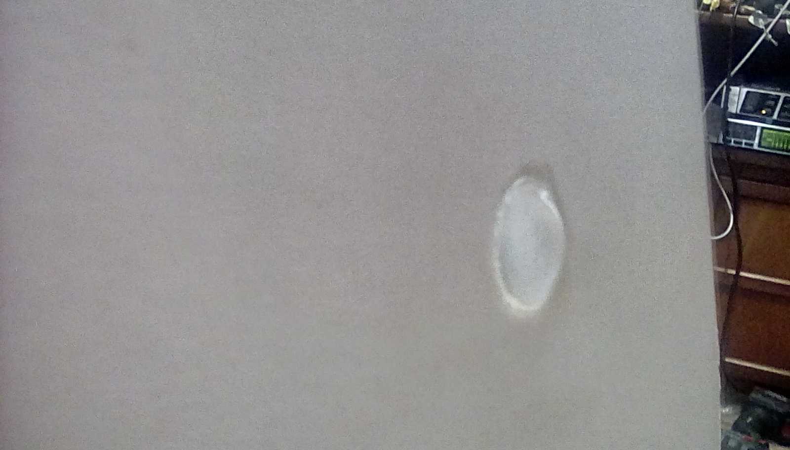

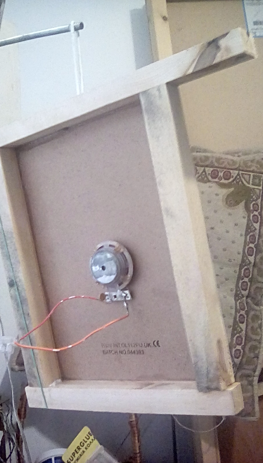

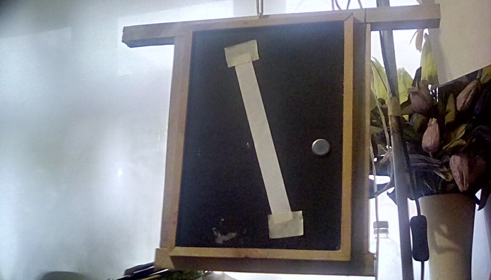

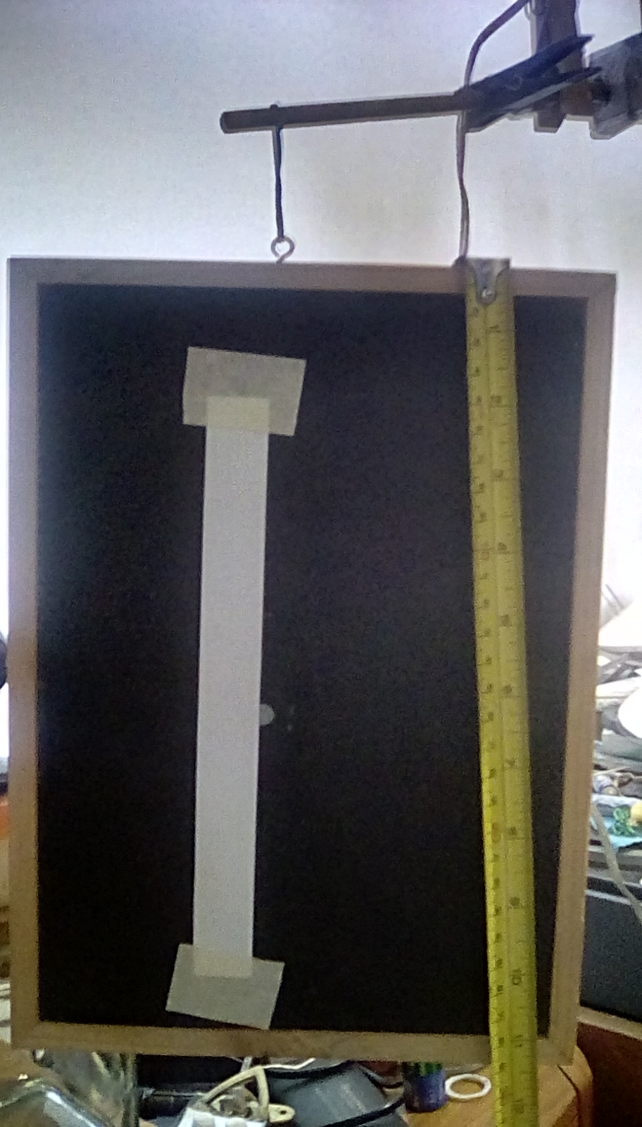

Testing drive ideas.
These are a few panels I quickly knocked together to see which ,if any worked.
1 an old chalk board .
2 card with dome tweeter made from pva.
3 card with dome tweeter made from recycled red milk bottle top.
4 is the first and easiest method of making a tweeter (concave) from an exciter,for me anyway.
5 the CD was just to see if I could do it,have not attached an exciter as yet.
The first three panels surprisingly have a very good sound and good response up to 20k and probably a lot higher.
LF is about 160hz ,but with a more solid frame the chalk board could go to about 50hz or there abouts ,I believe? Similar to the art panel.
Not bad for a small panel.
The card can also go lower as well,with a bit of clamping,when I've got time I'll check this out at some stage.
I'm afraid I've too many projects on the go at the moment
Steve

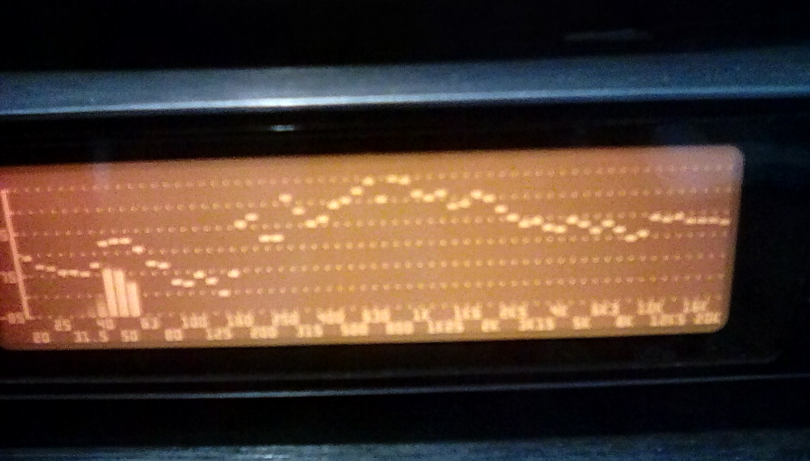

black sabbath
another quick recording of these two panels on their own, so please forgive the quality ,they were playing quite loud full range,and they were shaking about a bit!
the mic was over 10ft into the room.
i thought the room response of the two small panels was quite interesting ,the low end seems stronger than the pink noise shows,i will post a pict of the actual peek hold response of this whole track.
i think the low end could be increased considerably by placing in a rigid frame?
steve

This is the peek bold of all the frequencies played during the track.
Ignore anything below 40hz as this CD has nothing below this!!!
The hump in the midrange is the guitar solo and ozzies vocals .
While the low end is not strong but it is still there,unlike some bookshelf speakers that I have heard .
Steve
Steve

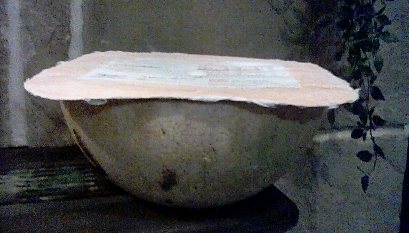

I'm waiting for this one to dry,it's an old circular plaster midrange housing my wife now uses as a plant holder in the garden.
It has a 6 inch hole at the bottom ,hopefully it should be ok for testing?
Steve
Steve
The plaster housing is back in the garden.
Basically it sounded like a speaker in a box ,I was also unable to keep a good amount of tension on the surface.
There was an increase in db between 150hz and about 1k but dropped like a brick below this.
I wil nowl try to increase the rigidity of the chalk board to see what happens,there will not be any problems keeping the surface tension?
Card.
The great thing about using free card from boxes is it is so cheep and so easy to cut using scissors,I have been changing the size and shape of this test panel to see what happens,all very interesting.
I can't wait to get my blue Peter badge😀
Steve
Card.
Steve
Another quick recording, this time a direct mp4 recording, no conversion!
It does pause after 3 minutes though,.
This is with the more solid frame attached to the small chalk board on the right,I have reduced the level of the left chanel so you can hear the chalk board better.
This panel goes down to 125hz with no room suckouts, so have xo the lf at 120hz 48db slope to the subs.
So the panel is doing everything from 125hz to 20k and beyond.

rigidly mounted Chalk board
These are pics of the chalk board after adding a stronger frame,I would have liked a thicker heavier frame but these 1inch off cuts were just handy and quicker to test.I
Steve
Steve
