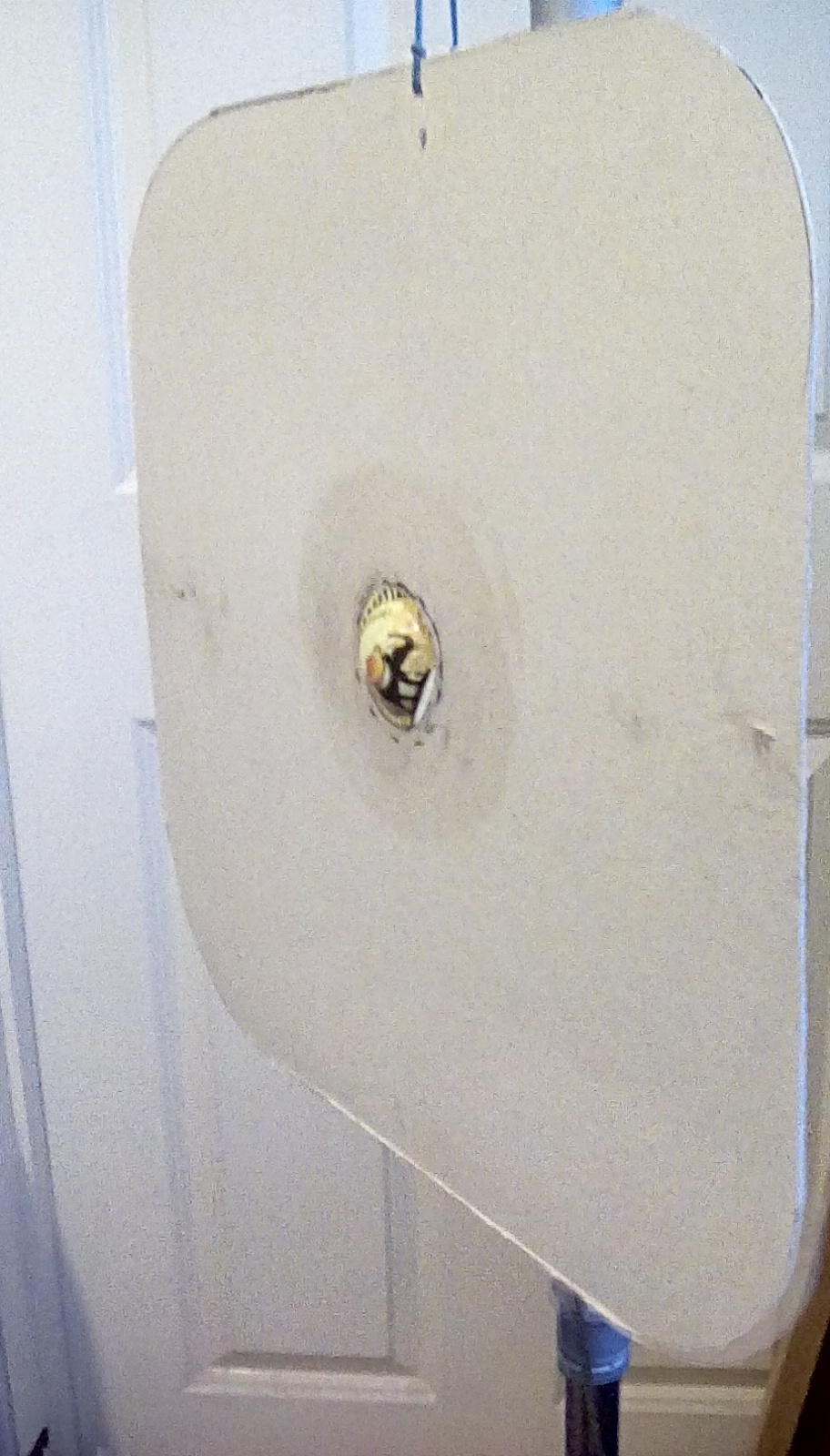

A few pic of the 10 1/2 inch square 1mmm panel with the central area made into a dome.
I got a bit carried away and coated the area around the dome with pva,which made the card bow outwards about at least an inch each side!!
I eventually managed to bend the card back but as you can see from the picture it's still a bit bent about a bit!
The bend ruined the mid to low frequency response.
I like the card sound ,I can see why paper cones have been around for over 100 years
I can see the card is going, probably ,to be my secondary smaller panel as I intend to be able to switch and even run together with my main set(EPS).I

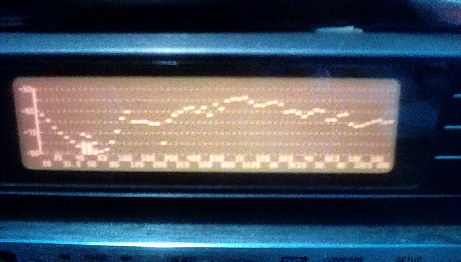

The fr plot was with the previous thinner foil dome at about a metre or so.
I'm just testing different dome thicknesses.
Steve

Nice testing!
What would happen, if you put the "exciter" on the other side of the card, so the card would have slightly concave outwards? By the way, what is the sound coming from the back side? Would that side give you better mid to low sound?
If you have time, have a look at this video. The guy is assembling a driver. It is Hindi, I don't understand it too, but the video tells a story. The cone is wavy, which tells us that vibrating surface of the cone gives out sound. Actually, DMLs prove it.
Also, to create a DML, all you need is the permanent magnet, yoke and the coil, one can glue the panel, just above the spider. There should be a very short chassis to suport the panel. Between the chassis and the panel, rubber tube could be placed to separate the two. It might be cheaper than buying an "exciter."

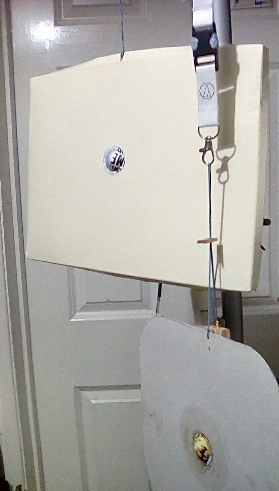

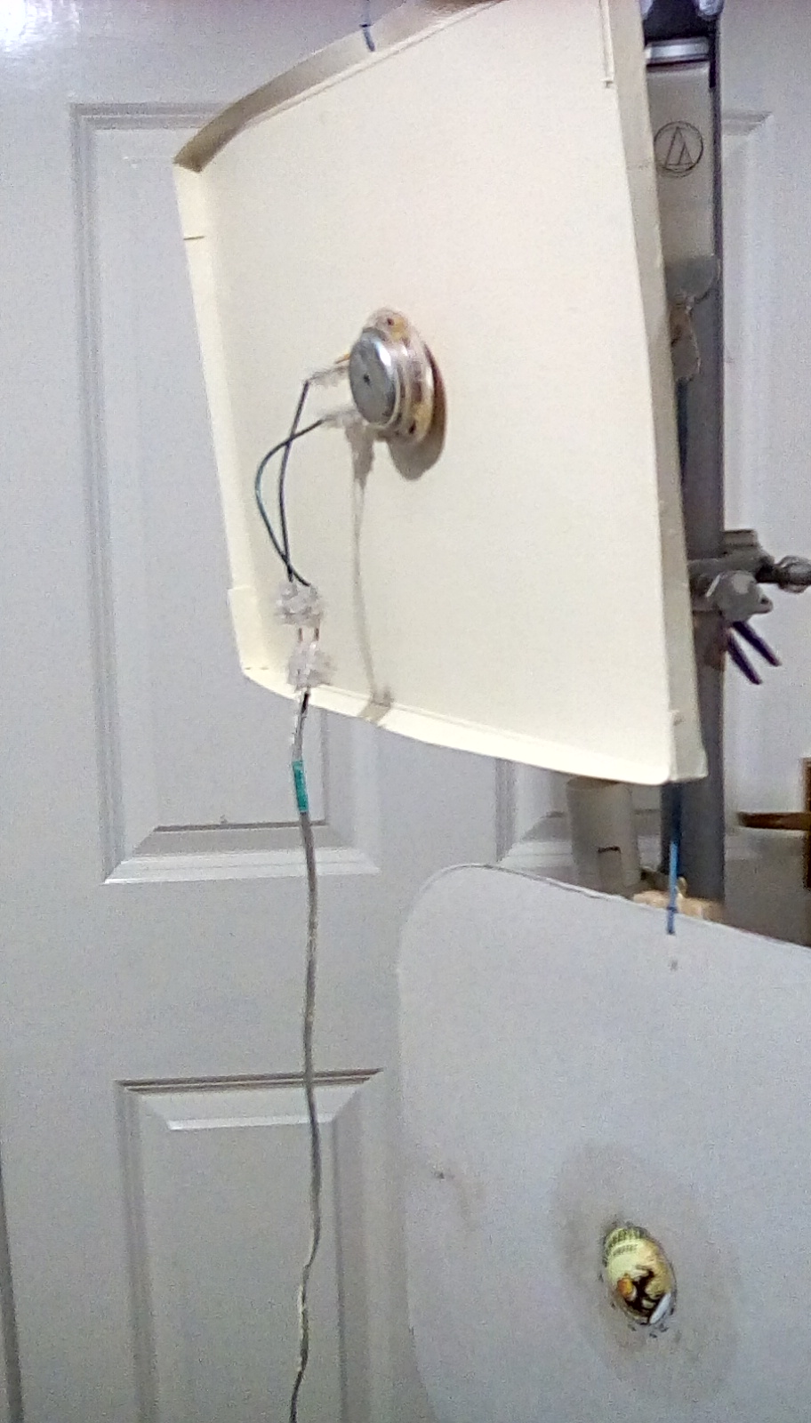

Steve
Steve

When I glued the two .5mm card panels together with pva to produce a 1mm panel I sandwiched it between two pieces of ply until dry,this gave a pretty flat panel.
I did wonder if the stretching technique for paper might work on card?
But I think I'll have to find a coating that prevents bending with time and moisture ,which hopefully sounds as good.
When I coated one side of a largish 5mm xps panel with pva,it bent horribly,but coating the other side pulled it back into place.
If I'd sealed and coated the panel to start with it would have saved a lot of pain,but at the time i didn't know how far I was going to go with this panel.
The other older 0.5mm card panel I'm using with the same dome at the moment,is one I first coated in pva ,then vinyl silk ,it could probably just as well have been gloss paint?
I use pva first as it's a glue and tends to soak into the panel for a firm exciter mounting,vinyl will will tend to pull away with time,so I paint around the exciter area.
Steve

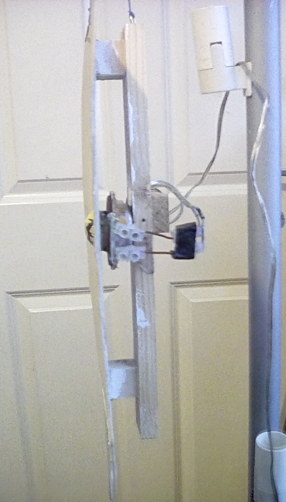

DML subwoofer anyone?
After reading about the post about Bristol paper I decided to try something...
I have a roll of brown painting dust cover paper ( the brown paper on the back of paintings ) like Bristol paper once you've attached it to the canvas you wet it to stretch it tight. The sound I got was not at all what I expected, Very VERY good response from about 35 to 200ish hertz above that is pretty much non existent. Panel was a basic wood frame (450mmx600mm) with paper stuck on the front with contact adhesive, first tried with plain water and then pva/water mixture with no real benefits. I do think this can be used as a low frequency driver with a smaller eps/xps panel to pick up the highs.
Interesting!
Brown paper has a different consistency and texture. Maybe, you should have a look in the stationary shops to find something like Bristol paper. They are usually sold in A2 size. You might even find some paper thicker than that. Bristol paper is more like a card.
Thanks for the info jmatt.
How did you mount the exciter to the paper,did you use a frame to support the exciter?
I must admit I would have expected some hf from the central area of the exciter,at least.
This is a cheap and easy panel to test ,so will probably give it a go.
Steve

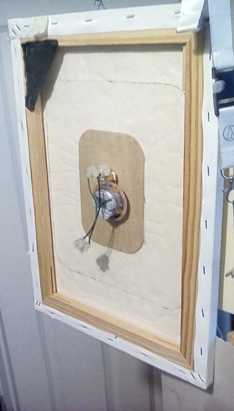

I mounted the exciter to a 100mm balsa disk and then to the paper, also used a wooden spine to support the driver.
JMatt.
I'm a little more confused now?
A 2mm 100mm balsa panel on its own should have a fairly good response from about 600hz to 20k if my memory serves me well.
I can't fathom why attaching paper would stop this?
It works with the canvas art frame panel 40hz to 20k?
Any chance of a picture or a fr plot?
Thanks .
Steve.

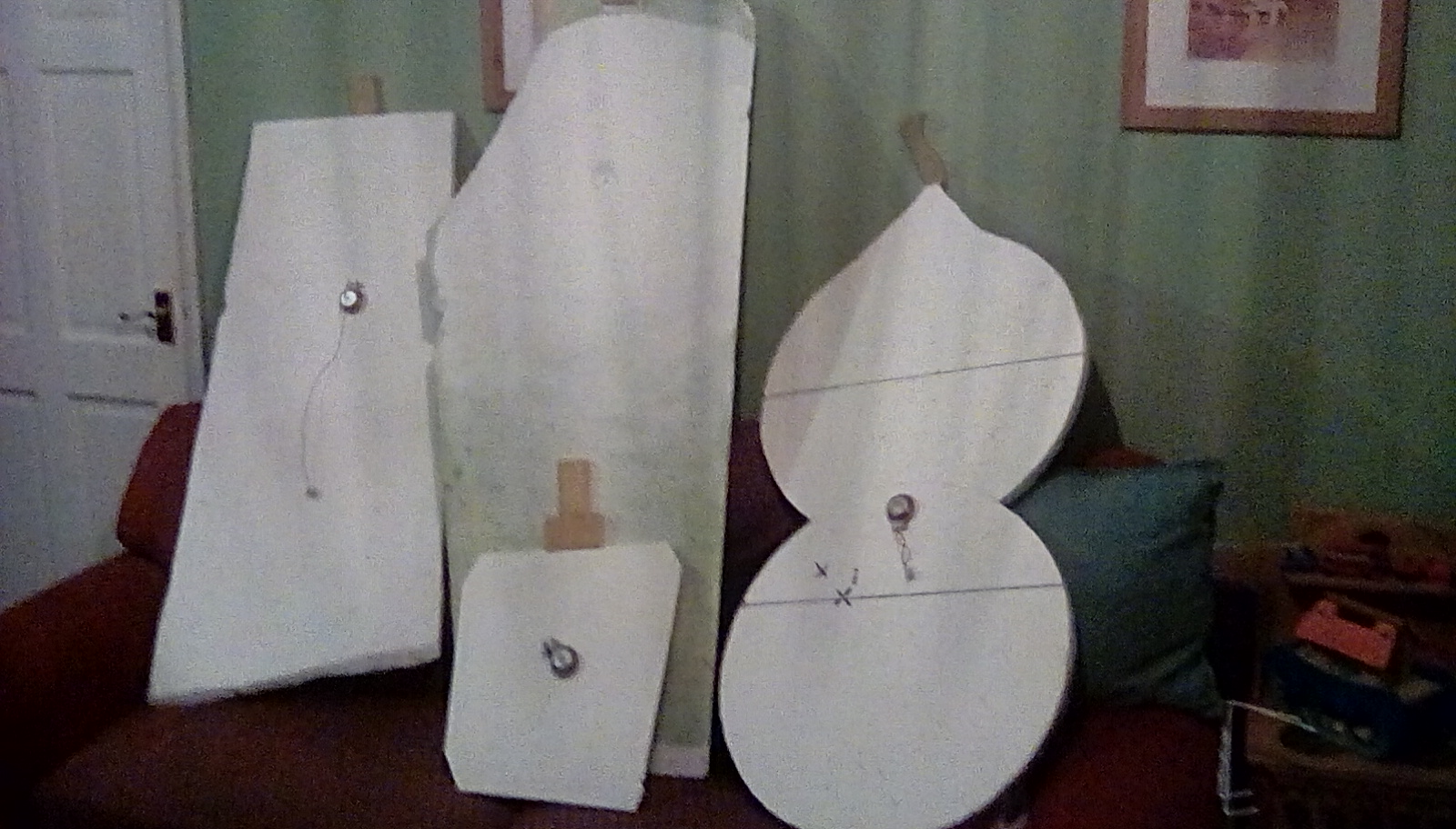

This picture shows some of my various shaped panels over the last 10years.
As for how many exciter or panels ,that is up to you,you can make it as complicated as you like,multiple amps,eq,xo,you name it.
All the things you have mentioned have been discussed on various threads on the web over the years.
It's a long read ,you'll be grey haired like me by the time you've finished reading them all,plus patents .
When I first started looking into dml,I purchased 40 or so exciters ,as it was thought that like the podiums ,the more the better!
That is why I have so many panels lying around with exciters still attached.
I have found dml interesting and fun.
Hope you will too.
Steve

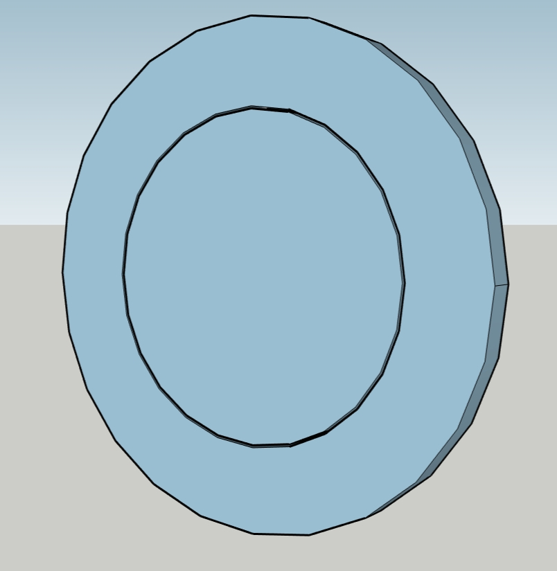

But what if we employed more eccentric shapes, just not so extreme as to drastically compromise surface area. See my attached crude drawing. ...
Interesting line of thought.
As sound waves move away from the source radially, why not use disks? Even in a cone, the waves move along the cone surface and on it, radially. So, why not use two different materials for the panel, one for mid/low, one for high?
Thinking about the sound waves coming out of the back, and to get lows out of it, why not box the back and leave a bass-reflex hole (or a transmission line) out of that?
Attached is a two material drawing of a disk.

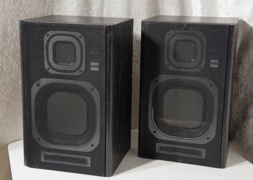

Might be better with the inner disk surrounded by triangular shapes, so it looks like a fat multipointed star. I'd then expect a softer transition between the two materials with respect to the two strong resonant modes these coaxial disks would have.
Chdsl.
You seem to be describing a BMR ?
Steve
The people, who try to earn money out of this explain,
"Balanced Mode Radiators (BMRs) combine bending wave mode technology with pistonic motion to create full audio range, wide directivity speaker drivers for lifelike sound reproduction."
And, also,
"The BMR is a flat-diaphragm driver that features greatly reduced breakup and extremely broad dispersion..."
After all, the DML is trying to do the same thing.
The "high-end" BMR manufacturers are using extremely thin diaphragm disk surrounded and fixed by the same way as the normal cone. Sony tried this with their APM series, and dropped it quite sometime ago.
