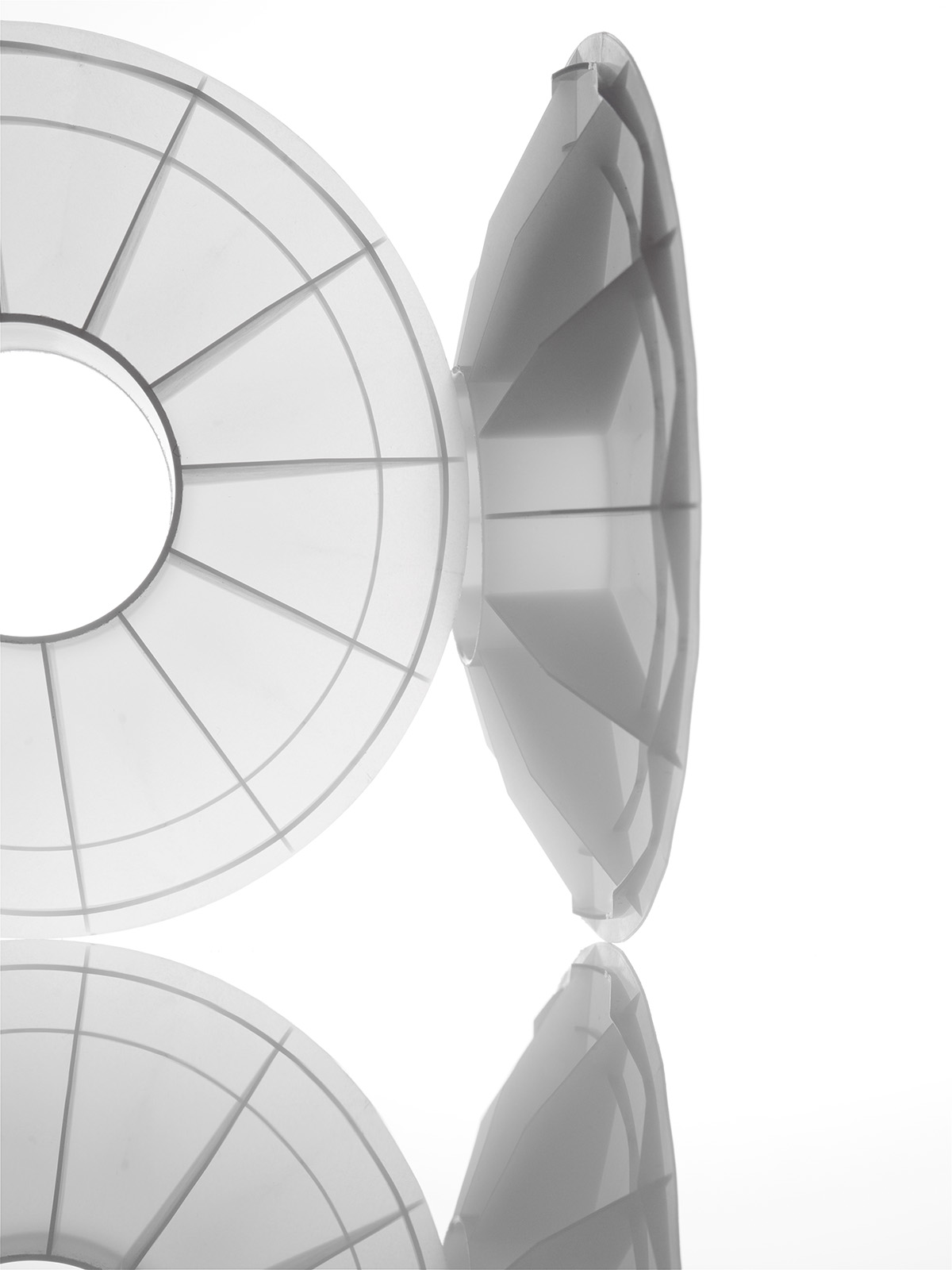

Taking into consideration the ideas of Peter Gansterer (Kiss Technology), one can try pasting ribs on the back of cone of standard driver and see, if the sound will be more prominent, and the bass is better etc. Or, instead of ribs, stiffening rings at different distances from the VC along the cone.
Here, it is a thin flat surface with ribs on the back and a tube to be glued to the VC. I've seen a disk like this in a electrical shop or in a piping shop, just can't remember where.

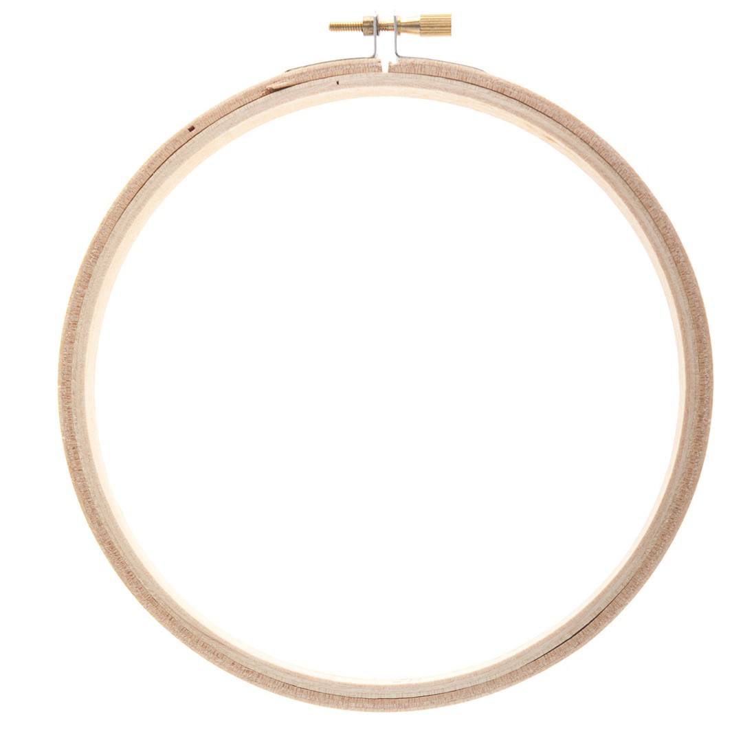

You'd better off with round paper disk, or even a cloth disk. It can be easily made with an embroidery ring.

Chdsl.
I have already stated my interest in the embroidery ring, for testing different materials?
Whether the ring would be better depends on testing and comparing performance.
The main thing is that the card and paper in a frame works well:D
The card was already my second favourite panel material,having the panel going down to 40hz is a bonus.
Obviously more tests and comparisons need to be made for best sound.
Such a large sound from such a small panel is a plus too.
At some time I'm going to want to test the bigger panel and see what happens.
I do have some thin cotton sheets from an old duvet I intended to stretch,when I can get to the local art and craft store,covid allowing!
Canvas is too heavy for my liking,paper is even better,cotton?

Chdsl.
We shall see
Steve

The good thing maybe, is that something like the embroidery hoop could easily be used to tune in the LF, if you make it too tight you can easily slacken ,lower the frequency.
