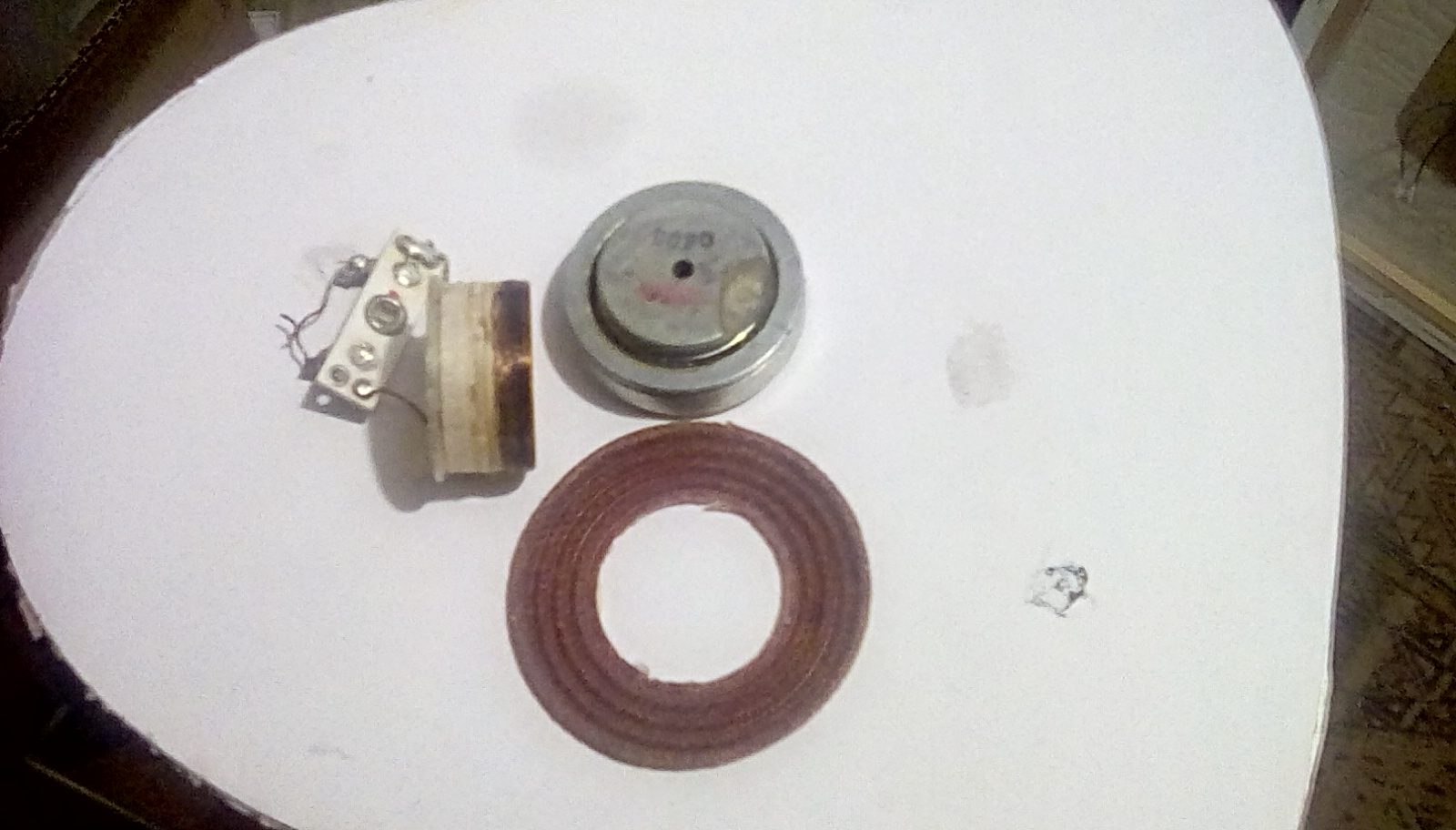

But before I go I must give you a warning that when using eps and similarly efficient panel materials,a 10watt exciter has no problem producing large volumes of sound,and I mean LARGE,and with very little movement from the exciter.
But if you try to turn up the volume on a panel such as ply ,especially with a 400watt amp !
You could end up with an exciter looking like this.
You could get away with full range light music,but heavy rock or electronic music will heat up the exciter to finger burning temperatures very quickly!
When playing loud music on ply I was always going around the back of the panel to check how warm the exciters were getting.
I thought I should mention this.

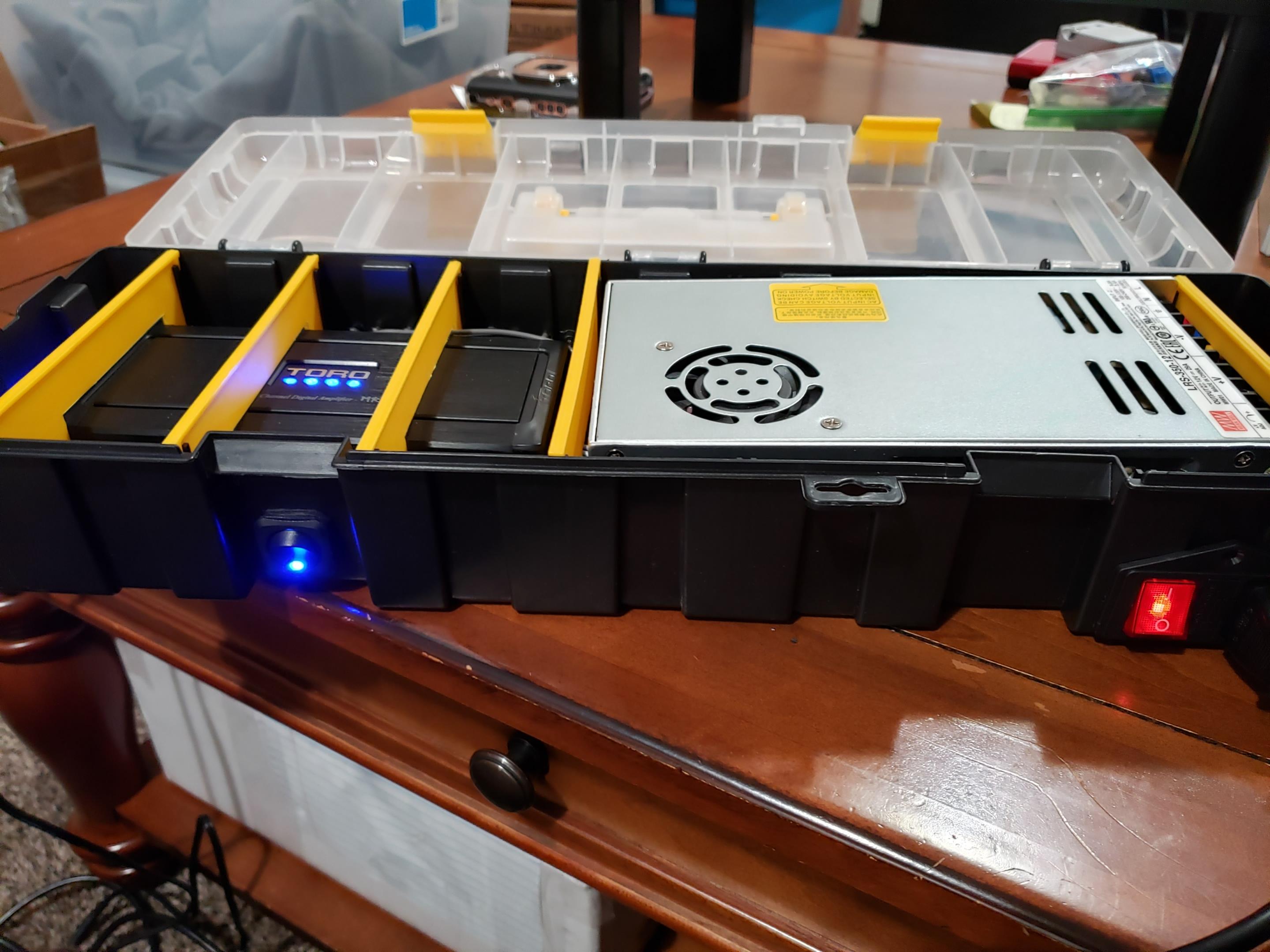

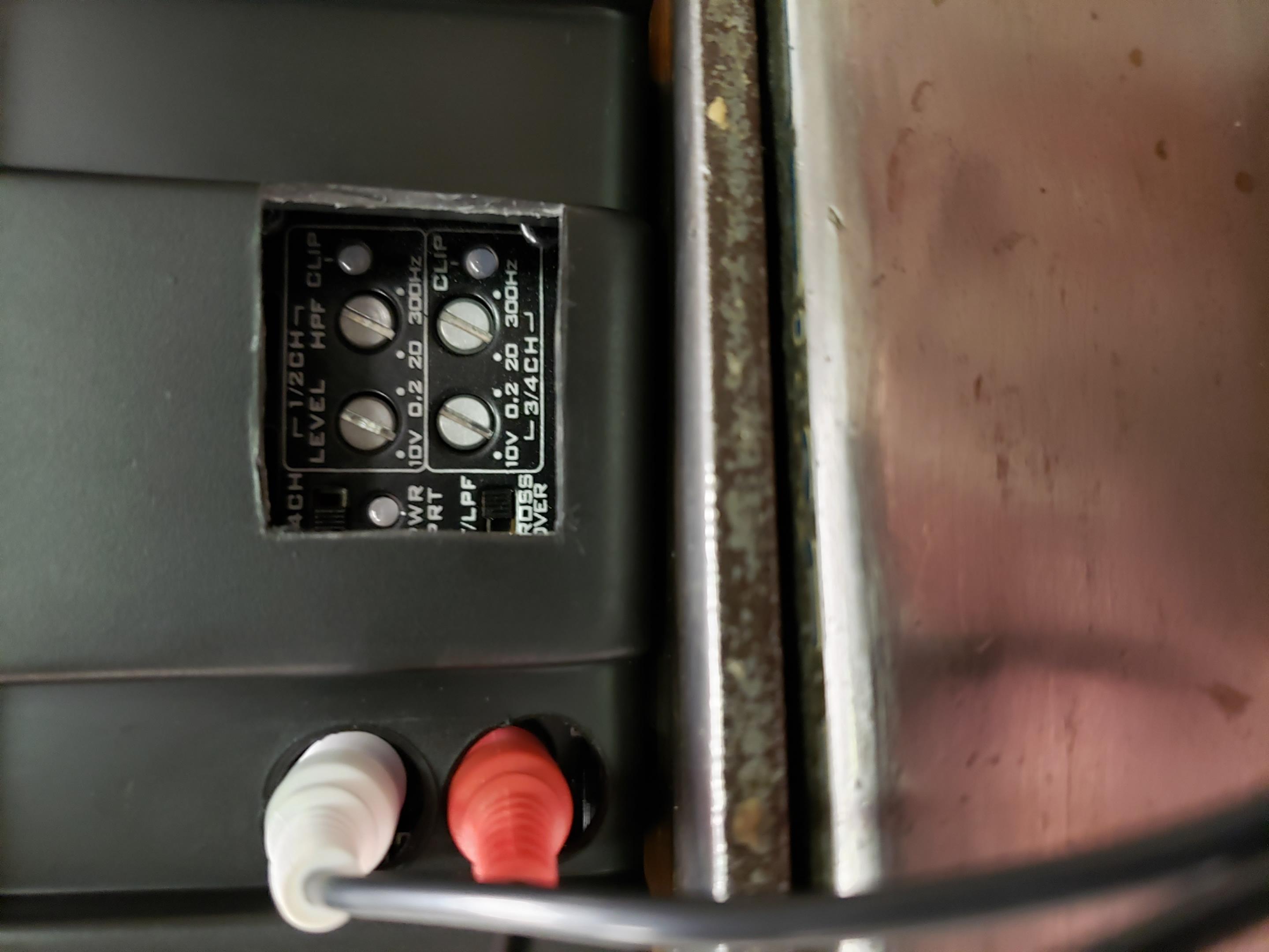

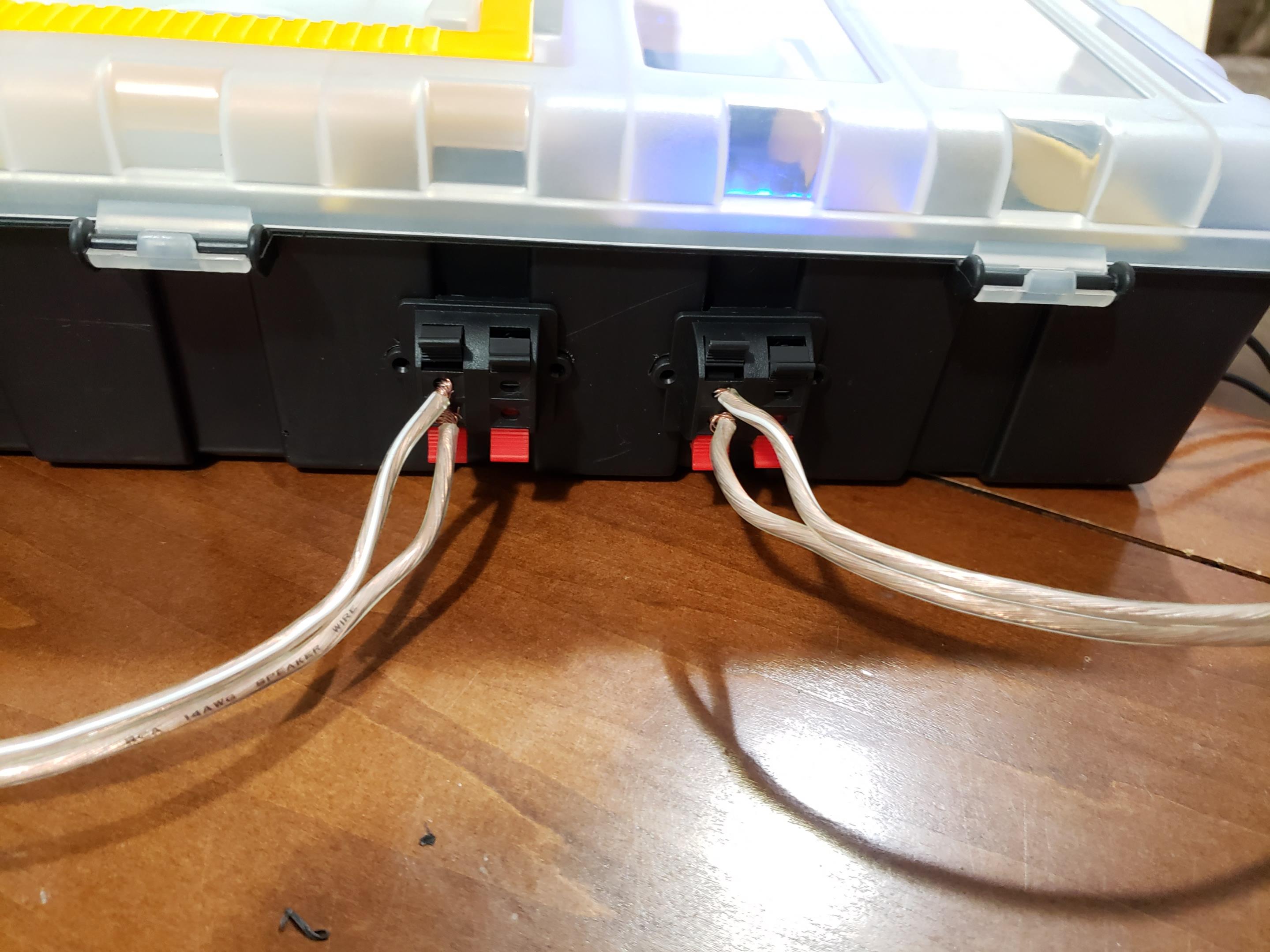

Hey guys. It's been a minute, but I've been working on some cool (at least to me) stuff. I built a test rig that gives me 4 channels with variable crossovers/gains so I can try bi-amped, 2 way setups. It's a 12v 30a Meanwell AC/DC PSU powering a Toro MRX4 amplifier, 4x80 rms @4 ohms. I tucked it all into a Harbor Freight parts box with independent power switches and spring loaded speaker terminals. It's working great so far. Cost about $130 total. I was going to go with a similar setup with a 24 or 48v PSU and a couple of TPA chip amps and a Minidsp but this setup is cleaner/note compact and doesn't require a PC to change the crossover settings.
I've got the lows heading to a pair of Dayton Thrusters and the mids/highs to a set of Dayton DAEX25QLPs. I have been toying with the thrusters on xps/eps and the EX25s on 3mm Birch, thin plexi, canvas and cardboard.
Some of the results have been promising, at least in the ear tests. I haven't put them through REW yet. It seems like the sound is fuller and more clear when you're not trying to get a single substrate to vibrate over such a wide range of frequencies, and when you can choose substrates that work better for certain frequency ranges.
Tests so far have just been with uncut/unprepped panels. I'm getting ready to try a couple of different designs with prepped surfaces and different levels of damping.
1. A 2 way speaker with a larger panel of foam plus a thin strip of Birch or cardboard in front of it about an inch. So like a 12w x 18t" foam midbass with a 4w x 18t mid/high in front. The high panel would be too narrow to block much low end, but also gain a bit of output by using the panel behind to reinforce the output. Just ballparking the dimensions.
2. Put the low frequency foam panel behind a slightly larger canvas with the high frequency exciter on it. The canvas is acoustically transparent enough to let most of the low end through but it looks like one panel (-ish).
I've also been trying one of each exciter on the same panel in opposing corner nodes. I know that it's been pretty well established that multiple full range exciters on a single panel don't seem to appreciably increase SPL or improve FR but, to my ear, using two exciters running on different ranges gives a better sound than one exciter running full range, even when sharing a panel. REW measurements will either confirm or refute this.
Depending on my outcomes I can use the results to either help craft passive crossovers so I can run a 2 way system off a single channel and then maybe power a passive sub(s) off the other channel to really fill the low end, maybe in an Open Baffle configuration as par of the panel base on a larger freestanding unit.
I'll post updates as I go. Hopefully I will be able to prep some panels and get some testing sessions in this week.
