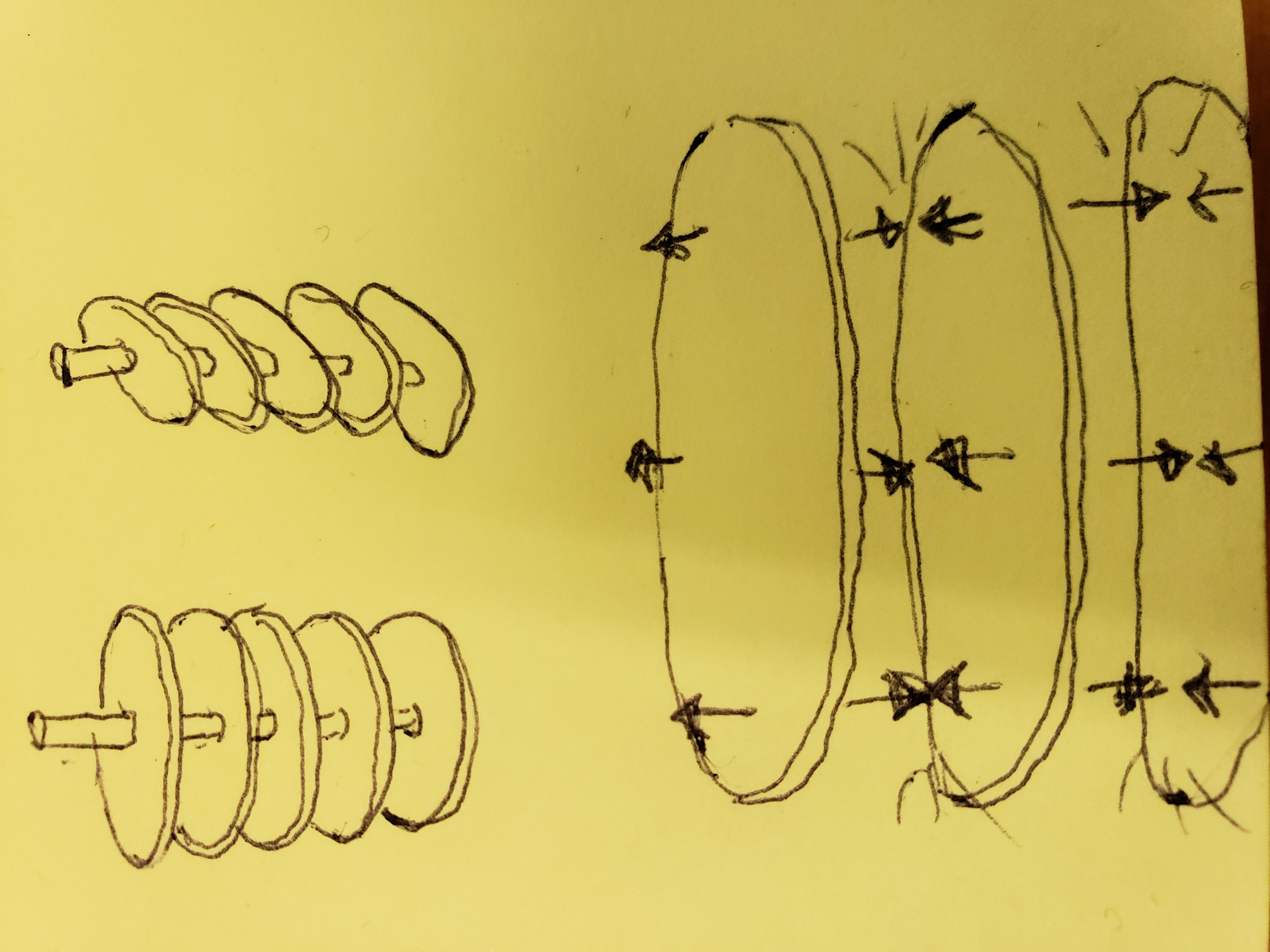

I made some DML's long ago. Every once in a while I see somebody bring up a picture of my old DML speakers, makes me smile. Anyway, I experimented at the time with different shapes of foam. The vertical rod shape seemed ideal because it required less floor space. As I recall, the results were very poor. While DML's do not radiate the same way as others, I think the vertical foam rod failed because I didn't have enough surface area inline with the driver's most potent direction.
I suspect a better idea would have been to have a thin shaft with many rings emanating from it. To equal the same surface area as a 36"x36" panel, a 1" shaft would need twelve 6" rings (math not guaranteed). You get the point, there is a way to minimize the footprint and maintain/increase surface area. The obvious downside will be earlier cancellation of low frequencies. It's just an idea to improve upon a past failure. It would be pretty easy to build. Cut out rings, slide them down the shaft, attach shaft to driver, and build base around upfiring driver. Omnidirectional is not a problem for DML, in my opinion.

By this concept, if I'm understanding it correctly (see attachment), wouldn't a corkscrew/auger design make more sense than a bunch of discs spaced out on a shaft? You would get more continual surface area by having one spiral fin vs many wafers, which would mimic a larger single panel. The issue I see here with either design, besides the fact that the facing surfaces aren't projecting sound into the room because the edges are what are facing outwards, and sound wave clash between panels. The sound emanating from both facets of each layer would meet with the sound from the adjacent facing surfaces and it would probably lead to cancelation or at least some unwanted resonances.
Agreed on all fronts. The spiral design seems harder to pull off just for purpose of testing. Less of larger fins also would reduce cancellations/interactions... though the small footprint benefit starts to get lost. There’s lots of things that could be tried: oval wafers, offsetting/staggering wafers, mixing materials, a Christmas tree shape, etc. Standard logic doesn’t always apply to DML. So that is why it may be worth testing—could prove useful in some way.

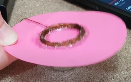

Paste a coil on the panel, connect it to the sound (music) source and bring a magnet near the coil, the panel would give out music. What would happen, if the coil is unwound and pasted on its surface in a large spiral, and then bringing a magnet near it? If music happens, then you could make a hole in the middle of the panel, and fix the magnet permanently (to the frame or to the panel). Fix the panel on a frame, maybe with some soft material.

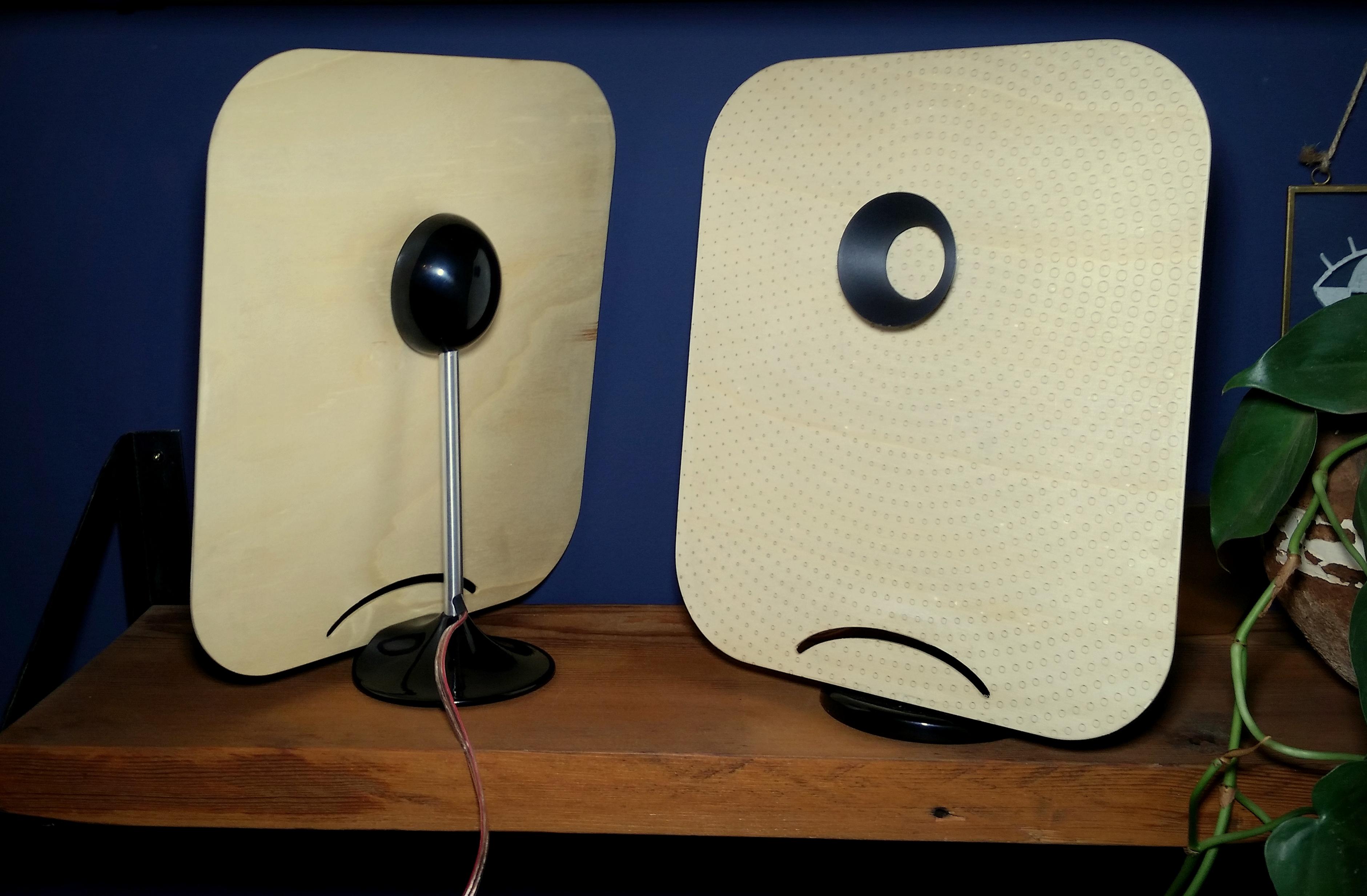

Cool. I'm assuming that you used a cnc machine to get the pattern. Is it functional or just decorative?
Also very fascinated about the whizzers. I like the symmetry of the panels but did you consider doing them off-center so you could place the exciter on a 2/5, 3/5 node? Do you have REW measurements or at least subjective input as to the impact they have? I'm assuming you did an A/B comparison between a panel with and a panel without.
Thank you, correct everything was cnc and lasered the pattern was just a decorative way to make it easier for me to align everything.
I moved the exciter around a bit and personally on these small panels it sounded better closer to the centre, on bigger panels I would still do 3/5.
As for the whizzers, well they are still a bit of an experiment. They definitely boost the spl and highs but it can start getting tinny the bigger it gets.
From my last post I reduced the size another 10-20% and changed to a carbon fibre pla cone that's tons stiffer and I like it a lot more now. Next I'll be experimenting with different whizzer designs.
