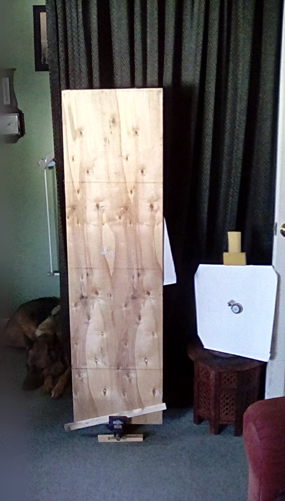

Pixel1.
I was listening to the ply panels last night and was not happy with the sound ,very dull and resonant?
I lifted one of the panels while it was playing ,and the sound improved instantly.
So not a good idea to lean panels up against book shelves.
They still sound like ply panels to me though,they still need a lot more work done.
But they will always have the problem of being a heavy panel.
As will all heavy panels,heavy panels will only get you so far,they have limitations.
This is why I concentrate mainly light panels for home use.
Steve.

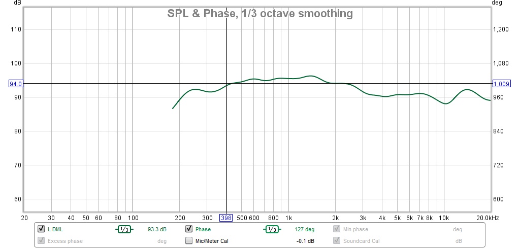

Some measurements
Thanks Steve..
I've just ordered five sheets of 400 x 600 x 10mm 70 grade EPS for a fiver.
I've also weighed the 3mm poplar ply and 25mm HD panels - 400 x 565mm. The 3mm poplar ply weighs in at 250g, the 25mm EPS at 180g. So 10mm EPS will weigh in at around the 70g mark at most. That's a lot less mass to shift.
The plan is to PVA it, and then spray paint except for the exciter area as you suggest.
I'm getting reliable results using REW and a calibrated UMIK-1 measurement mic. Add in a passive pre 'amp' after the miniDSP 2x4 HD and the ply panels actually sound pretty decent. But I think there's more to be had. With the 15 inch Monacor bass units handling bass duties for the first four octaves the emphasis now needs to be on getting the rest right.
Attached is an illustration of the kind of response I'm getting (1/3 smoothing). I listen to a lot of orchestral music and this benefits from the slight downward FR (about 3db drop overall).
Simon.

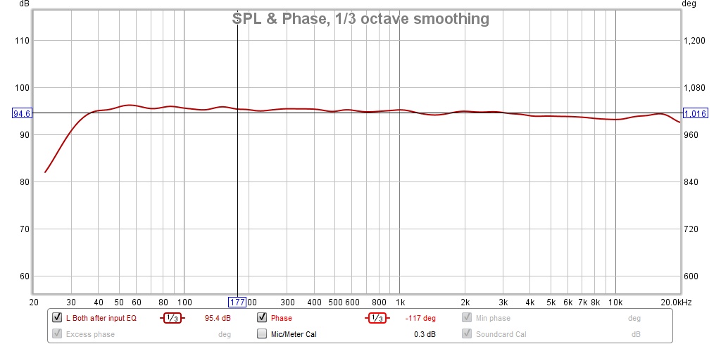

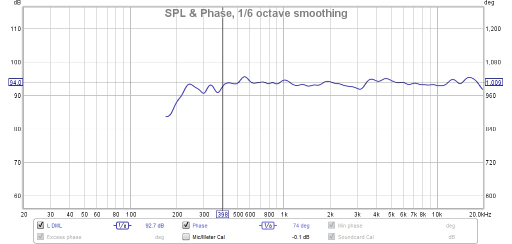

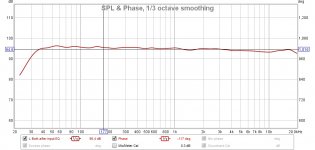

Here's the DML panel before any EQ - 1/3 octave smoothing again.
Also, I've included the panel with some EQ - 1/6 octave smoothing this time.
I ran out of PEQ levers to pull to fix a couple of dips and had to do this by tweaking the input PEQ.
My hope is that the EPS panel will be better above 2.5khz and will require less EQing.
Simon.
Simon.
Lordtarquin.
That is probably the best un EQd response I have seen posted on its site.
Could you please give microphone position and distance from panel.
I recognise the classic response the hump in the midrange and the dip at 10k followed by a peak.
If it was me, I would pull down the response in the midrange a little maybe slanting towards the hf slightly,
Your second plot gets a little lumy in the 200 to 400hz area for some reason ?
The dip and peak at 10k could be corrected on the panel itself(not with the paper strips used for ply.
You would have a response within +- 2.5db.
This would give a good looking response plot ,but it does not tell the whole story.
I usually measure dml by putting on peak hold and movin the microphone around the panel area ,usually about a metre in front.
I then do the same from my seating area ,but this time I move the microphone about one or two feet ether side of me and up and down.
This will give you more of an idea of what is being produced in the room, which can vary from one inch to another.
If Using a single point position response with dml ,you could be correcting something that is not in the room response, and make it worse.
If from your seating position you get a dip ,but at a foot to your right at the same frequently you don't get the same dip ,you might even get a peak! What do you do?
And don't forget it changes as you move up and down a few inches as well.
You might find it interesting if you do this in real time still on peak hold,moving the microphone around the room and watch the frequency response change .
Using this method You should be able to get a more accurate average response of your seating area.
It is not like ordinary speaker where if you move to one side a few inches ,you loose everything above say 5k.
You cannot measure a dml with one point, the frequency and phase changes all the time from the centre of the exciter all the way to the edges of the panel!!!
I can not stress enough that what is produced at one point of a panel will not be the same at another point on the same panel!!
In this way If measured as a whole ,you will know the full output of the panel.
I hope this will be taken into consideration when measuring DMLs.
Steve.

Thanks Steve, very helpful indeed.
The unEQd response seems pretty consistent whatever I do. I've tried measuring near field from about 1m and also from my listening position. I usually stick the mic on my tripod to try to get some consistency, so it will be easy to get some controlled results from different positions.
As I understand it, the usual strategy is supposed to be to measure drivers near field or where room effects are minimal, use output level EQ to fix driver response and then use input EQ to correct for room response.
With DMLs and especially OB bass, room interactions are a critical part of the setup. With the miniDSP 2x4 HD I have 10 EQ bands per output driver (4) and 10 EQ bands per channel (2). I've played around with 1/12th and 1/6th octave smoothing when doing the EQ. 1/3 smoothing is a little too crude.
I'm glad you mentioned phase - it's all over the place! I had planned to have a go with linear phase crossovers with the miniDSP, but I've still to get to grips with it - not enough taps are available and I cannot yet work out how to configure it (I've used RePhase).
I'll give the mic position thing a go - probably on Thursday when the mini heatwave is over.
Cheers
Simon
Cheers
Simon
Cheers
Simon
Lordtarquin.
Yes you are quite correct,the usual strategy for measuring cone or dome drivers is to measure the sweet spot directly in front of the units.
If you moved the microphone to the left of right a small distance the response would be appalling.
When you take a measurement in front of the exciter area on a dml panel ,you area measuring the sweet spot produced by the primary output of the exciter,which is exactly the same as measuring a standard drive unit such a tweeter ,midrange,and bass unit ,but all rolled into one!
The HF will beam from this area.
What happens after this primary output is what sets off the dml on the rest of the panel.
The phase I was talking about ,was the phase across the panel,which could probably be about 50% out of phase with itself and varying between these two states.
This is why dml has been described as being chaotic in nature.
If you move a microphone, say at about 2inches distance, across a large dml panel ,you will see the response varying greatly with large dips and peaks.
It is the combination of the whole that fills the room with sound,this also includes the response from the back and the sides of the panel also.
You cannot measure one point on a panel and say this is the response of that panel.
On my smaller panels ,they maybe a different story ,as they are becoming more of a point source?
Measuring a dml is not as easy as it seems,using standard measurements.
Most dml that I have measured from say 2inches in front of the exciter area will give a really good response,but sometimes, the rest of the panel response(DML) can be appalling!!!
I could go on?
But this subject is vast.
I stick to what I hear and measure in my room,it's a lot easier that way.
by the way the dip and peak in the hf response ,I believe is a resonance and distortion(phasing) in the coil area,you can level it ,but really you need to get rid of it,this can cause a harsh sound.
Steve.
