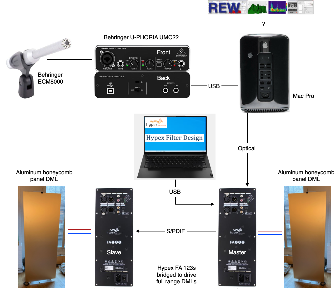

Measuring DMLs driven by Hypex plate amps
Those who have follow know that I assembled a pair of DMLs guided by the generous thought and discussion herein.
You can find discussion and pictures of the speakers over the past couple of months in the thread.
It has now come time to measure speakers.
See attached overview of what I have put together to use on this.
Equipment includes:
Behringer ECM800 microphone (mounted on a tripod)
Behringer U-PHORIA UMC22 microphone preamp connected by USB to ...
MacPro (this also serves as my music server) connected by optical audio to ...
Hypex FA123 amps (bridged teach operate in mono), which drive the ...
DMLs (w/aluminum honeycomb panels)​
Software:
REW, which I have this installed on both the Mac Pro and my Windows laptop running the ...
Hypex Filter Design app.​
The REW help files state:
"Connections
... If you are using a USB microphone you do not need to make any connections to the soundcard inputs, just connect the mic to a USB port on your computer."​
So I think I've got that part of the configuration right.
Theoretically, (I think) REW should have the ability to send signals through the Mac Pro to the FA 123s and the microphone can pick up the signal?
But, this doesn't seem to work.
Maybe some issue with the "computer audio" setup?
Thoughts and suggestions of how to go about this appreciated.

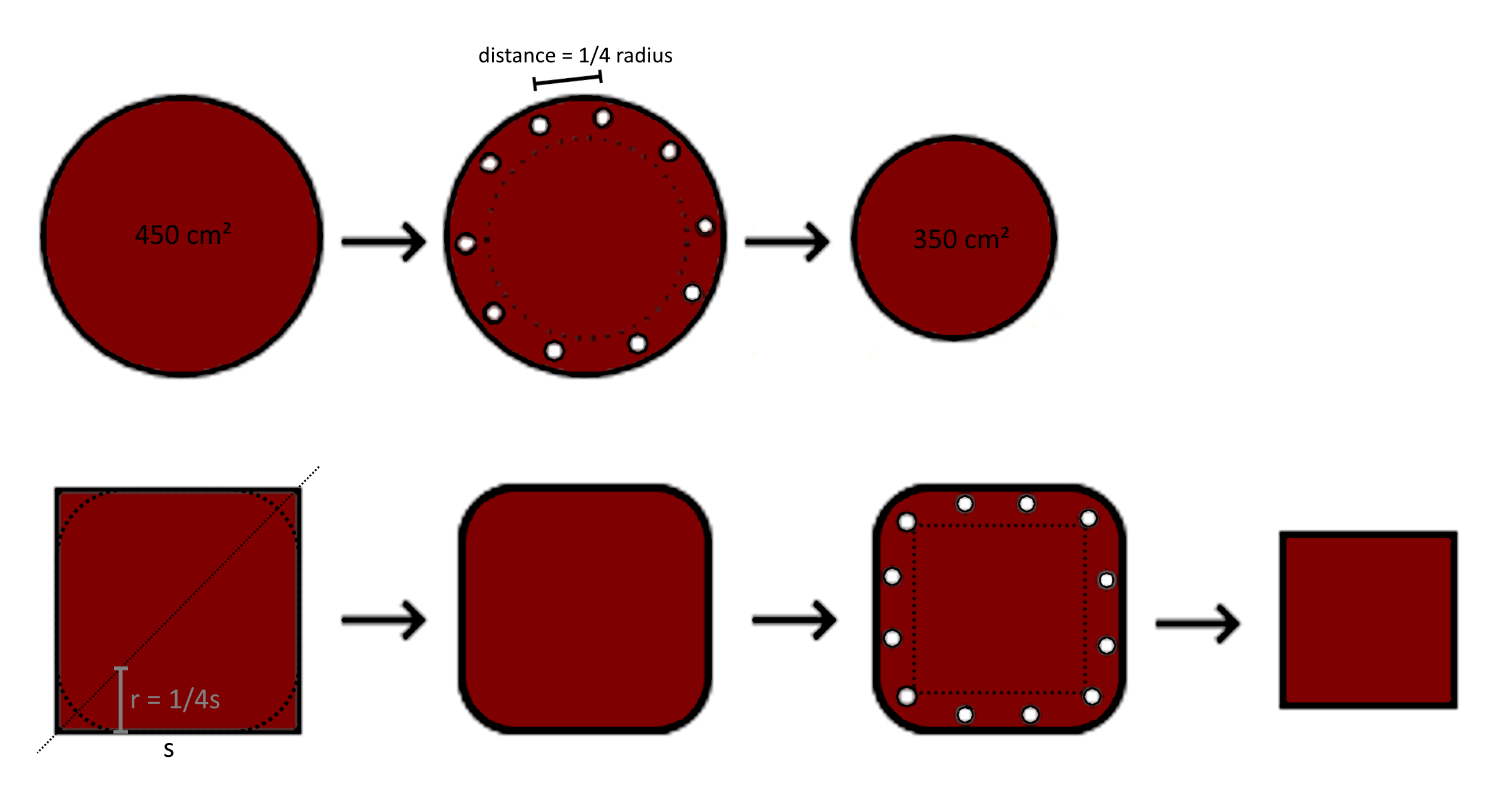

Hi fellows,
After reading through the whole thread, I am so excited to finally start my own basic testing on OffGridKindaGuy's Canvas DML Design.
I am really grateful about you guys sharing your knowledge and helping me in this process! :cheers:
Being fairly new to loudspeaker building, I am trying to come up with a test-setup that gives me a basic understanding of core principles, meaningful correlations and data.
To reduce complexity, I first just want to focus on the wooden material - birch plywood.

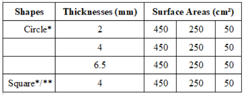

Test-Goal:
Basic understanding of the correlation of different Shapes, Thicknesses & Surface Areas of birch plywood; see table.PNG
as well as
* without & with holes (Ø 6mm, 1/4 radius-distance apart) drilled into the surface area that is to be cut off for the next surface area reduction
** square & rounded (r = 1/4 side length) corners
on SPL(@2.83V & 1m), Frequency Response, Impulse Response, Spectral Decay
Test-Assumptions:
  • SPL
    • the bigger the surface area, the more SPL
    • the thinner the plywood, the more SPL
    • circular < rectangular shape
  • Frequency Range
    • the smaller the surface area, the higher the low frequency roll-off
    • the smaller the surface area, the higher the high frequency roll-off
    • the thinner the plywood, the lower the high frequency roll-off
    • the thinner the plywood, the lower the low frequency roll-off
    • higher high frequency roll-off for rounded corner rectangles than the other shapes
  • Spectral Decay
    • the smaller the surface area, the shorter the spectral decay

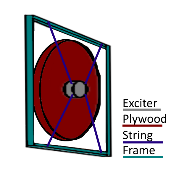

Test-Setup:
Panel: freely suspended
Exciter:
  • 'top-heavy' therefore mounted to frame with strings
  • attached dead-center onto plywood panel with adhesive tape pulled off and using superglue
  • Break-In: around 20 hours with a high-pass filter @200Hz
  • half-way between floor and ceiling to maximize the delay of 1st room reflection
Microphone: on axis to exciter location at 1m distance
Hardware-Setup:
UMIK-1 (Microphone) - Laptop (REW) - USB Audio Interface UCA222 + SPDIF Cable - Hifiberry Dac+ DSP (stacked ontop of a Raspberry Pi 3B) - Amp: Wondom AA-AB32178 - Exciters: 4* Dayton DAEX25FHE-4
REW Measurements of Exciter-Plywood Performance:
  • gated Measurements before & after Exciter Break-In on
  • SPL (@2.83V & 1m), Frequency Response, Impulse Response, Spectral Decay
What do you guys think about this setup? Anything I should change or add to it?
Regards, Bern
