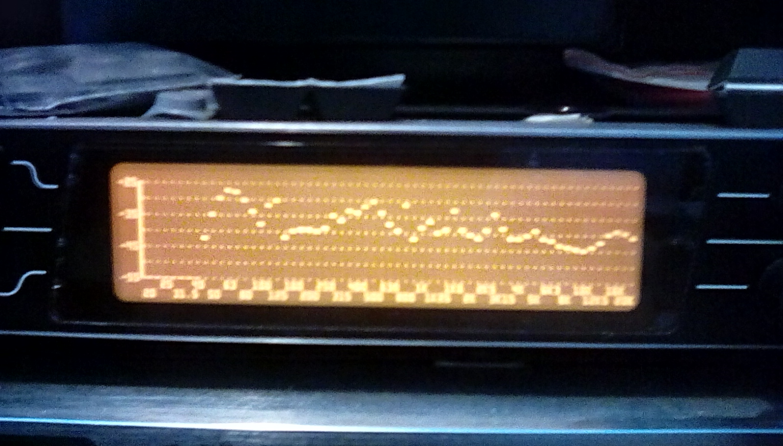

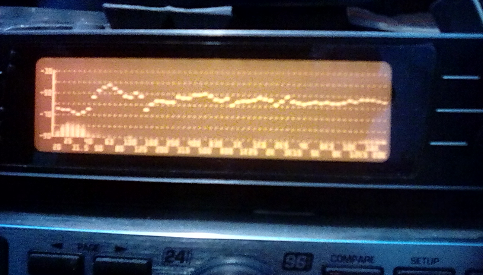

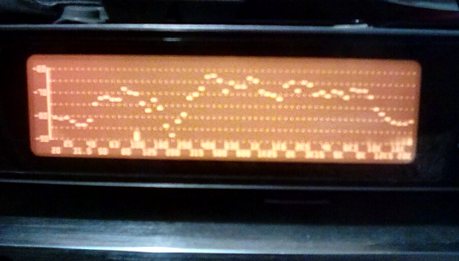

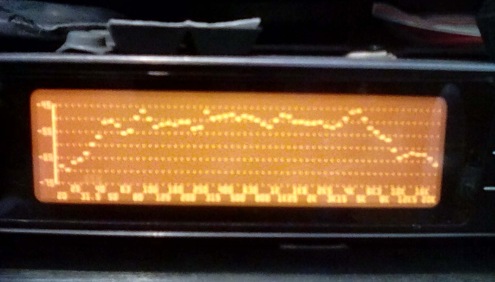

You seem to be a little concerned about the low frequency performance of the art panel,so I took some measurements of real music on peak hold to see the average responce.
Measurement at 3ft.
1 if it be your will,10db segments.
2 du hast,10db segments.
3 pink noise 20db segments ,ignore anything below the 40hz drop off,this is just road noise.
Notice no low end roll off until it reaches the 40hz or so drop off.
This fills all of the room with deep low frequencies down to the 40hz Mark,this is as loud as my IMF TLS at this frequency.
But the TLS goes all the way down to 20hz with the same power,which is nice😀
The patent mentioned going down to 20hz, but with no measurements to back this up ?
and I should mention that These measurements are all of one panel only!
It would be interesting to see if the 20hz can be reached with this type of panel.
If we take it that the response above say 500hz or whatever, is pretty much dictated by the ply panel response?
This then leaves the low end to be dictated by the canvas,so this must be optimised for the best performance,more powerful exciter? Size? Frame Rigidity? Correct tension,too much of too little?
This is where computer simulation is handy,it could take a long time to get it right otherwise.
I was just lucky with my size panel except for the CASCAMITE.
Although a little more rigidity in the canvas with some other substance could be an option?

Maybe I should have made measurements of the panel from the side or with the panel facing the wall to see how this would have affected the room response!

Yesterday I was playing around trying to tighten the art panel and my round crochet ring ,this had the affect of raising the the low end frequencies ,which is what you would expect from tightening a drum !
So maybe it is just a question of tuning the canvas like a drum to the desired low frequency ?
It would be very handy to be able to dial in and adjust this frequency as desired especially if using a sub.
Or for loss of tension over time of varying temperatures ?
These tests were me just fiddling around so don't take them too seriously,but tensioning the canvas did seem to increase the output higher up in frequency?
I suppose we are dealing with some sort of damped drum ,the damping being the ply ?
It's just a thought ?

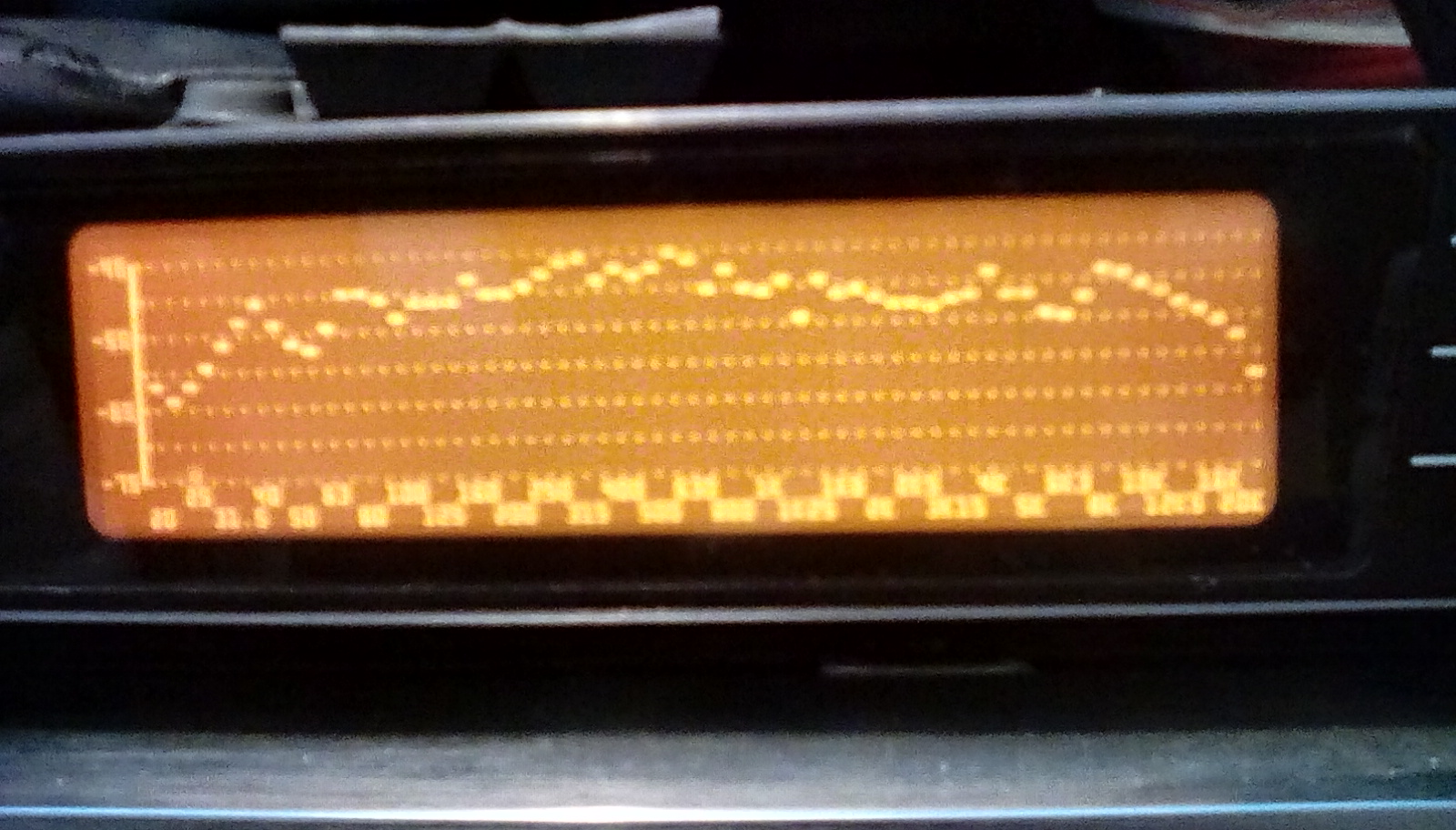

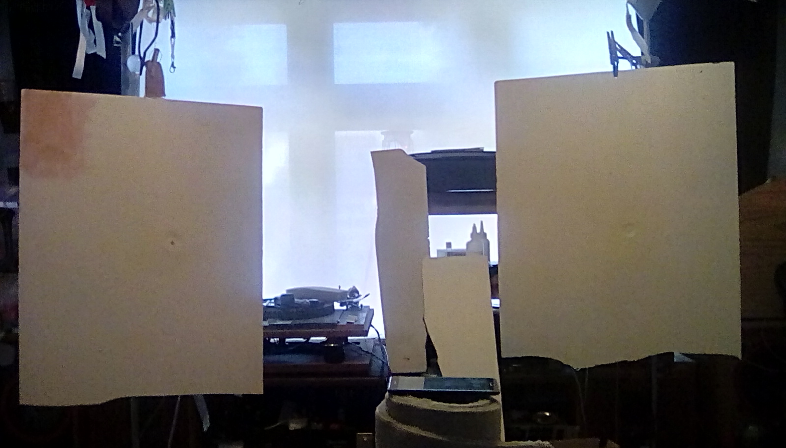

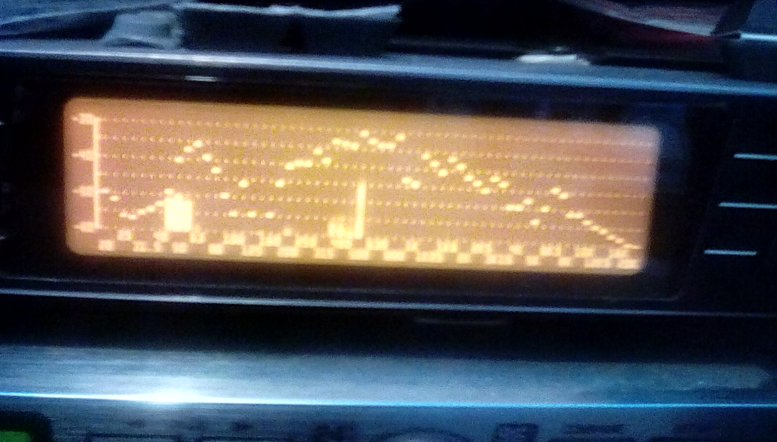

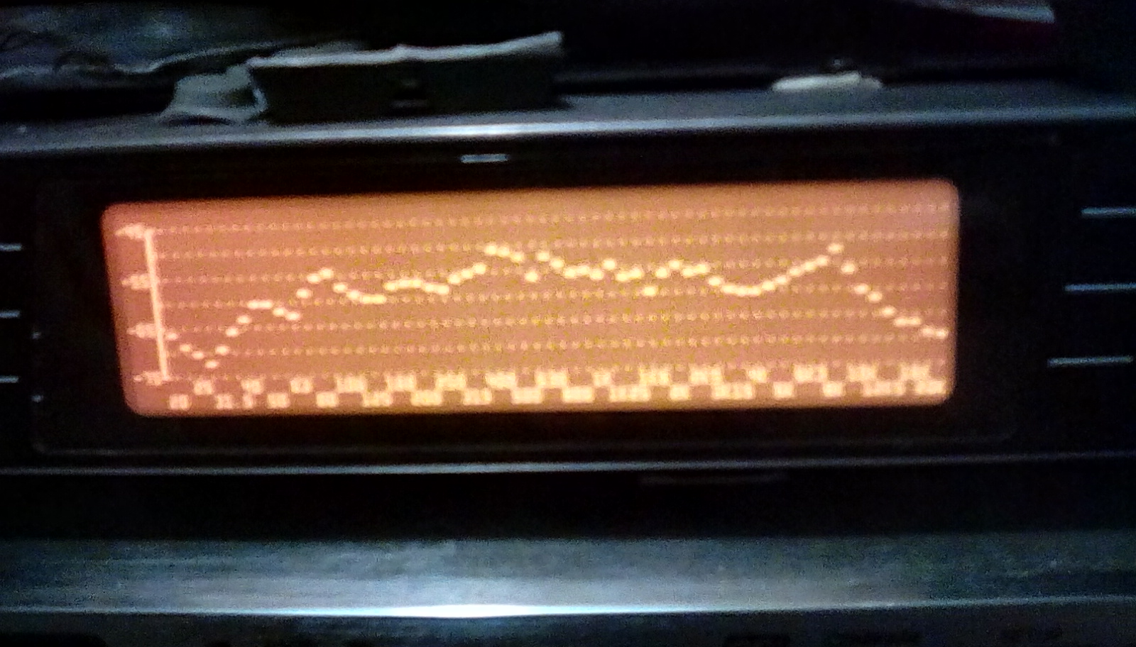

The closest I have to 1inch xps panels are my 5mm xps,these have been hiding behind some curtains in my front room for a few years now ,and it looks like someone has got a little over excited with the Hoover and broken off about 6inches off of the bottom 😱
Anyway,here is a picture of the panel and some responses.
This is a 30db window.
The first pic is the response at one ft.
The second is about 3mtrs into the room.
The third is the sorry looking panels with missing bits .
At one foot the low end looks pretty good but as you move away to about 10feet you can see the large hole in the response which can appear anywhere between about 100hz to 400hz.
This can give a strange hollow sound ,this is not a full range panel.
This panel is coated in pva and a few coats of vinyl silk paint.
They were test panels and I just kept coating them until it was too much.
So I would regard them as over damped.
I have done a recording with the panels full range but with TLS rolling off at 300hz,so the panels and the sub are running in tandem below 300hz to fill the hole in the room response.
Steve.

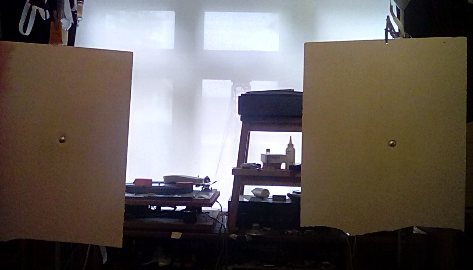

I've started to get a bit carried away again🙄
I've just added a second dome tweeter to the right panel the glue is still drying from the one I did yesterday but the hf is slowly getting much better.
The right panel tweeter is still pretty wet only about an hour after being glued,but with a little help from a hair dryer.
By tomorrow the wet tweeter should come up to the performance of the dryer tweeter,hopefully the dryer tweeter might be performing better tomorrow as well ?
The first pic is of the new domes after cutting a hole in the centre of the coil area with a Stanley knife and gluing on the domes.
Normally I'd glue the domes on to the coil foot ,but this is another one of my bodge jobs,as the panels have just about had there last tests ,I think?
Second pic is the dryer tweeter,notice the better hf.
Third is the wet tweeter.
I intend again to do a recording to show how this improves the harsh noise on vocals,and generally clean up the sound and also hopefully this will be more obvious ?
Steve
