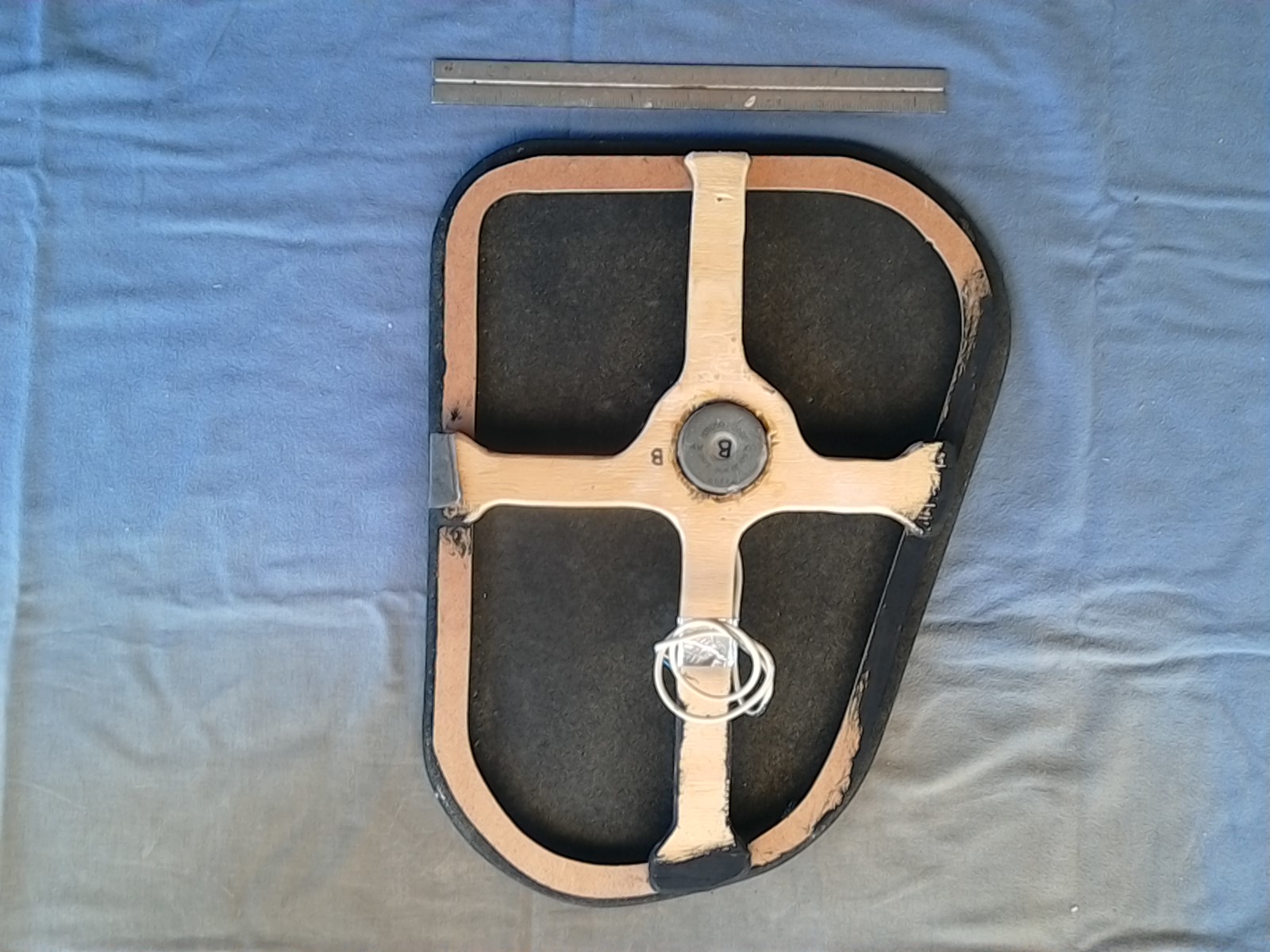

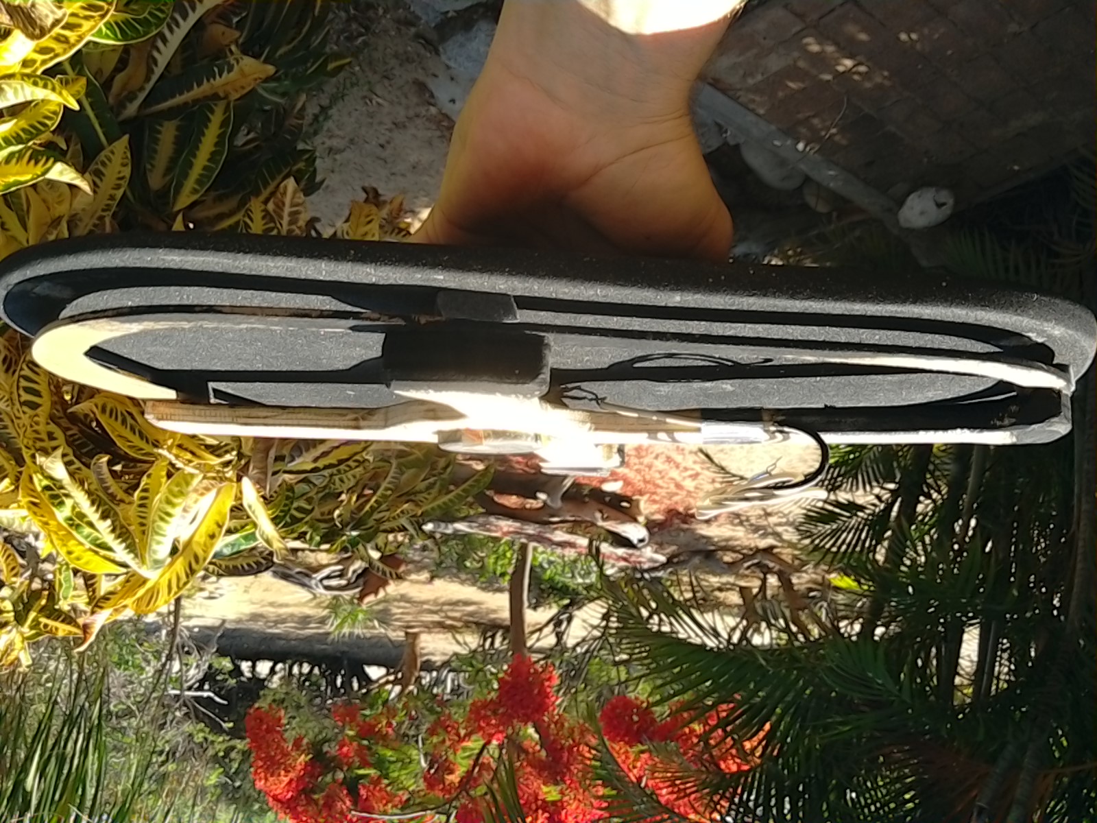

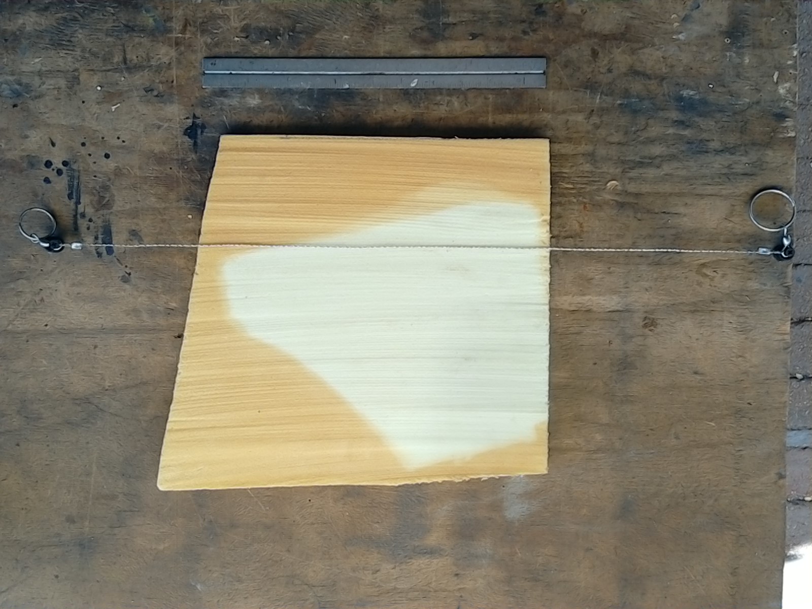

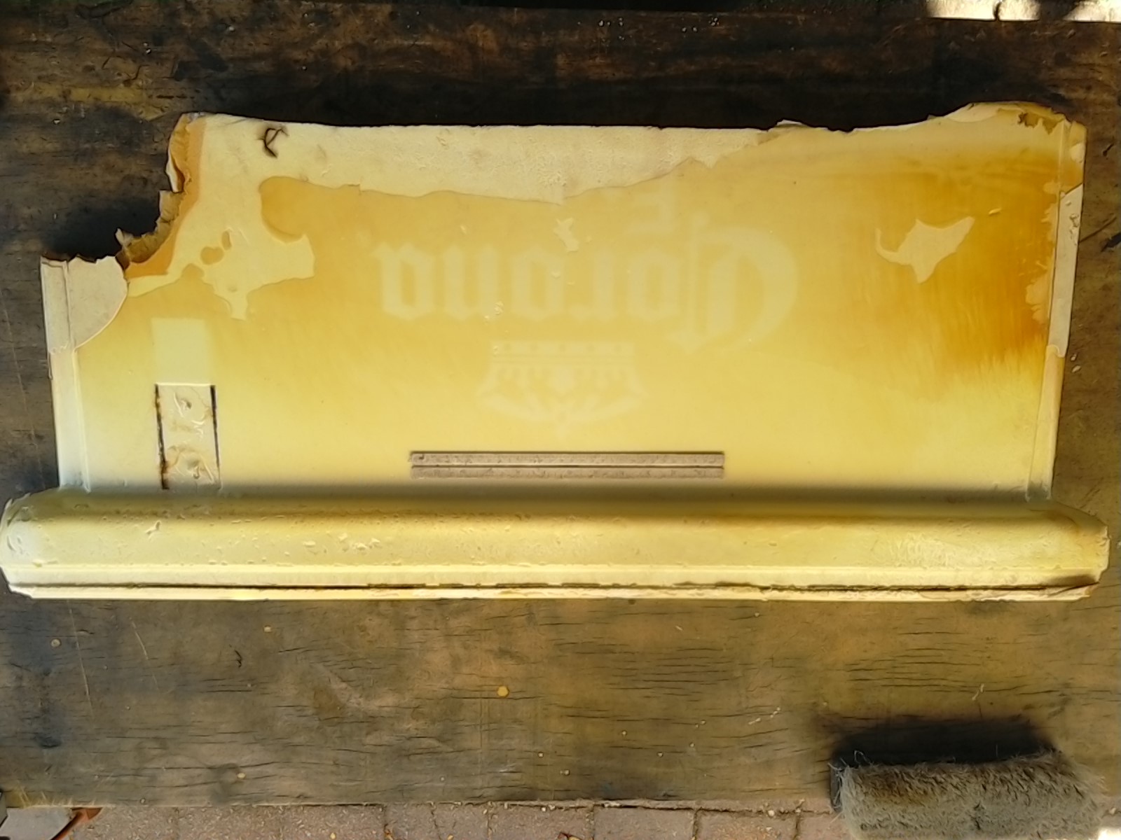

So I thought it would be a lot longer before I did anything else with these builds but one of my friends dropped off this busted up Carona beer cooler for me. Ths stuff is dense. I would say this EPS is over 1/4 more dense than what I've been using which seems by ear to correspond exactly in effeciency / dB as I'm using the same "exciters" on near the same panel size (smaller actually). Not only the volume but some crispness as well.
I'm gonna' leave these how they are until I receive some real exciters to test on them . I love the shape of these compared to the "freehand ones prior. I glued the MDF "frame" to the cross spine to have an all around dampening option if needed. My technique is to epoxy the exciter in desired spot to the panel and place the slightly bigger mounting hole in the spine centered over the exciter. I use 1" of the 3/4" thick weatherproofing foam at the cardinal points of the cross super glued top and on "sticky side" of foam to attach frame to panel. Now that they are both "free floating" I wire it to the amp and use an online tone generator through my PC and dial it in to no rattles or buzzing. I use strips of cardboard beween the exciter and spine to hold it snugly but still allowing for manipulation while doing this and simply use a few drops of super glue to fasten it when satisfied as the glue can be "broken" later if you want to remove the exciter.
As I've never used an actual "store bought" exciter yet, all of this fine tuning is probably not as crucial. These small "salvage exciters" that I'm using have to be dialed in very precicely at just the right height and uniformity to the panel or it's a s*** show.
One of the photos is of what I used to thin that thick cooler material down to a more desirable thickness. I made a few iterations out of "scrap"of a hot wire cutter but they didn't work on this super dense stuff to my satisfaction and i ended up with this wire saw doing a really nice job so long as you concentrate on keeping that material as flat on the table as possible under the super tightly strung saw. The results speak for themselves.
So there it is. I like how clean they look using the "back frame" style like this. I have these mounted at an agle off the wall with 4" of clearance at the rears, not ideal but looks great and sounds good being smaller panels and supplemental anyway. I may concave the faces of these with sandpaper from the exciters out, from really thin to existing thickness, maybe a couple of inches or so from the edges to check out what happens. I'm curious if I can regain some of the volume lost with this dense EPS, the less dense stuff's volume was a perfect match with my bookshelfs. I'll let you all know what happens cause' I know I'm gonna' do it, who am I kidding. Hope some of this helps. luego
