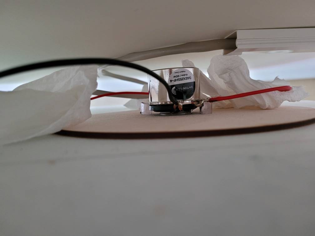

Cheapvega.
If you tilt your head to the right you have your panel hanging with a spine supporting your exciter,the exciter is glued to the wooden spine.
The wires can be firmly attached to the spine also.
Steve.
