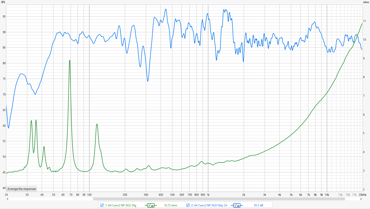

Thar doesn't seem to hold for this panel of Andre's:
f0 68Hz but full output down to 55Hz ?? What does that mean?? - was the 68Hz a spurious spike with the real f0 at 35Hz ??

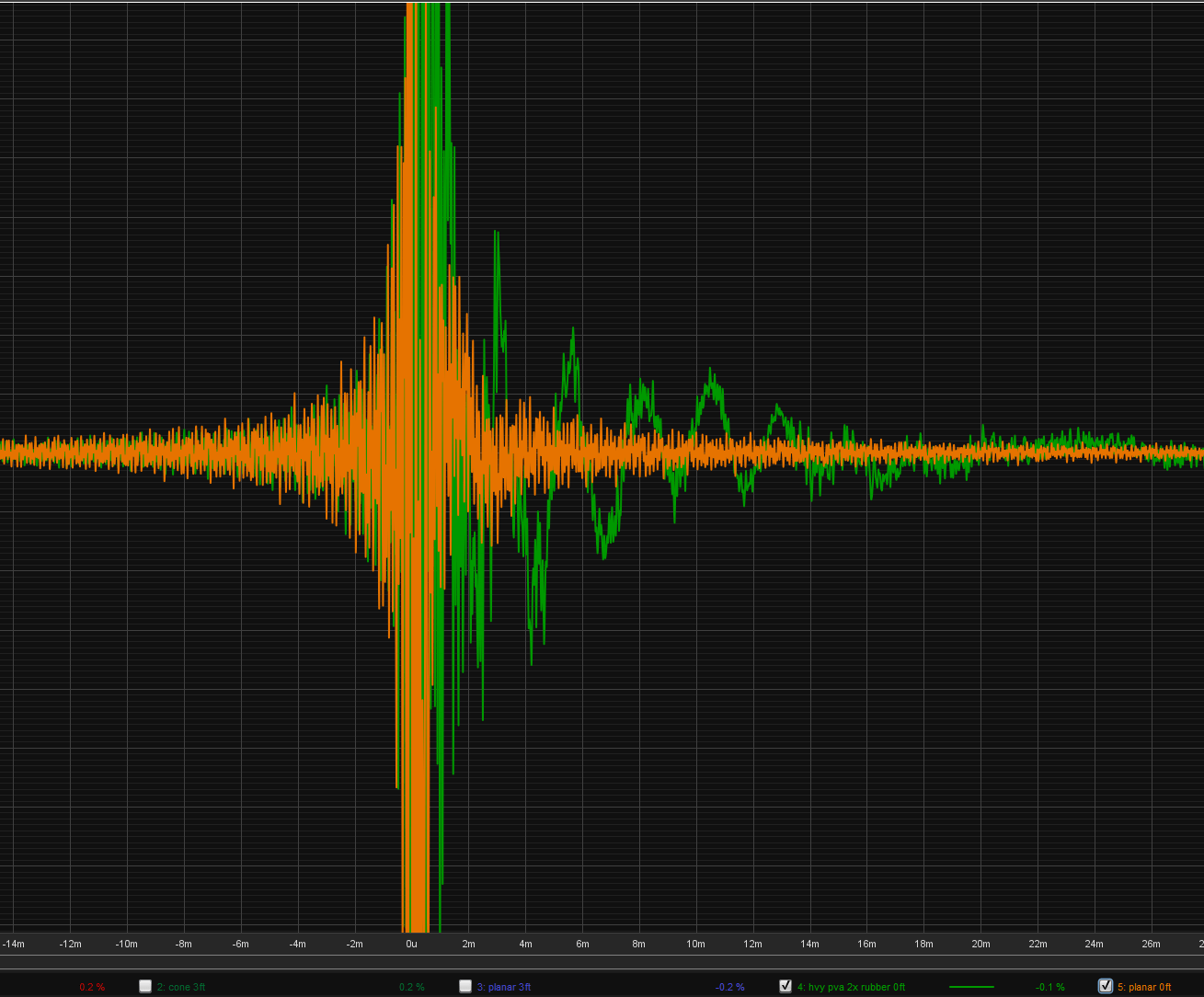

I decided to compare the heavily PVA'd XPS with 2 coats of rubber to the small planar magnetic speaker I've got tonight. My goal is to get the DML 'as good as' the planar speaker but it needs a lot of help. Here's why I've focused so much on damping:

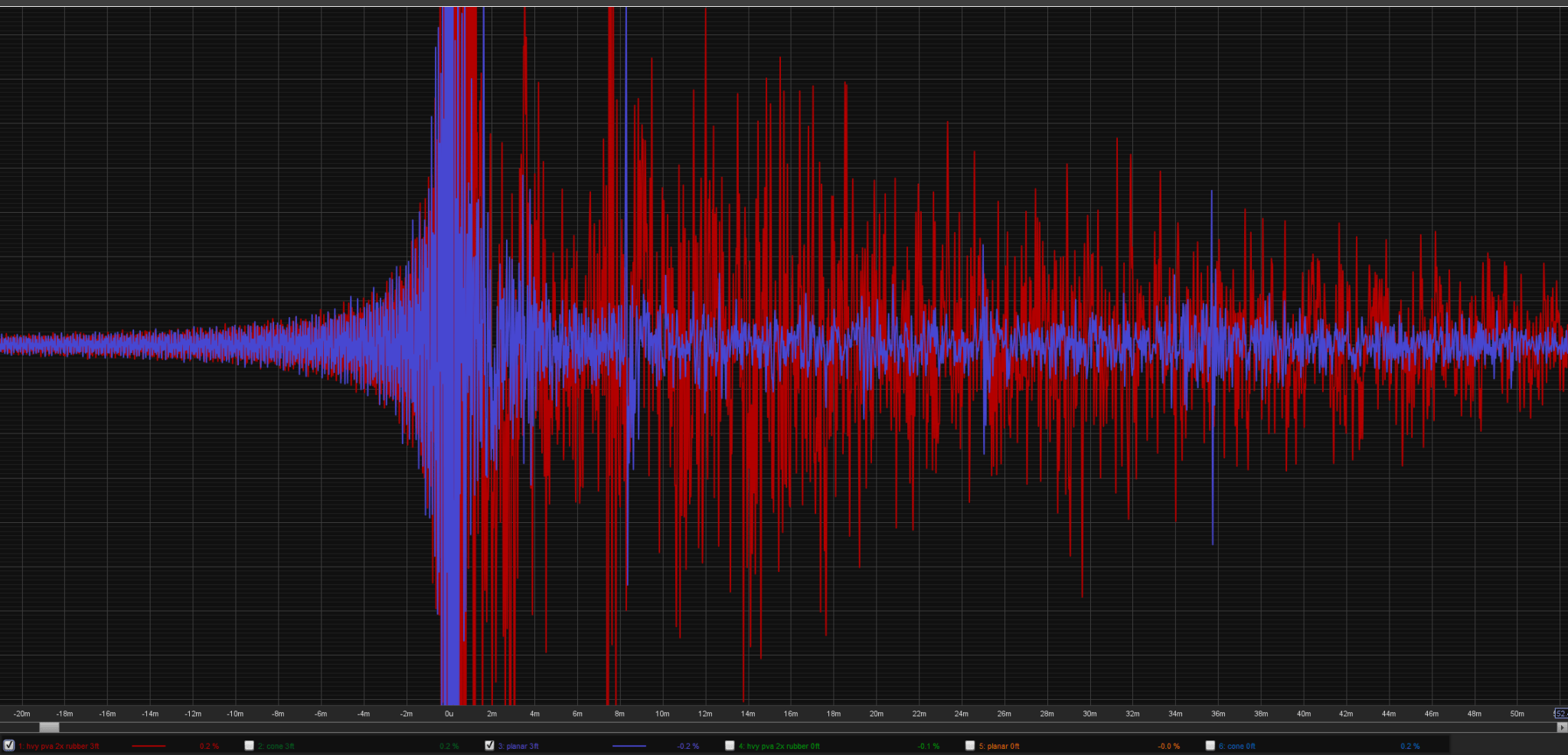

We can see there how the green DML keeps ringing for so long in this close-mic impulse overlay. This is even more wild in the 3ft measurement:

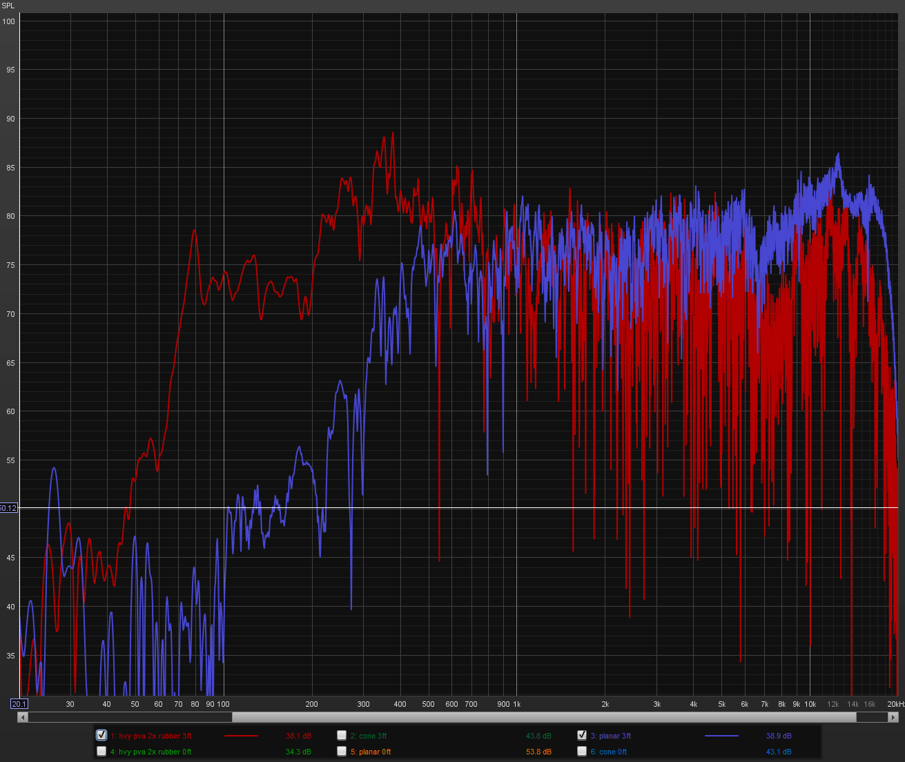

I think this is why the FR with no smoothing shows such a wild and hairy look compared to the planar:

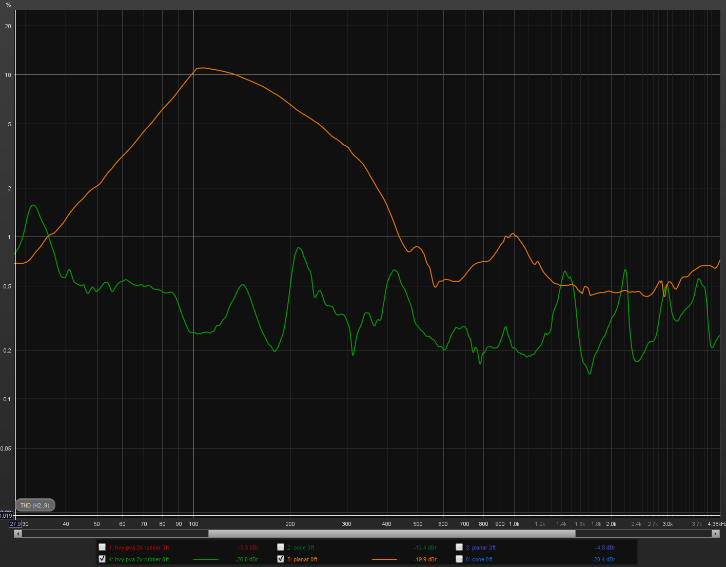

Interestingly the close-mic distortion measures better for the DML, though for the usable range I guess they're both low enough that the difference doesn't matter:

This panel already has heavy PVA and a heavy coat of rubberized undercoating and compared to many other panels it is far more damped. Even still it has a very long way to go to come close to the planar speaker. It isn't even close to the very cheap 3.5" cone speaker I tested either.

SS- Maybe re-post the FR with 1/6th octave smoothing to get a clearer picture. The human ear can't distinguish those spikes. Also look at psych smoothing-it'll make you feel better (I decided to compare the heavily PVA'd XPS with 2 coats of rubber to the small planar magnetic speaker I've got tonight. My goal is to get the DML 'as good as' the planar speaker but it needs a lot of help. Here's why I've focused so much on damping:

If I had used smoothing in that FR it wouldn't have shown the correlation between the ringing on the impulse graph and the hairy-looking nature of the FR. I believe that if the impulse response can be cleaned up to look more like the planar (or any other cone speaker) then the FR extreme swings will also be cleaned up. There will still be lumps from the modal nature of course.
I don't know if myself or anyone else can hear those unsmoothed spikes directly, but they are a sign of what is going on underneath and I believe that can be heard. Additionally that high variability could cause more intense interference issues, I suspect. In this case I am pretty sure it is ringing in the panel and that muddles the sound clarity and paints those long tails on the FR graph.
When doing A/B test between this panel and this planar I can hear a slight difference in that clarity. It isn't a huge difference that I hear, if I didn't do the A/B I wouldn't know which is which (if I ignore the planar giving a 'small' sound while DML gives 'big' sound), but when switching to planar there is a little more 'magic' to the sound which makes the tingle response come more easily. This comes from clarity, I am certain.

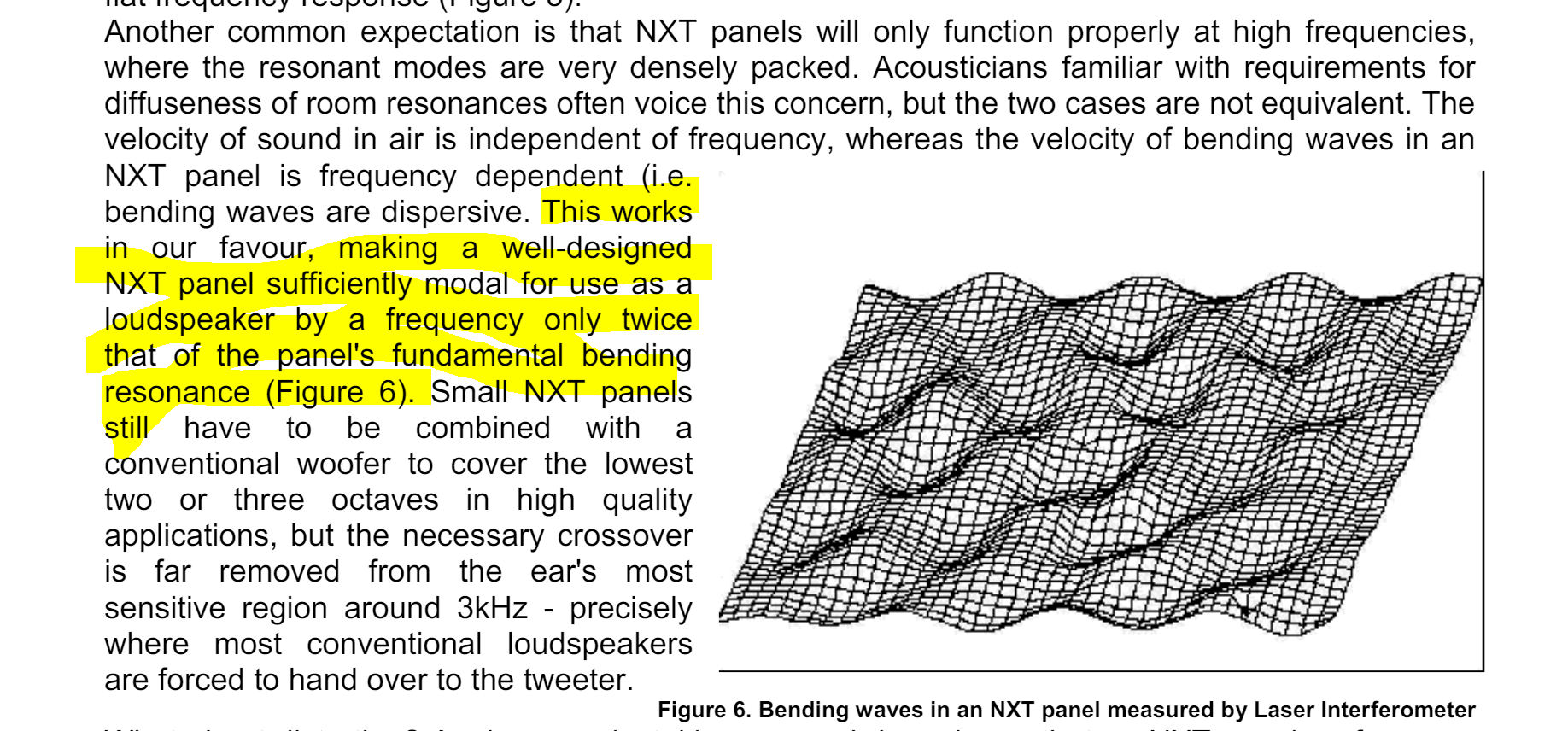

Eucy,Can we reliably say that to achieve an acceptable level of output at say 150 Hz, we need a panel with an f0 of no more than 53 Hz (or 35Hz for 100Hz ) - that's 1.5 octaves. That falls within the guide mentioned somewhere (can't remember where) of the limiting output being 2.5 times f0. Again, more testing required, but at least it's a starting point if a panel is to be crossed over for bass output.
You sent me looking for the articles where the 2.5 x fo figure was cited. I didn't find the exact one that I recall. (Christian, can you?) I'm all but certain it was from an article by Henry Azima or his group at NXT. I did find this one, by Azima himself.

From here:
https://loudmagnet.com/html/pdf/NXT Technology.pdf
I'm not sure how it went from 2x to 2.5x or the other way around, however.
My inference (which could certainly be wrong) is that the 2.5x came from the fact that for most low aspect ratio panels, the fundamental is pretty far removed (i.e. much lower than) from the next higher natural frequencies, so there is little chance of filling in the gap in between. So maybe the next higher productive mode (say the 1,3 or 3,1) is where they figured the acceptable response really started.
But what I have found is that with high aspect ratio panels (supported around the perimeter) the fundamental is close enough in frequency to the next higher natural frequencies that the good response can begin at the fundamental itself, rather than 2x or 2.5x the fundamental.
Eric
