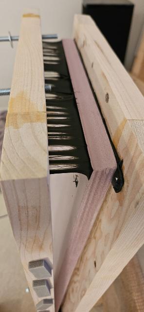

They did have Dupli-Color rubberized undercoat for $8 though and the clerk said it's basically the same as 3M so I grabbed a can. I'm sure 3M is actually better, but this is just a cheap test anyway.
<snip>
So the bond strength is interesting. The coating has a powdery feel and sometimes when it sprays out of the can it forms fine strings. It sticks pretty good to the panel and can easily withstand gentle hands, but if you drag something like a popsicle stick across the surface it will scrape up a line in the coating pretty easily. I'm wondering if it needs a hard coating on top. I tested some acrylic lacquer for compatibility and it worked on top of cured undercoating, but idk if it impacts the damping performance or not.
I still haven't done any measurements but I did take an awful panel from the past with tons of ringing and I sprayed about 10g or so of undercoat on each side and now the panel has far less ringing. I'm guessing at least 50% reduction. The coating is difficult to put on lightly and the thicker spots takes several hours in the sun to cure, so unfortunately I won't be able to do tests the same day that I apply the coating.
Oh, and of course the exciter cannot mount to this coating, I'll have to mask off the mounting area.

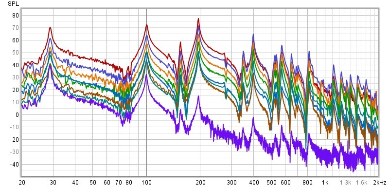

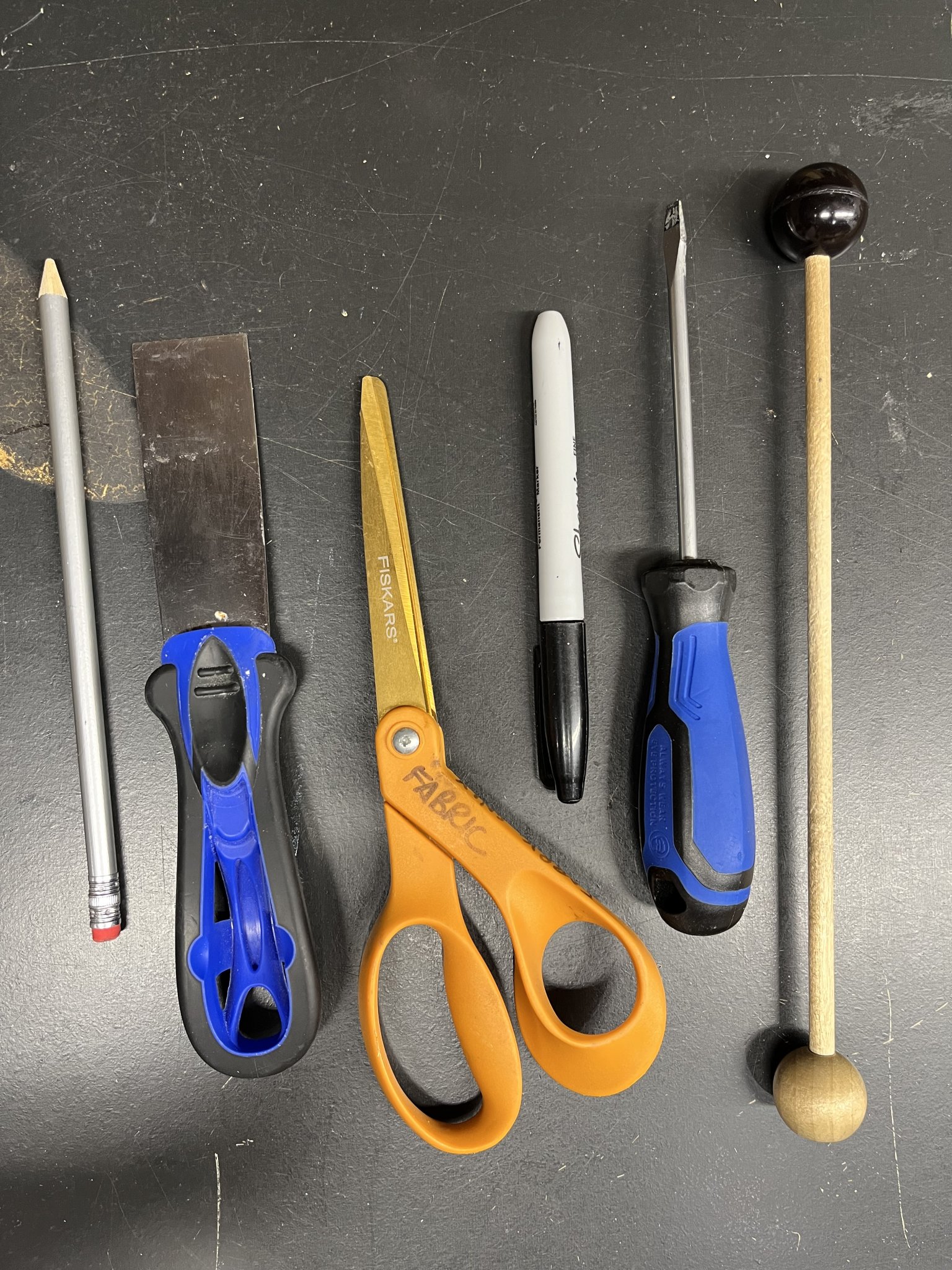

The resonant peak locations in the tap test shouldn't be inconsistent, if nothing changes in the supports, tap location, and mic location. If the peak frequencies are inconsistent, something isn't quite right. Maybe you should try something other than your finget for tapping.
I did a bunch of taps on a PS foam panel with various "tappers". The panel was suspended by two strips of painter's tape, the mic was at the center of the panel, and I tapped about 1/2" above the mic. The results, even with different tappers, were incredibly consistent (see image below). Even to some of the tiniest details like the little dip at 280 Hz (no idea what that is!). The bottom curve (purple) is my attempt with my finger as the tapper. It still shows the same peaks, but is the least clear of all the results. The image attached below shows all the different tappers I tried. For the screwdriver, scraper and scissors I tapped with the handle end. I was surpised that I found the hard, light ones to be the easiest to use (like the Sharpie Marker and pencil), particularly for the panel suspended with tape strips. The heavy and/or soft ones (especially my fingertip) transferred too much momentum to the panel and and made it swing into the mic. But the marker and pencil both worked great. The best tapping technique seems to be to hold the tapper lightly between your finger tips so it can swing freely between your fingertips just before it strikes the panel.

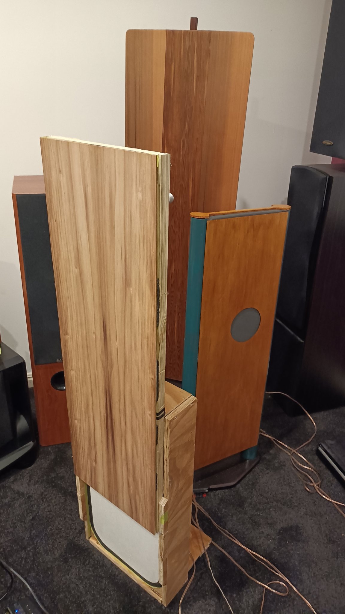

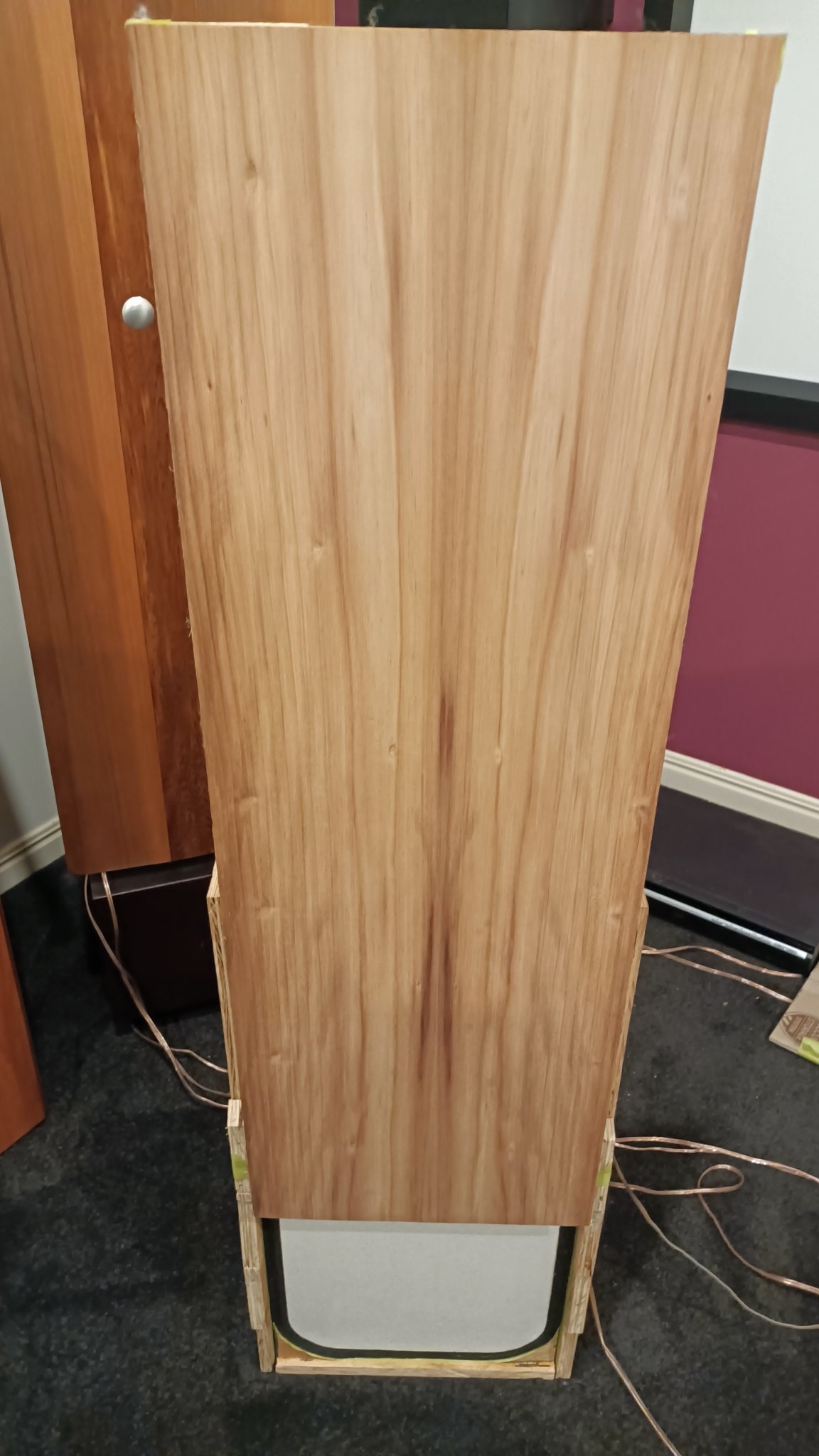

Recently, I gained access to a drum sander, so I decided to sand off the rear ply, and thin the front face slightly from each panel.
I have high hopes for this material. It is recognised as a great tonewood, which is always my main starting point. It's also attractive.
It does indeed look great! But be cautious about the sanding. Plywoods are made with symmetric structure. if you disrupt that, a panel is far more likely to bend, warp, twist etc, especially when the humidity changes.
Eric
Reactions: Eucyblues99
Thanks Eric - Yes - I'm sure it was me, but in this instance I was really only testing for damping so I was more interested in the shape of the peaks rather than their location - The marker pen/pencil is a good tip - I just need an extra set of hands 🙂
Well, actually they're asymmetric as they a 3/5/7 etc plies with the final faces longitudinal, so I now have 4 plies, 2 in each direction. But I take your point.
However, in the case of this material, there's no sign so far of a propensity to warp and it is far less 'wobbly' that poplar. An important characteristic of this timber (btw: from Tasmania, the State of my birth 👍) as well a being beautiful, it is also very hard, even though the density is only 50% more than poplar, that's why I mentioned ( I think) that it almost feels like a thin fibreglass panel in stiffness.

The natural tone I think is brighter/crisper than that of Cedar (which I like a lot), and maybe (not sure) poplar also, and although I haven't tested these panels yet due to a range of circumstances, the highs are great to my ears, and these panels by themselves do seem to have noticeable bass for their size. That may be the material and/or the mounting.
Either way it was a trial that I am very happy with so far, (although my daughter still prefers the sound of the Cedar panels seen in the background of the pics above (I admit they do sound very nice, but freely supported so the bass is not developed to full potential - I'll modify them someday) )

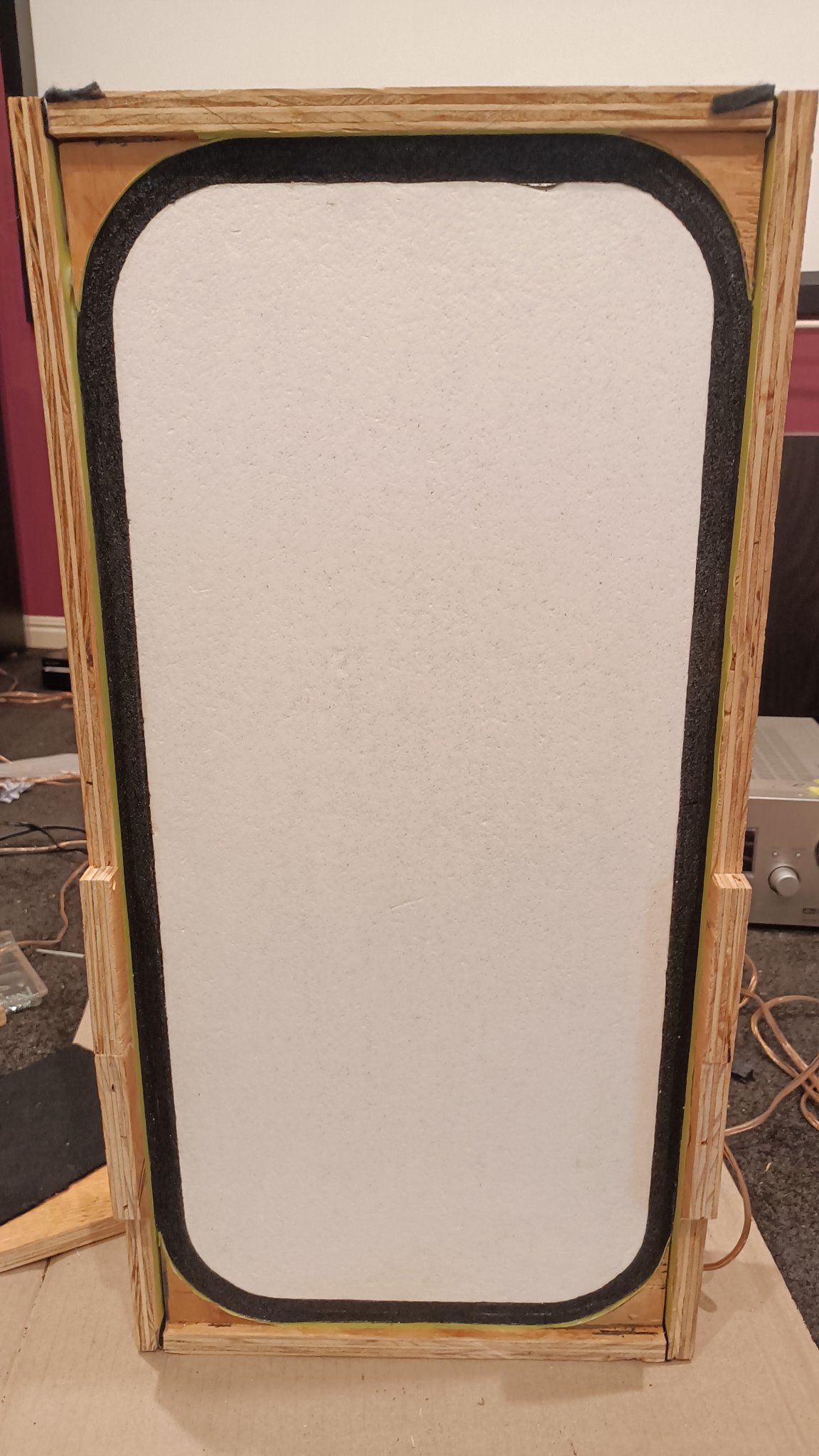

I tested the rubberized undercoat today and it gave a pretty nice improvement. Distortion was significantly flatter and lower. The Impulse EDT is lower than anything else I've tested recently. It was a medium coating so I sprayed again and am waiting for this heavy coat to dry. I'll test tomorrow and share both.
I also tested the coating on old panel that used to ring very badly and now it is actually ok. Not as good as the PVA'd panel, but went from 'garbage' to 'usable', I'd say.
I also tested the 5mm thick heavily epoxied panel today that I spoke about some days ago and it wasn't that great. Too heavy, and too floppy for its weight I think.

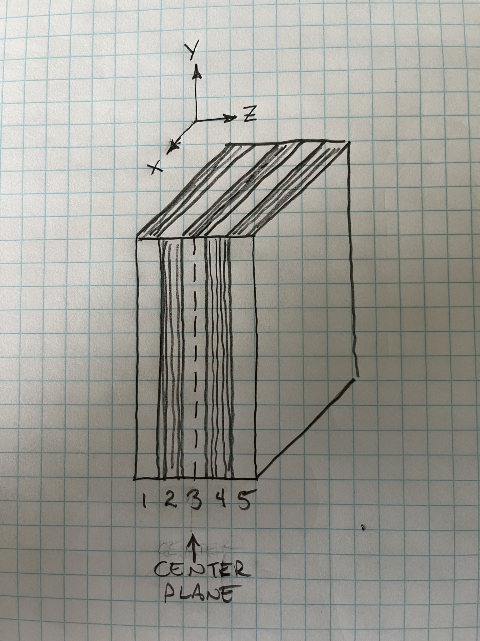

Eucy,
I'm glad they haven't warped. Let's hope they don't!
But I suspect you are thinking of a different type of symmetry than what I was referring to. I was talking about symmetry around the plane that passes though the center of the panel's thickness. The common 3 ply, 5 ply and 7 ply etc plywoods are all symmetric with respect to that plane. I suspect you are thinking about symmetry between the two axes of the plate's length and width directions. And yes, having 2 plies oriented in each of those directions would be more symmetric in that sense than having say 2 plies with grain going in one direction and 3 plies going in the perpendicular direction.
But the symmetry that you need in to best avoid warping is to have symmetry around the center of the plate's thickness. In the sketch below of the cross section of a 5 ply plate, the plies are arranged symmetrically around the center plane (dotted line). Plies 1,3, and 5 have grain running parallel to the x direction, and 2 and 4 have grain running parallel to the y direction. To have a balanced structure with the least likelihood of warping, the plies on opposite sides (say, 2 and 4 or 3 and 5) of the structure should be the same thickness, and orientation.
And conversely, pretty much the worst thing you can do, from a warping standpoint, would be a two layer structure with the grain running in perpendicular directions in the two layers. A structure like that will warp like a potato chip!
