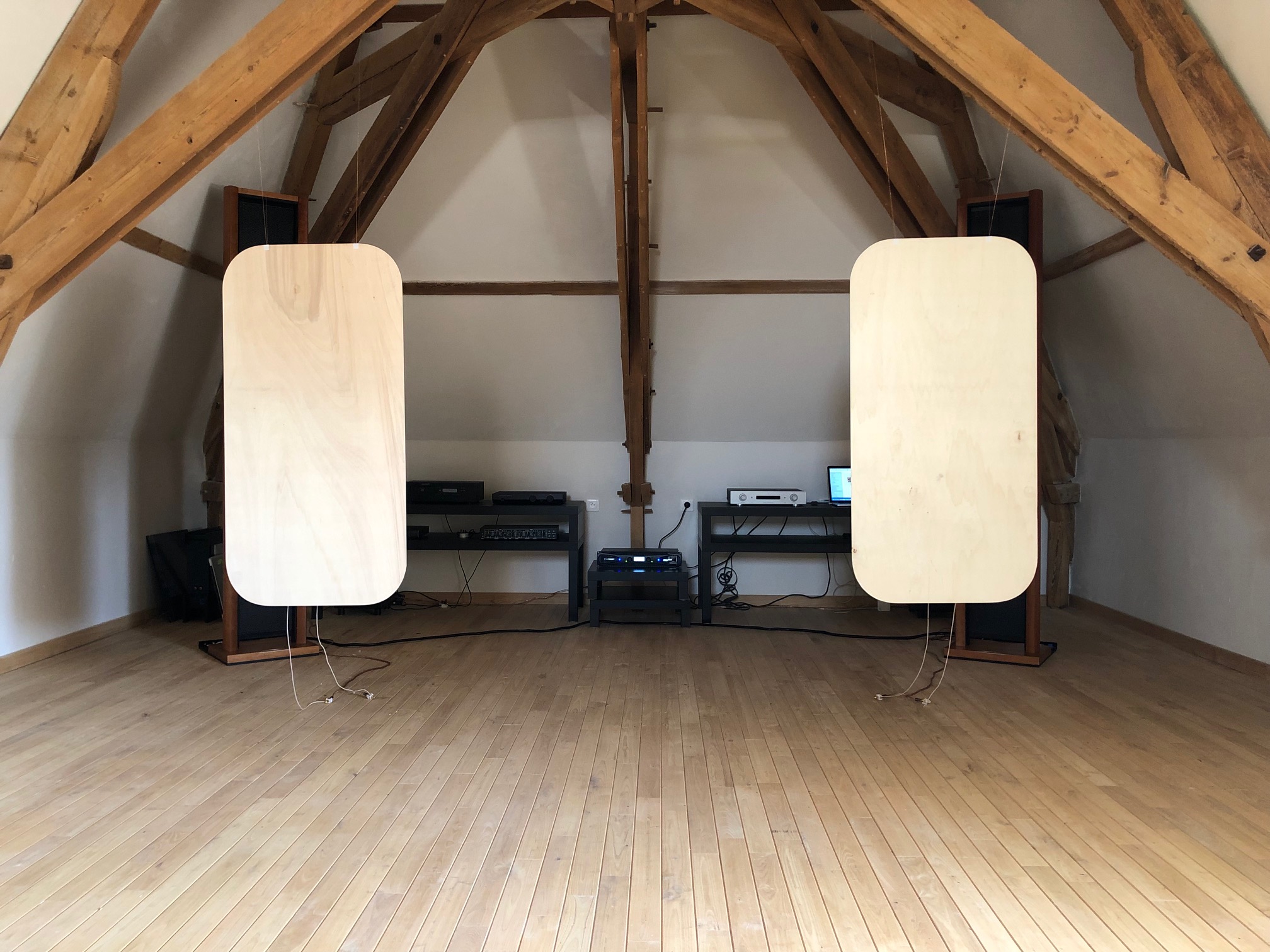

A heartfelt thanks to the pioneers in this thread, I owe you! My electrostatics never recovered from the move to France and I after days of diagnostics it appears I have a major panel rebuild before me. As that means yet more time without sounds I thought why not give these DML panels a try.
I read through this thread, which took some time, then threw together a couple of panels made from some cheap thin ply from the local DIY store. I used Dayton DAE32EP-4 Exciters and hooked it all up in the approved fashion.
Total cost 67 Euro and about two hours work. Not expecting much but needing some music I gave them a whirl.
Bloody hellfire!
First record was Vaughn William’s ‘A Lark Ascending’ by The Academy of St Martins in the Field. What a wonderful presentation. It’s a very distinctive soundstage but utterly convincing. I had read the descriptions of ‘being there in the room’ but I have heard that so many times before I had discounted the claims. Wrong! What a strange experience. The walls to the listening room have simply gone and you can literally walk into the soundstage, something I have never experienced before.
Next up was ‘A Walk in the Wild Side’ by some bloke called Lou Reed. Oh my days what fun! I am there in a NewYork club sitting a couple of tables back. When the Coloured girls did their thing I burst out laughing.
Then there’s the timbre of instruments. I have never, ever in all my days heard such a realistic piano sound, ever. Nor have I heard the accidental tap of a bow on a music stand in the middle of a violin concerto before, not like that, no so clearly defined it stood out against the music, a tiny but distinctive error.
There are a few things that I need to think about. Some recordings sound like a transistor radio, some sound utterly perfect, incomprehensible so considering the tiny outlay. I am going to have to do a deep edit on my collection. And it’s not just classical, jazz V rock. As I write this Lana Del Rey has begun ‘ Born to Die’ and it is ravishing.
I also think they need help from some decent subs but those subs are going to need to be very good to keep up with the quality. Both problems are very minor.
So I just wanted to say thank you to all the pioneers who have kept the flame burning for this extraordinary technology. Might be a long time before those panels get rebuilt. Might use the frames for something else. Colour me amazed.

Here are the panels with the ESL's sulking in the background.
