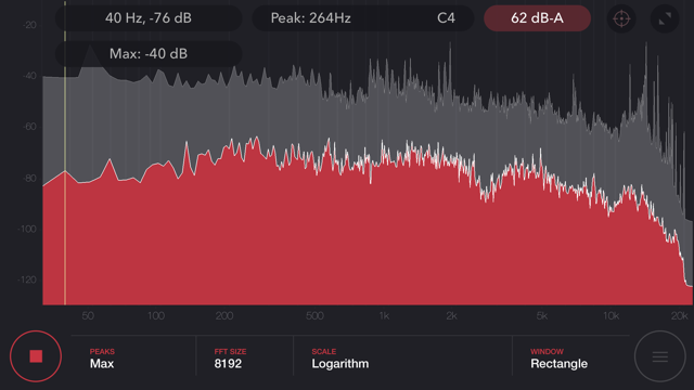

I promised some feedback on frequency response of the cheap as chips panels I threw together last week.
I have attached an image on the overall spectrum made using an online white noise generator below.
Several notes of caution on the image.
Firstly it’s recorded on an iPhone using an app called dB meter. As the iPhone microphone has a limited response below 250hz by design please ignore the spectrum below this.
I recorded the white noise at a distance of one meter from the panel but make no claim for huge accuracy, it’s just a quick and dirty look see with what I have to hand.
There is an obvious dip at around 3k. From this point there is a gentle falling response out to around 18k after which it falls off a cliff.
After that I used an online frequency generator to test the audible range I can hear from the panel. More caution. I am not able to hear much above 12k these days and yes, that’s exactly what I got. Blame me, not the panels.
The bottom end was more interesting. These panels definitely reach down to 50hz but there wasn’t much below that. This is not as deep as I ‘thought’ I heard, e.g. a Low E from an open bass string was heard, but that might have been the ‘missing fundamental’ effect in action.
So maybe I need that subwoofer, be it a big panel or a decent box.
In the meantime Dire Straights 'Alchemy' is playing and I am at a rock concert. Fabulous sound.
