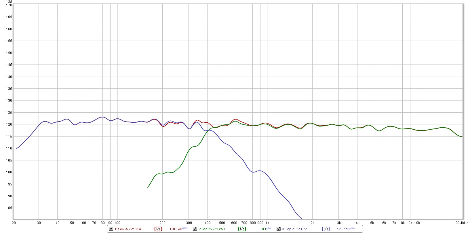

And hereby hangs a question. When mounted on my 600mm high OB bass L frames, the overall height is a bit on the low side. So this got me thinking. 2 x 300x400 panels in landscape orientation, one above the other with the 4 ohm exciters wired in series may result in some mutual coupling benefits in the midrange. My understanding is that mutual coupling tends to benefit the bass more than the treble, but there could still be some benefits from having double the power handling per side. Obviously 8 ohm exciters wired in parallel would give more welly potential.
Anyway, back to my canvas panels with ply insert. Here is a plot showing the bass unit with 24db LR low pass filter, 300x400mm canvas panel (£6 exciter) in landscape orientation with 24db LR high pass filter plus the combined response. Not too shabby at all.

So far, these are giving me the best performance of the exciters I've tried. At around £12 a pair, I can afford to experiment.
Are we talking passive or active crossovers? At that 24dB rate there should be phase issues.
Calmart
I use active crossovers - a miniDSP HD. An LR24 XO is in-phase. I use the miniDSP for EQ too. The amp setup is a pair of TPA3255 modules, one per side. Each side is split between bass & DML. So it's a true 'dual monobloc' type setup.

I never use eq ?
3rd or 4th order eq ? Do you mean crossover.
I usually allow the panels to go as low as possible depending on the panel but no lower than about 80hz.
But practically always I roll off the bass unit above 300hz to help sort out room problems (suckouts )
With The art ply panel,I would treat it as a fullrange speaker and put a sharp roll off below 40hz to prevent any large unecessary movement as the response of the panel drops like a stone below this.
Rolling off the art ply panel higher up would increase the power handling and benefit from a dedicated sub.
Steve.

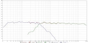

Lordtarquins post 3836 shows 2 plots the one on the left is without eq ,which is a pretty decent response.
I probably wouldn't bother to eq this.
But if I did I would probably just put in a little slope from abut 500hz to about 3.5k , this would keep the response almost within a 5db band up to about 18k .
