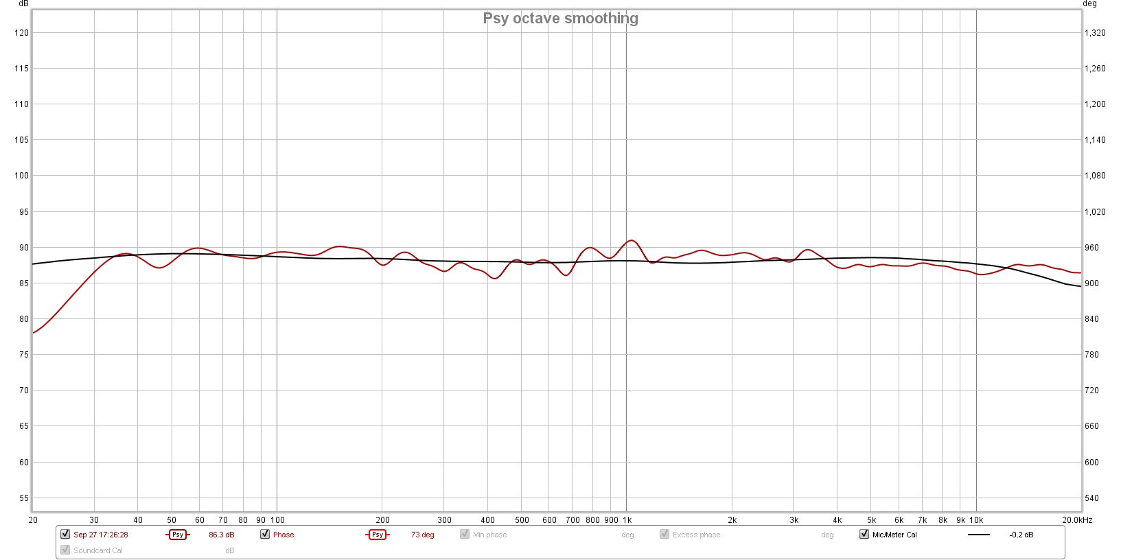

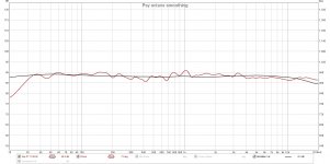

Like you, I went down the minimalist route before finding out about DMLs. I had a pair of Allison 6 omnis with upgraded bass driver. The bass driver ran with no crossover at all, and the tweeter had a 1st order roll-off with a single cap and one resistor. Whilst it avoided the 'point and squirt' effect of traditional box speakers, and loaded the room in a different way, they still didn't quite deliver what I was looking for. I've even played with single full range driver speakers (I have a DIY pair as my rear surrounds in my TV system).
With respect to EQ, as I use active crossovers via the miniDSP, there is little to be lost by using active EQ in my case. I listen to a wide variety of music. In particular, I listen to quite a bit of classical music. I find that this tends to be more demanding of tonal accuracy than some other genres.
As Steve mentioned, the response from my cheap £12 a pair exciters on canvas panels was pretty good, and you could probably get away without any EQ. I'll be trying out a slightly different version of the 40x30cm canvas panels later today. These have 10x15cm ultra high density EPS in the middle instead of the 3mm ply. My expectation is that the top end may be a little better and needing less EQ, but that's only a guess.
What I can say, however, that listening briefly yesterday, the OB bass unit plus canvas panels were sounding very good indeed. The room response needs tweaking a bit perhaps, possibly in the upper bass / lower midrange area where there's a bit of a response dip that results in a slight lack of 'body' at times. When listening to it, it's also a bit 'hot' in the upper mids / lower treble and this seems to be accurately reflected in the attached frequency plot (psychoacoustic smoothing).

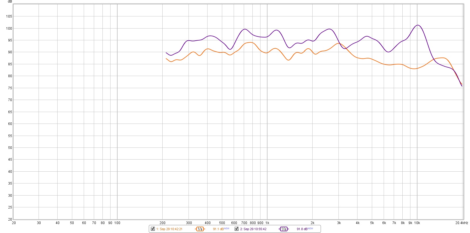

Canvas panels: Plywood vs EPS Inserts
I have now been able to compare 3mm poplar plywood and 10mm ultra high density EPS when used as a 10x15cm mini panel glued to the centre of a 30x40cm art canvas panel.
I've attached the plot. The highlights are that the EPS mini panel is about 5db more efficient, that falloff at 20khz is the same, and that the EPS is a bit choppier but with more output particularly from 3.5khz to 12khz. The EPS looks a bit easier to EQ should one wish to do so.
The orange line is the ply, the purple is the EPS.
The frequency sweep below 300hz sounds pretty ropey, with quite a lot of unpleasant flapping and buzzing. I need to investigate the cause.
Lord, maybe the panels need edge bracing? That may be why canvas panels are able to go low.
I have more Aiyimas and some 18x24 panels on the way to test that out. I am no acoustic expert but my gut says fixed edges help retain low frequency energy.
CV
These are the canvas panels with ply inserts. I'm wondering if the canvas is a bit on the loose side. I have some butyl rubber that I may try rolling into thin worms and then ramming them between frame and canvas right at the point where they meet.
I'll try to find the source of the problem. Too busy listening to different bits of music now!
