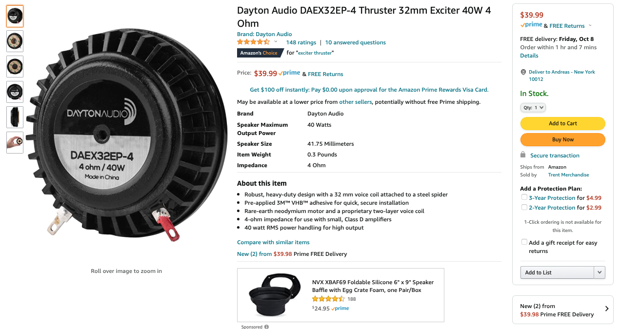

Dayton Audio DAEX32EP-4 Thruster 32mm Exciter 40W 4 Ohm currently listed on Amazon (see attached screen shot) @ $39.99 each (nearly double the PartsExpress price.
Also see: Amazon page
Amazon "promises" rapid delivery (by Friday 8 Oct with Prime Delivery).
Distributor some company called "Trent Merchandise" out of Texas.
Seems like someone scooped up some Thrusters and now sells them at a substantial mark-up.
I ordered some as PartsExpress lists them as backordered with expected delivery around 19 November.
Seems a bit dodgy.
I'll report as to whether they actually deliver them.
-- Andreas
