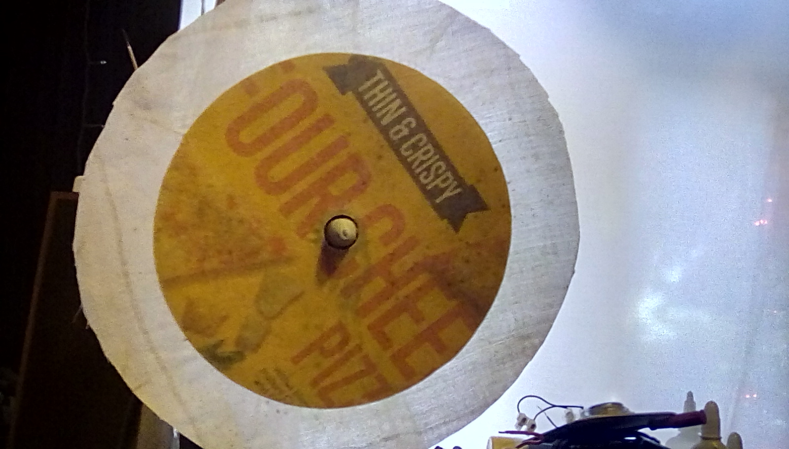

The card and epoxy still isn't stiff enough to produce stronger LF to drive The room but is ok ish for near field listening.
Maybe the epoxy will go harder over time ? But I suspect not.
I will have to do some listening with the panel rolling off at about 150hz or so to assess the sound in room , from my now crowded cupboard !

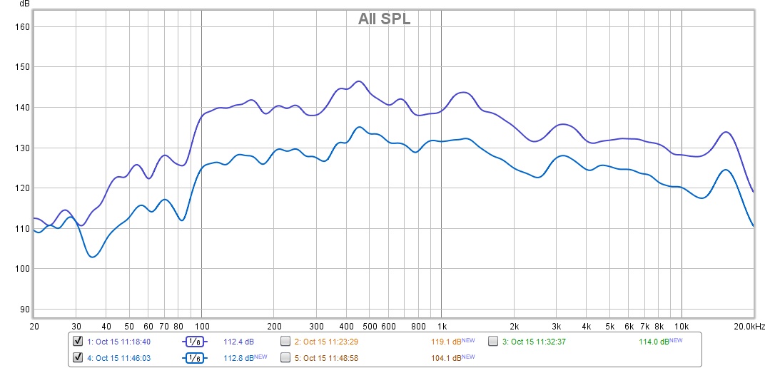

First measurements on my AV DMLs with dual center exciters
See attached screen shot.
Followers of my recent posts will remember, I've begun experimenting with two exciters on each panel. One exciter produces the respective left or right channel and the other produces center channel information (a "dual center channel" as per the Magnepan idea I discussed earlier).
The upper curve (darker blue) shows (on each channel) th left or right feed + dual center feed configuration.
The lower curve (teal) shows each of the pair of exciters playing full range (no dedicated center channel information). Each exciter has a dedicated amplification channel.
The shape of the curves looks pretty similar, but that would make sense given that center channel often just mixes the stereo channels and that (if memory serves) REW just plays the same thing out of each speaker when it does a sweep.
I can't account for the difference in dBs between the curves. All the REW settings remained the same during the measurements. The microphone (UMIK-1) stayed in the same place too.
Looks like everything between 90Hz and 10KHz falls with a 15 dB range.
Listening to actual music, both configurations sound compelling and engage me with music. They both have great soundstage and "air".
I might prefer the dual center configuration, but recognize I might have some confirmation bias ;-)
That said, I won't listen to music on this AV system. I've begun experimenting with this dual center channel approach to better hear dialog and other movie center channel information.
I've done nothing yet to address room acoustics.
I do have a miniDSP SHD that I can plug in and use to develop some room tuning with DIRAC Live that I can then manually implement in the AV DSP.
Any thoughts and guidance appreciated.

aagas.
It depends on how the signals are processed.
Is the processor in the computer or part of the minidsp ?
Does it process the all 4 channels of does it just add a third hafler channel ?
It would seem something is going on as you are applying a mono signal to all channels I presume ?
Steve.

Steve -
I currently have optical from my smart TV to the miniDSP SHD, which then:
See above.
To generate the sweep, REW either sends either the left or right signal to both speakers or a synthesized left + right signal.
- Andreas

Steve,
In reverse order...
For clarity, I don't have any "surround channels" -- no speakers to the sides, back, or above the listeners. No subwoofers yet either.
I only have the pair of plexiglass panels, with 2 exciters on each producing (well intending to produce):
Does this "...improve the intelligibility on the center channel..."?
It varies greatly vis-a-vis source material.

So how does It sound on movie soundtracks ?
Does it improve intelligibility on the centre channel without affecting the surround channels ?

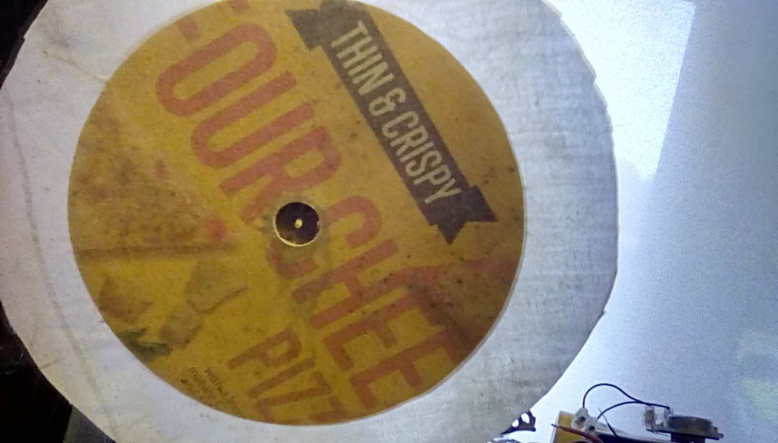

I ment to photo the phase plug before I cut the panel out of the hoop.
I want this exciter to go on my 5mm x600x380mm xps test panel, so I'm cutting it down slowly to see how it affects the performance.
The phase plug is just some rolled up blu-tack, it's just another way to prevent the cavity resonance in the vocal range .
I have seen designs with out the phase plug as in the second picture.
Steve.
