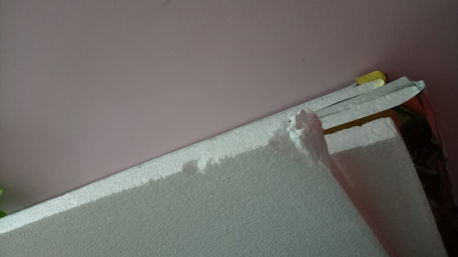

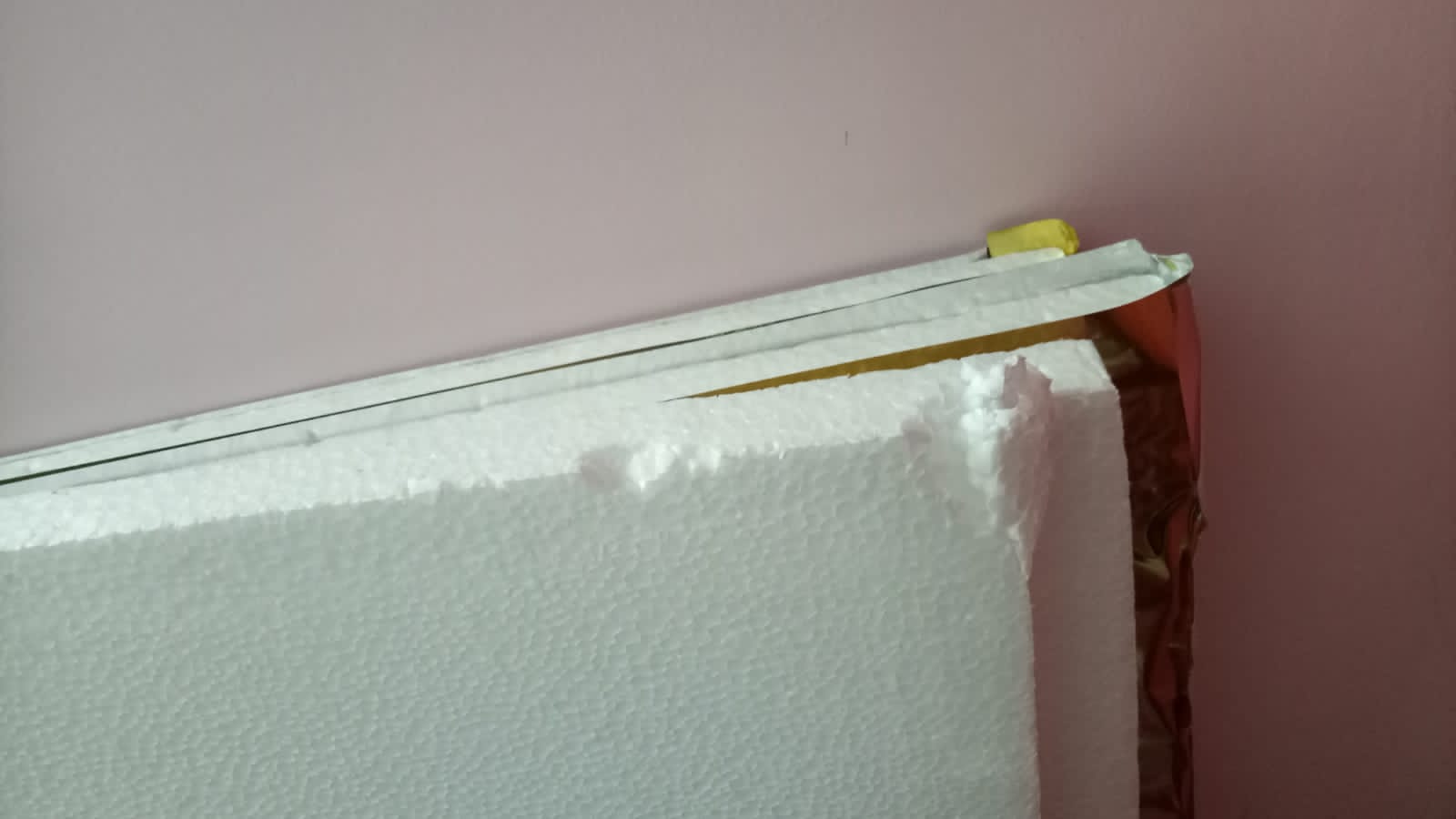

Is EPS sheet is same as thermocol sheets as shown in the attached pictures. These thermocol sheets are very light in weight and very fragile, and thickness of around 1cm.
If we need to experiment by putting exciters on different panels or different position on same panel , how to attach and remove without effecting the exciter and the panel material.
