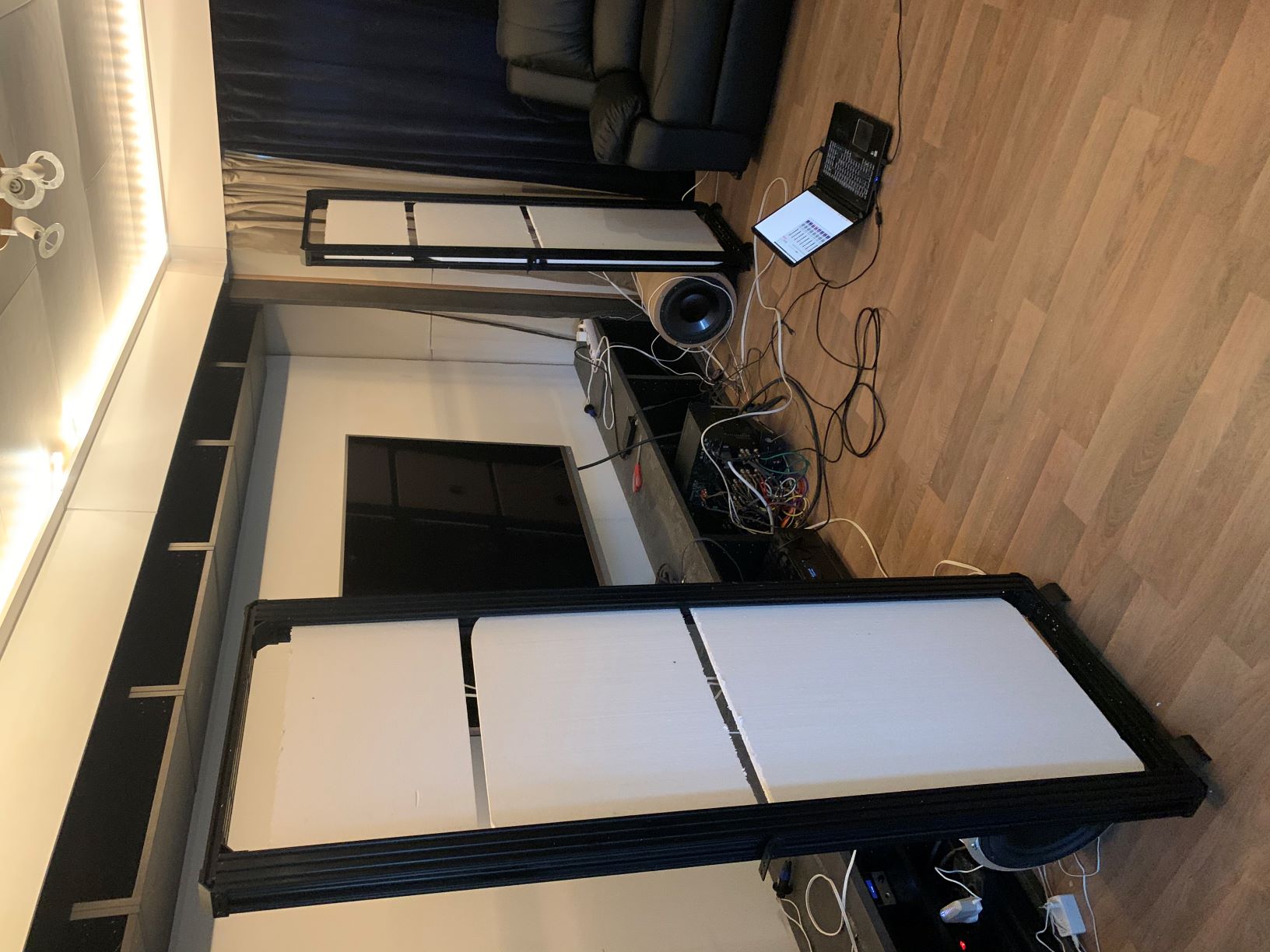

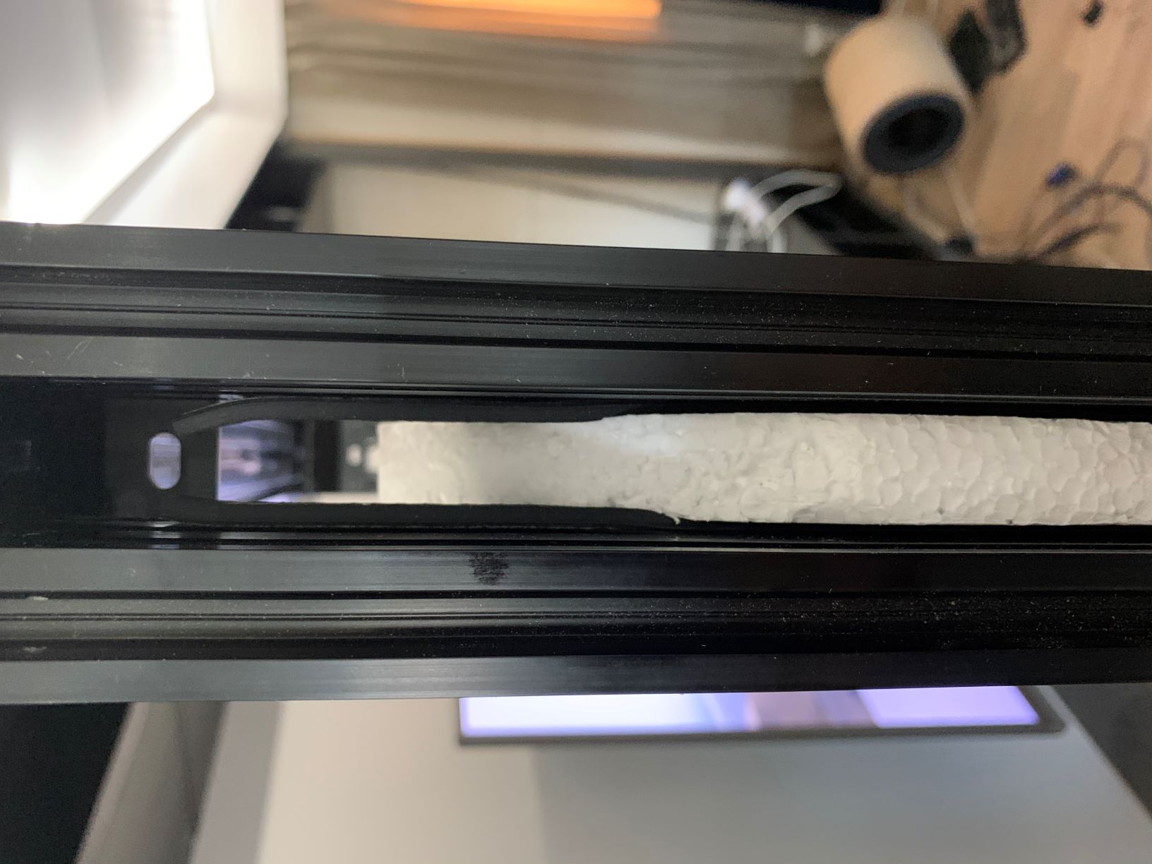

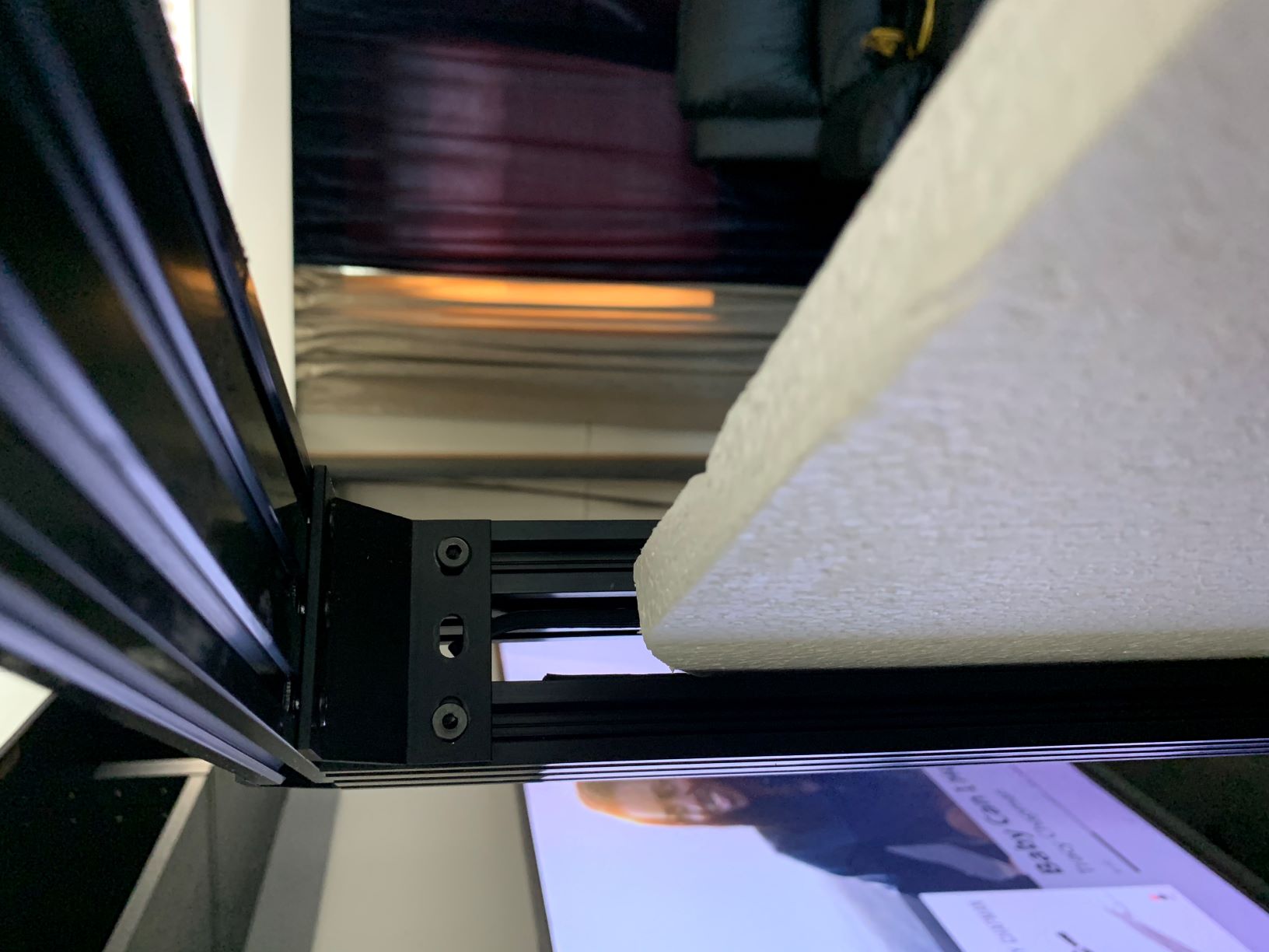

I attach some pictures of my current DML project. I use 3 separate panels with one exciter on each panel for each stereo channel. Sandwiched between two extruded aluminum profiles.
The picture is not up to date, now all 3 panels are of equal size. And there is also a frame around each of the 3 panels.
I have a crossover at 120Hz to my subs
