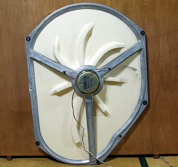

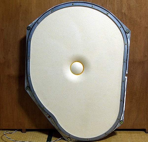

Hi, everyone. I want to start by thanking you all for everything you give back to the community. Anyone heard about the Yamaha JA-6001? Big Styrofoam speakers from the 70's. Chasing the dml Holly Grail I got interested in this speakers and managed to get a smaller version of this ones. They sound amazing taking into consideration my equipment. If enough interst I might take them apart and post some detailed pictures of my witch I belive has the JA-3502 driver. I just ordered some exciters to try and make something similar to the Yamaha but with the dayton audio exciters. Oh the ja-6001 is big: 880 x 640 x 180 mm / 34.6 x 25.2 x 7.1 inch.
Sorry if I went off the tracks but I thought it was strange nobody brought this type of speakers into discussion.
Hope It works 🤔 and helps😁

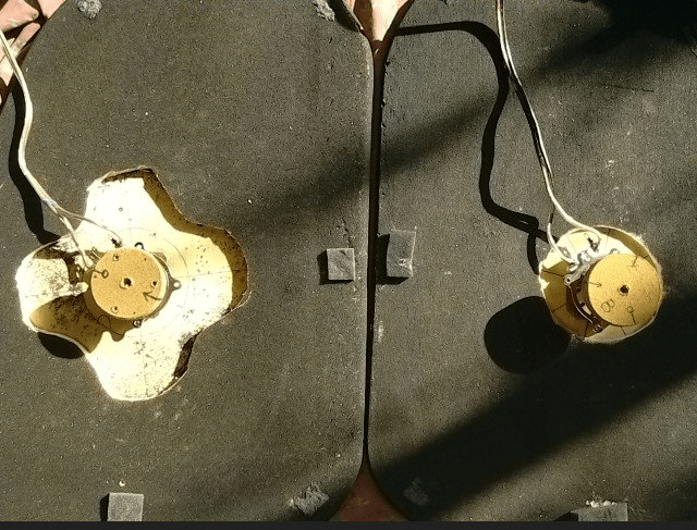

Fail / Resurrection
Testing was a major letdown, certain things as expected stood out and sounded great, as in wooden instruments (cellos to die for) and mid range percussion and all instruments in general were pretty darn good, piano especially along with those cellos. The rub was the vocals...
...So on with the experiment. I removed the frames and carefully cut out and removed as much EPS as I dare that's glued BOOM!...that was it. Night and day on the vocals and everything else came alive as well, especially the high's.
Hello Toddincado,
To be sure to follow you : the left panel of the picture here below is what gives you satisfaction? So the plywood working around the exciter and then the EPS.
Would you remind the dimensions of your panel, its thickness? Just to add some information in an update of the history file I already posted.
Your solution to attached the exciter is interesting. Not so easy to keep it straight, with no effort from the cable neither effort on the voice coil.
About your listening feedback, I could make about the same comment : it is on the vocals we detect the defects while having a very good sound (probably not necessary the exact one but the one we like) on instruments. Is the panel coloration good for instruments not for the voice?

Those speakers were already mentioned in this thread and also I think in the historic "NXT...rubbish?" audiocircle thread. Usually, Bertagni speakers are also mentioned in such discussions.
You can have a look here around p114 #2273 with a link to japanese pages about them.
As far I remember (memory...), I haven't seen clones of those speakers. Some design solutions are used : reduced thickness at the axis, non rectangular shape (few example, see Toddincabo just before), ribs but no so popular (perhaps difficult for most of us).
To know the membrane thickness or the suspension solution could help. The frequency response?
The funny side of your post is that by searching a little about the Yamaha, I found posts about topics I have in mind at the moment (room interaction, baffle...)

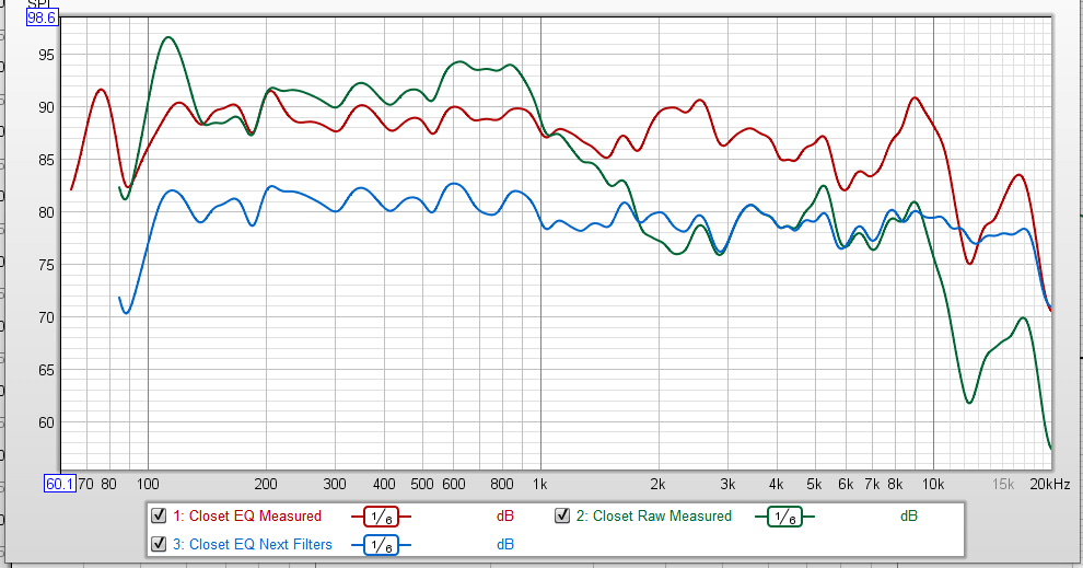

Another quasi promising update....
I found the USB connector for my ZOUDIO 4ch amp, so I was able to apply filters and remeasure. Green is the first raw measurement, red was the best I could do with initial EQing, blue is the final target I'm trying to achieve.
Good news: I was able to get the panel to run a lot flatter. Sounds much better. Still gets low. With adjustments, sounds a lot more musical and dynamic.
Bad news: I used the brand new exciters. Same measurements basically which is good for consistency but also bad. Still some wonky stuff going on up top. Current setup (exciter stuck to panel with double sided tape) seems to have a nasty notch at 12K I can't fix. This may be a property of the exciter more than the panel as my EPS panels had a very similar high frequency response (small peak at 9K, big notch at 12K, slight rise from there)
Also I think the big low end peninsula from 2K down might be some active EQ in the amp. Just more impetus to get my TPA3255 amp set up.
I will probably have to mount the exciters directly to the panels with screws which could be interesting. I imagine getting rid of the metal feet might have a meaningful effect on response. I am HOPING it wakes up the top end. I will get some hardware this week to play with. Even if it doesn't fix the issue there's enough headroom in my amp and the DSP to get things OK. So it's looking better. Still bummed I can't get that initial response though, that was a sweet curve.
Reactions: xsuper9988
Cheapvega.
If you could state the position of the microphone in regard to the exciter,distance ,and panel material ,this could help with understanding what is going on , in the plot.
on the green line the response is good from 2k to 10k (mostly within plus or minus 2.5db ) but after 10k this could be a suck out problem caused by the exciter ?
In an attempt to boost the response above 10k you seem to have caused the peak at 9k on the red line.
If this is a near field response of the exciter ? I would not try to use eq to sort this problem out ,as this could be very misleading.
Steve.

@spedge all measurements had the mic basically 2-3cm in front of the exciters. I was more just trying to see the speaker's natural response and seeing how much EQ could affect that. I will do a full measurement + EQ from listening positions once these are installed.
I got some more measurements, now with the exciters screwed directly to the panel rather than stuck with squishy double edged tape. I tried 2cm (yellow), 20cm (blue) and 1m(green). There are def some room interactions at distance, but again I am not testing in a similar room or for room interactions. Just seeing what the driver can do.
After some eyeball EQing I got the following at 20cm (red vs raw in blue):
Still definitely some tweaking to do, and the filters to fix the high end were heavy. There is a serious hole at 12K; there is a good 20dB of boost there and there is still a bit of a hole. But music sounds much better now and I can see where I need to tweak to get things flat.
That is all kind of secondary though. The main takeaway for me is these things can legitimately cover the full range, only needing a subwoofer to fill in the lowest of the low end. There is still a little "distance" and coldness in the sound, but I think some of that is from the holes at ~500 and ~3500 (the latter also being a weird hole). But it's all tunable.
Next step is to get my TPA3255 chip and ADAU1701 wired up so I can see how these run with more headroom. Gonna go ahead and order 4 panels for my kitchen. I'm sold.
