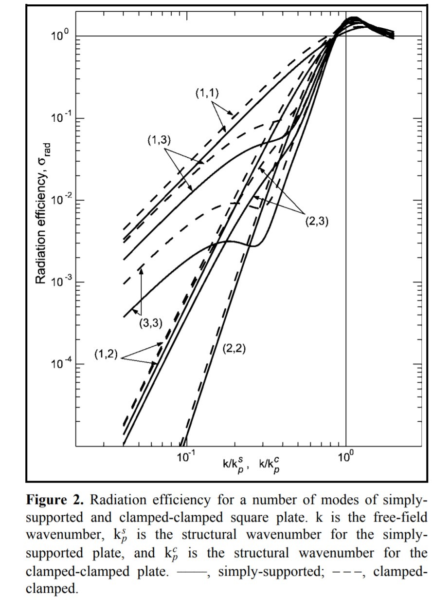

If I follow you analysis... for example among the first modes shown, only the number 1 and 4 give a pressure at distance? Meaning that many modes are useless?
Christian,
Yes, basically, at least at low frequencies. It's perhaps an over simplification to say the other modes are useless, but they are much less efficient, especially at low frequency.
See the figure below from this paper:
https://www.researchgate.net/public...nt_Forces_Using_its_Surface_Resistance_Matrix
All modes radiate sound equally well above the coincidence frequency, but at low frequency the odd/odd modes radiate much better. The modes 1 and 4 from the previous link are the (1,1) and (1,3) modes in this paper.
Disclaimer: I have not yet read this particular paper, but I have seen similar figures in other papers. It looks like it might be an interesting one.

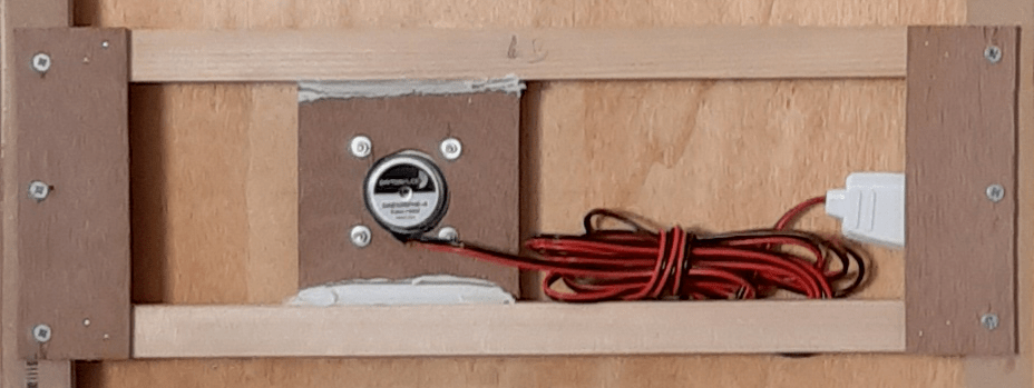

To save me from having to measure a ply free floating panel again ,I thought I'd show this link.
With my exciter I had a good frequency response at 1m from about 30hz to 20k.
And also with ply and my exciter I always found the tell tale hump from 10k to 20k.
When I measured from the side as in the right picture the HF holds up well , even down to the mid hundred hz.
I never really new how much was reflecting from the walls in my room , so I was hoping that you might be able to measure from the sides to confirm or not the ply response from the side ?
If I remember correctly the hf on my ply panels spread to the edges of the panel without loss ?
You can click on the pictures to enlarge them.
In the end I rigidly screwed the ply panel to something like a 2inch by 3inch frame which gave me a higher output, that better matched my 10watt exciter.
I recommend this for pro use with a more robust exciter.

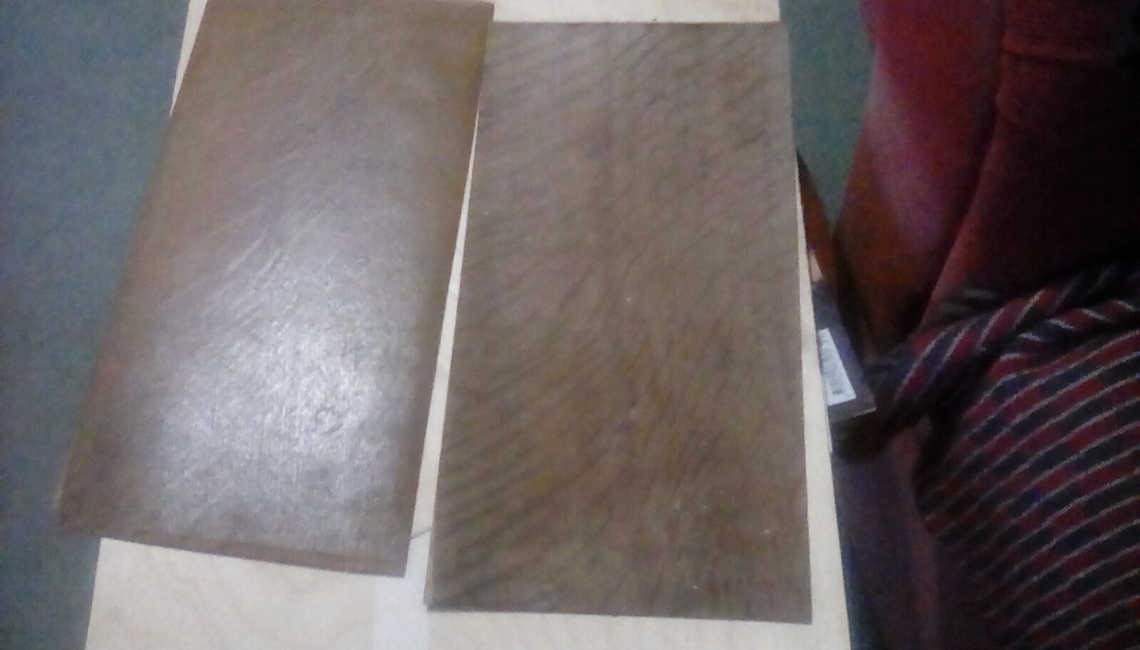

I just remembered that a couple of weeks ago I found two pieces of old .5 mm veneer in my shed ,which had peeled off of some old draws.
they were very wrinkled but I soaked them and placed them in between two ply boards.
they look pretty good now.
I have a choice of making one 1mm panel 34cm by 17cm or two panels 17cm by 17 cm maybe with a little off set on one side so it is not square ?
Should be interesting.
When I get around to it that is.

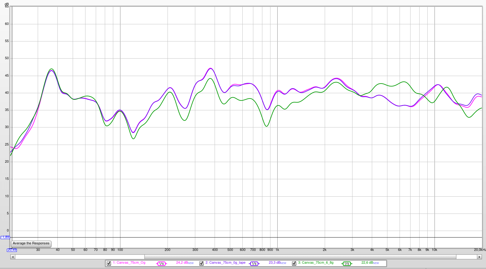

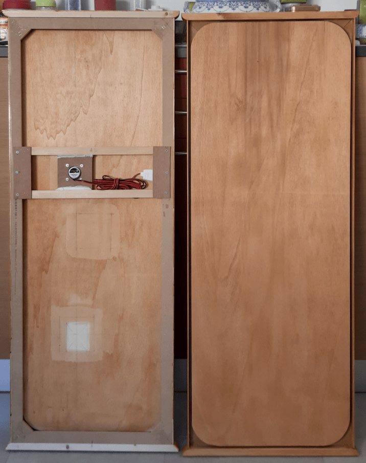

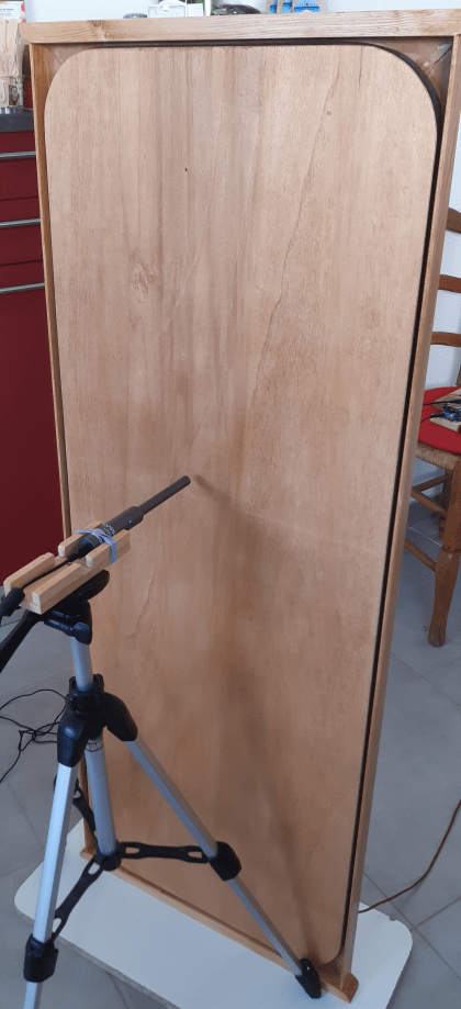

Before sharing some results from "basic" tests I would like to say that canvas panel in addition of being a very good full range is very useful to support tests. By its size, it is more easy to go for a short test without having to push furniture. I think it is perhaps the best choice to start with panels : few components, almost standard. Really a good choice.
So in the attached document some results of basic tests I set up to check characteristics of DML or some ideas. As for other tests, some results are expected (even if not understanding the exact reason), some not.
Christian

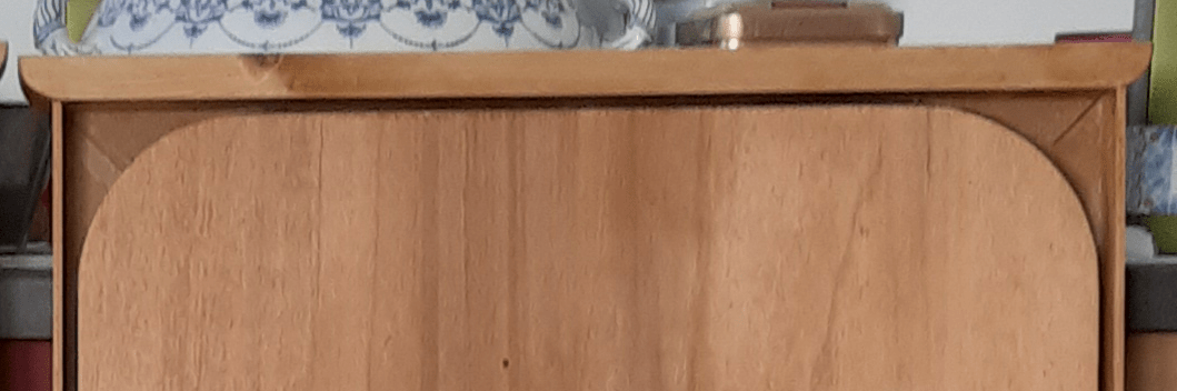

- baffle : not so much effect. For sure not as expected on the peaks in the medium
- rounded edges : same effect as the baffle with a smaller dimension (nice look compare to the baffle!). The canvas with the rounded edges are now playing. Pleasant; No big trouble I think (even if is not really a listen test). The sensation of the plywood panel is still missing.
- Directivity : confirmed very very low. even if known it is always incredible to see; so low changes between 0 and 60°
- Effect of additional mass at the voice coil : here also the effect is very low. No low pass filter appears even when the voice coil mass is multiplied by 5!. More difficult to understand.
Christian

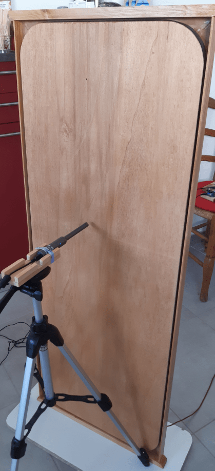

Hi Steve...so I was hoping that you might be able to measure from the sides to confirm or not the ply response from the side ?
The exchanges are dense... not sure to understand what you want neither what previous question you are referring... sorry.
A measurement is I think possible. What would you like, the microphone aiming at the panel edge (like a 90° test)? What distance ? I don't know if my panels are the right candidates because they have a frame for the suspension and a piece of wood covering each side (see the edge on the picture)
If you remember, I posted some times ago how I tried to measure the wave speed in the membrane. I am trying to improve the script to get information from the record... It seems that the attenuation of the wave going through the membrane decreases suddenly above some kHz. Not fully sure but seems. It goes in the same way that what you see and want to check.
Christian

I measured from the front at 1m and then from the side at 1m.
I took the exciter as the 1m point in both cases.
You can take the measurement 1m from the side of the panel if you wish, it's just to see what the response is from the side without any wall reflections.

The white coat was provided with the canvas when I purchased it. It is the preparation added on the fabric for painting. I remember now that in the art store, this coat seems different in at least appearance between canvas type. Mine as a real white color when low cost canvas seem more "white gray", less "thick"? The canvas I have is made of linen, 0.45kg/m² (I guess coating included). If I remember other are something like 0.39kg/m²... far from the 1.6km/m² of 3mm ply. Stiffness and damping are different also in comparison to plywood.
For the tape, it was an accessory just for the mass test. I thought the paste I used for adding mass to glue on the canvas but not; so I needed something to keep it in position. At the end of this test cession I made a measurement with and with out the tape. No differences. The tape is not here when the canvas are playing. The mass neither.
The goal of the mass test was to check if a first order filter appears as the first level of modelling shown in academic papers suggests. The filter is expected between the mass and the mechanical impedance of the membrane. Is the impedance of the membrane so low that the cut off frequency is high or is the model too simplistic?... All the measurements were done at the same volume. Like if the level is not affected by the additional mass. Below some of those curves : no mass added and no tape, no mass but tape (not shown before), 6.4g and tape.
The spectrograms don't show big difference on time axis

Currently I have 2 pairs of panels. This one made from plywood and the canvas type. So in my posts when I write plywood it this one.
I summarized its characteristics in my first post #4116 (text below) and they are in the "history file" page 2 "standard panel 2" column 1 (Homeswinghome) - updated version attached
Here are more details and pictures
Let me know if you have questions.
In the picture below : left = back side, right = front
The white area on the back side is a raw area without varnish to keep the possibility of a second exciter to improve the bass (not tested)
membrane material : 3mm poplar plywood
dimensions (WxHxh) : 420 x 1200 x 3mm
coating : no coating
finishing : highly diluted varnish
shape detail : rounded corner
spline : yes
exciter : Dayton Audio DAEX25FHE-4
exciter gluing : original double side tape
exciter position : off center (inspired by the IEC baffle)
bandwidth : about 150Hz to 20k
mounting method : frame with foam suspension
equalization : not necessary. I think about for a fine tuning

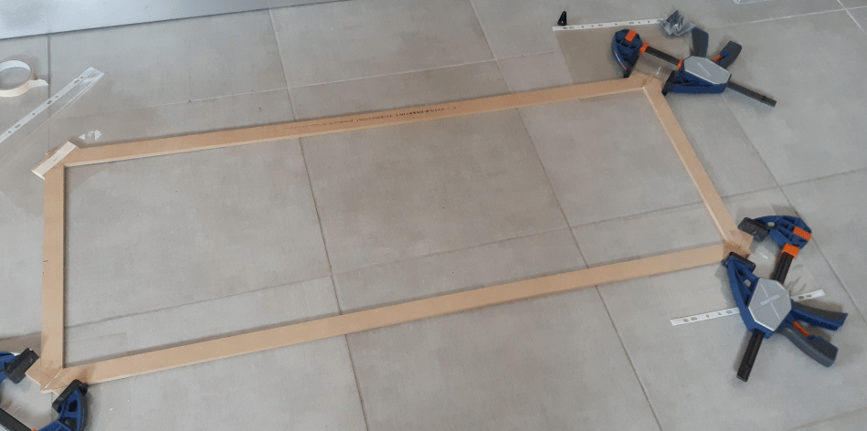

Assembly of the frame (material = medium)
Detail of the exciter immobilization (the exciter is bold on the square plywood piece, wooden blocks help to keep it parallel to the membrane while the filling material is applied). Adaptation of what I understood from Zygadr at Audiocircle. This is an intermediate step, the cable has to go through the square base before applying the filling material.
With the filling materail (I thought I bought some silicone but in fact it more hard more similar to plaster!)
Final with the additional pieces of wood all around (free Japanese inspiration for the horizontal one ;-) ), the foam suspension (17x17mm 3M foam seal for garage door) is a little visible (dark gay at the edge of the membrane)
And we are happy with the sound even without Eq neither sub!
