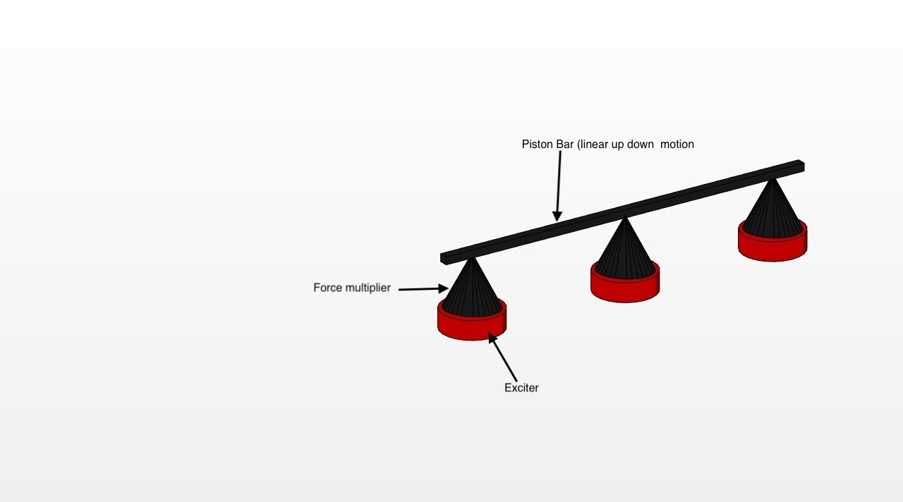

Frankly speaking I have some difficulties to fully understand the mechanism of DML.
The academic papers explain the wave speed in the membrane if below the sound speed in the air or above. When they are equal it is the coincidence frequency. The pressure at distance is made by the summation of the speed at each point of the membrane. The relation between the wave speed in the material and the resulting sound is something missing in my understanding. But for sure there is sound, no bang and there is displacement of the panel in the same direction as a piston (except that it is not expected all points move the same distance at the same time).
When you speak about MEMS : have you make something around that show the damping effect in the panel? Is it damped quickly? I am not so sure. We can easily hear the sound at the edge of a large panel, even in a more than 1m plywood.
In your 3D, is the bar intent to "push" the membrane? Have you already test it?
One additional question : why do you name the cone "a force multiplier" ? I am thinking to something similar in order to apply the force more locally but in my understanding the force at the tip of the cone in the one given by the voice coil of the exciter not more.

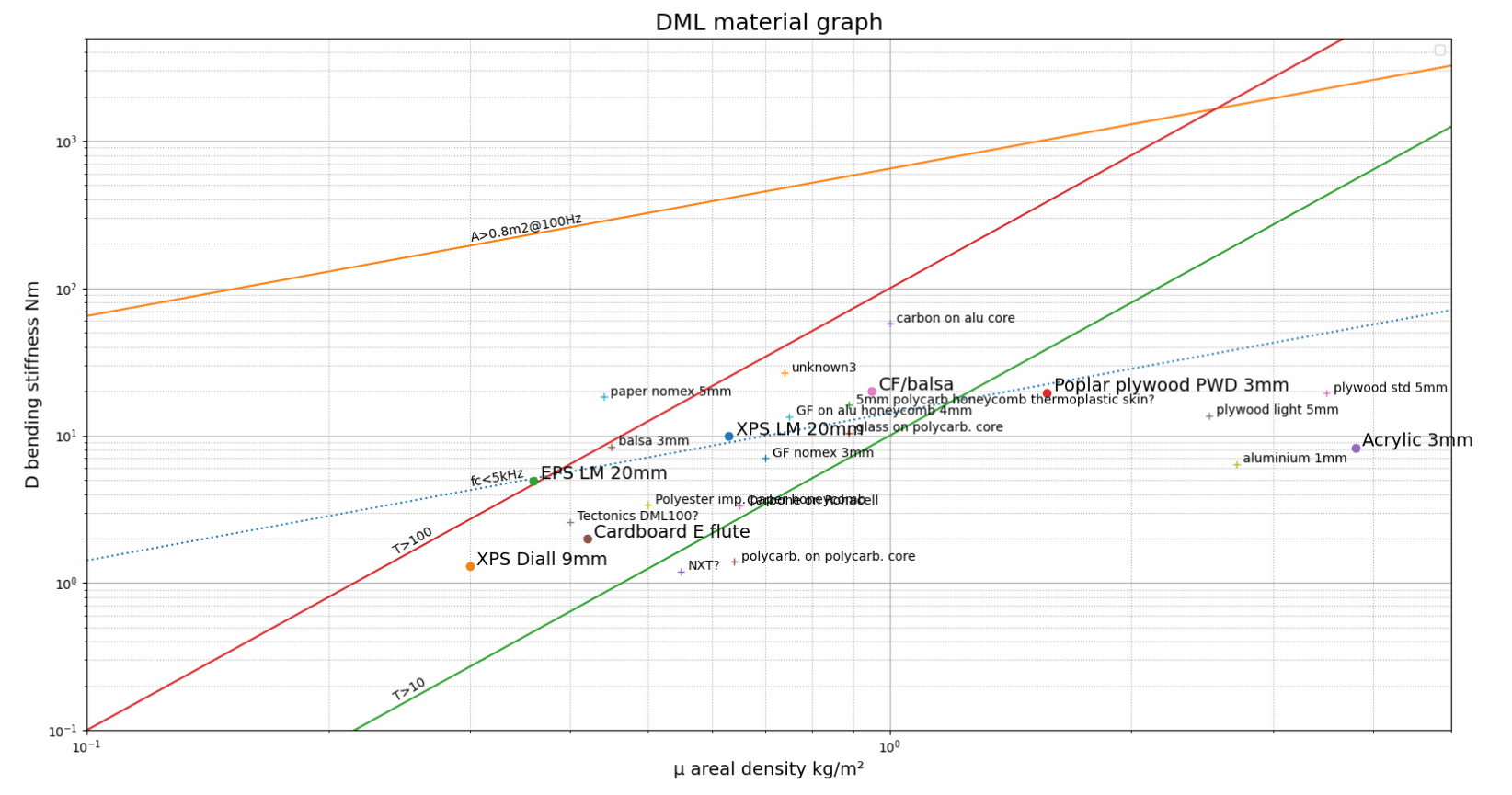

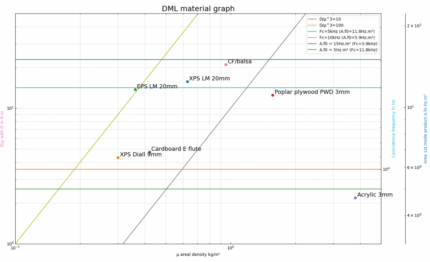

Please find here an update of the "material graph"
First is the one already posted updated and cleaned D = f(µ)
Second shows a limited number of materials (the one discussed in the last posts). The form is a bit different because it shows the bending stiffness to arial density ratio (D/µ) according to the arial mass µ.
2 vertical axis are added : the coincidence frequency fc Hz and the panel area 1st mode frequency product A.fo.
Thanks to the log log chart and the D/m in vertical, the target for fc or A.fo are horizontal lines.
2 of each are shown : Fc = 5kHz, Fc = 10kHz, A.f0 = 5Hz.m², A.f0 = 15Hz.m2
The line D/µ^3 = 10 or 100 as efficiency criteria are also shown.
The criteria A.f0 is easy to use : for example, with A.f0 = 5, if the target for the 1st mode is f0=40hz then A = A.f0 / f0 = 5/40 = 1/8m² = 0.125m²
How to use that...
In horizontal : to the left the material with the higher efficiency, to the right the material with the lower efficiency
In vertical : up the material with a "low" fc and the need of a larger area to reach low frequencies, down the material with "high" fc and the need of a smaller area.
I would appreciate to have data (bending stiffness) about 10mm EPS, PVA coated or other which in the top list of material choice.
Christian

On your post #4505 you show the Tectonic fixation surface waves longitudinal wave front with low frequency at the edges and higher frequencies at the center. The acoustic energy is traveling along the panel which depending on the material is either supersonic or hypersonic velocities in air which at STDP is (344m/s). If you look at that figure and thinking that the amplitude of the surface wave is generating sound that is a transverse wave and does not generate sound in air else one would be hearing sonic booms. For one to generate acoustic wave that one can hear it has to be longitudinal waves ie piston motion of the panel which then the F=ma comes into play and that then limits the high frequency the panel can generate. If you put a MEMS accelerometer on the panel you will see that the panel damps out quickly from the center of the exciter. What you should be considering is a circular to line converter so that the panel acts as a acoustic line source (see attach figure). It is 3D printed and includes the force multiplier which is a shell to reduce it's mass
Hello Pontos,That's exactly what I was thinking of as well, or close to it. And my next thought was to have a vertical line array of multiple exciters acting on a perpendicular edge glued to a flexible panel that's curved slightly in the middle coming around sharper to the edges with meet perpendicular to the mounting surface (wall). Would that dampen the edge reflections?
DMLs are in an area still to be discovered so fully open to new ideas. It is appealing but in my opinion, it could be also a trap... when I see the difficulties to master a panel with a single exciter! The time and investment to go from the idea to a satisfactory result guide in the choice of the fights. Unless proof that other architectures give easily better or faster results, I think to continue with the single exciter configuration.
About a variable thickness, we can find 2 ideas behind :
- Change the speed of the waves... I don't remember to have seen a document about that. Do you?
- Damping. Here you can see post 969 page 64 about the Acoustic Black Hole. But here also I am at the beginning of the question : is damping good or not?... This question is here independently of the number of exciters.
