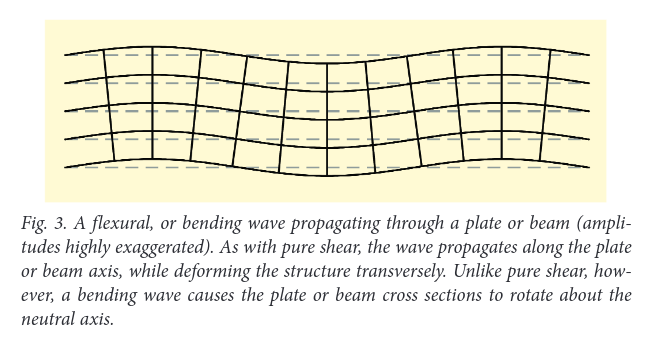

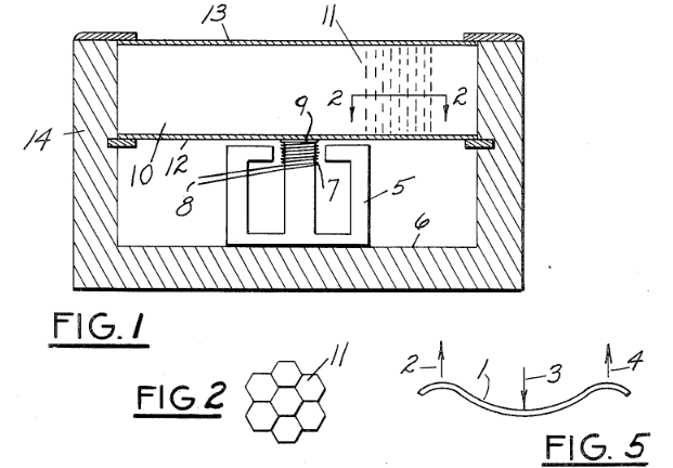

It took time to me to find a representation of what are the bending waves which produce sound. There is one drawing below extract from STRUCTURAL ACOUSTICS TUTORIAL—PART 1: VIBRATIONS IN STRUCTURES Stephen A. Hambric
M Warnaka's patent introcuces a way for that. 1966! (the patent gives also by the way the basic formulas that govern DML)
So what is expected by the core is more than to be light and what is expected from the skin is not to be stiffer as possible.
It was well summerized by Steve in #4823 "As long as you get the combination of rigidity and weight correct they seem to work well."... with some condition on the core to be added. Unfortunately I won't be able to give you those conditions... Refer to some foam core panel that don't work. It is where I am.

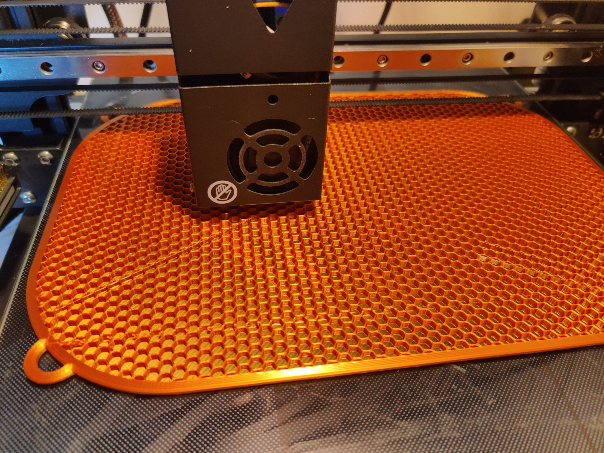

The 6mm plate will take a while to print and take a lot of material, but I have the 1mm and 3.8mm ready now with exciters mounted.
Size of the plates are 295x205mm, and the 1mm plate weighs 36g, and the 3.8mm 76.3g.
Both plates have one 0.1 layer at the bottom, which is the side the exciter is fixed on. The infill is 17% honeycomb, and at the top I have 3 layers a 0.1mm each. These settings was pushing it with the BioFusion filament, and the surface at the top didn't become fully solid everywhere, and little bit came off at the bottom of the 3.8mm getting stuck to the glass as I removed the plate. But it was the settings I found best for for the carbon filament, so used the same for these plates.
The extrusion with is 0.6 mm as nozzle size, but infill has 50% extrusion.
This is the 3.8 mm plate during printing to give you an idea about the structure:
Also you can see the thick walls. I added those for some damping. Maybe not ideal from a efficiency standpoint, but seems like some damping will smoothen the FR and reduce ringing, and I'm planning to tie it in all 4 corner mounts only for suspension.

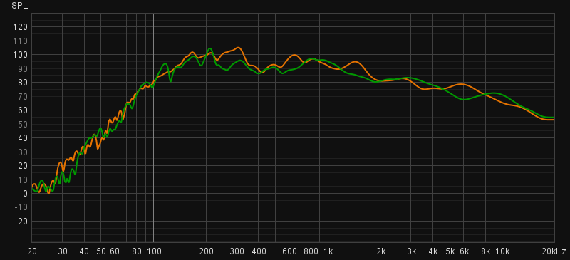

First of all which is louder?
Using "check levels" before measuring the FR in REW, the noise registers as 93dB for the 1mm plate and 99dB for the 3.8mm. So as expected the ticker plate is loudest despite having double the mass.
Since this material is not that stiff to start with, the 1mm plate is very bendy though, and wobbles as you wave it in the air. The 3.8mm is fairly stiff, and takes some actual force to bend it.
When it comes to FR, the 1mm is surprisingly close I would say...it feels so flimsy that I expected it to be a disaster. Actually it is, but because it distorts badly in the low mids, more on that later...

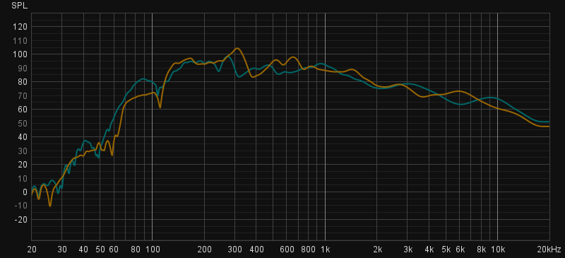

First I measured with them just hanging from strings, with orange being the 3.8mm and turquoise the 1mm:
The bass response is stronger with the thin plate, but some strong modes in the low mids makes the 3.8mm win in peak SPL.
To drift away in speculations a bit, this kind of response is what I seen before that makes me think why the thickness tends to push up those modes in particular. The lower bass frequencies depend more on pure wave bending of the plane, and hence become louder with the thinner plate. But the lack of body means weaker modes in the mids. That's my hypothesis anyway and I'm sticking with it!
The plan is like I said to actually suspend from all four corner mounts, and to emulate that I pulled slightly at the bottom corner mounts while doing the test (orange 3.8mm and green 1mm):
We see that the bass response especially becomes smoother, and is much more similar for both plates. It makes sense if the damping constricts the planar wave motion, but we still see those mid peaks in the 3.8mm, and they don't seem to be much affected by damping the boundaries. This does seem to indicate that there are different principles at play here in different parts of the spectrum.
However, like mentioned before the 1mm distorts badly in the low mids. I'm not sure why that is, but think I want to revise the process and see if that can be fixed by printing the top layer separately and glue or iron it on. Improving on the 1mm plate might help improving the thicker plates as well.
Forgot to mention what was the biggest surprise to me. That the 3.8mm plate actually works quite well. In the earlier test I did with this filament I got bad HF response, but must been the mounting of the exciter that was bad, or that I had double as thick bottom skin.
Efficiency is also on par with the carbon. The carbon sounds a bit tighter somehow, but the double stiffness according to the specs doesn't seem to have nearly as much impact as I would have thought.

I have been trying to follow some of the patents, a lot of it is over my head for sure. But looking at the Warnaka patent, it is intended for low frequency loudspeakers. I'm not saying there is no bending wave. You can almost see it with your bare eyes for low bass, but I suspect that principle becomes less and less dominant higher up in the spectrum.Leob,
I won't come back to the "self exciting" versus "linear resonance"...
I let perhaps Steve to comment on the low density EPS because he tested so many material. DML is also a matter to experience, some with success, some not.
About the difference according the frequency in the spectrum, the key is more in my understanding in the efficiency of the different frequency regions described in the analysis of vibrating plates than in existence of a body. This also a point where we don't have enough understanding or evidence.

Yes, it is way to thin for this material, but only intended as an experiment. But I'm really surprised how well such a flabby plate works...apart form the distortion, the difference to the much stiffer 3.8mm is relatively small.Leob.
by the way you are describing the 1mm panel, it sounds as if it is too flexible and needs more rigidity .
The hf response seems to look very similar to a thick xps panel ?
Steve.
I don't have XPS to compare with, and like mentioned it is a cheap uncalibrated measuring mic, so I don't trust the HF response especially. But it is a bit less bright than the plywood or polycarbonate I tried.
