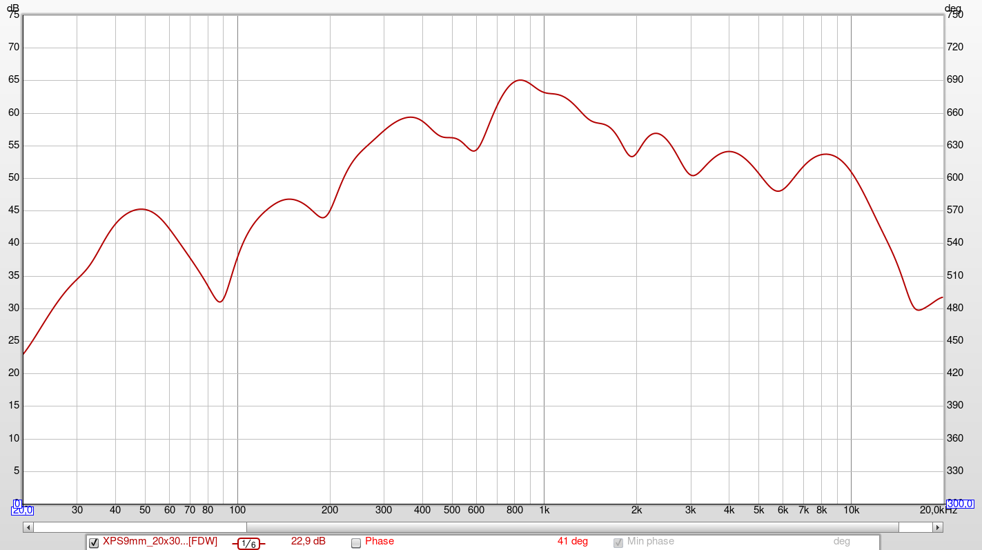

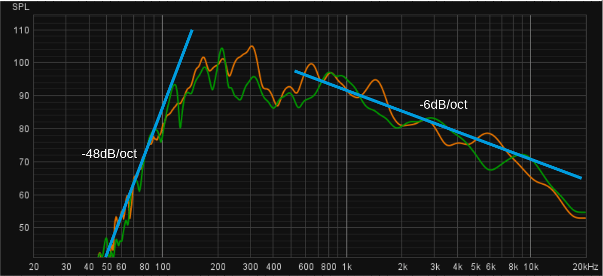

Leob,
The HF roll off is not very steep so why not but the bass roll off is unusually steep. Almost the same for both panels is also strange. There is perhaps something to check.
Made the same observation and thought I forgot to disable the HPF I usually have on when listening to music on them. But it is not an issue with the measuring equipment. My regular speakers don't have the same drop off.
Possibly it can be related to the edges I have that dampens a bit. Doesn't really bother me though since I'm planning to use them with a sub, but also curious as to why.

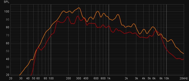

Just here a 20x30cm XPS9mm measured at 50cm about. It is more typical of what I have seen from panels up to now. I had not good results with this material but I have some sheets available easy to cut at dimensions close to yours. In the next days I will try to measure it at different distance to see the influence of the measurement distance on the FR.
You got me thinking Christian...so I had to put up the PC (500x400x6mm) panel. Both to confirm the LF and HF roll offs.
Red line is the PC panel, and the 3.8mm damped printed plate is orange (might have differing amp level):
The notion that they are brighter I probably got from a peak around 7k, or bad mounting in earlier tests, the printed panel actually has a better response overall. Will check tomorrow if perhaps HF improves a little after a while with the tape.
But yes, bass response is also dropping off abruptly. Will try ply later and see if the result is the same. Could it be the exciters? I used two different, and I would have thought a 50mm exciter should give deep response if anything.
Also, I'm doing the tests via BT APTX on this machine. Maybe not ideal, so will try from my desktop that has an analogue connection instead.

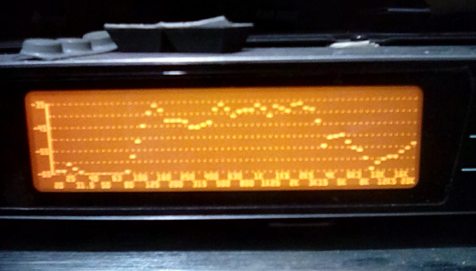

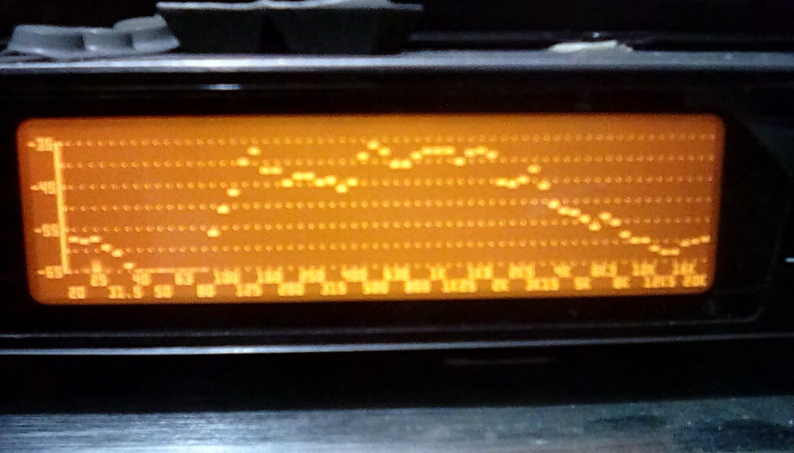

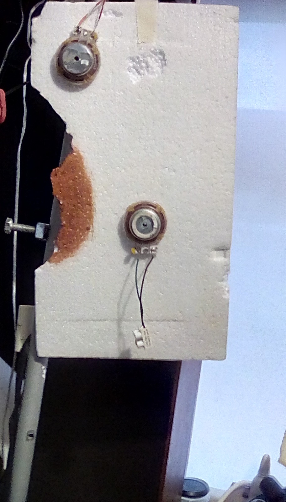

Leob.
Sharp roll off below 100hz is possible as in these pictures of a low grade eps with epoxy on one side only.
The first fr picture is from the exciter side which has the epoxy on.
The second is from the front.
The third is the offending panel using the exciter in the top left , the epoxy only goes down about a third of the panel.
These were measured at about 6inches.
Although the panel rolls off after about 3k which could be because of the epoxy skin ,or double sided tape or both ?
The sound does not sound too bad vocals sound full bodied with the obvious loss in hf.
I might try This on a proper eps panel and see What happens to the hf ?
This is a low grade eps material ,I could try it on a higher grade which I might still have somewhere ?
My phone microphone drops off like your plot but at 50hz ,you are probably measuring your microphone and panel response,you really need a microphone with a flat response from 20hz to 20k .

Leob.
Sorry, for some reason I had the impression that you were having problems with you microphone ?
so this is the real panel response at 30cm , how goes it sound ?
my test epoxy panel.
This was an old low grade eps test panel that I coated the top end in left over epoxy, just one side though.
You should get a good response up to at least 10k with low grade eps and pva.
The epoxy formed a soft skin on the surface, maybe it needs the fibre glass to form a hard surface ?
The pva soaks into the surface and sounds and feels harder .
Epoxy is also heavier than the thinned pva.
Although it does not look promising, I should do proper tests before I make a final decision.
Basically ,I just stuck the exciter on this panel just to see how the epoxy affected the sound, but notice the response was quite similar to your panel.

They sound good! I don't have much reference but the printed panels is definitely better than the polycarbonate and ply I tried. And seems to be able to handle more power as well despite being smaller.
So you find that you get that roll off with low grade EPS in general? Or only with epoxy added?
Like I said, my mic measures bass response of my regular speakers fine. It is a measuring mic (Omnitronic MM-2USB) and should have a reasonably flat response.
I understand now "cheap mic" and there is now doubt about the measurements from the mic side. The specifications are good and the price not too high. Good to know! Sorry for the previous posts. I interpreted them as a chain with some low cost electret capsule...

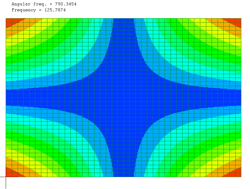

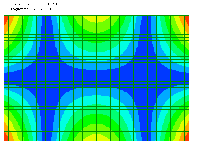

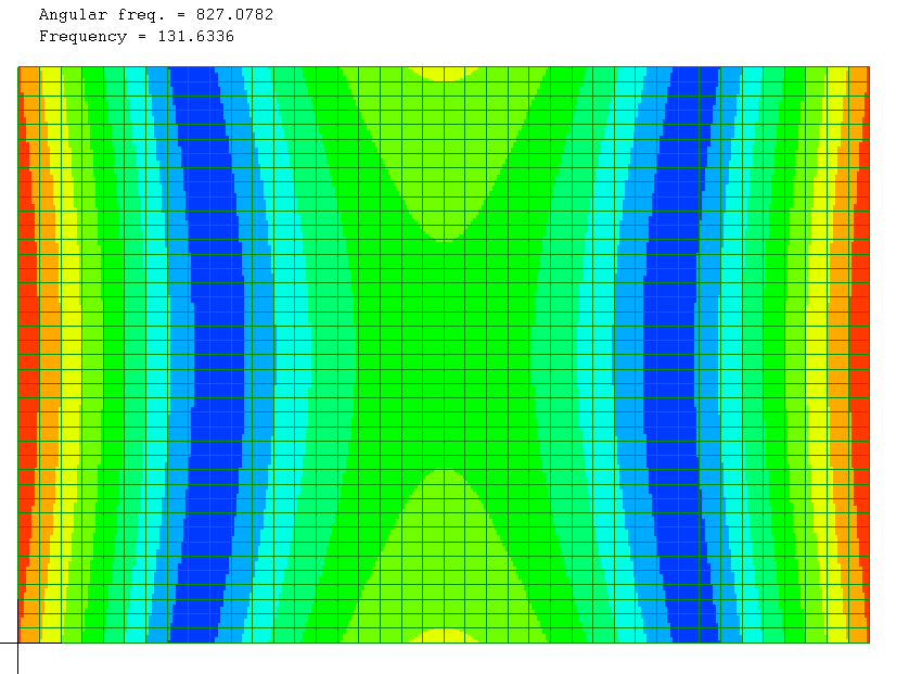

@Veleric

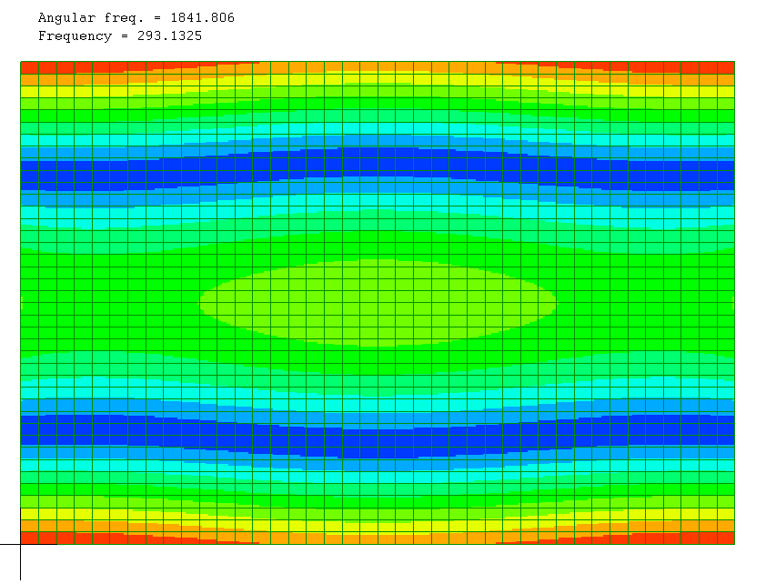

Do you know a way to calculate the first resonance frequencies of a free plate? The reason I ask is, for test, I made some measurements of a "small" (20x30cm) panel just glued on the exciter and try to make a relation between the observed resonance frequencies and what could be predicted by calculation.
Thank you
Christian
Christian,
Yes, I know how to estimate the frequencies of some of the most simple modes. But of course you have to know the elastic properties of the plate material to do it. Usually I just let my LISA finite element model do the calculations for me. It can calculate the frequencies for more modes than I can.
You can find the equations for the fundamental frequency in flexure and torsion here: https://en.wikipedia.org/wiki/Impul...tion technique (IET,of a material of interest.
Look at the equations in the "Experimental correlations" section. Note, they give E and G as a function of the appropriate fundamental frequency. To go the other way around, you will have to invert their equations to give f as a function or E (or G).
For your first try, ignore the correction factors they give (T and R).
But I have another suggestion for you first. If you tell me the elastic properties of your plate, I'll run the LISA model and estimate the resonance frequencies for you. I would just need:
Elastic Modulus (both directions if you have measured them)
Poission ratio or shear modulus (not as critical, if you don't know it I will make a guess!)
Thickness
Density
I would be happy to do it. It's simple (and fun for me, at least). You might find the results more insteresting than you imagine.
I have a second suggestion too, which I will put in a second post....you should try both!
Eric
@Veleric
Christian

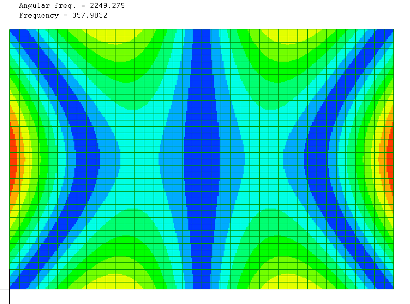

Christian,
My second suggestion is to simply measure the resonance frequencies of your plate directly using the "tap test" that I mentioned in the other thread regarding the Impulse Excitation method.
The way to measure the resonant frequencies of a plates is to make a series of REW measurements at various points on the plate using the "tap" test. Each of the locations will reveal a different set of resonance frequencies.
For each tap location you:
1. suspend the panel a particular way, depending on which mode or modes of resonance you want to excite/isolate/identify.
2. place you mic very close to the surface of the plate (1-2 cm), at a particular location (again, depending on the mode(s) of resonance you want to excite).
3. tap the panel at the location of the mic
4. monitor the response in REW, (using the RTA function, spectrum mode, no smoothing and , 4,8, or 16 averages)
5. you will see several sharp peaks in the frequency response. Each one is a resonance frequency of the panel.
Below are images representing the first several modes. The shapes will be similar for most any plate with the same aspect ratio. These particular results are for a 20x30 cm plate, 4 mm thick with a Elastic Modulus of 5 GPa and a density of 0.6 g/cm^3. (Like plywood, but isotropic).
To measure the first mode (first image below), attach strings to the plate at the middle of two adjacent edges (where the image is blue for that mode), and place the mic (and tap) at any of the corners (where the image is red). I use alligator clips to attach to the plate, so the hanging locations can be moved easily. If the plate is light enough you can just use strips of tape. When you tap the plate, the lowest peak you observe in the REW spectrum is the fundamental in torsion.
To measure the fundamental in bending (2nd image), move the stings to one of the long edges, attached about 1/5 of the distance from each end (image is blue there). Position the mic and tap the panel along either of the short ends of the panel (where it's red). Now the lowest frequency peak you will observe corresponds to this mode. You my still see a peak for the torsion mode, but ignore that, as you already know what it is. You will also see many peaks at higher frequencies, corresponding to higher order modes.
Leave the strings in the same place, but tap and mic at one of the corners to find the frequency corresponding to the mode in the third image.
If you wish, continue the same way to get the frequencies of the next two modes. In each case, ignore frequencies that you have already "identified" from previous results.
Note, it can get a bit tricky as sometimes different modes can be very close in frequency. But by trying our different tapping and/or micing positions you can often figure out which is which. this is because tapping at "blue" locations won't excite that mode. So if you can find a place that's red for one mode and blue for the other, tap that place and the peak you get will correspond to the mode that's red at that spot.
Try it!
Eric
