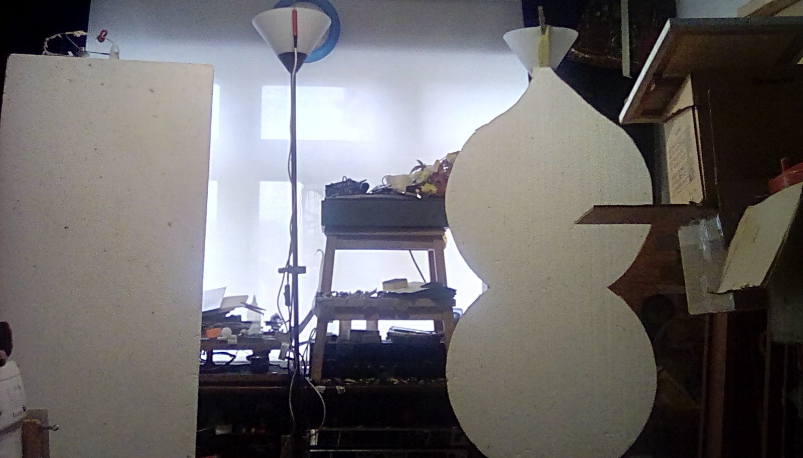

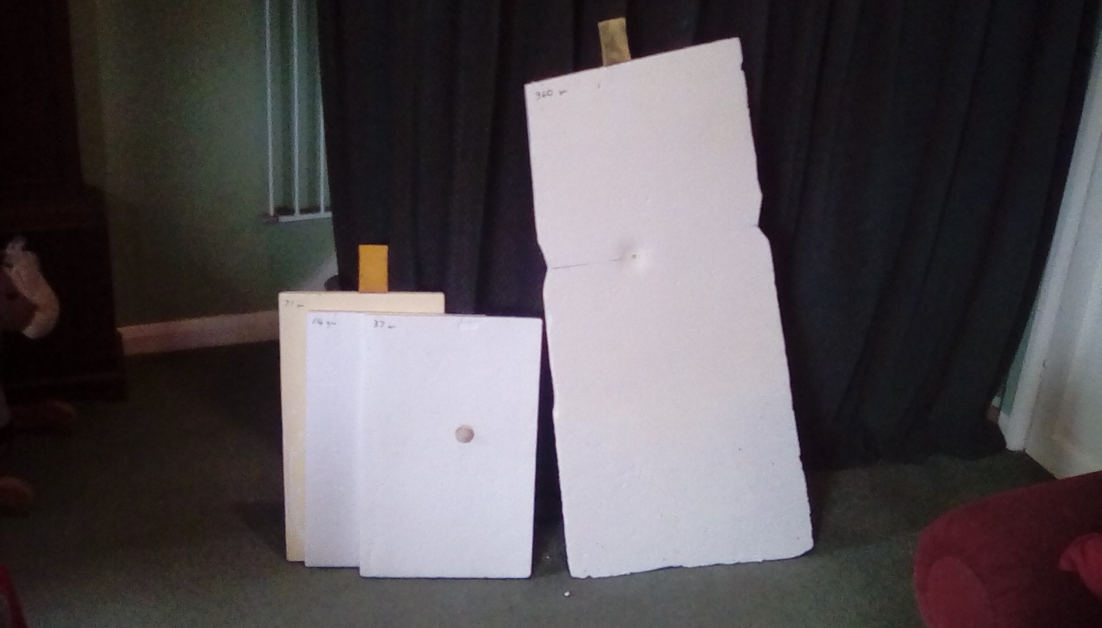

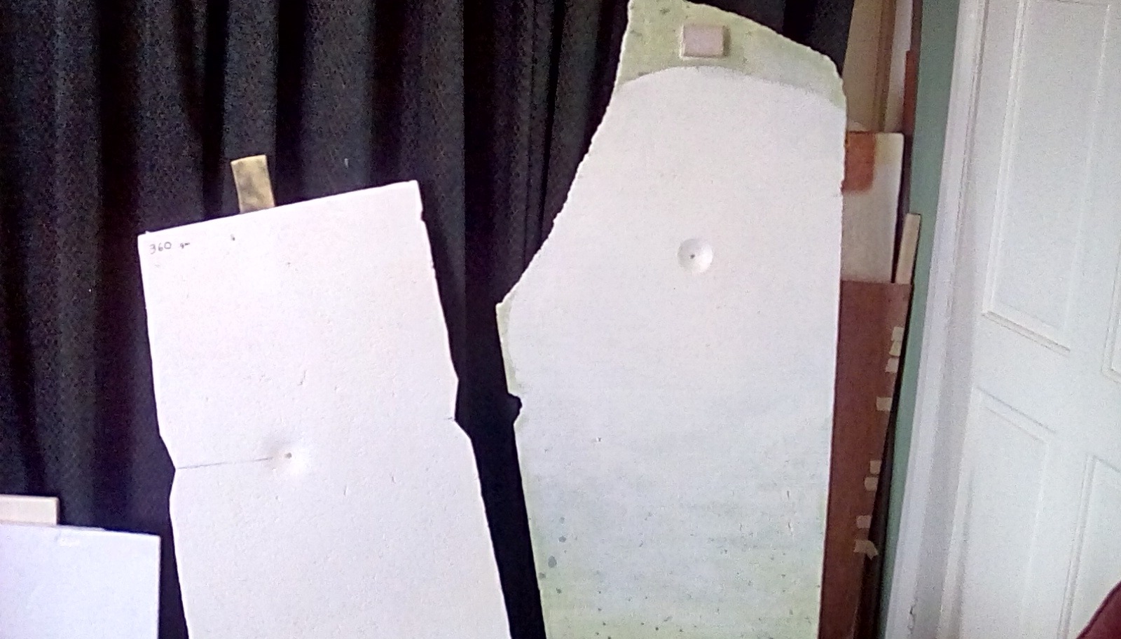

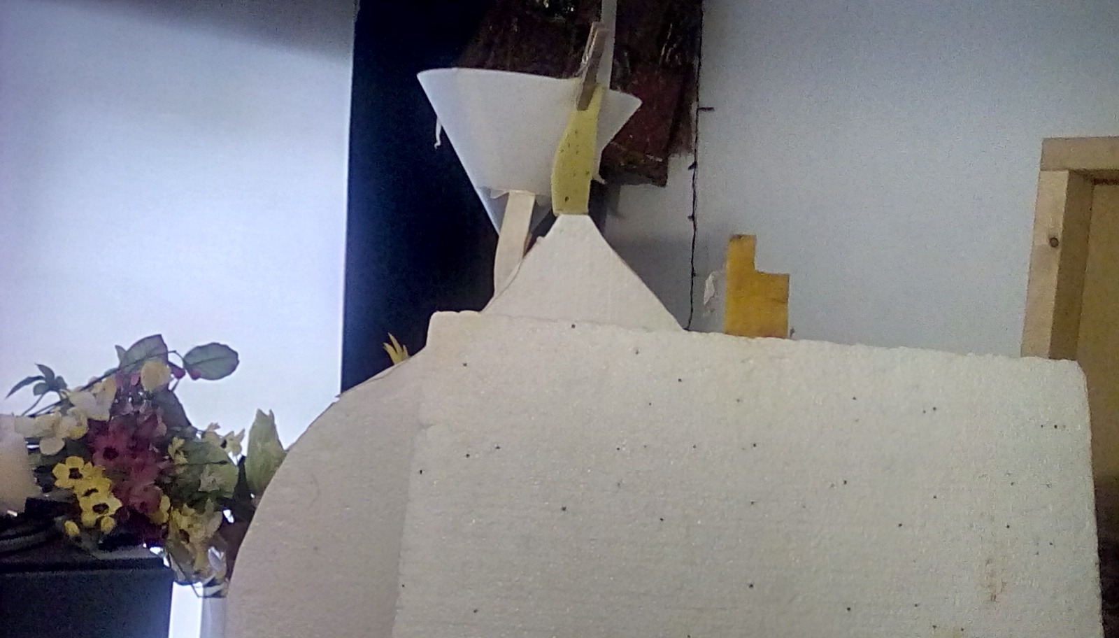

Yes eps 70grade.
Some years ago now wickes started using poor quality eps, which had holes in the surface , so my supply dried up !
This was another reason I started playing around with other materials.
I used to make a concave dome shape in the centre of the exciter area to allow more direct sound through the panel.
it looked like a cone shape on the front, and probably acted like a cone too.
This improved the presence in front of the panel ,and gave a more intimate sound.
Sanding yes, but this is a pain in the neck with a 6ft panel !
Then apply a 50x50 mix of pva and water, this mix will run off, if the panel is not sanded !
If you feel the need to add more you can, I even experimented with thinned vinyl silk paint, which softens the sound, if it, is preferred ?
The pictures show some very old panels, the one on the left is sanded , but not coated or thinned in the centre, white dust still falls from The panel after all these years !
The 6ft panel on th left is standing on the floor on dish sponges , but will start to walk if heavy low frequencies are used !
my preferred eps mounting I use is 1 inch dish sponges,(softened) they affect the sound very little ,and do not buzz , they also stop the panel spinning around every time I walk past them.
If you do attempt this panel ,I am always willing to give advice.
WARNING.
Do not attempt to collect this size panel on a windy day, a slight breeze will send you flying across the car park ,trying to dodge all the cars and pedestrians 😱😀
Very embarrassing !!!
This link shows the damage caused to the panel (bottom right) when it was ripped out of my hand, I glued this piece back with pva.
https://www.audiocircle.com/index.php?action=gallery;area=browse;image=45743
Steve.

Yes eps 70grade.
WARNING.

Christian.
a 20mm panel should be fine
The large panel in my room weighs about 500gm ,which is actually 170cm x 60cm x 25mm.
This picture shows a couple of my old panels with the weights written on them ,I hope you can see ?
The first yellow panel on the left is a 15mm thick panel coated in vinyl silk and is 71g.
The second is a low grade 10mm thick eps with no coating and only weighs 14g.
The third is the same low grade with a coating of pva, it has a pva coated fabric dome which is adding some extra grams .
The fourth is a 25mm eps panel heavily coated in vinyl silk ,it has no parallel sides , and with the cone in the centre of the coil, I even angled The edges, I got a bit carried and !
The paint adds about 100g !
I added the second picture to show a panel that was with other panels stashed behind the curtains, out of the way of my wife's prying eyes.
Speaking of my wife, I can hear her upstairs ,doing French lessons on her phone app.
She has just booked the Eurostar for September to stay at a friend's houes,if all goes well ?
She is very happy at the moment ,so I had better hide the panels quickly 😁
You can mould these panels to the sound you prefer, heavier ,stiffer, softer ,the choice is yours.

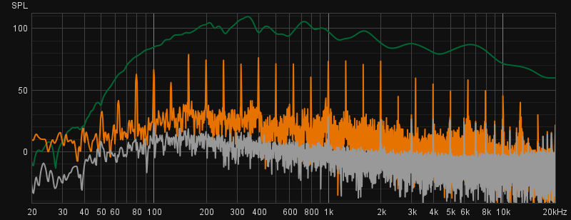

So done some more printing experiments.
Some 3d print technicalities to bore you all with:
Since the single layer 0.1 mm skin was sensitive and easily ripped, I tried to print double 0.06 mm thick layers instead. Usually it is recommended to have extra thick initial layer, since consumer level printers with decent size beds usually is a bit uneven. So even a 0.1mm initial layer can be a challenge, and 0.2mm is a more typical first layer height. Some printers (Prusa, the Apple of 3D printing) even force minimum 0.15 height for first layer. But with double 0.06 layers printed in different directions I get a much more homogenous skin, and only 0.12mm, so 0.02mm thicker than before. So he plates will stand remounting of the exciter, and perhaps it gives a bit lower distortion. The absolute minimum layer height (limited by the stepper motors resolution) should be 0.04mm, so can try to push it even more.
I tried printing the top separately. My hope was to either glue or heat it on.
Glue didn't really seem viable. It seems to need a quite thick and gooey layer of glue to stick, and probably a vacuum as well to make sure it is stuck at every cell. At least my attempts resulted in some spots not being stuck, causing terrible distortion. And in the end you are probably not getting a lighter plate anyway compared to printing it in one piece if you have to add several grams of glue. I will revisit if I get vacuum equipment and a good epoxy to play around with sandwich composites, but one of the allures of printing is not having to go through the expense and hassle of that.
Heating it on was just a really bad idea. The material will shrink and deform when heated...especially a 0.12 mm thin film. Should have known since I attempted annealing a plate earlier to increase stiffness, also with less than ideal results.
But, lowering the layer height, I can also get a bit thinner bit more solid top layer, so printing in one go might not be so bad.
I suspected that some of my initial measurements was off due to exciter mounting issues which caused me to discard the PLA+ as useless due to a really bad drop off above 3-4k, but I noticed results have been more consistent when using tape. So printed a 3.8mm plate with the PLA+ in the same dimensions (295x205mm) but using the lower layer height.
Here is FR (green) and spectral contamination (orange) and noisefloor (grey):
FR is similar to the other printed plates.
For the spectral contamination I simply used multitone 1/10 dec in REW. I tried with one of the files @homeswinghome linked to, with similar result. My graph looks very different though...do you have the actual file you used Christian so I can compare?
So hard to say much about the spectral contamination without a reference, but will make the test on some different panels.

This confirms the density range and the fact the paint can be an important portion of the total weight.
I can belief you. The point is to how to proceed, what modifies what... without some dozens of tests (more?)You can mould these panels to the sound you prefer, heavier ,stiffer, softer ,the choice is yours.
Christian

Good think you tested the spectral contamination test. When I did it, it was in comparison between a classical full range (a Visaton FRS8) and different panels. The first point should be to check the level used which is perhaps not so easy because it needs some mic calibration. I am also not aware of a kind of metric extraction. If somebody knows about it...
Before a having a better framework, you might perhaps use a standard loudspeaker as reference.
By the way, with your post I understand that I am not using the last REW version. I have the 5.19 while I suppose you use the 5.20 which has a multitone generator; So next task for me to update REW.
You will find attached two mdat from my records : one is the reference FRS8, the second is an acrylic. Let me know if you want others.
Christian
