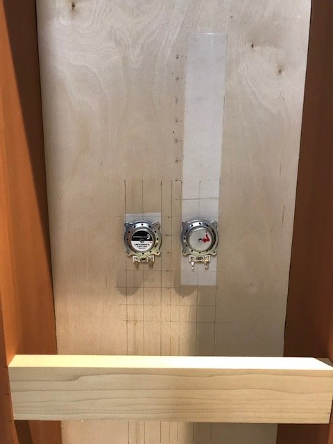

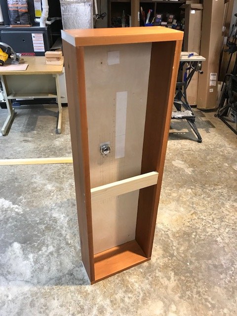

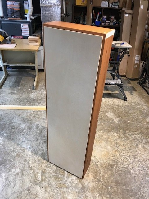

Eric,I'm not sure I would go as far as Christian to say clamped is loudest, but I do agree that constraining the edges can have a positive effect on both FR and overall output. One of the NXT patents demonstrated this but I'd have to look to find it.
For me, so far the best constraint seems to be attaching the panel to a rigid frame around most or all of the perimeter using a double sided foam tape. This approaches what engineers refer to as "simple supports" which implies that the edges of the panels can't move (not much, anyway), but can rotate. So the perimeter is mainly like a hinge. I think this is effectively what the Tectonic supports do, although their combination of rigid and compliant supports may be more nuanced.
Here are two examples comparing panels with frames and foam, compared to the same panels hanging from strings (free edges). In both cases the biggest difference is at the low frequency end, where the framed panels provide much greater output than the free panels. At higher frequencies, the responses tend to converge. The first is for a 16"x23" CF/balsa panel, and the second is for a 14"x48" plywood panel. In both cases, the same exciter was used for both test, and the amp was set to the same volume, and the mic was placed at 1 meter. I have done this many times and see pretty much the same thing every time.
Eric
I come to almost the same observations. I'd try to share some FR to show that. At the moment I am experimenting with XPS (for convenience). As it is a light and quite flexible material and my test panel is small (20x30cm), I think the foam leads to something more close to clamp conditions; By removing it in the corner, in the way of the Tectonic patent, the result is better.
Christian
Sure. The frame is a bit overdesigned, but maybe not as much as you might think. The exciter position that works best is about 5 inches above the center, and 1.5 inches to one side. Two exciters works well with the second one 1.5 inches to the opposite side. With two placed thus, the frequency response is almost identical. But (for reasons I don't understand), the impulse response is slightly cleaner. The opposite is true if the exciters are much farther apart.Do you have any photos of your 14"x48" plywood panels mounted in the foam?
Last picture shows the foam tape. In this case it's 3M Extreme double sided mounting tape, cut to about 1/2" wide. It turns out that the FR is pretty sensitive to the choice of foam tape. Even just the tape width. As you can see, this is pretty thin foam, only about 1.5 mm I imagine. I usually don't run the tape all the way to the corners, mainly so I have a chance at separating the panel from the frame for another trial. This is the highest damping foam tape I've used. It works well for this panel, but may not be the best for every panel.

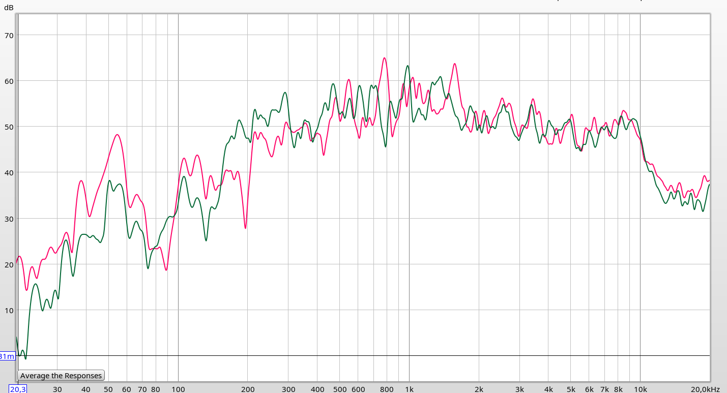

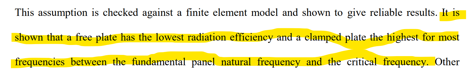

Here are 2 FR with a low smoothing. One is free edge - red (2 strings suspension), the second - green is frame and foam ( just 40% of each side to keep the corner free). I can't make a relation between what you say Steve and those graphs. I must admit it is panel for measurements, no listening test...
Christian
Yes it might come from this paper. Somewhere, they mention 3dB difference. Fully agree it is in the detrimental of the FR. All the current indications go to the simply supported conditions.Christian,
Now I recall at least one source of that information: it was this paper:
https://eprints.soton.ac.uk/369232/1/Eprints.pdf
where they say:
But the caveat is (as Loeb pointed out), the the clamped plate has a higher fundamental frequency than other boundary conditions. So while it might be most efficient above its fundamental, its fundamental is higher. So there is a trade off. My experience so far is that a "simple" boundary (i.e. like a hinge which limits displacement but not rotation), rather than clamped is a pretty good compromise between high radiation efficiency without driving the fundamental needlessly higher.
Eric

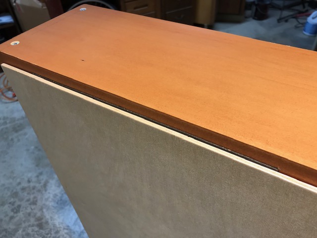

Eric,Sure. The frame is a bit overdesigned, but maybe not as much as you might think. The exciter position that works best is about 5 inches above the center, and 1.5 inches to one side. Two exciters works well with the second one 1.5 inches to the opposite side. With two placed thus, the frequency response is almost identical. But (for reasons I don't understand), the impulse response is slightly cleaner. The opposite is true if the exciters are much farther apart.
https://www.scotchbrand.com/3M/en_U...ing-Tape/?N=4335+3289430068+3294529207&rt=rud
View attachment 1040403 View attachment 1040405 View attachment 1040406 View attachment 1040408
Do you have made tests and calculation to estimate how close (or far) a design is from the targeted conditions? Or in other words where the suspension is between simply supported to clamped?
By the way, nice realization. The "oversized" frame seems a solution to keep the panel standing up by itself.
Christian

Christian,Eric,
Christian
It's much, much closer to the simply supported condition than clamped.
And yeah, they stand up themselves! That was just a happy accident, however.
Eric

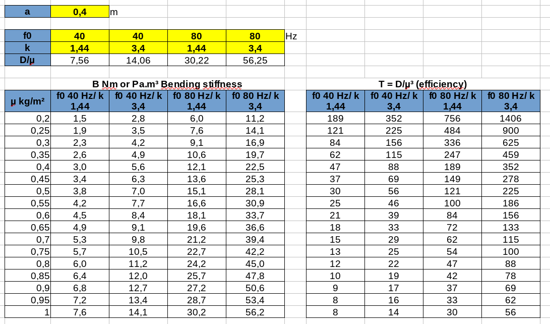

@Veleric &all
Eric,
I propose to adopt the following naming :
Assuming we can reach by the suspension simply supported condition and neglecting the effect of the exciter (not sure it is true for the low B value)...
* B/µ = [2.a².f0/pi/(1+1/k²)]²
My approach is to set 'a' as my target in width for the panel, f0 related to the targeted bandwidth, k as the panel ratio.
I made a spreadsheet of that to give the value of B according to µ
Here is a screenshot, attached is the zip file (xlsx format exported from OpenOffice... Linux computer!). Let me know if it works and if any mistake.
In yellow the parameter cells. 2 values of f0, 2 values of k (1.44 = 577/400, 3.4 you suggested
With that I understand why you propose a value of 10 for B where I am more thinking 3 or even less!
Christian
Eric,
- B bending stiffness Nm or Pa/m³
- µ aerial mass km/m²
- a short side dimension m
- b long side dimension m
- k = b/a side ratio
- f0 = 1st resonance mode (1,1) Hz
