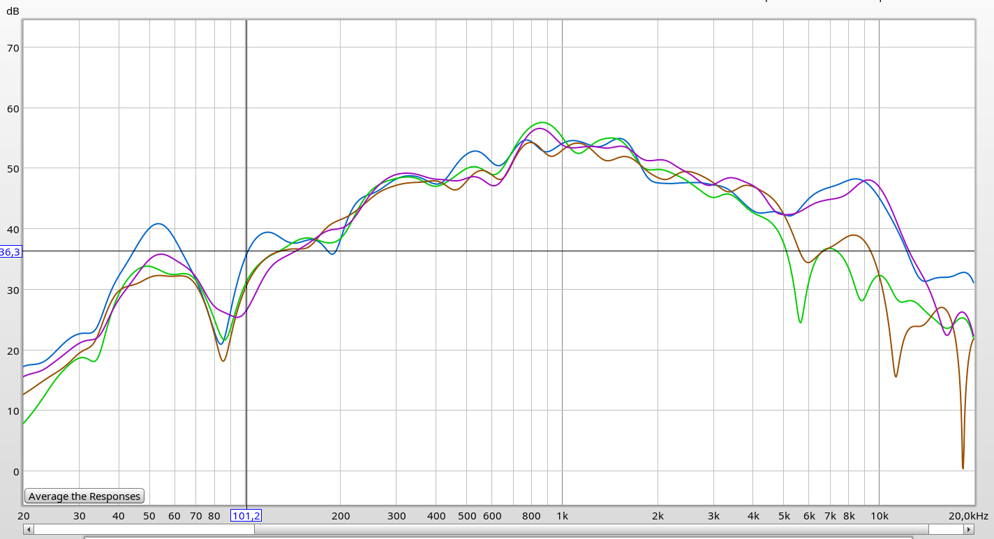

Hello,
I would like to come back on 2 topics under discussion those days... double exciters and role of suspension.
On post #5095 I shown 2 FR, one with one exciter, the second with 2 exciters with no big differences; encouraged by the exchanges here, different readings, I decided to make some additional tests to understand if it has to be a design rule (as suggested in the Tectonic patent to get a balance panel) for the future... and today something went different compare to the previous tests. With 2 exciters, there is a lack of HF. I tested different positions of the second exciter, no big change... what's wrong I don't know! What is true, I don't know...
The second test was to see what happened changing the way the panel is attached (string, corner hand held, on the side hand held). So it changes clearly the bass. When the panel is hand held at the bottom corner, the 1st resonance seems disappearing. @Leob, not exactly what you have but more close than before...
2 exciters test : blue one exciter at 2/5, purple 2 exciters post 5095 (previous test), green 2 exciters at 2/5 (symetric) today, bronw 2 exciters today.
blue : 2 strings attached on the upper short side (Spedge's method ;-) ), red : hand held at the 2 lower corners, pink : hand held at 0.22 of the length of the long side from the upper corners (similar position than Tectonic rubber fixation but only 2 points)

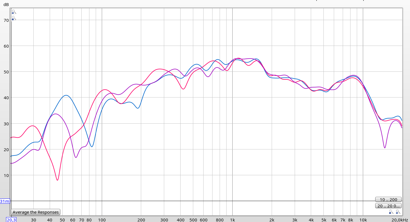

Hello,
That pink line is fascinating.
Christian.
basically when you are holding the sides with your fingers you are changing the standing waves on the panel.
I use this method to find places to apply weights.
I usually slide my fingers down the panel while watching in real time the output of the panel with pink noise.
with this method you can fill in some of the dips in response in the 100hz to 400hz region.
Steve.
