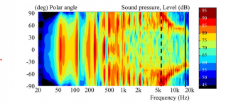

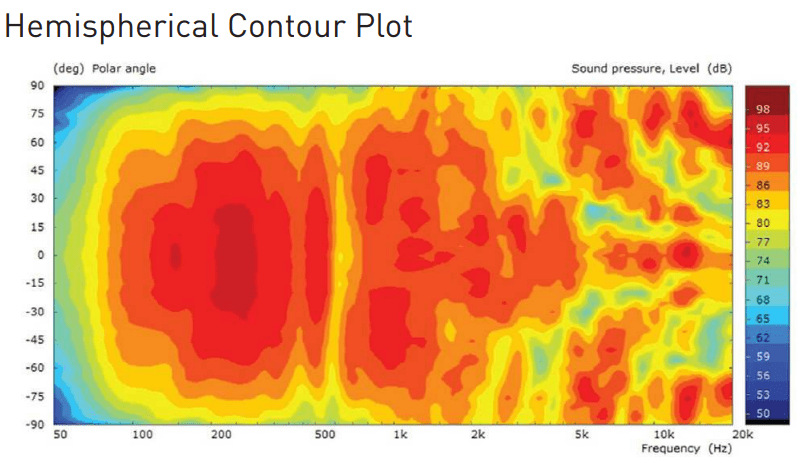

The difference is huge !
Gobel is trying to stop all reflections from the edges and prevent DML modes, this is a bending wave panel !
The methods he is using has been around for hundreds of years.
on beaches you can see water breakers or should I say wave breakers which are made of wood mostly and go out into the see ,to break up the waves, for the bathers.
The slits on the gobel panel do the same but with extra damping applied.
Steve.

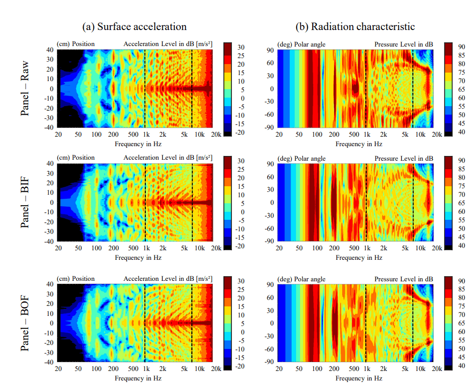

Good question to know if there is something in practice behind that... The paper might be much in advance to me! I will read at least the introduction.Yea, maybe, that's why I qualified it with 'presumably'
I did a simple calc last year with simple textbook equations and got around 1000 Hz I think for 3cm, which is in the ballpark, and I left it there.
To get an accurate value, you would need to use the correct higher-order theory, not the simple Kirchoff-Love theory.
Foam for example is much thicker than metal plates and deforms much more, so the poisson ratio, shear strength and deformation effects would be important. It would be nice to have it line up, but will it lead to anything you can use, practically?
I just found this paper may be of interest if you want to pursue it: https://matelys.com/publications/AMCTCG20.pdf
Christian

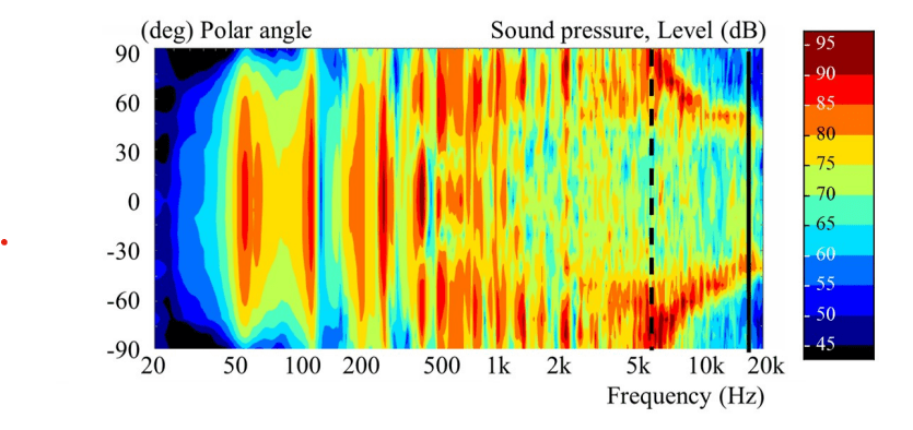

Steve,Christian.
Steve.
Academic papers say : infinite plate no sound... so finite plate with infinite edge absorption, does it make sound? A DML with a frequency dependent edge absorption makes more sens to me for now for smoothing the FR.
I understand and I see your example at sea shore but which example of real bending wave panel (in the meaning of full absorption) do we have (apart the Göbel for which I don't know paper showing this full absorption)?
Far from my little knowledge.
Christian

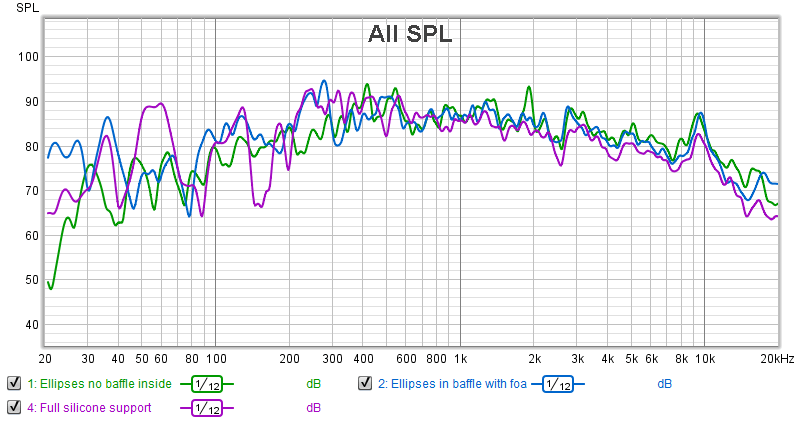

Here are some responses from the 4-ellipse panel I showed yesterday. They are all in-room with 1/12 smoothing. I'm sure I did one outside, but have not found it. All curves are comparable in the sense that the volume was set constant and the speaker was places in the same position in the room. The speakers were set diagonally in the room, facing toward an large (~2m x 2m) doorway into the hall, in an effort to reduce room modes.
In comparison with previous study of a plain panel of similar size (1200x600x30), I noted that the response seemed to have more peaks, and so a greater overlap between peaks, giving fewer large variations. I also believe there are more peaks below 100 Hz from the lobes, and this helps the bass response, but I need to repeat outside.
Paul
- Green curve is panel in free air. Note the relatively linear decrease below ~400Hz at about 20 dB/decade.
- Blue curve is panel wedged into baffle with light foam strips. I remember this sounded really good IMO, although I didn't listen for a long time. Bass holds up much better.
- Magenta is full support probably closer to simple support, panel siliconed to 7mm ply. Vibration and strong resonance through the baffle and frame.
Paul

You are right, the blue curve looks nice.
The difference between the green (free air) and the blue curve (foam suspension) is similar to what I see in my current tests between a free air panel (or even one suspended by 2 strings) and one with a foam suspension (even not all around the panel). My test panel is just a rectangular 520x30cm) piece of XPS 9mm thick.
Christian

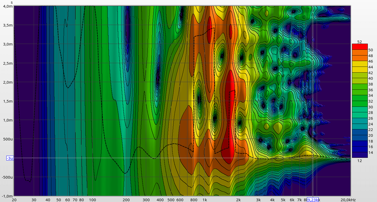

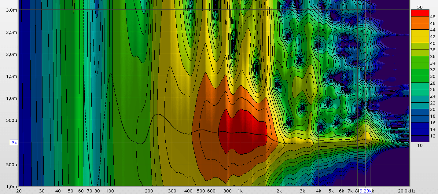

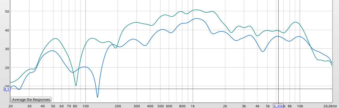

I made some measurements to see what happens at high frequencies with different materials
In the first FR below :
- blue 2.8mm plywood 17x27cm. The HF seems a bit smoother but not go very far beyond 10k.
Seems this light EPS sample has a lower capability to give HF.
There are 2 things to see in the spectrograms (see below)
Christian

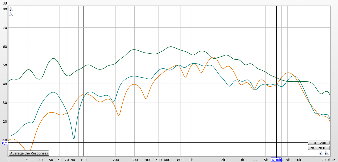

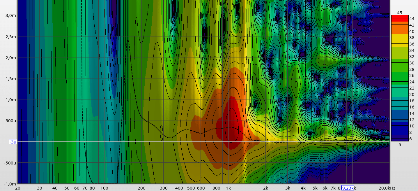

Hello Leob,
- blue-green (the lower one) is the XPS 9mm 20x30cm. See the hump at 9k. 20k is much lower
- orange is a 7mm piece of EPS (medium density I guess, it is from a packaging) 13x17cm. The hump is at 8k. 20k is low also
- green (upper) is a large 60x80cm 20mm light EPS (15kg/m³). No hump. The level was increased by 10dB for reading. If you remove those 10dB, this panel is below the others from 4k and above.
- The free panels (only linked to the voice coil) might show important level far in time from the origin
- The PS panels show this resonance in the 8 to 10k area that plywood doesn't have.
Christian
All those measurements are from today. Same panel, mic position (mic at 1m), no change in the environment.
Christian
Free EPS 7mm
XPS 9mm on 2 strings
Plywood

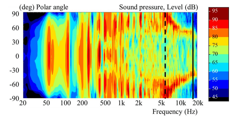

I've looked for it myself by holding positioning the mic at just a bit less than 90 deg and looking for a peak in response that "should" be there. I've never found it. But, if you have good enough equipment, apparently you can. This figure is from a Paper by B Zenker (link below) and shows the change in directivity above the coincidence frequency, indicated by the dotted line.Again on coincidence frequency, I'd be very interested to observe it somehow on the panel. I believe that at coincidence you should see an abrupt increase in the SPL measured at 90 degrees to the panel normal (ie along the edge of the panel).
I looked for it and never found any evidence of this. Maybe will try again when I get time to drag everything out and make a start.
https://www.researchgate.net/public...-_Evaluation_of_the_Voice_Coil_Break-Up_Modes
The Tectonic site includes this plot which shows a similar change in character above about 5 kHz, coincidentally (haha).
I'm thinking that these plots like these would actually be a useful basis for discussing the "regions" of the frequency response of a DML.
Eric
Further along the lines of defining various regions of the frequency response, it would be useful to look at the surface acceleration plot along with the polar frequency response:
https://www.researchgate.net/public...zing_the_Off-Axis_Radiation_below_Coincidence
It's especially cool that you can see in the surface acceleration plots that the (1,1) mode is operating at about 70 Hz, the (1,3) mode at 100 Hz and the (1,5) mode at 180 Hz! I wish I could make those plots.
Eric
