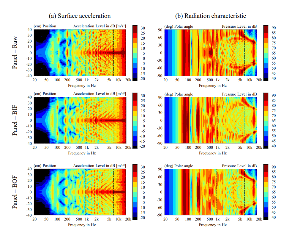

Thank you Eric! Your two posted links have done more to further the discussion and real knowledge about this topic, than all the other 268 pages of this thread put together.Further along the lines of defining various regions of the frequency response, it would be useful to look at the surface acceleration plot along with the polar frequency response:
https://www.researchgate.net/public...zing_the_Off-Axis_Radiation_below_Coincidence
It's especially cool that you can see in the surface acceleration plots that the (1,1) mode is operating at about 70 Hz, the (1,3) mode at 100 Hz and the (1,5) mode at 180 Hz! I wish I could make those plots.

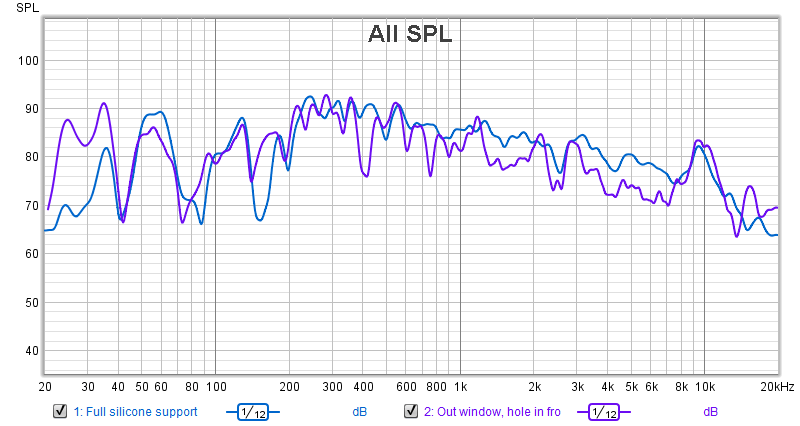

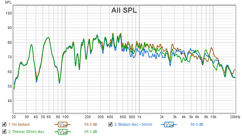

I did some further tests last year to the area opposite the exciter on the same ellipses setup I showed yesterday.
First I drilled a hole through the XPS to test cavity resonance. Purple curve is with hole. So, not cavity resonance.
Then I did a series of tests with blutack balls, radial strips, and discs of different sizes. All of them, where they helped the peak at 10 kHz, also affected the response much lower down. Here are a couple of relevant ones with discs. Brown = no blutack, Green: thin 30mm disc, Blue: thicker 30mm disc.
The peak is moving to a lower f, which does support the oil can resonance theory. But both effect the lower part of the spectrum, and bring on the HF rolloff even sooner than before.
I think the correct approach will be surface treatment or surface layers, to stiffen the surface or increase the bending stiffness to the point where the peak occurs above 20 kHz. Note this XPS had no surface treatment, but did have a circular layer of epoxy below the exciter to get a good base, then it was glued onto that with superglue.
Yes, see my response to Steve. I think increasing surface hardness or bending stiffness with panel surface treatment or additional composite layers respectively is the correct approach for foam, to take the peak/cliff beyond 20 kHz."Oil can resonance" is the name of the phenomenon. I have in mind 2 countermeasures : a very small mass at the center or a hole. Does this say the root cause is the 1st mode of the disc within the coil area (with a pinch of the air enclosed behind between the panel and the magnet?). With the stiffness of the plywood, the mode is rejected above the panel bandwidth?

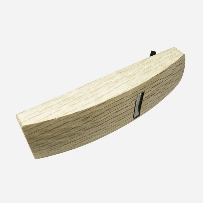

- which wood is it ? which section?
- the hand planner is it to give the concave shape we see at end of bracing like on a piano sound board? If yes why to it after gluing?
Hello Christian,
the lighter colored strips are poplar and the darker and longer ones are red oak.
Poplar is quite soft and bends easier and the red oak is much harder and hopefully prevents the panels from bending long-term.
The hand planer I used is a very small convex japanese style planer that lookes like this one:
The strip have to be glued onto the board so that you can tune the board step by step via tapping and carving.
