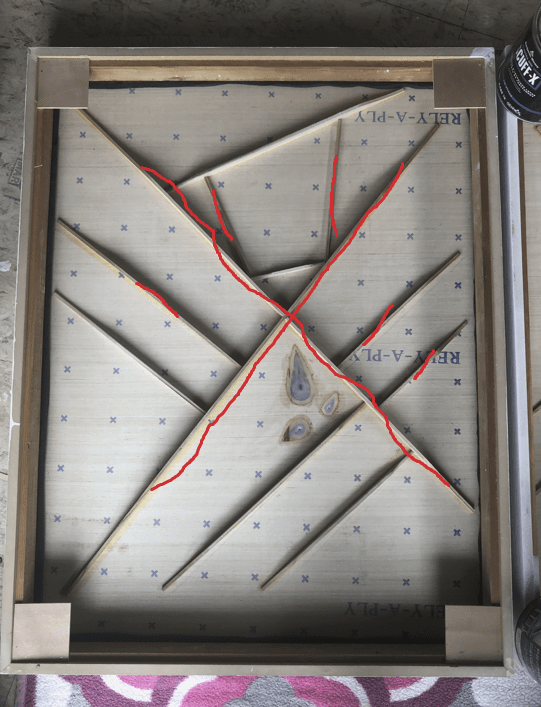

Congratulations on your success Sebastian.Ok, let me try to give you a rough idea about this. Just briefly, because I decided to provide a proper pdf document with all decisions I made that led to here.
1. I read this forum on and off for quite some time and identified the outlier approaches as well as the commonalities among everyone's experiences.
2. I tried to find research papers that would support the topics/ techniques that I identified in step 1.
3. I decided to do a very naive approach and do things similar but still different. (e.g. the foam suspension was done by many, but not like this.)
4. I tried to find the principle of DML in other applications and found the top of a guitar. Here, based on the naive approach, I asked myself, if luthiers do that for hundreds of years, why question it and therefore just give it a try.
5. I did some research on the principles of guitar bracing, the different sound quality of ply wood oppose to tone wood.
6. I did not try to fight material sourcing constraints and just went with what I was easily able to get and moved the fancy solutions, like tonewood, composite boards and such into the future. First a proof of concept, then the real deal.
I can't really teach what I did, but I can provide the sources that I took as a basis so far, document in pictures what the panels look like now and explain the steps how I built them.
Because these forums are going over years and so much information gets lost, or is hidden in 300 pages of posts, I'd like to bundle my experience in a document once I think I reached a milestone, so that others do not have to make the same mistakes, or can take individual steps and repeat/test them on their own panels.
But, I'll have to do some reading about speaker measurement so that I can be sure that what I record and what I derive from the recordings makes sense.
All this is probably not what you asked for, so here is the main answer in respect to guitar bracing.
I googled guitar bracing and tried to find as many different bracing types as possible. There are many sources that explain how they sound different.
I picked a Yamaha classical guitar bracing because I assumed that nylon strings need more support in the higher registers than steel string guitars.
Here is a good article about the different types:
https://www.thisisclassicalguitar.com/bracing-styles-for-classical-guitars/
What I did is I picked one, then I marked a the 3/5-2/5 position on the panel with a pen so that I could ensure that no brace would cover that spot. Now, I took the longest wood braces (one of those that shape the main X) and set that diagonal over the panel. The second long brace was positioned from the other corner on one side to the golden ratio position of the opposite side of the panel. I decided to not have a symmetrical cross on the panel to avoid unwanted resonances and a greater variety in possible tones (at least I naively assumed that would be the outcome). Then I just eyeballed the angles and distances of the leftover braces and glued them also to the panels.
Once the glue had dried, I looked at the guitar bracing picture and eyeballed the carving that I'd roughly had to do. Once I was done, I held the panel up in the air by holding it between two fingers and I started to tap the panel at different spots, and voila, I was able to hear many different tones. And then I put the foam on, and glued the panels onto my frames,...
I wish I had easy access to 3mm ply sheets in that size, but 5.2mm had to suffice. I can imagine that bracing, if done right can allow you to make much bigger panels, without fear that the panels bend once you hang them into a frame.
I assume that a main part of my panels' struggle in the 70-150Hz region is due to the center cross brace. It avoids the first mode and second mode, I think. I'll try to make that less rigid once I have the new exciters in.
Next step, once the new exciters are on, I'll lay the panels on the floor and put sawdust or sand on them to see what the patterns look like at different frequencies and then I'll try to change the sound output for individual frequencies.... that'll be a fun.
Ok,.. that is it for now.
In short, no science only naive following of what has already been there.

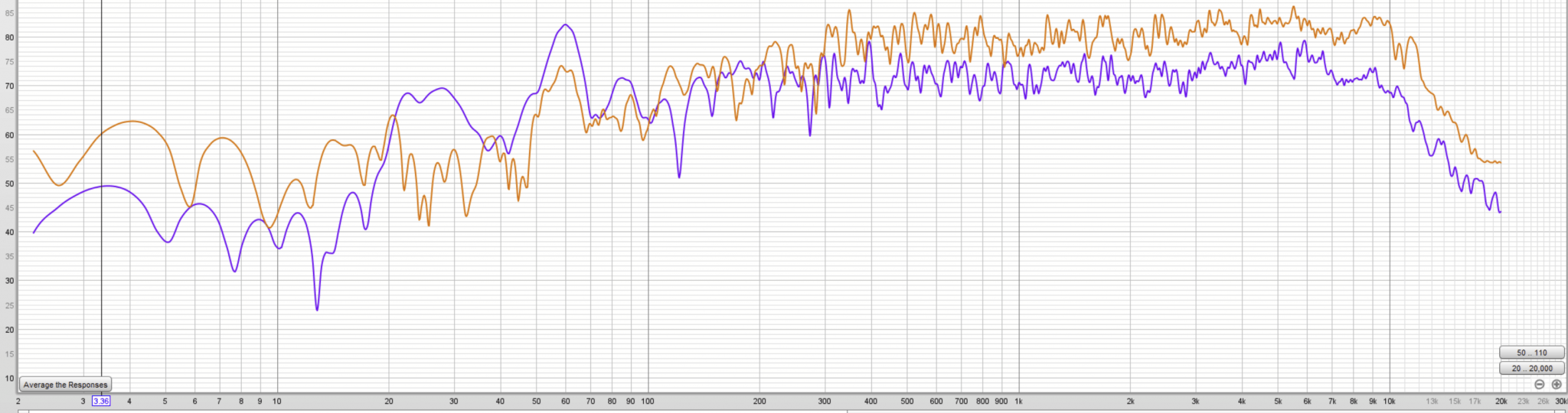

Sebastian,
Another great post, thank you.
The only decision to made that I would perhaps second-guess is starting with the assumption of 2/5, 3/5. That "rule" seems to have very limited use which doesn't extend to your design. I would think it would be more effective to do your bracing as you describe except without a preset exciter position and then test the panel with exciters at different positions between the bracing.
Also, I would not look at your hole in the low frequency as a bug, but rather a feature. A sub at the low end is going to be your best best anyway and having a panel resistant to those frequencies would seem to help resist distortions in the frequencies that matter.
I agree you should expect more HF power with thinner wood.

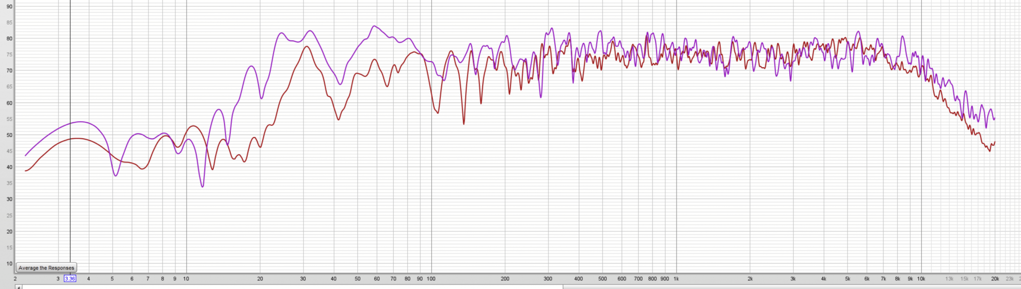

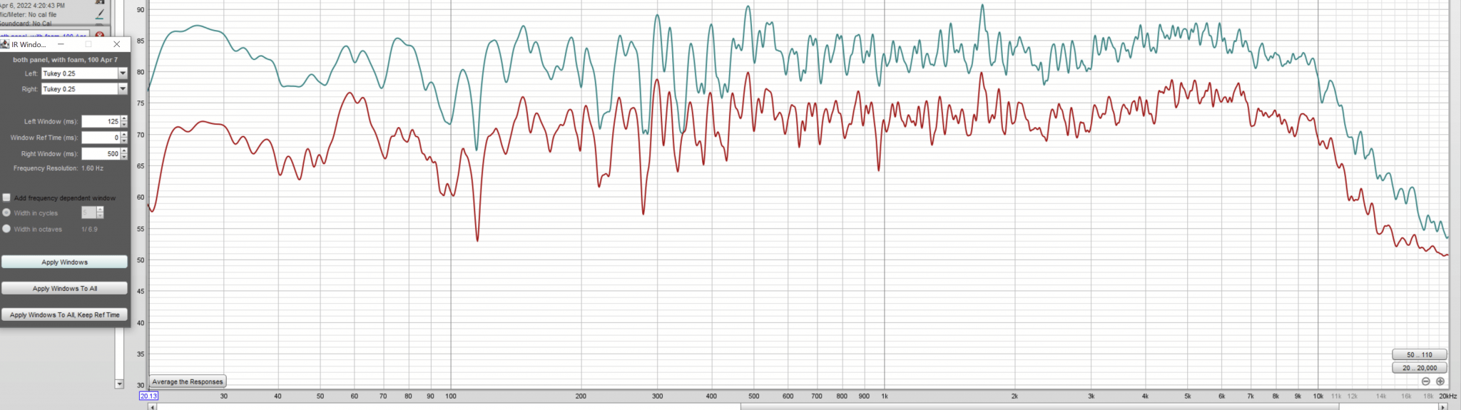

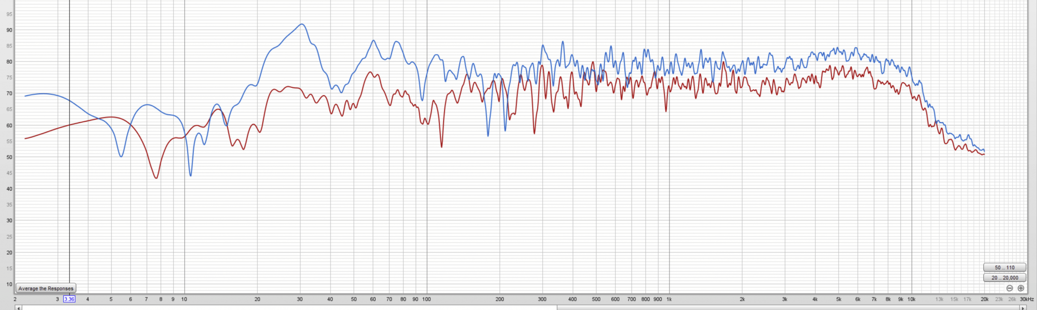

SebastianHello Sonnar,
yes, the drop is really bad, but I will not bother until my other set of exciters arrived.
I did not expect the current setup to do much above 10Khz because the exciters I use have nothing to offer in that range.
Right now I have the following two wired in series:
https://www.daytonaudio.com/images/resources/295-240--dayton-audio-daex30hesf-4-specifications.pdf
https://www.daytonaudio.com/images/resources/295-230--dayton-audio-daex32ep-4-specifications.pdf
And my goal is to have two of the following wired in series:
https://www.daytonaudio.com/product/1184/daex25shf-4-steered-high-flux-25mm-exciter-20w
My amp is a TU-8300 from Elekit and it only provides 6Watts max per channel at 8Ohms.
The current setup with the 40Watt exciters rocks the whole house and the 200 Watts 10" inch sub has trouble to fill in the gaps for these large panels.
Unfortunately, an organ, or a drum set will still need a little more power from this system to sound real. I have not tried to listen to orchestra music, but that will probably ask for a bigger amp and maybe 4 of these panels and definitely a much bigger sub.
However what I really like about these speakers is that you can really crank them up and they are not tiring the ears as much as e.g. my Cornu spiral speakers. The mids and heights are very charming.
We will see where this journey will end. So far I am very pleased.

I just had a look to the specification of the exciters you chose... The surprising point for me (but I have experimented only one model...) is that the 30HESF has a 0.31mH inductance, the 32EP a 0.21mH inductance and the 25SHF has a 0.41mH inductance.
So we could expected with the 25SHF a lesser HF performance than with the current one. With those exciters, I'd try a capacitor in parallel of the 30HESF. Not sure of all of that but you will find post #5065 a quick test I did adding a 0.33mH inductance in series with my exciter.
Like that I don't understand your choice of the 25SHF
For now, I have only used the DAEX25FHE-4 I chose for its low voice coil mass (no proof it is a must) and its low inductance 0.1mH (here some indication it is a good choice for HF)

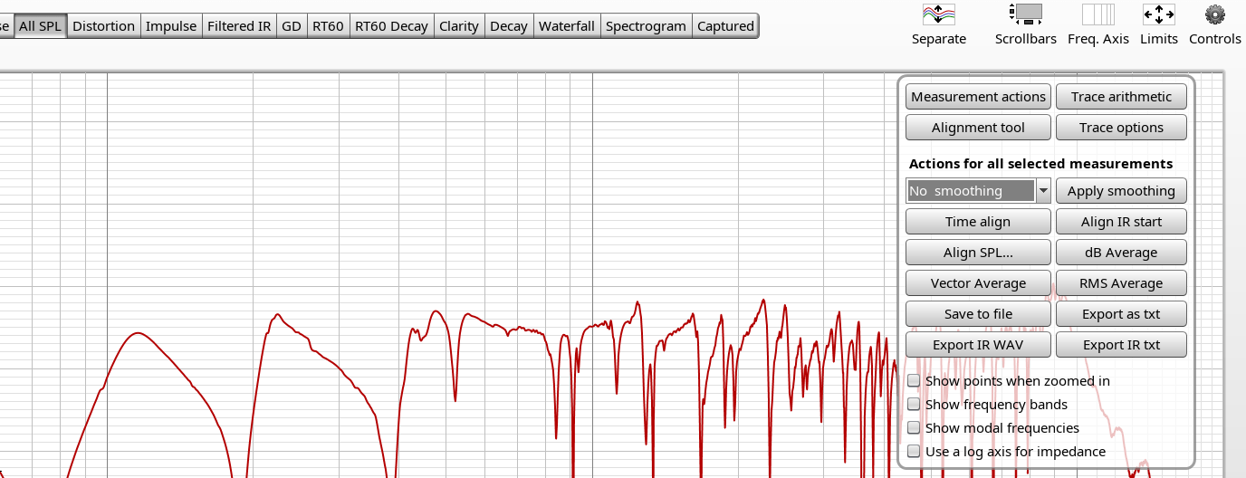

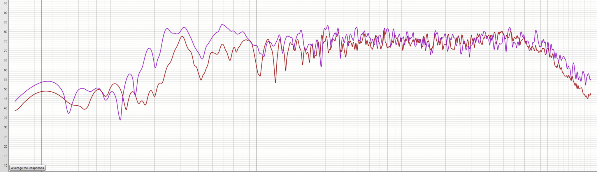

It took me time to install the last version of REW on my Linux computer!Well, this is when I uncheck that box.
Is that the one you are referring to?
It is the same graph as the last one I posted
I'll reply to the rest of your post tonight.
Sebastian
So if somebody wants to do it, the trick is to enter "export INSTALL4J_JAVA_HOME_OVERRIDE=/usr/lib/jvm/default" at the terminal line before launching the script. This says to script where to find Java environment. Sorry no link to our topic but if it can help somebody...
So the box you show is the one I suggest to keep.
The smoothing I suggest to remove is the one on the graph.
2 possibilities :
Graph > remove smoothing or Ctrl+0
or under All SPL
controls > no smoothing

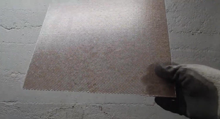

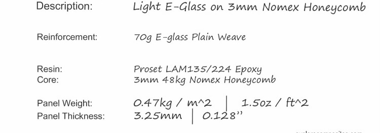

Lighter panel, more exciters, higher motor strenght?
Light composite panel 20x30 cm can weigh 20…30 grams, how much motor strenght would be optimal?

I don't understand precisely the problem you are referring too...How would you solve this dml problem as best as you could?
The DML is by nature modal. It leads to interesting properties like no need to enclosed the rear wave, about no directivity, no relation dimensions high frequency. The bad side is an uneven frequency response which by its nature is I think (not tested) a good candidate for EQ. The exchanges here show countermeasures before EQ might be possible working on the damping or the panel structure (bracing).
It is perhaps a matter of requirement but at the moment I have no problem to live with the sound of my current panel (without EQ) even if the FR is "ugly" according to the standards, thanks to the other qualities. Despite this strange frequency response, the sound is really pleasing. The point is to be at ease with the new paradigm.

I am by far not done with removing material from the bracing, but I had to wait for the microphone. However, I can already tell that as soon as you remove a little too much, the ply sheet starts to bend towards the front side. At least mine.
I am working on a stereo pair. Maybe I was not explicit enough about that. I have to panels, one has the exciters placed on the blue and the other one at the red markings in the picture.
The braces stiffen the board significantly. I was too afraid that the sheet would bend into several directions once I hang it up at the ceiling. The bracing introduces drum like behaviour when tapping onto the ply wood sheet. At first the big sheet didn't really "sound" at all, it was in fact dull, now it has clear tones. My goal is to produce as many as possible tones and to then efficiently dampen the panel so that resonances are avoided.
Always dabbleing, yes. I will climb the ladder very often soon :-D.
I am not 100% sure if I understand you damping upward question correctly. Can you please further elaborate on that?
I laid the panels don onto the floor today, to see how dampening might be an issue. I have 1 inch thick sheet of foam that will cover the backside of the frame. today it was below the frames with the panels. No real difference except for a little more bass.
I'll post a picture tomorrow that that the construction is clearer.

I put the panels on the floor and did some tests today.
It was amazing!!! It "felt" like I had a 1:3 scale miniature band in my room standing on top of the panel. the sound quality was identical, although I sat in a distance in a very shallow angle. Both panels have quite a different sound, but I will post about the how and why at some point later.
Here are the differences.
The microphone was not moved, but unfortunately the volume knob was different compared to yesterday.
The panels laid in their spots from the day before but quite a but closer to the microphone. I just turned them and dropped them towards the mic. The "average" distance was now 1m instead of 2m. The mic was 70-ish cm off the ground.
Purple was yesterday's graph, panels upright, no subwoofer, 2m from the mic
Orange was today, flat on the floor, no subwoofer, 1m in average from the mic.
300Hz to max has not really changed.
And now a test with the subwoofer and the microphone 2 meter hanging above and centered between the panels. 3.5m away from the sub.
The subwoofer volume was the same in both recordings, panel was different volume, but same difference to the day before as in the above graph.
Red yesterday's panels standing up + subwoofer with 100Hz cuttoff
Blue today panels on the floor, mircophone hanging above them, sub as above.
I do not really see a noteworthy difference. but what I observed is that the room modes play very much into the measurement below 300Hz.I moved the microphone up a little and I got quite different responses around 100Hz.
The 4ft length of the panels should translate into a DML low end of around 68Hz for 1st mode at half wave (if I understadn that correctly). Most of my measurements see peaks in that range and therefore I will try to get the panels as linear as possible towards 80 Hz,... and then the sub may take over,...
But much more reading in this thread will be necessary....

Meanwhile, I can show you the differences between both panels and the positions I published earlier.
Somebody here might have more experience to comment how a non-braced panel would behave on these different positions, and how the FR might look different.
No subwoofer used in the following recordings but mic only 40 cm away from the panel.
red is the exciters in red position, on the epoxy spots (more "dabbling on that idea coming later").
purple are the exciters in blue position, where the hole in a guitar would usually be.
however, the bracing is a little different, I assume.
Anyhow, the purple panel expresses much more brilliance than the other panel. I assume more bass is due to the fact that the blue exciter position is closer to the center of on part of the 2nd mode.
The red panel has tighter mids.
Sebastian

Sorry, I mixed the exciter positions up. the pruple curve is the exciters in the red position.Hello NaRenaud,
I think you are 100% right, and I think I can prove it, I just have to wait for my other set of exciters, then I can make some placement comparisons.
I'll try to make outdoor recordings for that. But this will take a little time.
Sebastian
red curve is the exciters in the blue...
Sebastian
