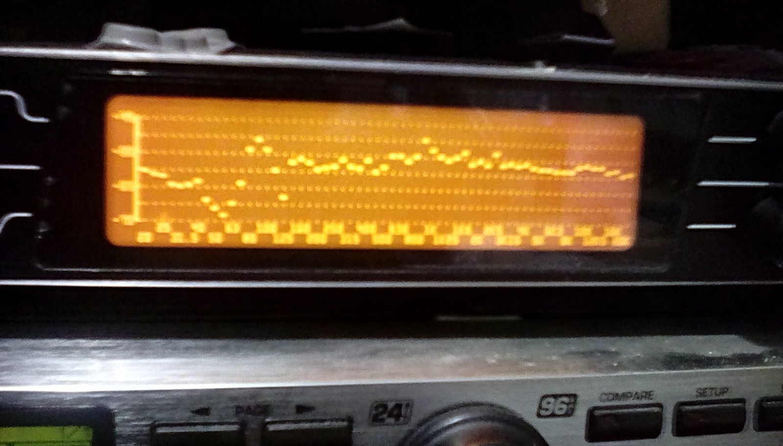

I just did a rough and ready response plot of the new three strip low quality ply.
the response looks pretty good to me all the way up to 20k even though the exciter is only stuck on with double sided tape.
the low end has the usual resonant hump but this time it is at about 80hz and falls like a brick at about 60hz.
The microphone was at about 30cm.
There is a little blip at about 1k which I suspect is a little exciter noise, which I will have to fix at a later date.
I've been playing them in conjunction with the art panel with the same panel materials and they work together well.
Obviously the art panel resonant hump goes down to 40hz which helps fill out the sound.
The efficiency of this material is quite amazing, I have not put it up against my large EPS panels yet but expect it to be quite close ?
I am now thinking of applying another strip, the last one, and seeing how it goes ?
Hopefully it won't fall apart ?
Steve.

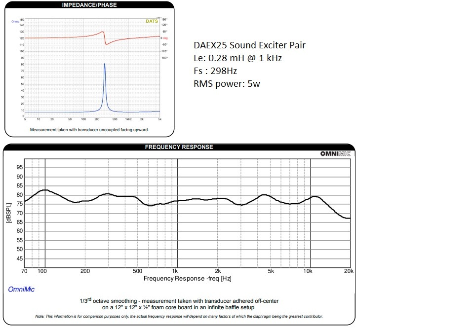

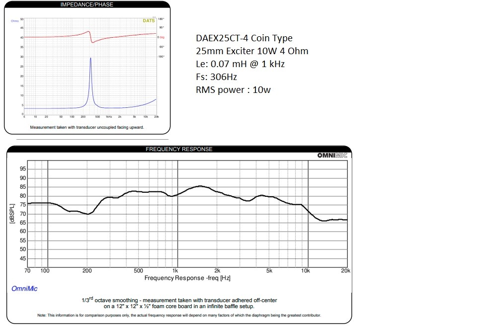

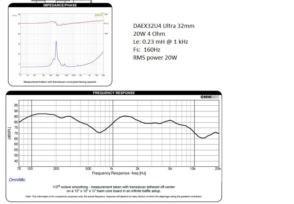

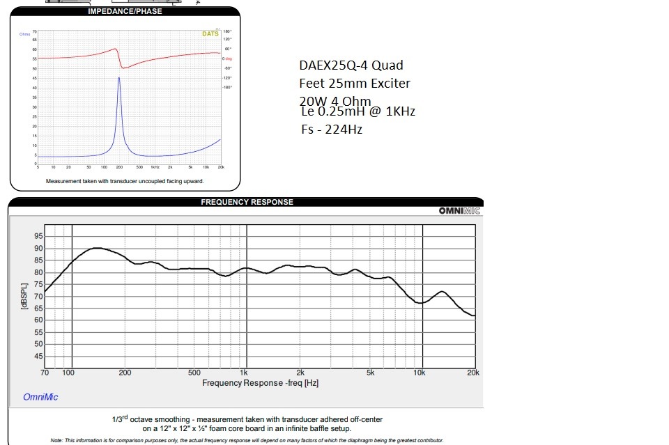

Could you please help in choosing exciter out of the below models which are available here. Attached the response graphs given in its data sheets.
DAEX25Q and DAEX32U are rated at 20w, and DAEX25 at 5w, and DAEX25CT at 10w
The more popular one DAEX25FHE is not available here and is out of stock.
Thinking of using them with Canvas panels running full range to start with.
One common thing in the data sheet graphs is that all the models have weaker top end / treble after around 10KHz. And for DAEX32U we have a dip at 700Hz. Do we see similar behavior when used with plywood or canvas panels

Hello Steve. Very good! Welcome to the sound of plywood panels?
I know it might be difficult for quick measurements but a rule of thumb seems to measure at 3 times the panel large dimension (or listening position if the panel is really big!).
About the efficiency, plywood (light one?) is not so bad but I would be surprised it reachs EPS performance.

Sarathssca,
I can't go in the spec for now but what I have in mind from the last posts on exciters :
  • The frequency response shown are not relevant (too panel material dependent)
  • Choose the lowest inductance, the highest force factor (BL)
  • 20 or 25W is ok, 10W probably but not less (Spedge's advice if I remember). In my opinion low inductance is more important than power handling.
...with that I am afraid the answer is DAEX25FHE... You should find a post from Spedge about the Tectonics exciter he have used.
From the previous posts reading, to be patient or search for alternative source with the right exciter might be a good option.
Christian

I'm not new to ply panels.
some of my early experiments were with ply.
but this ply sounds different , it has a lighter sound , more similar to an EPS sound 😱 than a ply , with very good efficiency , not sure yet but I think it comes closer to the EPS than you imagine ?
I made a test with a small 8inch EPS panel which had a similar db level .
But I will not be sure until I match it with an old panel, that I know has high efficiency.
Steve.
