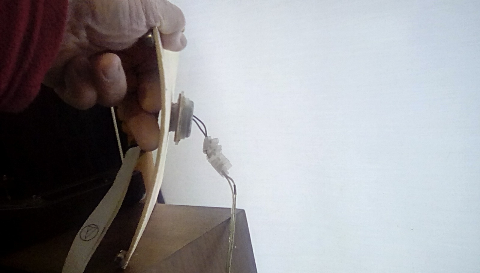

As can be seen in the photo, the panel bends easily on its short surface , but not so easily on its length.
what it would sound like the other way round ,I have no idea.
but this panel material works very well ,sound wise .

Hello Steve,As can be seen in the photo, the panel bends easily on its short surface , but not so easily on its length.

By the way I am happy you find quality in this plywood. I think it is close to poplar.
This morning I had a top of box (similar to a crate)... The difference of stiffness in both direction is really important... I don't know really the consequences but probably the aspect ratio as no meaning then. We should think about the dimension in low stiffness direction multiplied by the ratio of the stiffness (high stiffness on low stiffness).

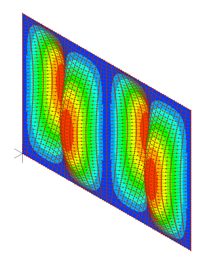

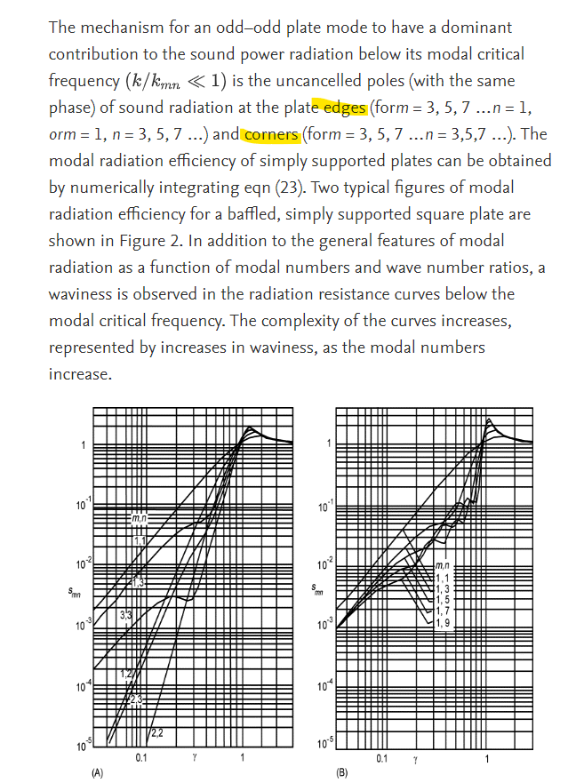

Okay, so by "edge and corner modes" you did not mean the flapping edges and corners of a free panel, but rather something else.For a finite plate, the radiated sound is not zero, because there are un-cancelled portions remaining at the edges and corners of the plate. These are the so-called edge and corner modes, which are the source of sound for panels when f<fc. They occur in all supporting conditions, clamped or otherwise. They are often mentioned in the literature, including the one I last referenced https://www.researchgate.net/publication/272518312_Radiation_efficiency_of_damped_plates. (Well, actually they explain in a similar fashion why a damped infinite panel has non-zero efficiency).
That is a great link by the way. And it references a lot of the seminal work in this area, which reminds me I have some reading to do!
But I'm still not following what you mean by edge and corner modes. I skimmed the article twice but still didn't see it referenced (although I guess you saw that too). Is there another paper that talks about edge and corner modes? I don't ever recall seeing that terminology, and I'm still confused what they are.

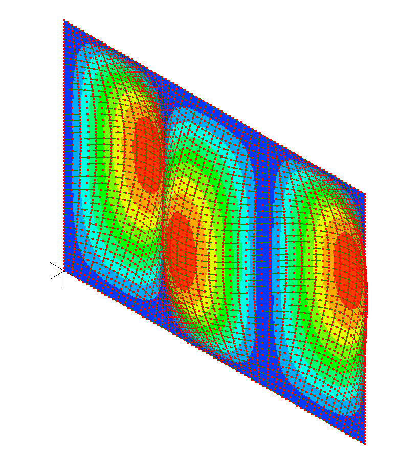

The sources I have found mainly talk about how, below fc, the modes with the highest radiation efficiency are the odd, odd modes. I have always assumed that the reason for this is that those modes (like the 1,3) shown below, are unbalanced and hence not fully "cancelling". That is it has two regions that are out of phase with the one other region.
![1650210847117.png 1650210847117.png](https://www.diyaudio.com/community/data/attachments/953/953514-53ec489010be0e9c8b01f05eadabf150.jpg)
While modes like this (1,4) on the other hand, have identical regions moving in opposite directions, and hence tend to cancel each other in the far field.
![1650211069458.png 1650211069458.png](https://www.diyaudio.com/community/data/attachments/953/953515-11ced802ea02f4baf0d7b7778a717836.jpg)
But this effect is not dependent on damping, so perhaps it is still not what you are talking about.

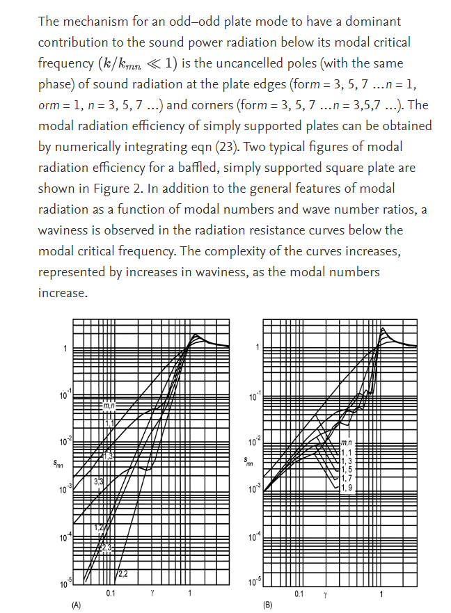

pway,
What I was talking about is this ( but better explained and shown):
https://www.sciencedirect.com/topics/engineering/radiation-efficiency
Eric

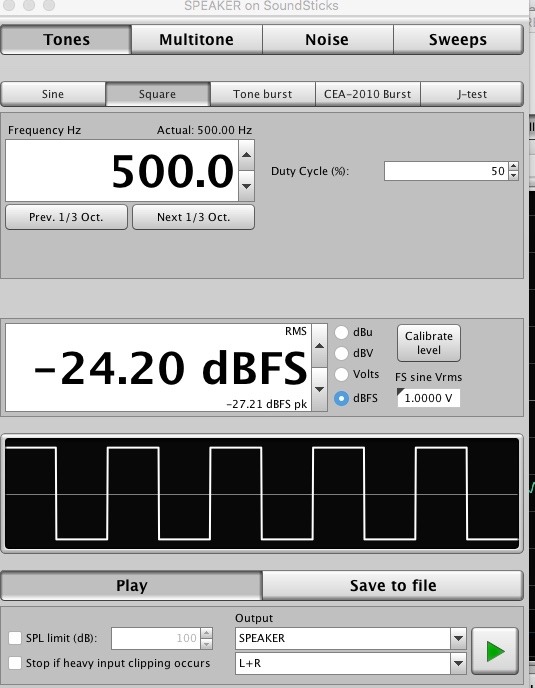

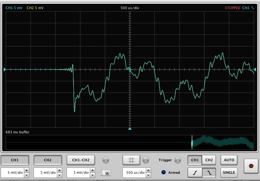

Would it be possible to post some data of your composite CF Balsa CF planar speakers using REW Signal Generator and Scope ?
Here is what I see with my 3mm Colplast panel that is 900mm x 300mm and a 20W driver I was driving at 500Hz square wave 1Vrms and here is the oscope response of what the UM1k-1 microphone picked up. I would like to see the response of your speaker My panels are not clamped at the edges but are suspended by thin stainless wires at the top corners.
I think this shows the some of issues with panels with mass. It shows a slow rise and fall time with various oscillations which may be due to the reflected waves from edges of the panel. I be curious to see how your panel response is since if I am not mistaken is clamped and should be way stiffer with the CF than the polyethylene plastic that I have been using.
Again many thanks in advance

I think I probably can. I've never used the scope function on REW (didn't even realize it was there!) so there may be some learning curve to it.
I have some other stuff I'm working on so may take a few days, so be patient.
My CF balsa panels are actually not mounted at the moment. But I have frames that fit that I can easily mount a panel to in a matter of a few minutes. It won't be "clamped" but would be attached to the frame around most of the perimeter with any one of several double sided foam tapes. It's more like "simple" (i.e. hinged) supports than clamped. Would you like me to choose a foam tape that has high damping, or low damping? Is the mic at 1 meter?

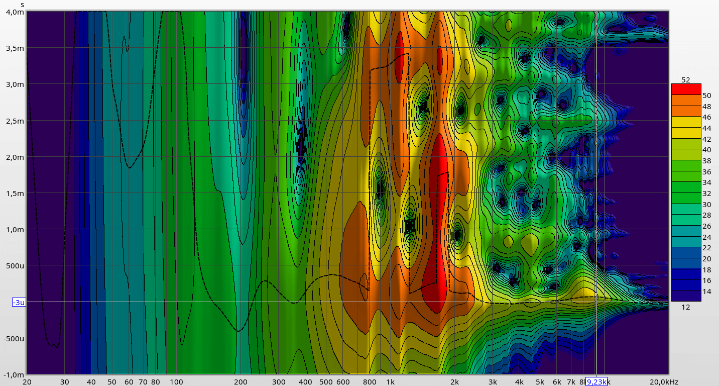

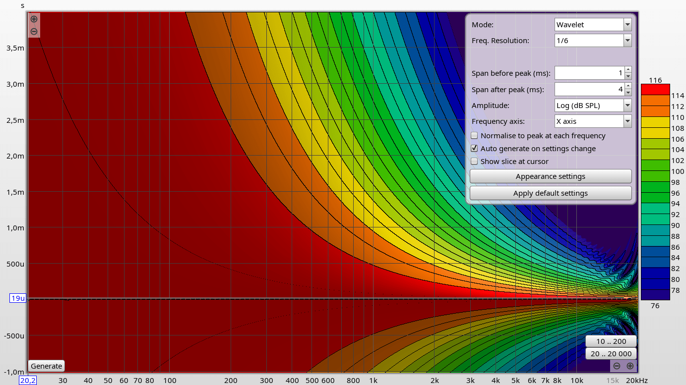

May I suggest another method... REW offers a spectrogram function that give a 3D view : SPL according to frequency and time. I use the wavelet option.
Below is the spectrogram of a "pure" pulse leading to a flat FR. You'll see in the box the settings.
After is the spectrogram of a completely free small EPS panel. See the "islands" that occur after time 1ms are I think the signature of too low damping, reflections at the edge.
