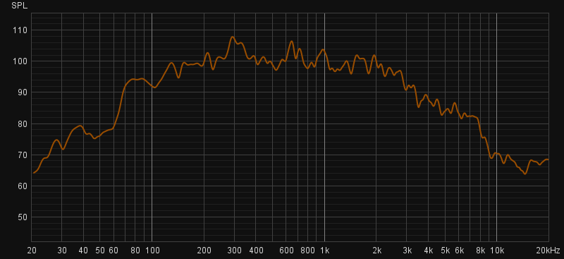

Tried fixing the exciter first with the hide glue, but somehow it didn't see to stick to the plastic on the exciter. Maybe if I would been more patient it will adhere, but when the glue was sticky enough to adhere to the shellac surface and my fingers really well.
I also tried shellac, and it seemed to be working ok at first, but after playing loud for a while one exciter fell off. Again, I might have been a bit impatient, and I let it harden overnight if I try it again.
The results with the 500x330x10mm neopor with hide glue and shellac was both disappointing and encouraging.
The disappointing part is that drop in HF is still there, and the FR doesn't look better, but is less flat:
It is weaker between 3-7k which makes it sound duller.
However, despite that it is the best sounding plate I have so far, especially when pushing the volume. The sound is more focused and it distorts less. Things sound punchier and interestingly when playing in stereo with the 25mm styropor, even if it has less HF and slightly lower sensitivity one gets the impression that sounds come more from the side the neopor. I would have though loudness and HF response would be more important, but I guess it has tighter transients despite the lower treble.
Also it seems to respond better to EQ, and when I try to adjust to get a flatter graph, the different between the neopor plate and styrpor becomes very big.
I think some tweaking can smoothen out the FR a bit, but my hopes of getting better HF response with the harder shellac surface was obviously false.

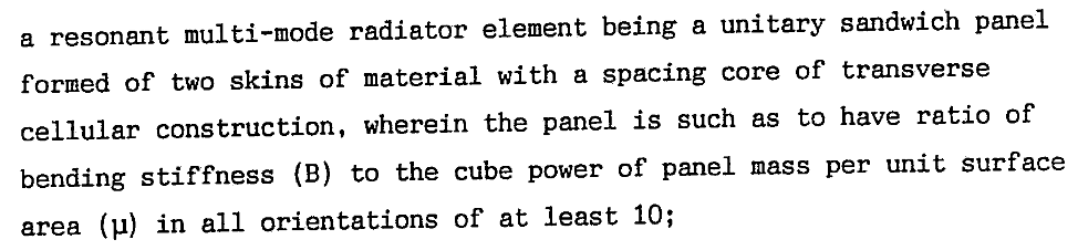

Thank you for the correction : yes "areal mass".
The question about the role of B/µ or B/µ³ was started a long time ago by Veleric. When I joined the discussion, we (Veleric and I) exchanged about that.
I have in mind 2 sources :
- one thesis about piano soundboard : Piano Sound board thesis
- one patent : WO1992003024A1
You can have a look to my previous posts I did to answer to a question from Cheapvega some months ago.
I reported about some quick tests (acoustic experiments in a living room!!!) that linked SPL to the B/µ³
The main outcome was the thickness is not a 1st order parameter of the efficiency (efficiency in the meaning of a SPL at some distance for a given input). The parameter is E/rho³ (E Young modulus, rho density) which is the same as B/µ³

The factor that has been the subject of much discussion here (and forgive me, I havn't read all the correspondence on the matter!) appears early in the paper (p8) as 'radiation ratio' , 'acoustical constant' or 'Shelleng's vibration parameter
R=sqrt(E/rho^3)
I was about to refer to this paper https://sci-hub.se/https://doi.org/10.1121/1.4906186 which relates radiation efficiency for f<fc to damping factor eta. Then I read that the piano paper also draws a connection to damping. And indeed, with Eric's graph of acrylic vs plywood vs foam giving increasing SPL seems to suggest it could be damping playing a role.
I have to read these more carefully, as Im not sure I understand anyway. There are at least 3 sources of damping mentioned in papers, which is really just talking about energy losses - internal frictional damping, conductive damping (energy lost eg to the frame and surroundings) and radiation damping - the energy lost to radiated sound. If the relation is just between this factor and radiation damping, then it may be just another way of stating the same thing. And I cant see why the factor would have a relation to viscoelastic damping anyhow. OTOH the paper I cited above is talking about internal, viscoelastic/frictional damping related to greater efficiency at low f.
