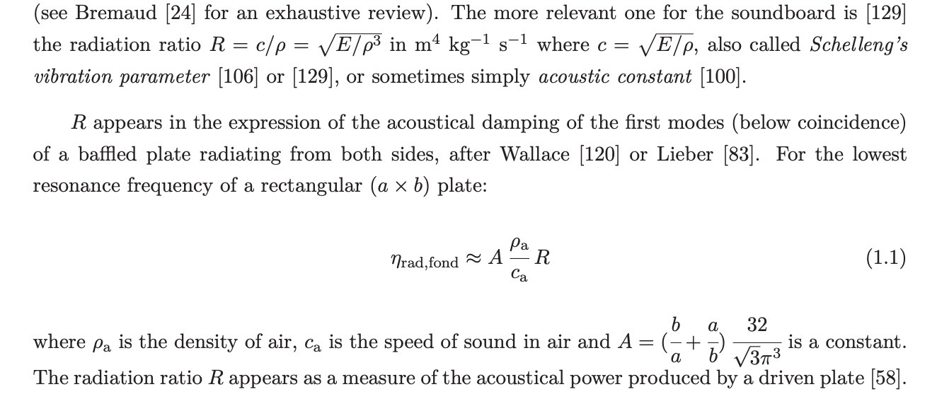

Hello PaulI read the first chapter of the piano soundboard paper (the only one in english). Very interesting how many concepts are common between musical instruments and our goals here. I split off the appendices and tried to translate, but the equations were mangled. Those appendices cover a lot of the important concepts for our purposes.
The factor that has been the subject of much discussion here (and forgive me, I havn't read all the correspondence on the matter!) appears early in the paper (p8) as 'radiation ratio' , 'acoustical constant' or 'Shelleng's vibration parameter
R=sqrt(E/rho^3)
I was about to refer to this paper https://sci-hub.se/https://doi.org/10.1121/1.4906186 which relates radiation efficiency for f<fc to damping factor eta. Then I read that the piano paper also draws a connection to damping. And indeed, with Eric's graph of acrylic vs plywood vs foam giving increasing SPL seems to suggest it could be damping playing a role.
I have to read these more carefully, as Im not sure I understand anyway. There are at least 3 sources of damping mentioned in papers, which is really just talking about energy losses - internal frictional damping, conductive damping (energy lost eg to the frame and surroundings) and radiation damping - the energy lost to radiated sound. If the relation is just between this factor and radiation damping, then it may be just another way of stating the same thing. And I cant see why the factor would have a relation to viscoelastic damping anyhow. OTOH the paper I cited above is talking about internal, viscoelastic/frictional damping related to greater efficiency at low f.
PS Inline html for greek characters doesn't seem to work. Have to use unicode entry I guess.

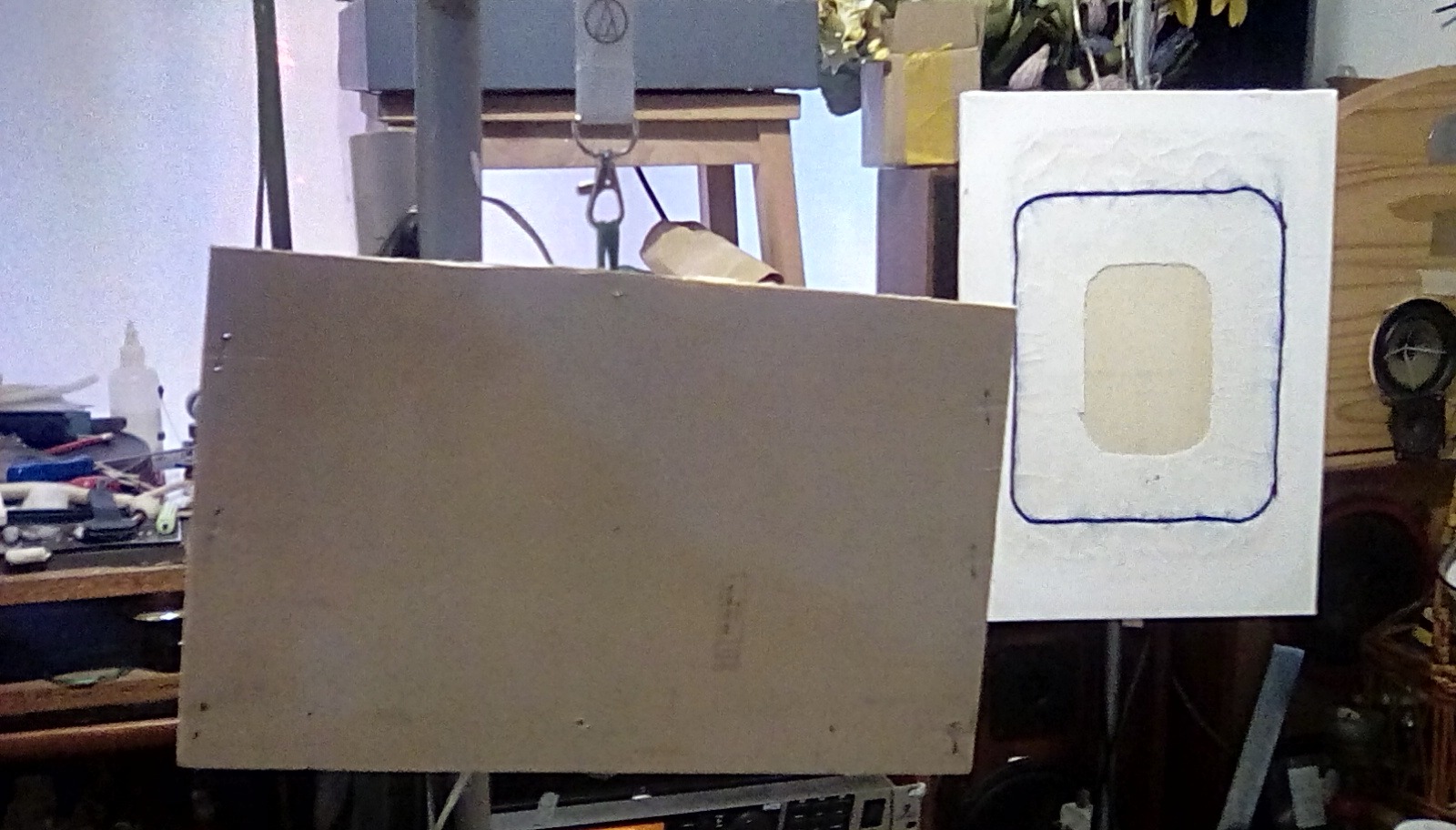

low quality 3 ply from an old veg crate .
i will post a picture of the two panels playing.
on the right is the old art panel i cut up to insert the new 185 x 175cm panel.
on the left is the naked panel with only the exciter attached .
both panels are running full range , the art panel goes down to 40hz but the naked panel only goes down to about 140hz so i added a couple of weights to bring down the response to 100hz.
no sub used.
recorded at 1m as usual.
m4a.
a very detailed sound with plenty of ambiance .
steve.

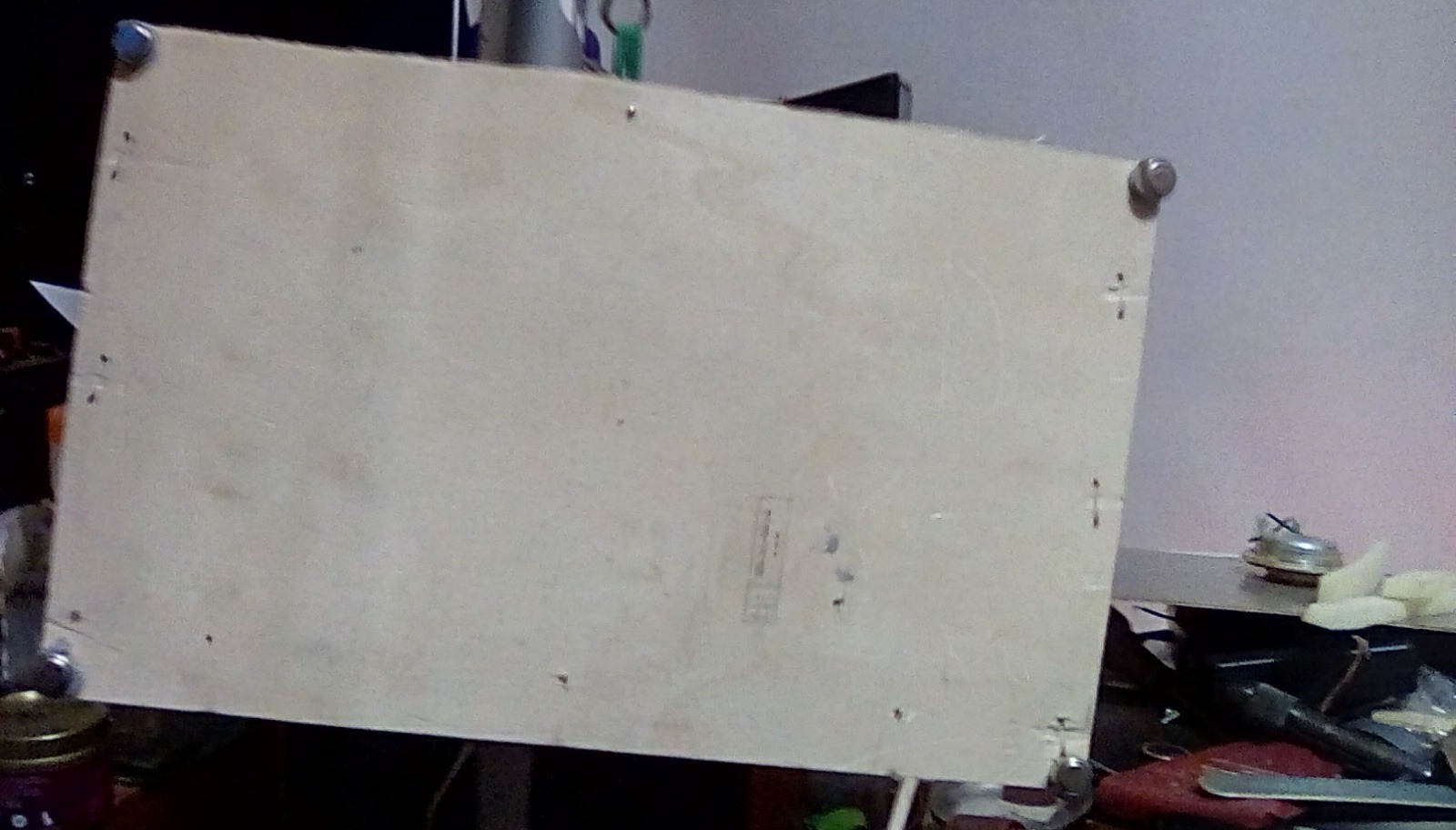

Pictures of low quality 3mm ply panels.
The second picture is of the weights attached in the corners to increase the output down to 100hz.
This is a very basic panel without me even doing anything to improve the sound ,yet !
Not that it needs much doing to it.
It is a very flexible panel and bends easily.
Steve.

Im learning too, piece by piece as time permits (unfortunately you need ALL the pieces for a proper understanding - these phonomena are complex). The basic idea for efficiency is to describe how well a moving (vibrating) object transfers kinetic energy of a body (mean-square velocity) into sound waves. The piston is used as a reference because its a simple model whose theoretical behaviour is well characterised. Efficiency is not really the right word, because it can be >100% (ie more efficient than the piston reference).
Im trying to understand the relation of the Scheleng parameter R to damping. They say:
This damping factor is radiative damping - not energy lost in the material, but energy lost to sound. In other words, they are talking about radiative efficiency, as you said in the beginning. Note also the factor A which confirms that longer panels are better radiators at low frequency.
It's insightful to state it this way, because a higher radiative damping means both higher SPL, and a tighter impulse response, because the panel is losing energy to the air, not resonating too much.
This is a simple relation because it relates only to one frequency - the fundamental resonance. But I guess we can assume that a higher R value increases efficiency for all f < fc.
