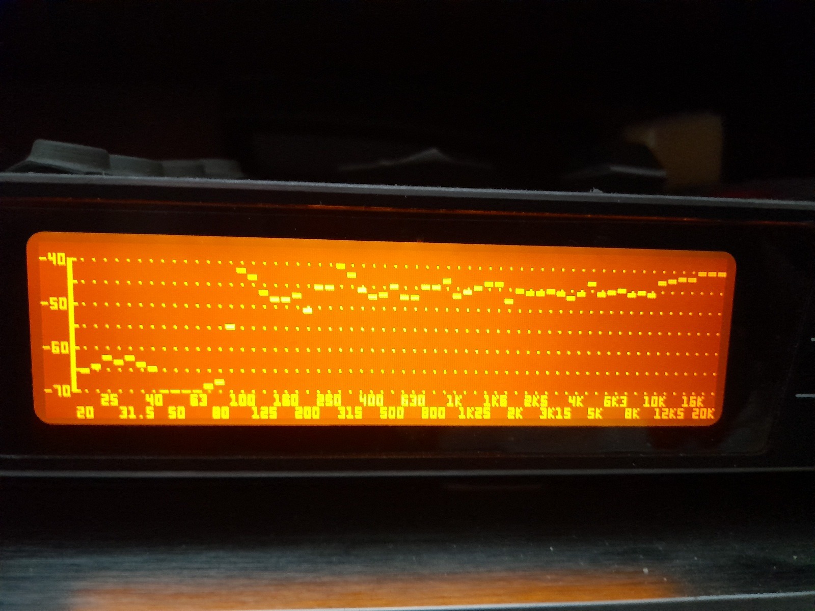

I made some measurements of the proplex panel.
Pic 1.
1 inch in front of exciter.

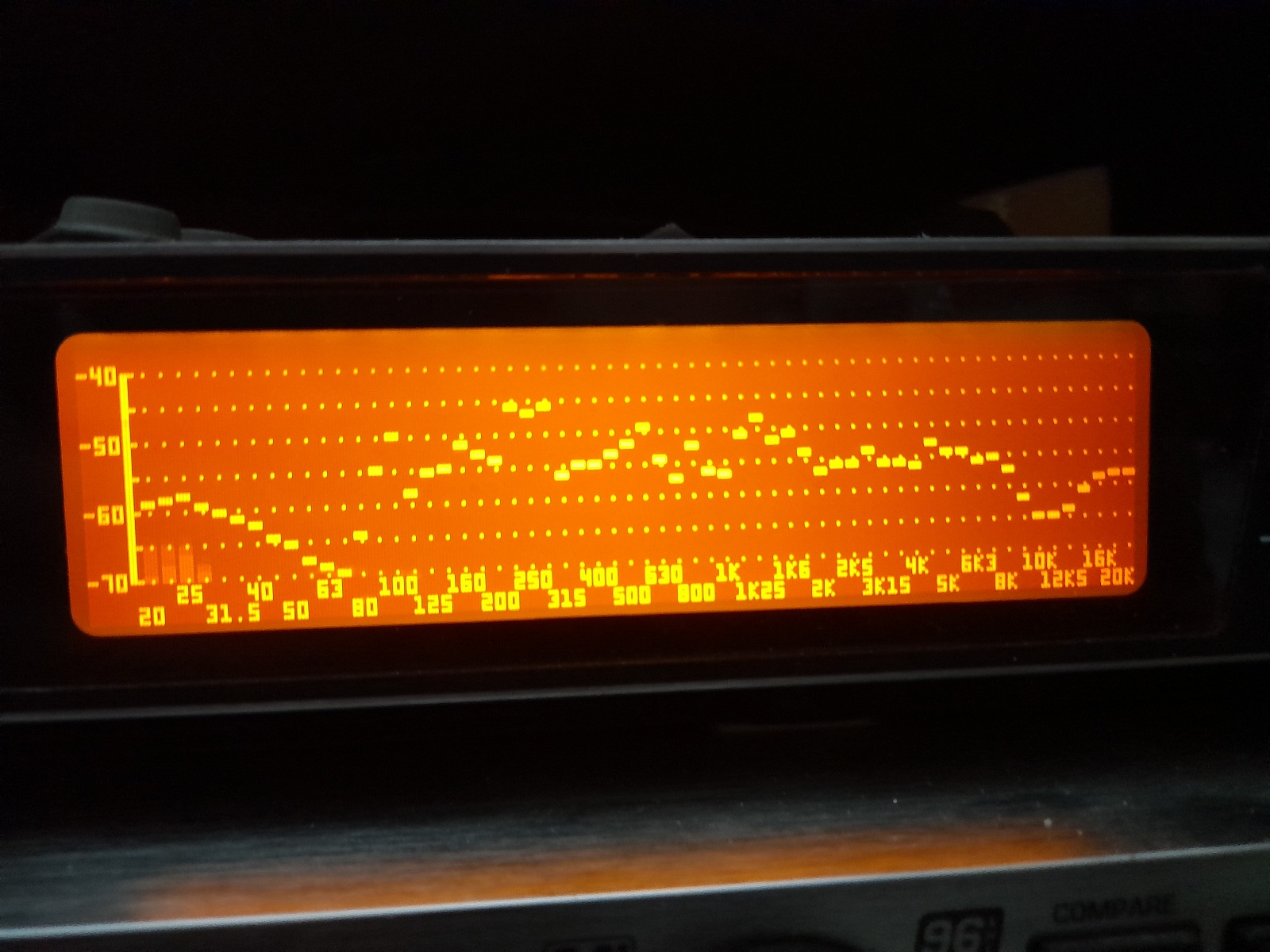

Pic 2.
To the right along the flute lines at the end of the panel at 1inch.
Large hump in response before roll off.

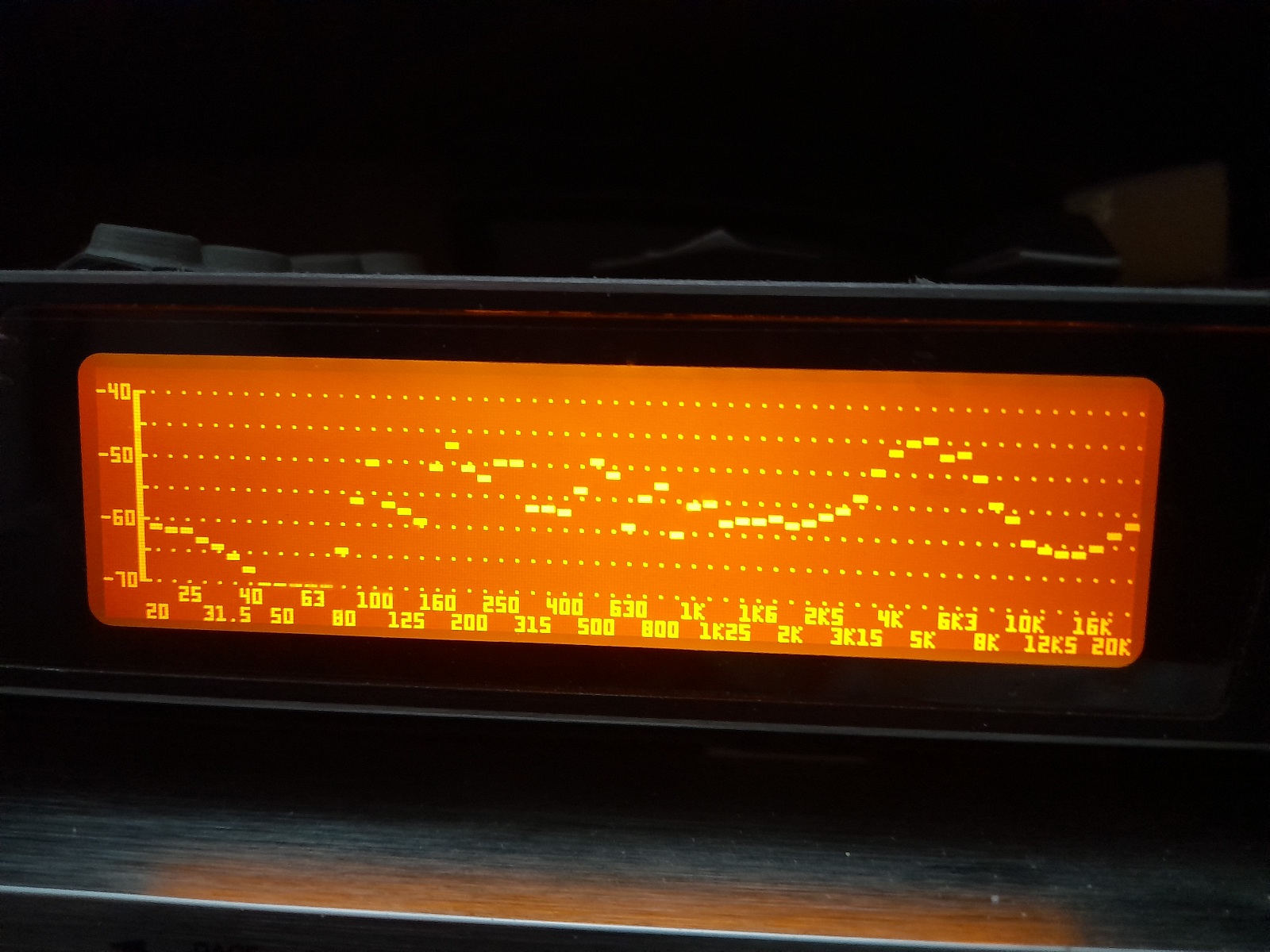

Pic 4 .
Was interesting which was at about 3inches from the corner on the bottom.
Stronger hf.

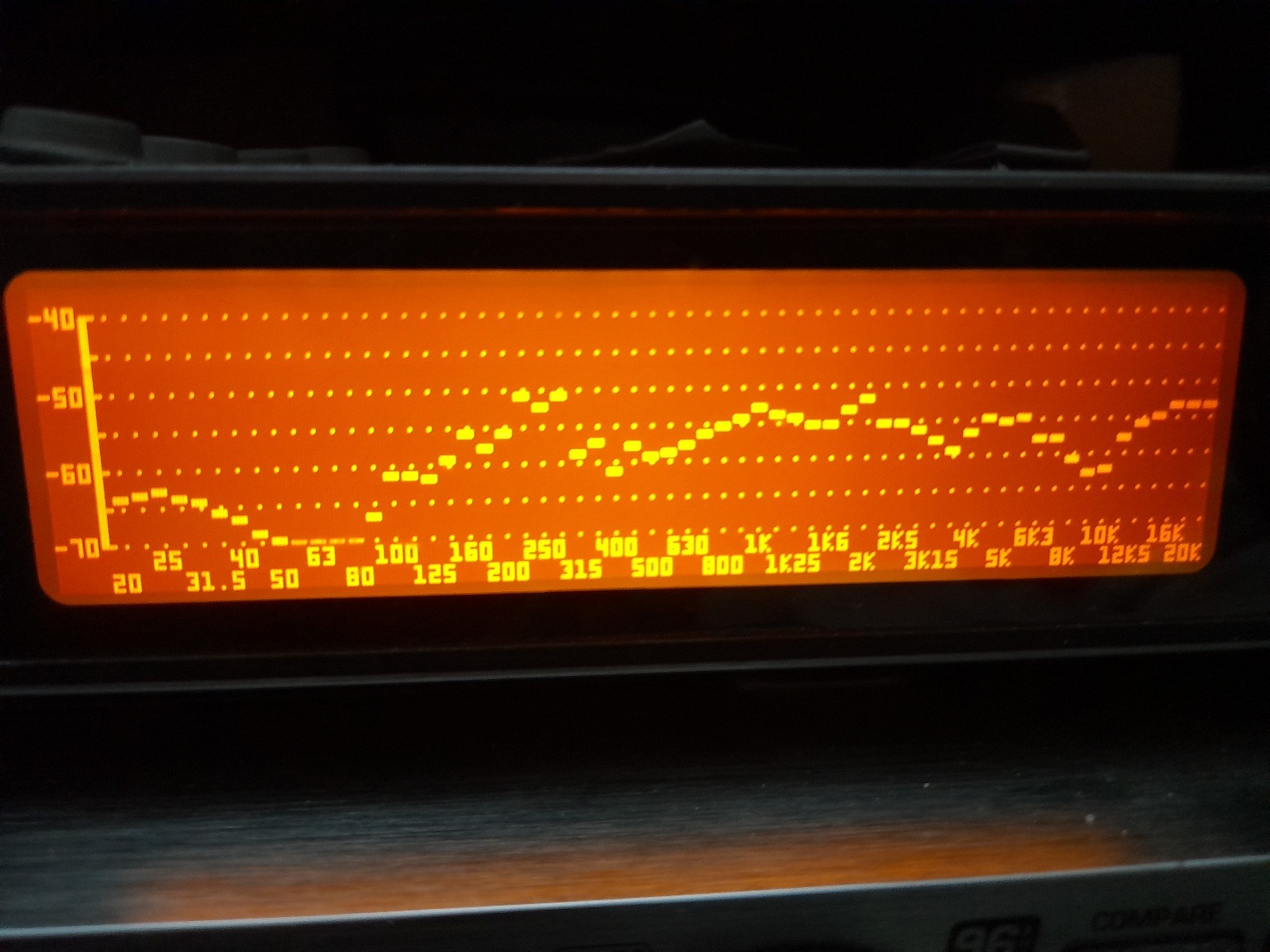

Pic 5.

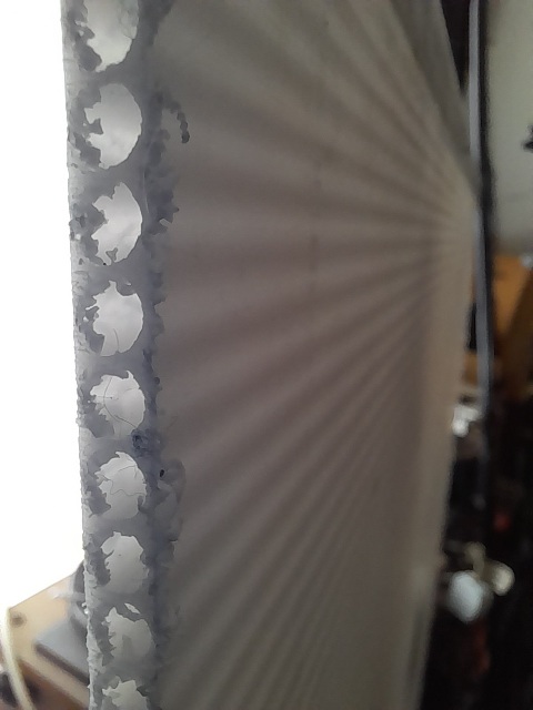

The flutes are circular for added strength I presume.
Steve.
