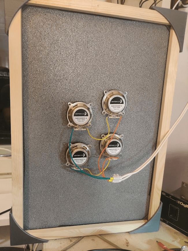

I have not completed the mounting yet, and just have the exciters attached with the original adhesive, so this is how it looks on the back:
So 4x DAEX30HESF-4 in a Tectonic style configuration.
Leob.

Decided to make bracing part of the construction holding the 4 plates. Vacation starting today, so gonna get the rest of the materials needed tomorrow and should get amps next few days. So will get started building the first stack now and when that is done I will analyze that, and can make a recording as well.

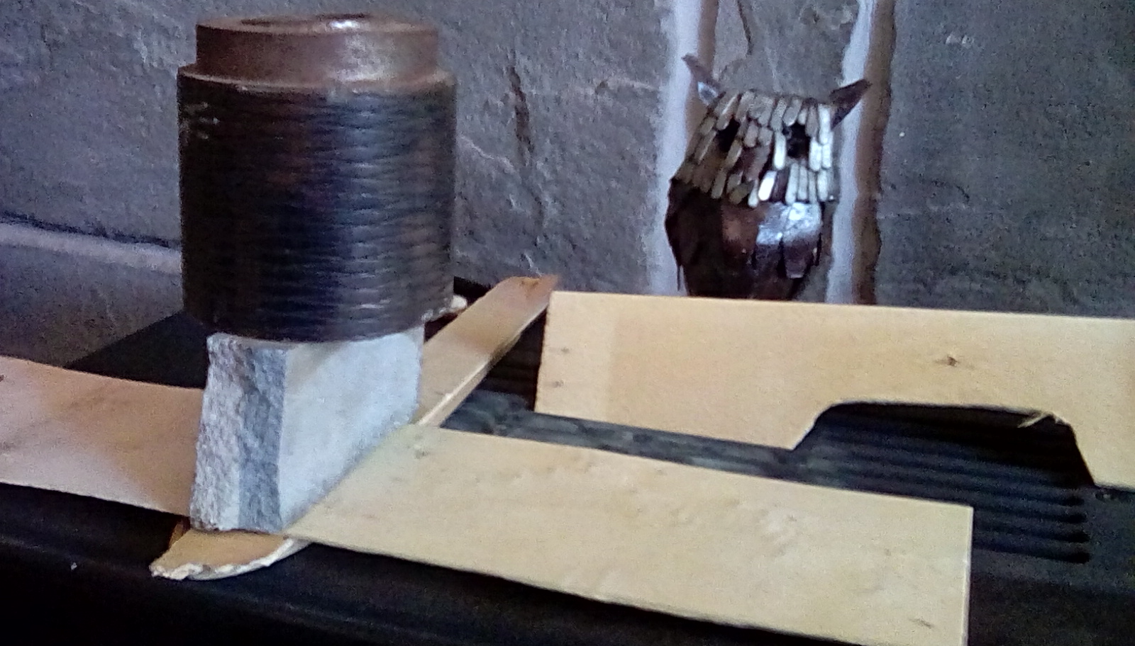

Thought I'd pass on that I've also tried using very light braces to flatten panels.
I used 3mm ply on edge about 8 to 10mm deep and tapered the ends as per guitar bracing..glue in a pattern which suits the panel and the warp.
It appears to work...just enough stiffness to heep control of the panel without affecting the performance
Suggest give it a go

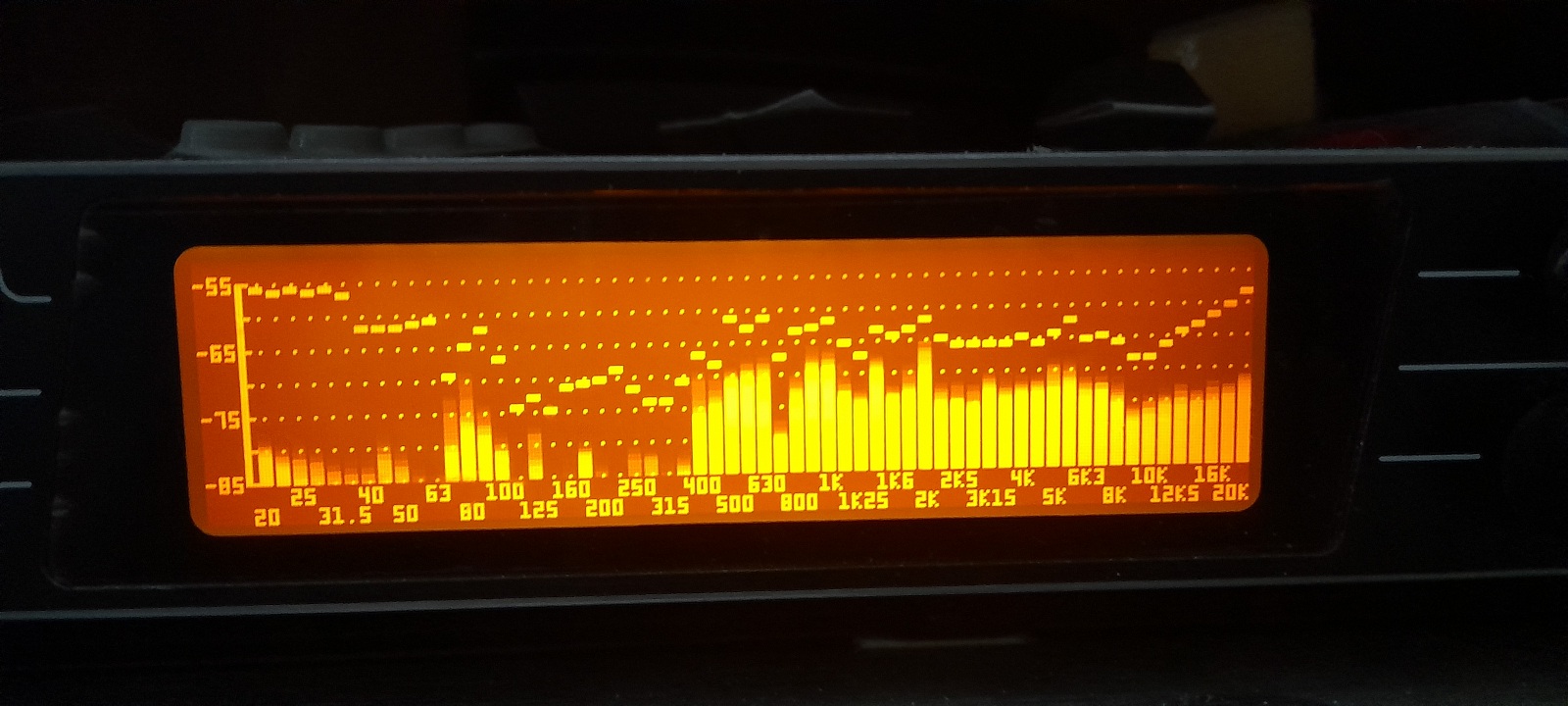

One thing I have noticed with the crate ply is a harshness in the upper frequency.
I also noticed when measuring, that the frequency rises above 10k off axis.
See rough picture ,dotted line off axis.
The panels are close to walls and objects, so I could be getting strong harsh reflections?

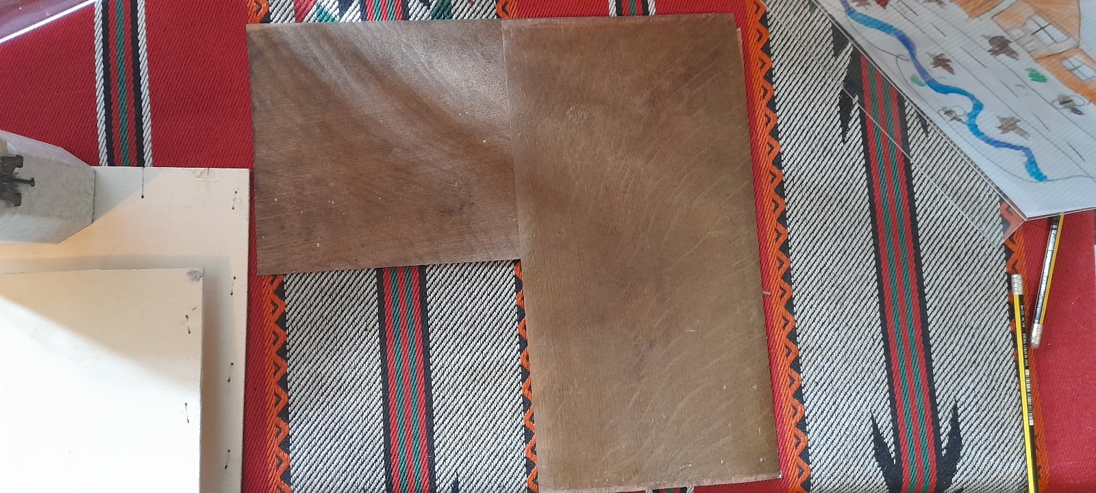

I had forgotten about these two.5mm pieces of veneer I found in my shed.
I'm still thinking of what to do with them .
One long 34cm panel with the grains going the same way.
Or two square 17cm panels but one going with the grain and one crossing grains.
I'm in no hurry as , as usual I have too many projects on the go at the same time 🤯

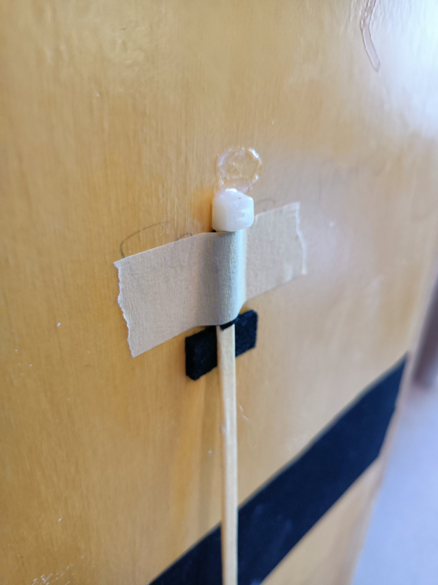

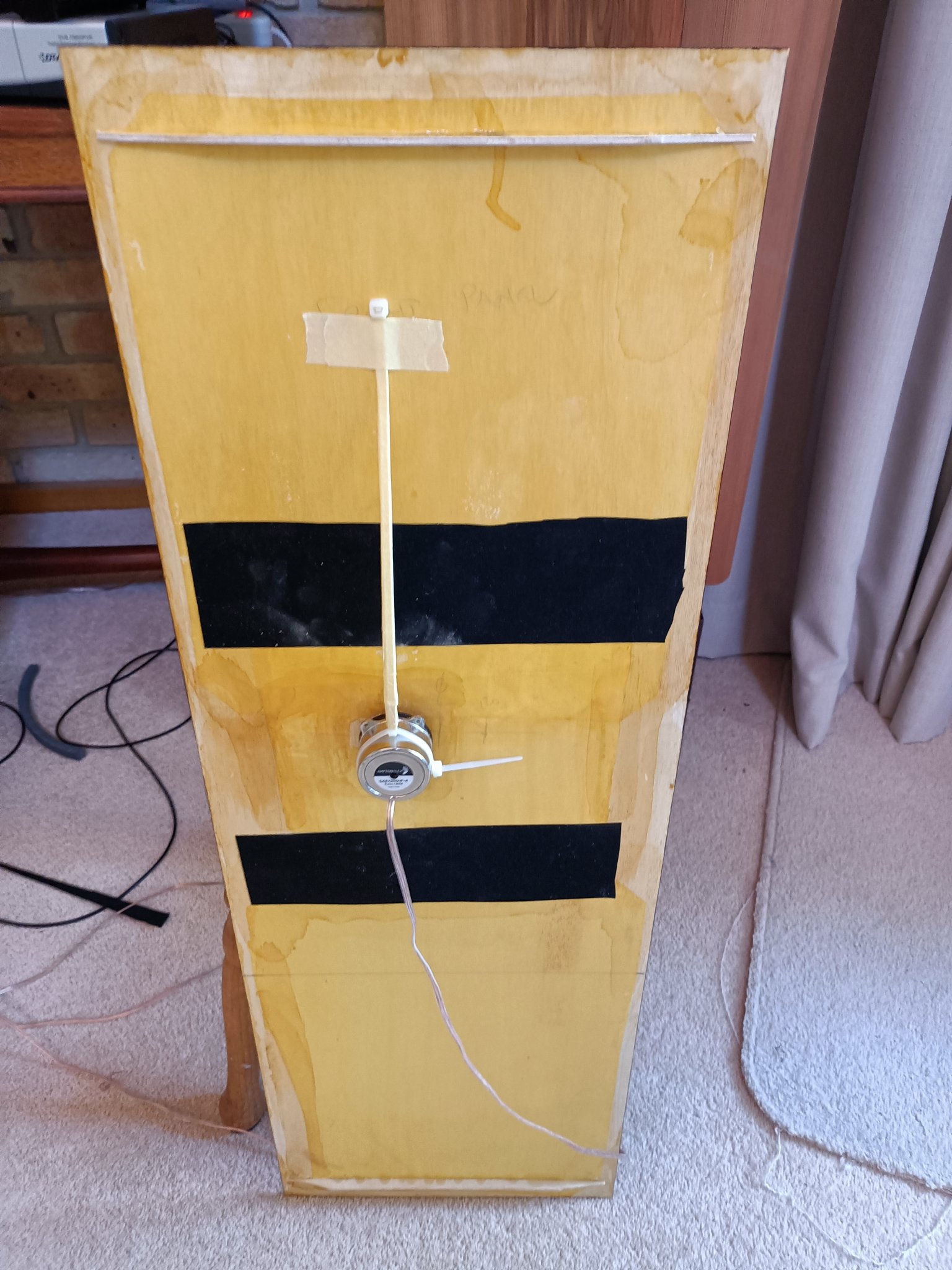

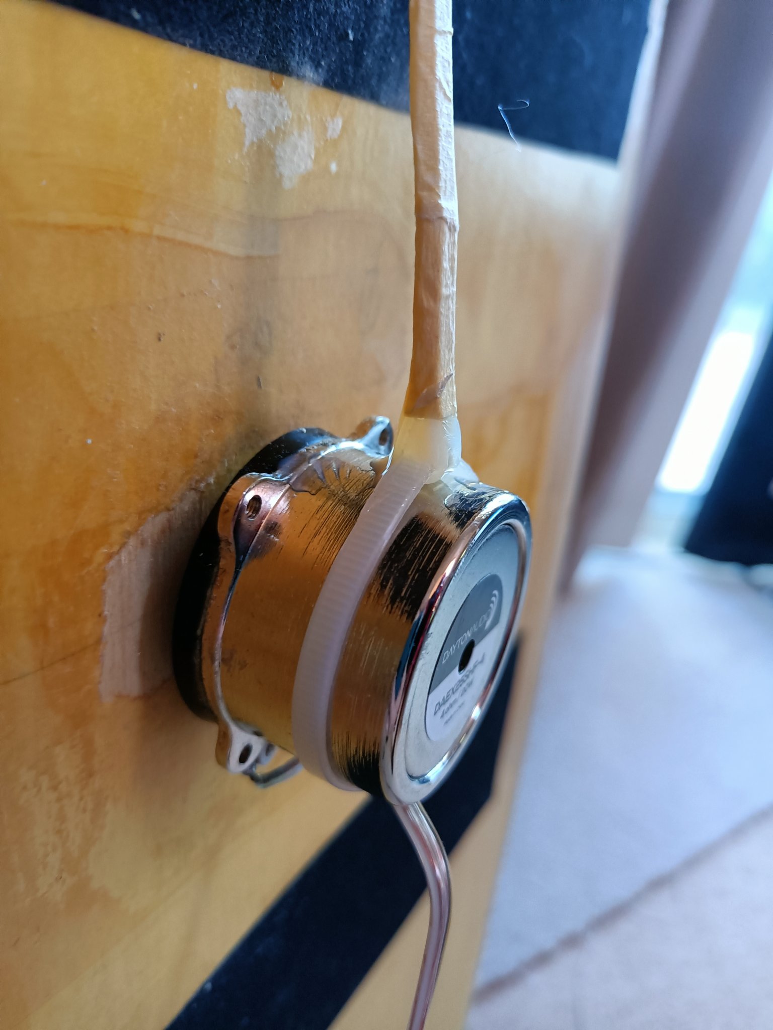

Hi Christian
Pic of the rear of a test panel
Stiffener at free top and bottom edges
Sides taken care of in other ways
Yellow trace paper on rear
Damping by very thin adhesive felt used for drawers
Exciter supported by damped cable tie glued to panel..Tape for temporary/permanent extra hold
A bit rough in finish but unseen
