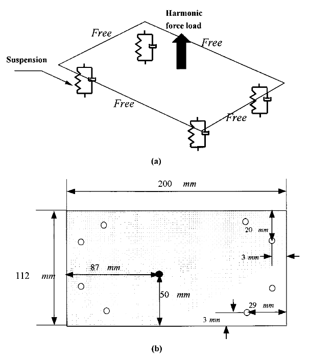

The second document is Development of panel loudspeaker system: Design, evaluation and enhancement. In chapter IV there is a design guide. Most of the items make sense following what I tested and what we have shared here.
In particular, it mentions the relation to E/rho^3 as a driver of efficiency.
What is more unusual is the proposal for the suspension in 8 points in the corner (see extract below)
Does somebody experiment such suspension?

Christian,
The first link (Does Size Matter....) is basically worthless. If the formulas do not include panel thickness or elastic modulus, there is no way they could be meaningful for anything other than the exact panel material and thickness that the author used (if that).
The "Bai" article you linked is one with which I am very familiar. I think there is much to learn from it, if you are able to decipher it. It's on the top of my stack of good DML papers and I have read it many times.
In fact, in the spreadsheet I shared with you, my calculation for panel area required (for a given lowest frequency) is based on eqn 23 from this very paper.
I must admit, that there is much I don't understand, but the reference to (E/rho)^3 in eqn 24 certainly caught my attention and confirmed for me the significance of this parameter for efficiency.
There are two things I find a bit odd from this paper. One is where in "step 2" with reference to eqn 23, where they suggest choosing either "small D or small mu" for a small panel, presumably to achieve a sufficiently low fundamental frequency. I think they meant to say "small D or large (not small) mu" since small mu would have the opposite effect of small D. I suspect that "small mu" was a typo. Let me know if you think I missed something there.
Secondly, I think it is a bit odd that in step 3/ eqn 24, they seem to be suggesting that one can select E and rho independently of D and mu, which appear in the same equation. But obviously, D and mu depend directly on E and rho so that is a bit misleading or at least confusing. My own interpretation of that equation is that they are trying to show that for a given fundamental frequency, the lowest impedance, and hence greatest efficiency, is when (E/rho^3) is as large as possible.
Concerning the issue of support points: I must admit that I missed that detail in previous readings. Curiously fig 6a seems to be showing only 4 support points, while 6b clearly shows 8. Also, fig 6b seems to be showing support points substantially inboard of the perimeter, but when you look at the dimensions they are really only 3 mm from the edge, so they are effectively on (not really inside) the perimeter. The logic they mention in step 5 of putting the supports where the most nodal lines cross seems to be reasonable advice, and basically consistent with the NXT philosophy. But I think they missed the fact that you can favorably influence the distribution (along the frequency axis) of modes by selecting particular panel aspect ratios and support points.
Finally, I have to add that I was very pleased to see that this author acknowledged the lectures of Dr William Thompson Jr of ARL/PSU. I was a student of Dr. Thompson for at least one undergraduate course while I was at PSU, but for the life of me I can't recall which course it was. It was over 35 years ago, so I hope I can be excused for that.

Hello Eric
For the first link, yes, no utility like that. I keep it somewhere in the background as I am still wondering what happens at the first resonance frequency between the front and rear wave. I would expect some cancellation but I haven't found any evidence of that up to now.
The "Bai article" is a good synthesis of the physics of DML.
What is strange to me with this kind of academic paper is they seem mastering the theory but the applications seem not being of the premium quality (do they listen music with?). There might be a constraint on such research like the expected area of application : for this paper loudspeaker for computer?
I agree there is probably an error in "small D, small µ"
By letting D and µ they haven't pushed enough the variable change. You are right, replacing them by f0 would have given a clearer expression. f0 is almost fixed at the beginning of the design in a range like 50Hz to 150Hz.
It is strange also to have chosen a so high f0 (almost 300Hz) with no mention to the rule of thumb of 2.5 f0 for the real bandwith. Like id the dimensions where a constraint with no better material to go down. Despite that, the fig12b shows a response going down 200Hz. Is there a trick like an effect of the exciter that might lower the natural plate resonance?
I try to use the kind of electrical model they give but with no real success. It seems too simplified of to be used with a mechanical model.
I think there is also an interesting advice for the exciter going in the way discussed in this thread : high BL, low inductance.
They mention the aspect ratio in the step 4 by distinguishing the modes in one direction and in the second direction. The advice is to interleaved them but there is no practical values.
About the suspension, there are no practical information; just the value of the compliance which for me at the moment has no meaning (is it a weak or strong spring, I don't know). It gives probably an additional configuration to test.
At the moment, if I have some direction to go for the panel based on plywood or sandwich, I have no clear direction for the suspension. The full foam surrounding I have in my plywood panel seems not too bad but without any link to physical models.
So I don't know if I'll do it but this design guide gives ideas to write something (not an academic paper, more something that make bridge between full handcraft and physics, some 1st steps of engineering...).
Christian

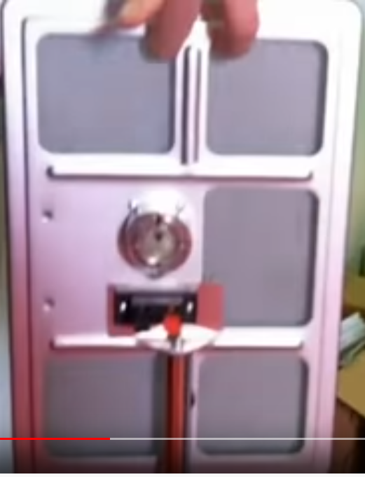

Hello Steve,
There are some information from this video
the large panel
  • aspect ratio is about 1.28
  • the panel material is printable, light grey with a honeycomb core. An idea of the possible material?
  • the frame seems to have a U cross section
the small panel
  • exciter position : 0.43xshort side, 0.47xlong side (less precise on the long side because of the video angle)
  • the exciters seem to have a conical vent at the back
  • 1/6 of the rear area is

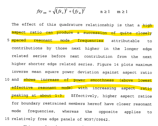

Eucy,
If I understand correctly, what you are suggesting is to roughly match the effective stiffnesses (including the length effect) in the two directions, yes? But what I don't understand is what you beleive is the effect of that matching, and why would it be advantageous?
Or is it rather that you have observed satisfactory perfomance when the stiffness in the two directions seems matched, and have inferred from that experience that it might be a useful rule of thumb?
Static deflections are usually functions of L^3 rather than L^2 aren't they? PL^3/3EI for cantilever beam, and PL^3/48EI for simply supported beam? Are you thinking of something else that I'm forgetting/missing?
The simplest method of pushing the fundamental down the axis is to lengthen the short side (or both sides), but I suspect you know that. I can model some of your proposed designs. It's easy to model, but a little harder to share all the results.
I am convinced that having the natural frequencies close and regularly spaced is a good thing. One of the main points in the NXT patents is placing the exciter in the position that excites the most modes (more modes means closer modes), and selecting an aspect ratio so that the natural frequencies are "interleaved", that is to say regularly spaced. So I don't think I am alone in that belief. That said, I can't say how close is close enough. I feel certain it depends on the damping, both within the panel and at the perimeter. Generally, I have had pretty good success with a panel aspect ratio approaching 4. And I've had decent success even when the stiffness in both directions is roughly comparable. So while I say there may be some advantage if the stiffness is lower in the long direction, it doesn't have to be so, as long as the panel aspect ratio is high enough.
Incidentally, I realized only recently that the NXT patents also recognized this feature of panels with high aspect ratio, in this patent:
https://patentimages.storage.googleapis.com/3c/12/36/2e7517cb3f2ffc/WO1999052324A1.pdf
In the above passage they are actually talking about panels with clamped edges, but hinged/simple edges provide similar closely spaced natural frequencies.
If you can get the Chladni approach to work, that would be cool. I've had much better success identifying the natural frequencies of my panels using "tap testing" as I described here:
https://www.diyaudio.com/community/...r-dml-design-and-analysis.383567/post-6954047
But it's very helpful to be using FEA in combination with the tap testing, in order to know where the nodes and antinodes would like be for each mode you want to identify.
