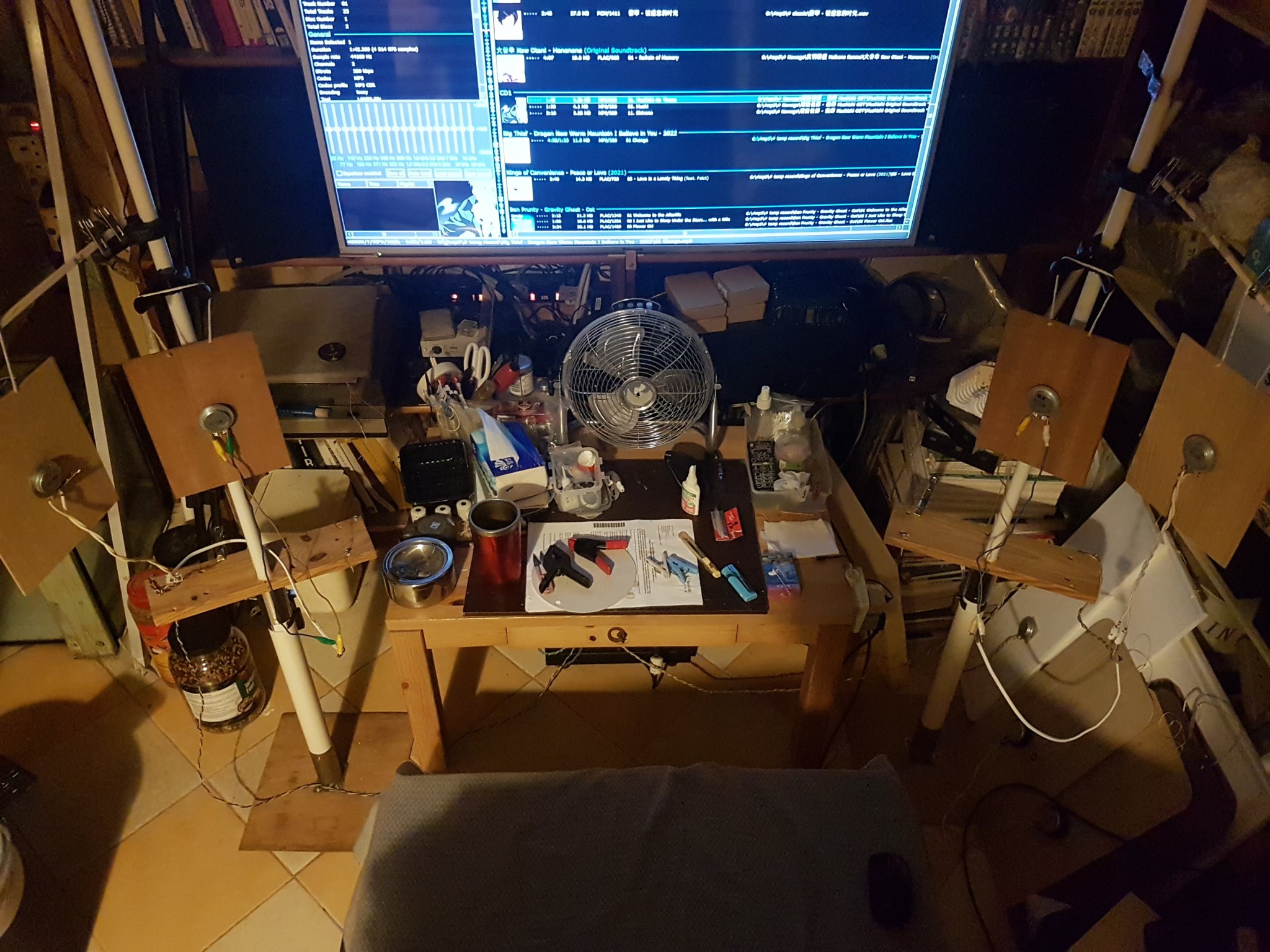

The picture in this post shows the the rug I used to record my headphones recordings .
The last recording was done in exactly the same way , but I held my Samsung a12 phone in my hand instead of resting on the rug.
This way I do not need the low frequency drivers, as the panels produce full range nearfield response.
All other previous recordings were recorded at 1m in front of the panels.
With the low frequency drivers, unless stated otherwise.

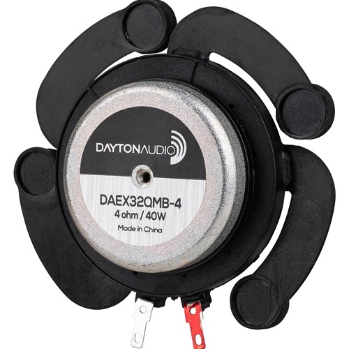

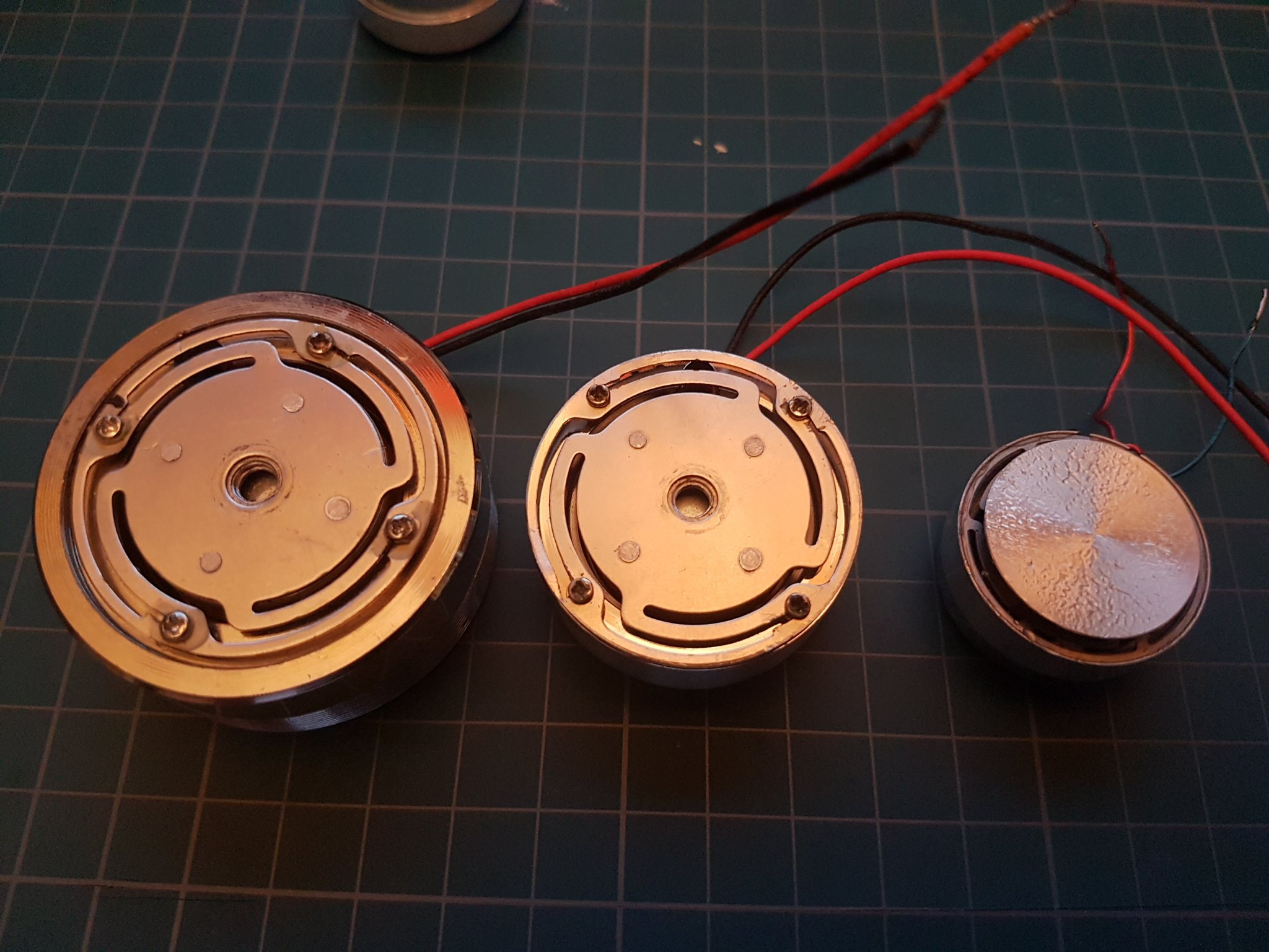

Donthertzme.
I only asked about the hole, as there is a modification I make to the panel , which I will cover in the graphite panel tests.
I can do this with my exciter after it is glued to the panel and show the difference.
But you will have to do it before gluing on the exciter as you do not have the hole.
A lot of panels have a peak somewhere near 10k with dips each side, mostly above, with a drop off in frequency there after.
Tectonic panels included!
It is just an easy remedy.
But not totally necessary, but should help prevent some of the shoutyness and most of all sibilance.
Steve.

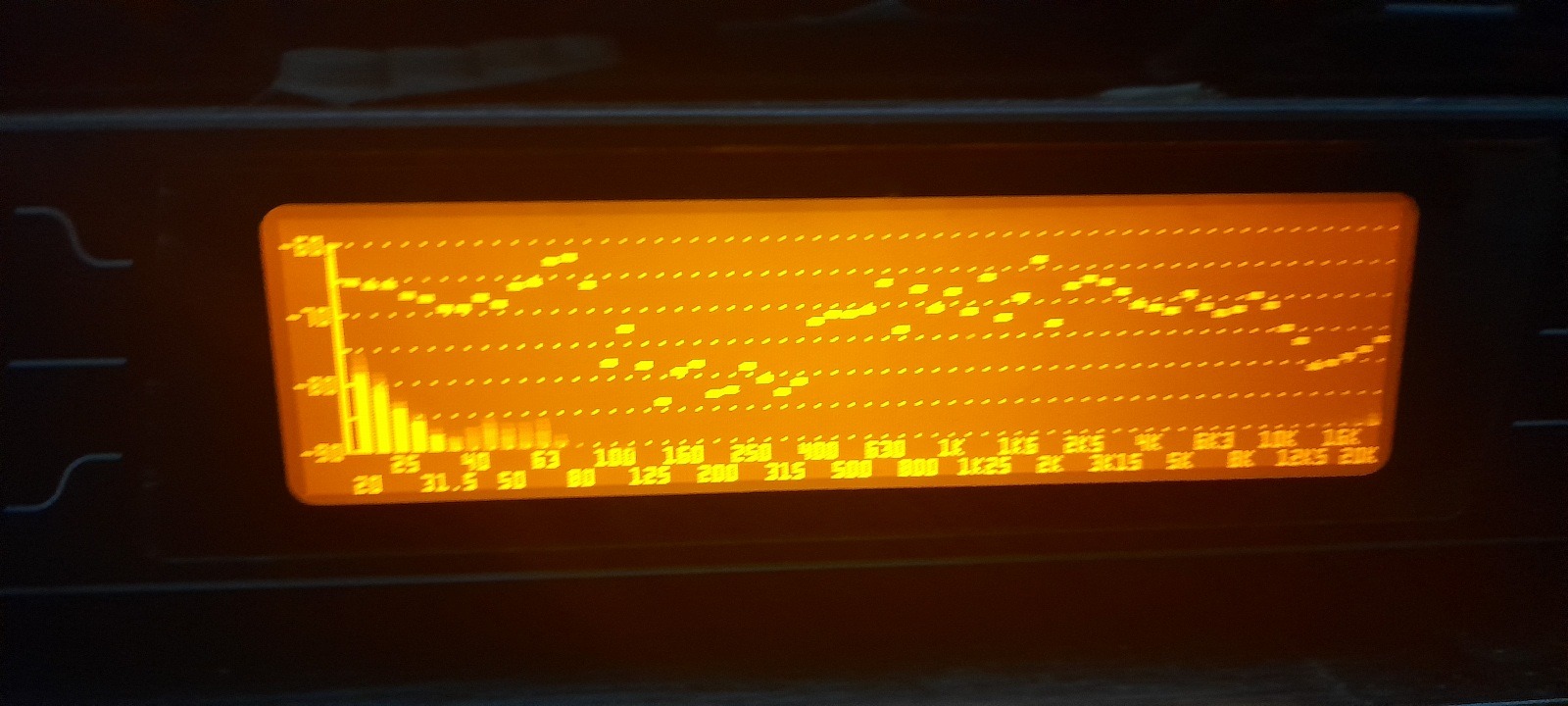

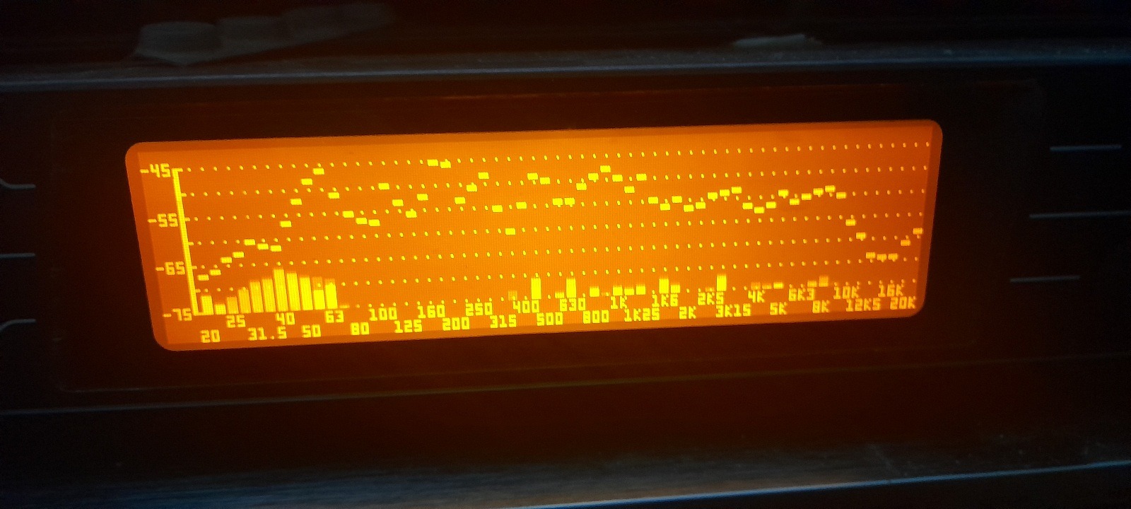

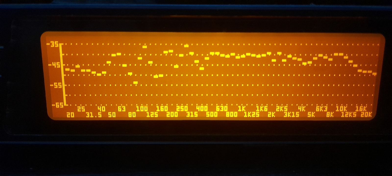

I thought I would take a few pictures of the panel response to give you all an idea of what I am doing.
The first pic is of the response about 2inches in front of the exciter area.
The 10k peak on this material is well damped.
The second pic is of the microphone being moved around about 2inches in front of the panel on peak hold, but around the edges, 2inches in from the sides.
It is at a lower level but quite similar but a more heavy a drop after 10k.
The third pic is with the microphone in a fixed position at 3m in my seating position.
I gave up trying to get a better response as there was a lot of passing traffic noise and my dog barking which was driving me mad.🤯
At the moment I am more interested in the response above 10k although it is pretty consistent from about 400hz to 10k, very similar to some measurements I made over ten years ago with my large eps panels over on NXT RUBBISH.
The suck out in the 100hz to 400hz region, is not that great, but this is a fixed point measurement which does not give a true idea what is going on in this area.
All the rubbish in my room is not helping the in room response either.
Anyway, even though I can't see a large peak at 10k to remove, I will see if I can still increase the hf, or not ?
Steve.

You means you're just place the a12 phone on that middle "roll of sheet"?!Hkguy6
Anyway, I just can't believe a phone's internal mic has this quality. Most of them won't capture bass at all. But your recordings obviously is full range.
Beside the mic quality, I can't imagine the mic has enough separation to record L/R stereo so good.
I have to test this on my phone, however I'm quite sure the result must not like yours.
Hkguy6.
Yes ,the phone is just propped up between the panels as if your head is in-between the panels.
I have always said even with my very large eps panels that standing between them was like wearing very large headphones .
I used to compare this sound to my headphones , and still do, the panels sounded better.
the microphones in the Samsung phones sound very good .
I did try various microphones with the computer but without much success.
They were very noisy with poor frequency responses.
The low frequency does roll off early on the Samsung phones though, there is nothing below 50hz.
The microphones in the phone are nearly 7 inches apart, very similar to our ears (maybe a little of the binaural sound ?).
At the moment I am using AudioLab free to record the stereo sound then using VLC to upload to my drive, where I can access and ZIP before uploading.
Not all phones are capable of stereo recordings.
The only problem is the auto volume control of the phone, which can become very intrusive, ruining the recordings sometimes.
Steve.

Yes I also have my "large headphone". (pic)
They are not the best sound setting. My ears always prefer single excitor and 2 panels clean imaging. However this 4 small panels setting is really good for late night listening. So intimate but with a huge deep soundstage.

I've got 3 models of them.Aiyima Exciters
Does anyone have experience with these Exciters... They have an aluminium mounting plate and rod which would seem to me to be heavy enough to affect hf frequency response
Also they have the metal spring spider which seems not ideal to me
They do however come in a range of powers and are reasonably priced
So worth a try maybe?
Yes you're right the metal spider is too stiff. So I cut them (pic2), however sounds not much improve.
Other problem is, from the pic1 you can see both 44/50mm model share the exact same spider. So the 44mm even worst sounding then the 50mm.
And they're both too heavy to use on a spineless system.
Overall not recommand even they're cheap.
