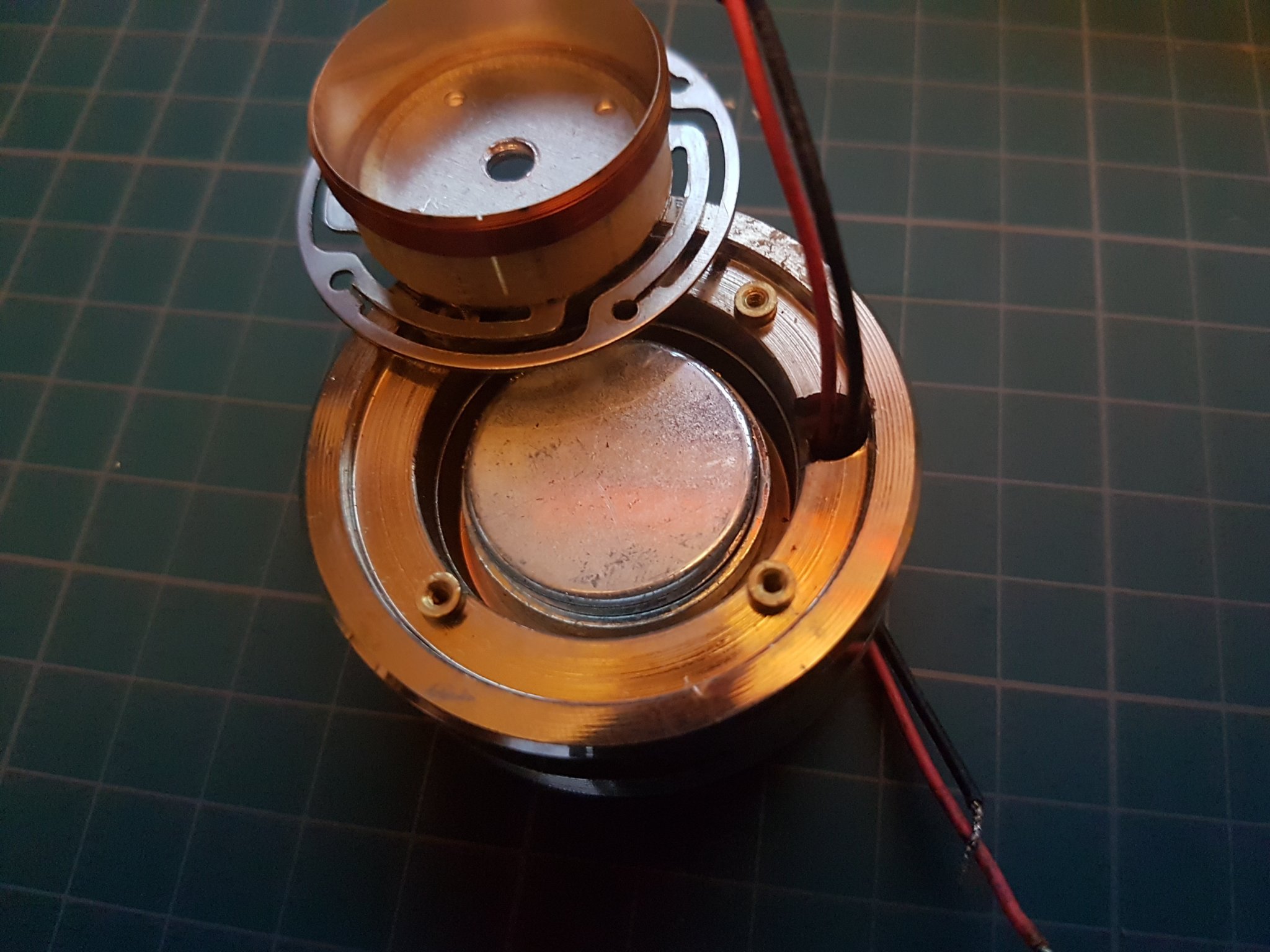

Yes you're right the metal spider is too stiff. So I cut them (pic2), however sounds not much improve.
Other problem is, from the pic1 you can see both 44/50mm model share the exact same spider. So the 44mm even worst sounding then the 50mm.
And they're both too heavy to use on a spineless system.
Overall not recommand even they're cheap.

Here (Hong Kong) we don't use plaster wall. All cement so can not try.
I doubt these Aiyima are really powerful. The magnet they used are quite small when compare with my PUI. All the weight goes to the metal housing.
From my experience they are not louder then the PUI when attached on same panel.

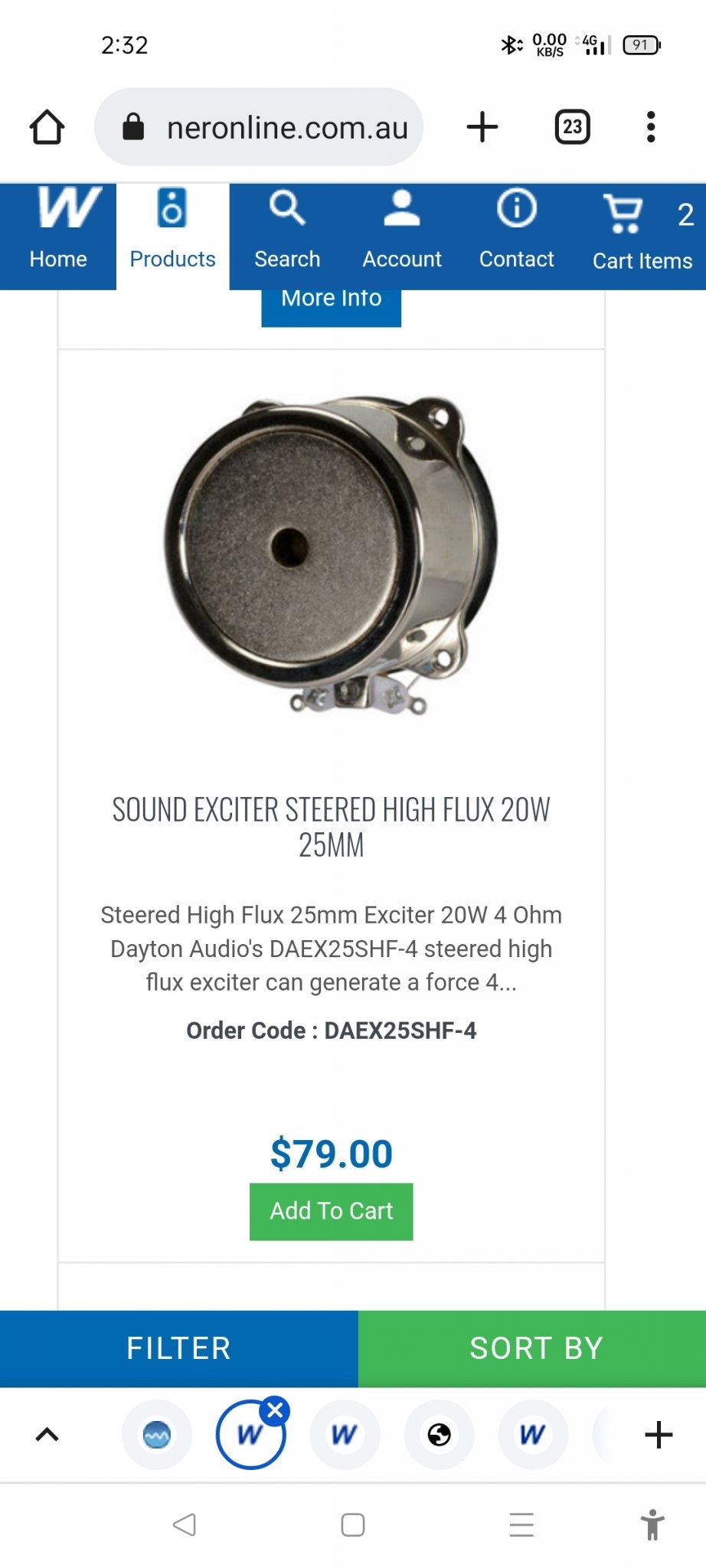

The 25shf-4 looks like the exciter podium used in their panels.
The price has increased considerably over the last few years.
It is a very heavy and deep exciter and needs support mounting.

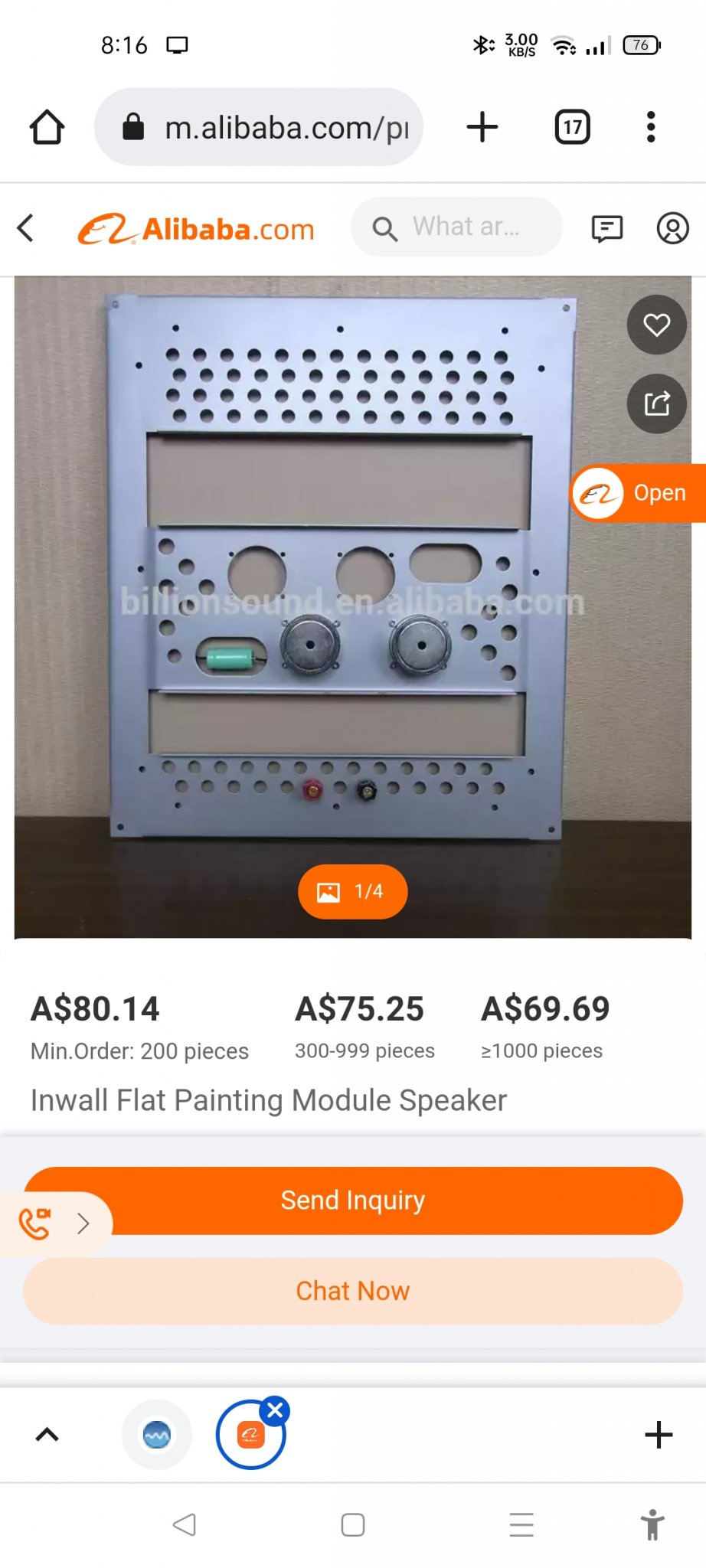

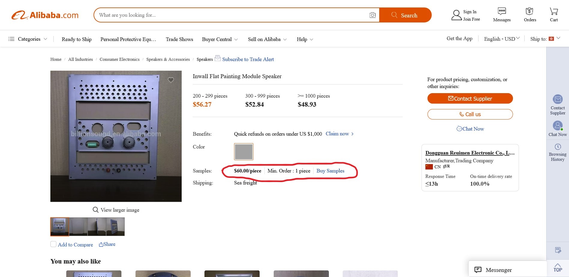

Or you may buy their panel with two 25shf on it. Accept sample qty:1 @ USD60.Hmmmm.. I can get these for about $20 each from Billionsound provided I buy 500 of them lol👍🤔😄
https://www.alibaba.com/product-detail/Inwall-Flat-Painting-Module-Speaker_60508011317.html

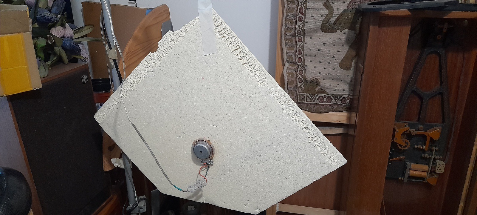

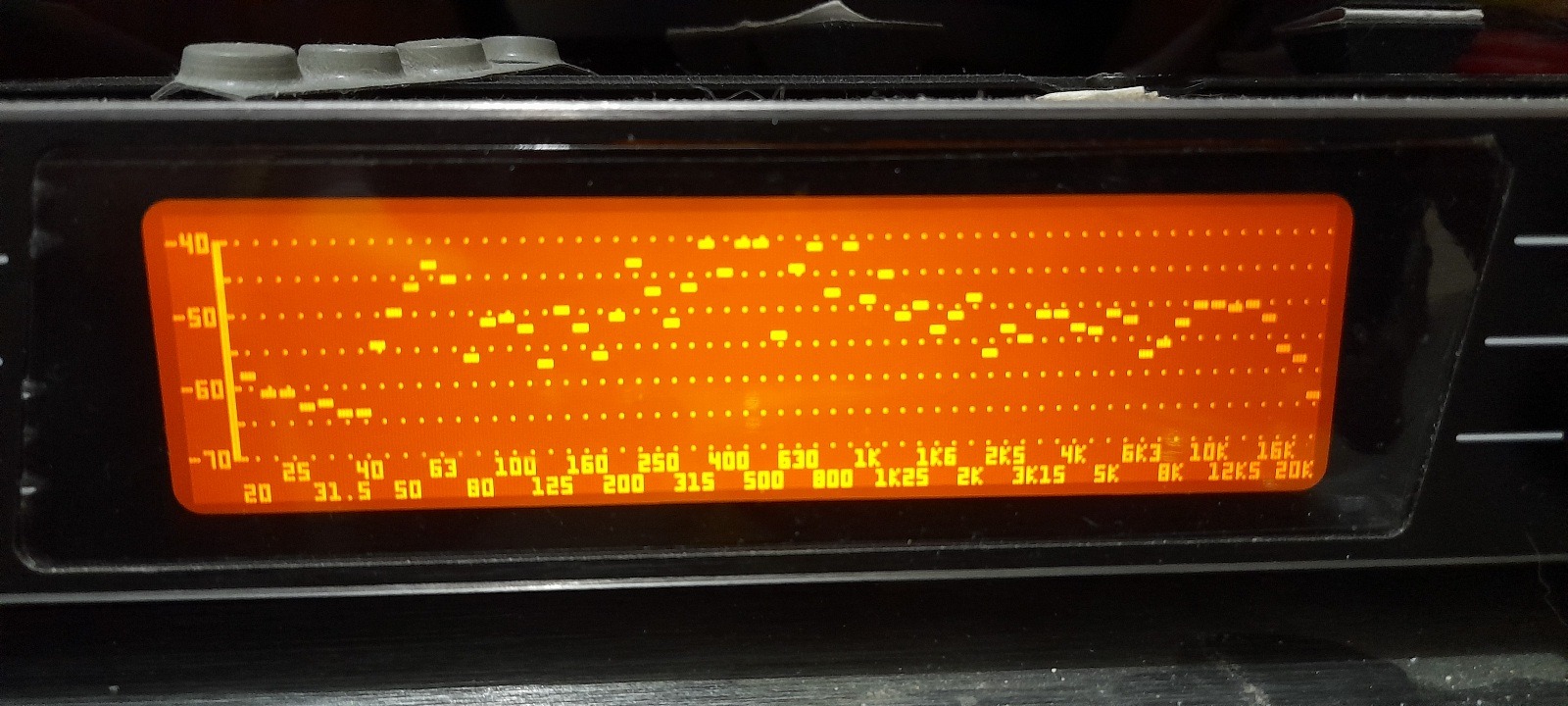

I just came across this post of mine on page 170, while looking for wall recordings (side tracked again ) 🤣Xrk971.
I'm always getting side tracked
Coming back to an old problem, these pics are of a 1inch thick eps I made out of two smaller panels.
I mentioned at the time it was beaming heavily to the sides , so I had to place pillows on the wall to stop the reflections.
My 5mm panel of similar size does not suffer this problem?
The first pic shows the offending panel and the angle at which the microphone was placed.
The measurements were taken at 2ft, but they were very similar in the middle of the room.
The second picture shows the front response.
The third picture shows the response from left angle.
As I said in my previous post, this response from the side can be very painful sometimes,especially if the panel is placed near a side wall.
I intend to do a little more investigation into this problem in conjunction with the dome.
I was hoping the dome might help cure this problem and smooth it out a little ,although there seems to be very little cavity noise , but I have not looked into this as yet , as I said I've got a little side tracked again
This is the reason I prefer to take multiple point microphone measurements to make sure I get the whole picture of what is going on.
But usually I just wave the microphone around the panel and watch what is happening in real time.
It's so much easier.
Steve.
Ps.
I forgot to mention that the peak from the side angle is about 5db higher than from the front ,this could be because the the side of the panel is close to the microphone?
Although the peak happens 3mtrs into the room as well (just measured it)
And remembered that I never followed up as usual with my findings.
I found that the reflection peak from the close wall, could be sorted by simply turning the panel on its 🙃
It seems obvious now as all the pro panels i have seen are mounted on their sides(tectonic and others).
Basically when the panel is on its side, the close wall sees a fuller frequency response, so reflects the fuller sound back into the room, from both left and right.
When standing upright the wall only sees the reduced frequency response,from the thinner side , it is not an artificial peak, but a drop off of response below the peak, (I hope this makes sense?).
When the panel is on its side you will get a fuller sound spread across the audience at a venue.
And all reflections from side walls will be the same.
In my room the walls are close to the panels, so when the panel is on its side,it reflects the fuller sound back into the room towards me.
Now the peak is firing down into my carpet and up to the ceiling which is further away from the panel.
This one strong reflection from the ceiling will also be absorbed somewhat by the carpet ,hopefully ,it would seem ?
This panel sounded fine when turned on its side,problem solved😁.
I now always mount my small panels on their sides for this reason.
Sorry it took me so long to mention this.
I look forward to any feedback on this and any thoughts.
Steve.
Hmmmm...Thanks hkguy6Or you may buy their panel with two 25shf on it. Accept sample qty:1 @ USD60.
Worth consideration...I couldn't find the single sample price however.. Plus delivery would probably kill it... Maybe 2 units would work... Hmmmm

Thanks Steve... It is heavy and deep and does require support...I started with a modified plastic coathanger with a silicone hinge mount and the last one is a damped zip tie. Neither types have a spine... Maybe the extra mass helps but I can't feel the exciter move even under heavy loadsEucy.

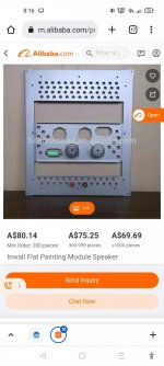

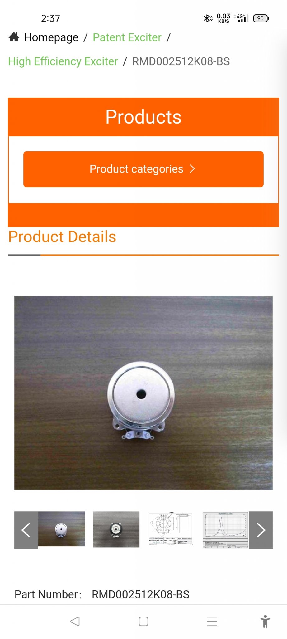

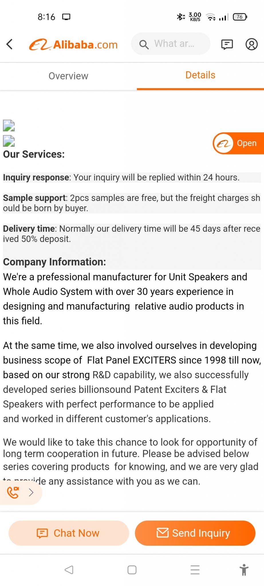

Eucy
Here.Hmmmm...Thanks hkguy6
Eucy
Interesting... Different web result on my phoneHere.
No single sample price
I may need to wait until I can access my desktop
Yeah also the stock price are different.Interesting... Different web result on my phone

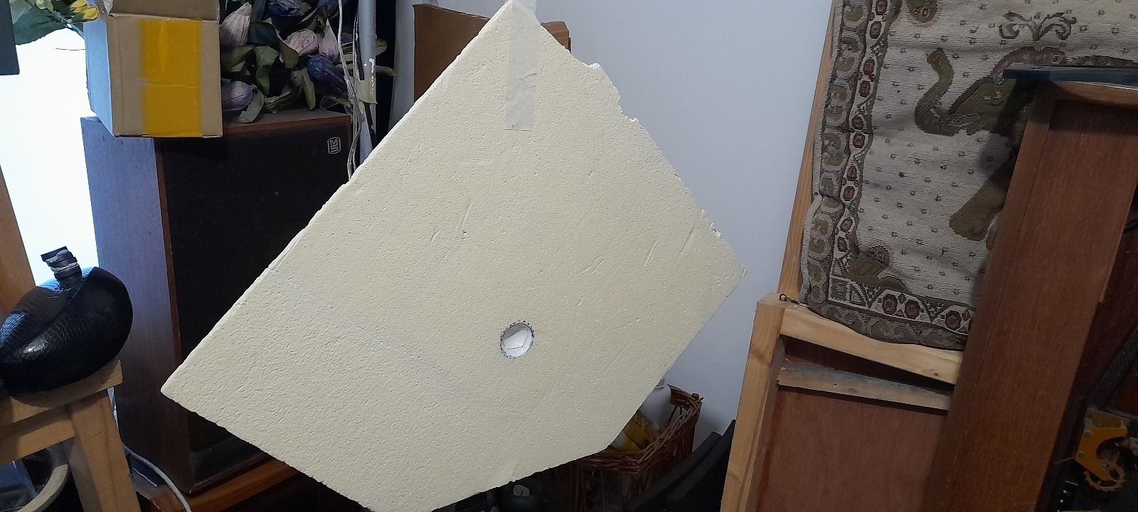

I just found this panel which I have not seen for a few years now.
I believe it is a 5mm vh grade eps.
It is pretty beaten up, it used to have a wooden frame on the two top surfaces, which i did not like the sound of, it has been coated in yellow vinyl silk paint, and has an eggshell for a reverse dome.
This was my egg dome period 🐣
The first two pictures are of the offending item.

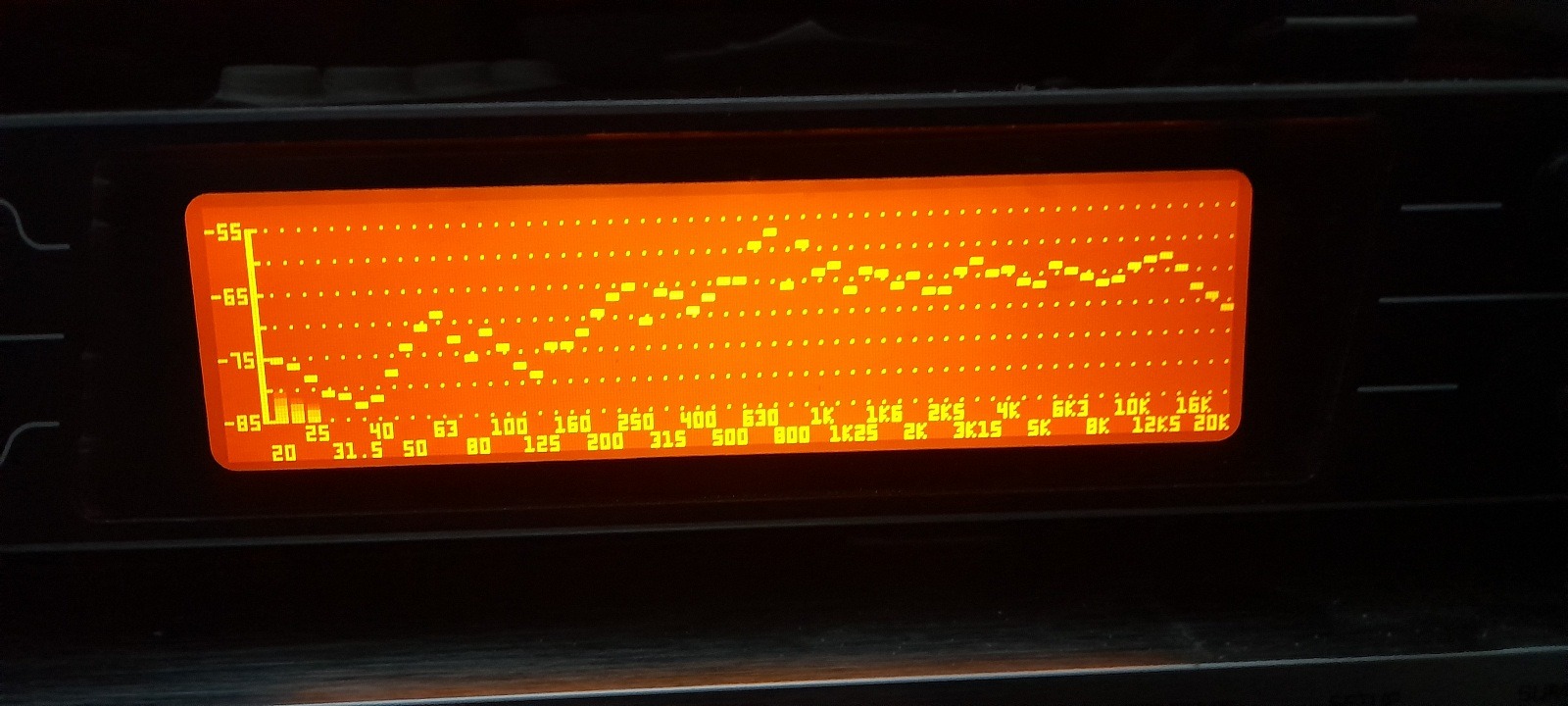

The third is of the response at 2m, about 2ft to my left in front of my seating position .
(The peak at about 800hz is probably to do with the coil cavity and the reverse eggshell , it just moved its position in frequency).
It was just a handy place to put the microphone.
The fourth picture is of the peak hold frequency of playing a cd with large drums and percussion.
This was of the single panel full range right chanel only.
I was surprised how well it handled playing full range into my room, I don't remember this.
I do remember the harder panels having a flat wider frequency response, but I had to turn the graphite panel down 6db to level up the volume when I payed in stereo.
