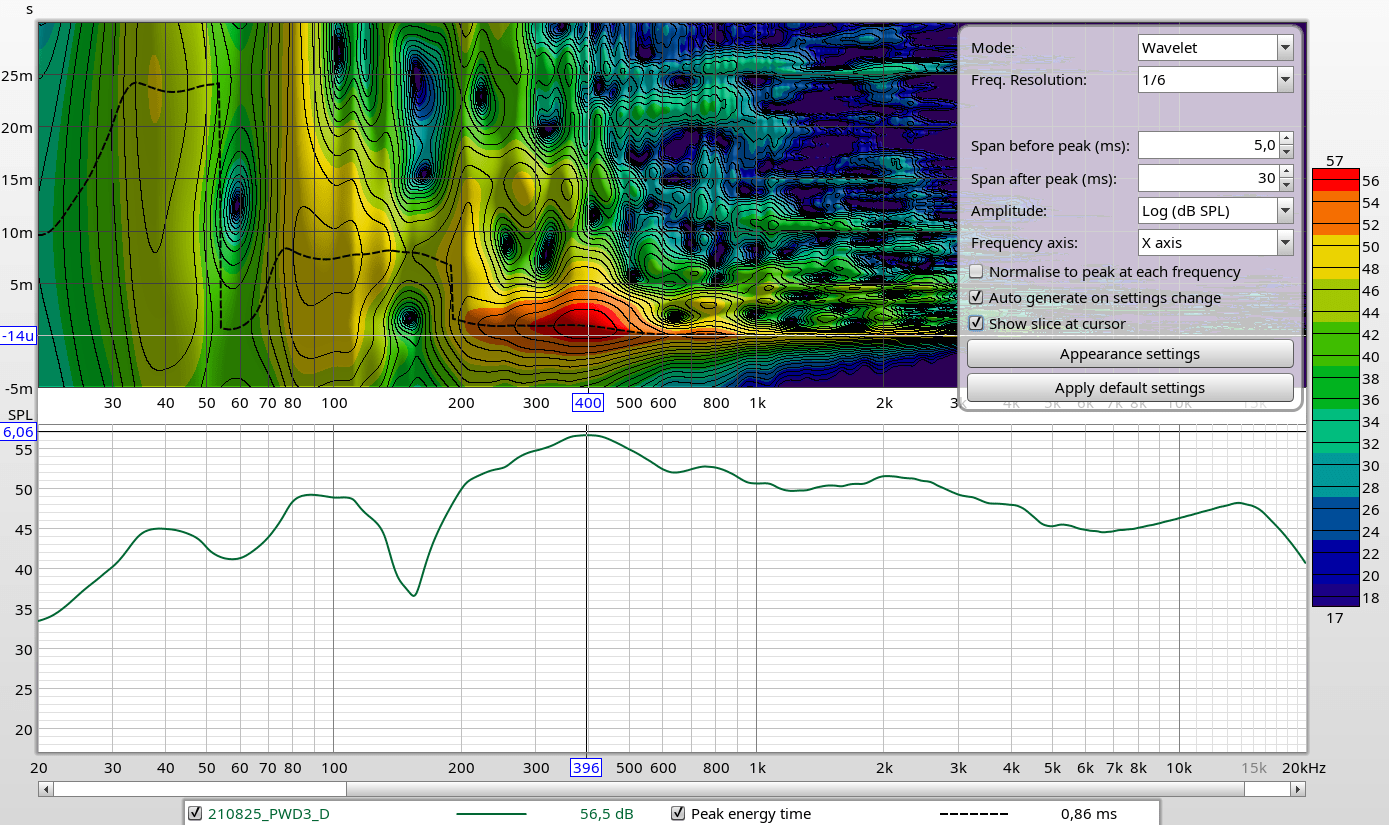

I added 2 slides in the tuto so that you have examples of spectrograms :
I just have seen in the 5.20 REW version you can make a slice (a 2D SPL=f(frequency) for a given time). Interesting. See below
- 9 : the IR/FR/spectrogram of a perfect pulse (Dirac = only one sample at 1 at t=0, all the other at 0). You will see the maximum of the filter outputs are perfectly aligned at t=0s. The FR is also perfectly flat.
- 10 : the IR/FR/spectrogram of my 3mm plywood panel (outdoor measurement). The peak of level at 400Hz occurs at 1ms so with a little delay. For 100Hz and 50Hz it is even later. The dash line shows the maximum.
In an other place, I still have my XPS board. It might be interesting I make a new measurement with them when I will go back there. This echo phenomena is probably one reason I switch from XPS to PWD (energy stored in the panel and released "too late").
In my list of thinks to too (to long list...) there is investigating the possibility of an EQ that aligns all the peaks (sounds like Rephase tool I guess).
In addition the dirac .wav fil in a zip file. Just unzip it and import in REW as a impulse response in a wave file.

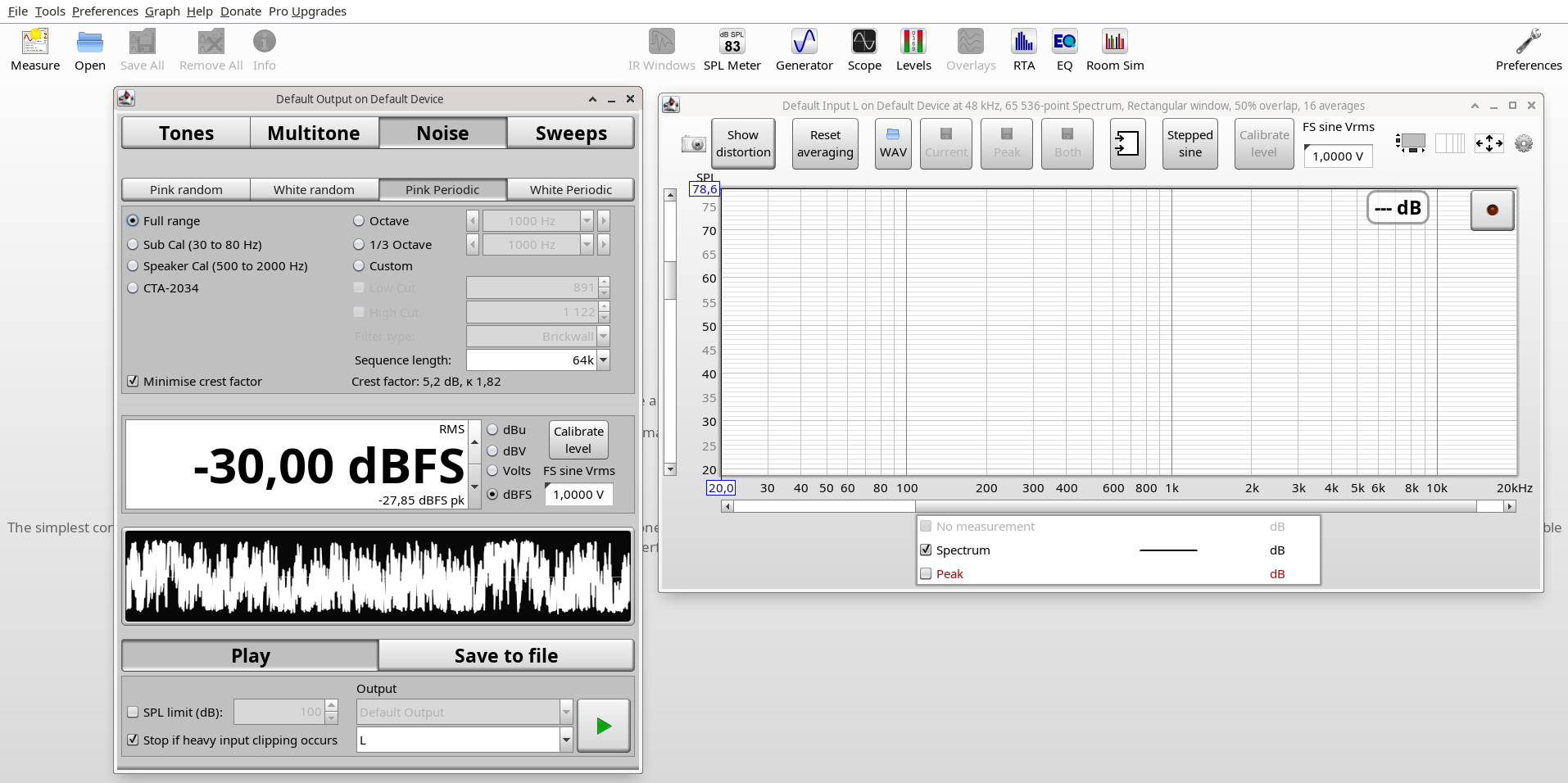

When I use REW, I do it in a basic form just to get fr sweeps.
I use a windows laptop with a calibrated Dayton IMM6 mic. Input and output from the TRRS headphone/mic jack wired to a Bluetooth amp thence to the speakers. Not lab standards I know but ok for my needs.
This gives me the FR graphs but no timing signal and the generate button in the spectrogram window is greyed out..
I'm unclear as to how to incorporate a timing signal and get the generate button active. Seems to be a common question on the web but I haven't found a clear answer and despite 300+ pages of the help file I'm still not sure of the process.
I presume the timing signal can be sent to the speaker being tested so no more hardware need be involved?
Cheers
Eucy

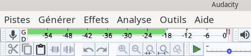

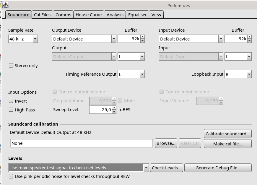

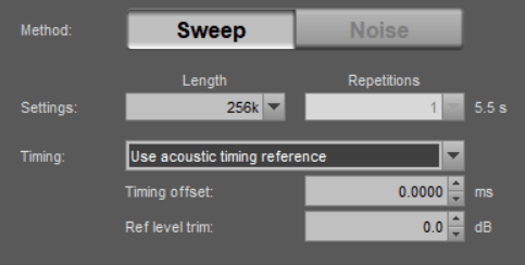

Making some measurements this afternoon, I had a more careful look at the settings.
I think what you suggested Leob is the root cause of the problem but not the only explanation.
My understanding is REW offers 3 possibilities to get a reference for the time.
1/ "No timing reference" / "set t=0 at IR peak" : it is what I use. The time origin is at the peak of the impulse. This option is not suitable to work with several drivers but in the case of the DML as there is only one source, it seems not a problem
2/ "use loopback as timing reference" : here a second channel is used (loop back) to reference the measurement. The best choice
3/ "use acoustic reference timing" : it seems (I haven't closely checked) like a trigger in an oscilloscope. So in case a loop back is not possible in a multi source measurement, it is a better than 1/, not as 2/
So I tested the 3 on my laptop.. the 3 works!
My assumption is your are in option 2/ but something in the setting makes muted the channel where REW is expecting the second signal.
Below are the preferences/souncard of my REW.
I use the left channel of the input (usb microphone) and the right for the loop back.
The mic is mono but is seen as a stereo device.
Under Audacity, the 2 channels of the monitoring meter move the same.
The second hypothesis to explain your problem is your mic has no left and right channels
Suggestions :
- set to 1/ "No timing reference"
- set to 2/ "use loopback..." AND in the preference/soundcard set the loopback input on the same channel. I am going to think about this setting for my own use...
Let us know if the problem is solved... or not...

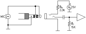

Hello Eucy
The IMM6 is in my understanding (not written like that in the documentation but "condenser") an electret microphone. If it tells to you, you can see the 2 terminals of the mic as the source and the drain of a jfet. The basic interface is to load it with a resistor connected to a supply. When the device is portable, the voltage is something like 2.2V or 5V, the resistor some k.
So no direct voltage on it and certainly not 48V. Higher voltage than 5V might be possible with the right resistance in series so that the maximum voltage across the mic is not reached.
I suggest you search around electret and their interfaces and what are the options of the UMC22.
I will see later if I can be pore precise.
Christian
With some schematics from my notes :
