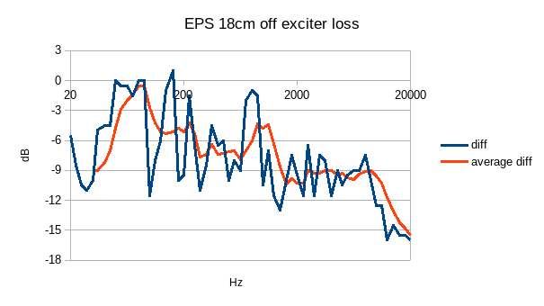

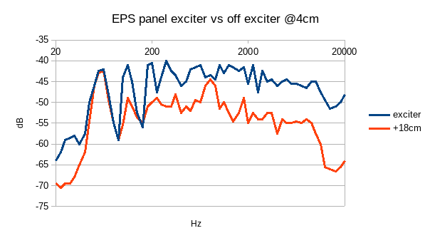

As promised, these are plots of the output in the central area of the graphite eps panel in front of the voice coils at about 4cm distance from the panel.
And of the output at 4cm also but at about 18cm ,(7inches) across the panel away from the main driving area.
The first picture shows the high output of the main (primary)driving area.
The second picture shows the lower output of the panel at 7inches.
These are single point measurements, so do not show the overall output of the panel.
This is why I regard the central area as being pistonic in nature, similar to having a cone speaker in the centre of the panel.
This makes the panel more of a point source and less defuse.
DMLs are never pure DML, they are also bending wave.
How much they operate in these 3 modes depends on panel materials and how you much you damp them.

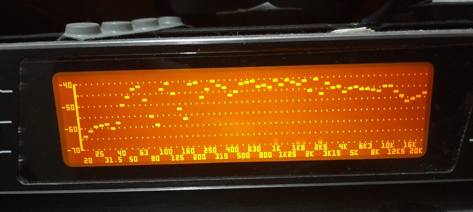

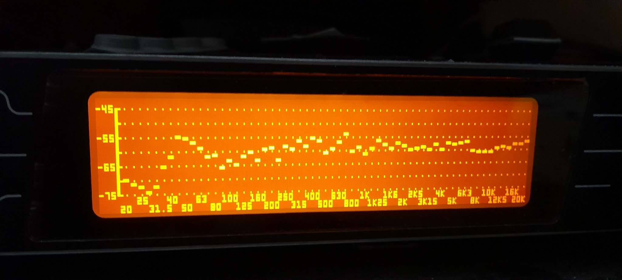

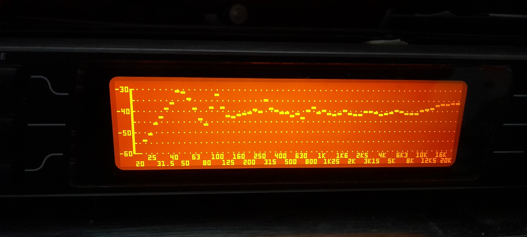

While I was unsuccessfully trying to apply my strips of paper on the two proplex panels, I took some plots , the first at 1m the second at about 2inches.
Usually I'm trying to correct strong peaks and dips in the response.
But as you can see ,There is not much to correct , if anything.
This is a very well behaved panel.

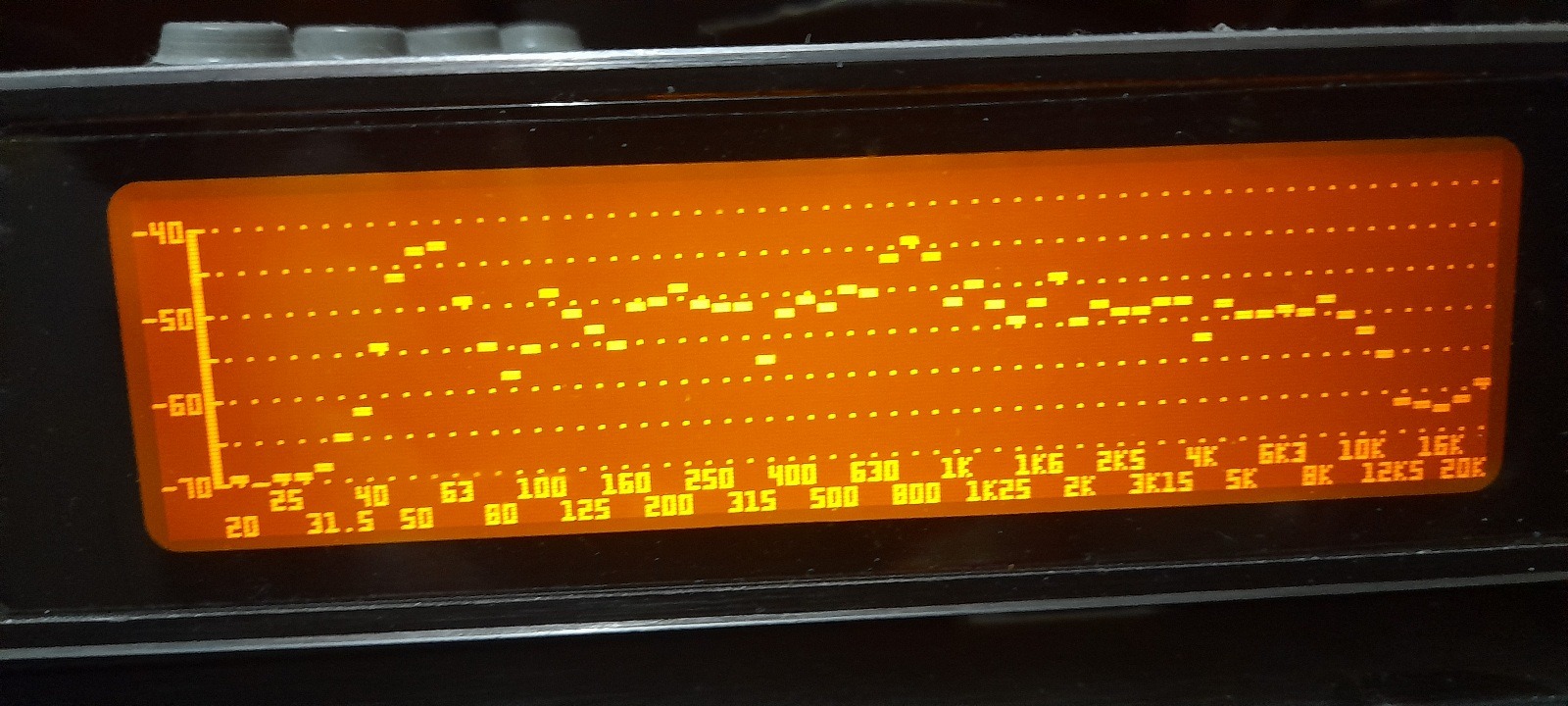

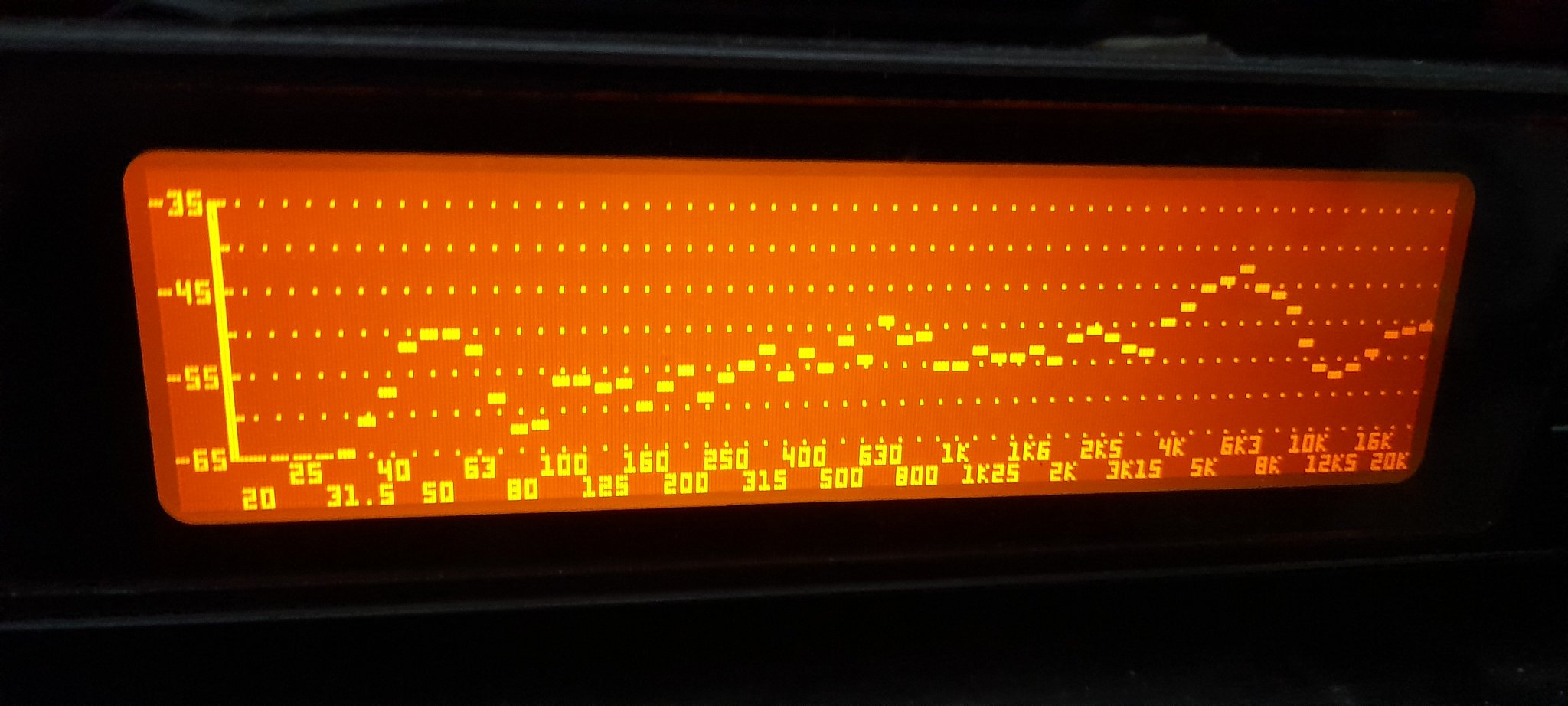

Although I did notice something interesting while playing around with the fluted panel.
In the third picture you can see a hump in the response.
This is beaming out to the side of the panel, but slightly to the front, but only on the side with the open flutes on ,not the closed sides.
If this was up close to a wall and toed in to face you ,it would beam those frequencies back in towards you.
So i would recommend having the open flutes pointing up and down to minimise the problem .
Strange but interesting.
Steve.

Hello SteveWhile I was unsuccessfully trying to apply my strips of paper on the two proplex panels, I took some plots , the first at 1m the second at about 2inches.
Steve.
