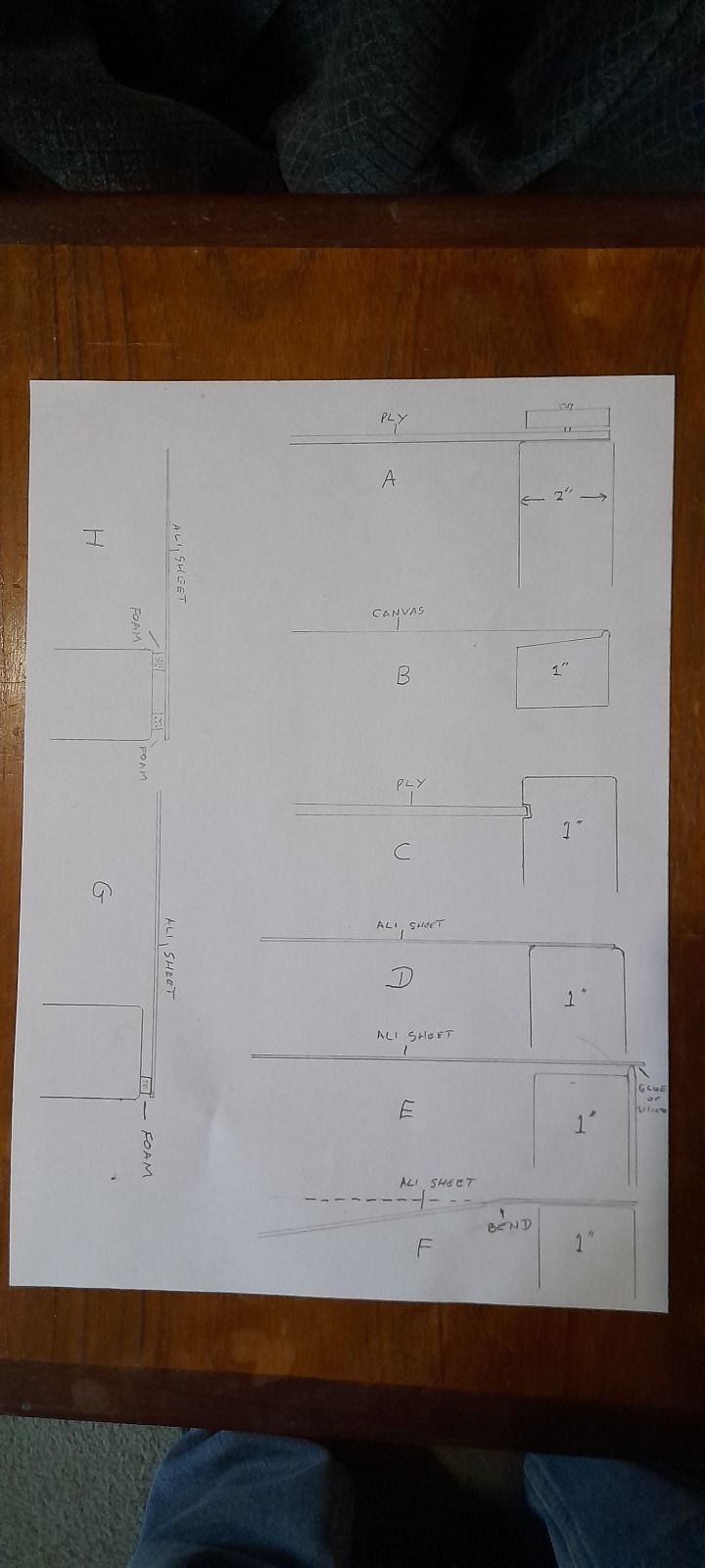

The other day I started thinking of ways to mount the Ali panel.
And was reminded of the mounting of my ply panels.
A.
Was the mounting I used for my large 6ft ply panels.
B.
Is the canvas mounting.
C.
Was the mounting I wanted to use for my ply panels, but I did not have a router.
D to H are various ways to mount the aluminium sheet panels.
But F shows the problem I have with A mounting.
You loose an inch or two at the edges ,plus this method makes the panel edges much stiffer.
The panel tends to bend further into the panel as shown in fig F.
This could make the panel much stiffer than wanted.
And the foam ideas might over damp the panel .
Would it be better to have the foam in fig G on the inner edge and let the outer edge vibrate freely?
Or mounted with foam at say half way between the exciter and outer edge?.
Am I over thinking this.
I like the idea of B C and E having a little bit of rotation in their mounting, giving the panel a bit more flex but holding it firmly.
I will have to think on it more.
Steve.

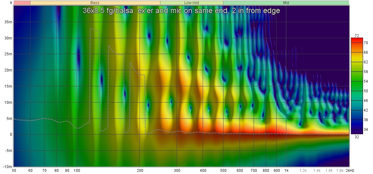

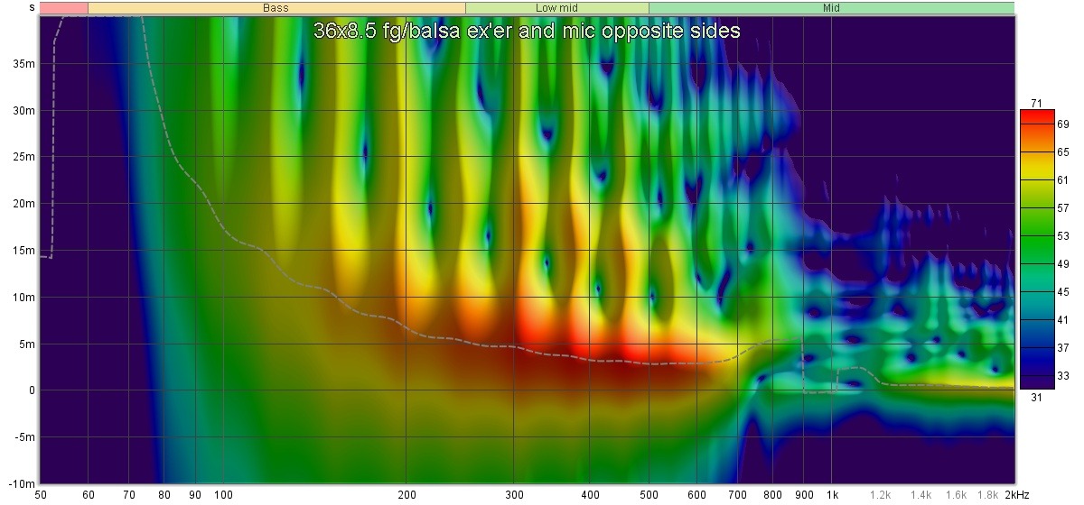

Christian, Hilbren,
I think the measurements below show pretty well the "wave speed" effect you have been looking for.
I did basically the same experiment as Christian did, but using one of my high aspect ratio panels. This was a 20 cm x 93 cm fiberglass/balsa composite panel, mounted to a frame around its perimeter with a soft foam mounting tape.
I placed the exciter 5 cm from one end on the central axis of the panel. The first measurement was made with the mic placed close to the panel (about 2 mm), directly in front of the center of the exciter. In the second measurement, I moved the mic to the other end of the panel, 5 cm away from the opposite edge of the panel, and hence 83 cm from the exciter.
The vertical ridges correspond to the natural frequencies of the panel. As I have noted in other posts, the high aspect ratio panels have a series of closely and regularly spaced natural frequencies which is clearly evident. The lowest frequency ridge at about 94 Hz is actually the 1,3 mode. The fundamental (70 Hz) and 1,2 (81 Hz) are not evident because the exciter is too close to the panel edge to effectively drive those modes.
But most interestingly, the first measurement shows virtually zero delay over the entire frequency range. While in the second measurement, with the mic 83 cm away from the exciter, there is significant delay at low frequencies and which steadily decreases at higher frequencies, exactly as it should. Using the wave speed equation I showed in a recent post, and my best estimates of the modulus, thickness and density of the panel, I calculated an expected delay of about 22 ms at 94 Hz, which is quite close to the measured delayed at that frequency (about 20 ms).

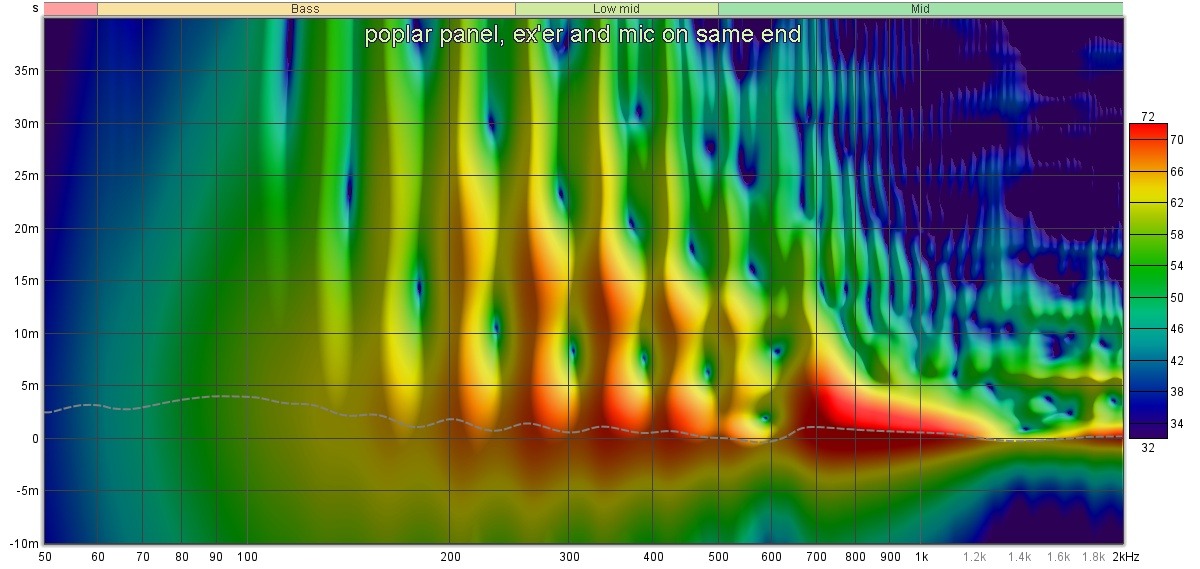

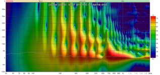

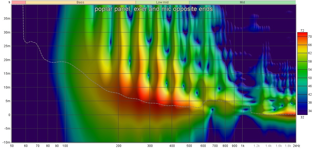

I did the same test with my 30 cm x 120 cm poplar panel, and got similar results (below). In this case the exciter and mic were placed 10 cm from the panel edges. The natural frequencies of this panel are a bit higher, with the 1,3 mode (again the lowest mode evident) being at 130 Hz. Exactly as for the other panel, there is no delay when the mic is located at the exciter, but a significant delay when the mic is moved to the opposite side, 1 meter away in this case. Again, using my best estimates of the plate properties, I calculated an expected delay of 15 ms at 130 Hz, which is pretty much exactly what the measurement shows for the delay at that frequency.
I'd like to repeat the experiment with a less stiff panel, which should have a significantly longer delay. I'll have to see what I can find to try...
Eric

Very clean and nice spectrograms in addition to be a bridge between theory and reality. Excellent Eric.Christian, Hilbren,
View attachment 1093515 View attachment 1093516
Eric
View attachment 1093519 View attachment 1093520
I was in the idea to test the material more in the shape of a beam. You did it.
2 questions :
- how the panels in those tests are suspended (I am not sure to understand in the proper way the beginning of the post)?
- which type of mic and REW setting (more precisely the timing box in upper right part of the measurement box)?

Thanks, yeah I think it's pretty cool too.Very clean and nice spectrograms in addition to be a bridge between theory and reality. Excellent Eric.
2 questions :
Seems we can also see the wave coming back
The two panels were suspended slightly differently, but both are suspended essentially with simple supports around the entire perimeter.
Both are attached by thin double sided foam mounting tape to a stiff wood frame. In the case of the plywood panel, the tape is "3M Extreme", about 1 cm wide and runs around the entire perimeter, except for about 5 cm in each corner. This tape is somewhat firm, and also pretty high damping. For the fg/balsa panel, I wanted to minimize damping, so I used a tape with much lower damping (3M Indoor) and used only a small piece (about 4 mm x 12 mm) every 5 cm around the perimeter. So these two suspensions provide different levels of damping, but are similar in that they are approximately equivalent to "simple" (hinged) supports.
As I have noted before, this method of support, combined with a high aspect ratio panel, provides a nice close series of natural frequencies, particularly just above the fundamental. This works nicely for this experiment, I think. I did try one test with a similar long panel but supported only by it's short ends, and free along the two long sides. But in that case the spacing of the natural frequencies is large, and the results where simply not as clear as in the two results I shared. I see now that I didn't even save those files.
For timing I used the loopback setting.
Mic is the DA iMM-6, probably the cheapest measurement mic you can find!
And yes, I agree, it seems we can see the wave coming back. In fact, in both mic positions. Interestingly, I noticed that the appearance of the spectrograms changes pretty significantly depending on which frequency resolution you choose. In the spectrograms I shared, I used 1/12 resolution. Using 1/12 or 1/24 resolution really emphasizes the natural frequencies. But if you use lower resolution (e.g. 1/6), the reflections start to become even more obvious.
Eric

Hello Eric,Thanks, yeah I think it's pretty cool too.
Eric

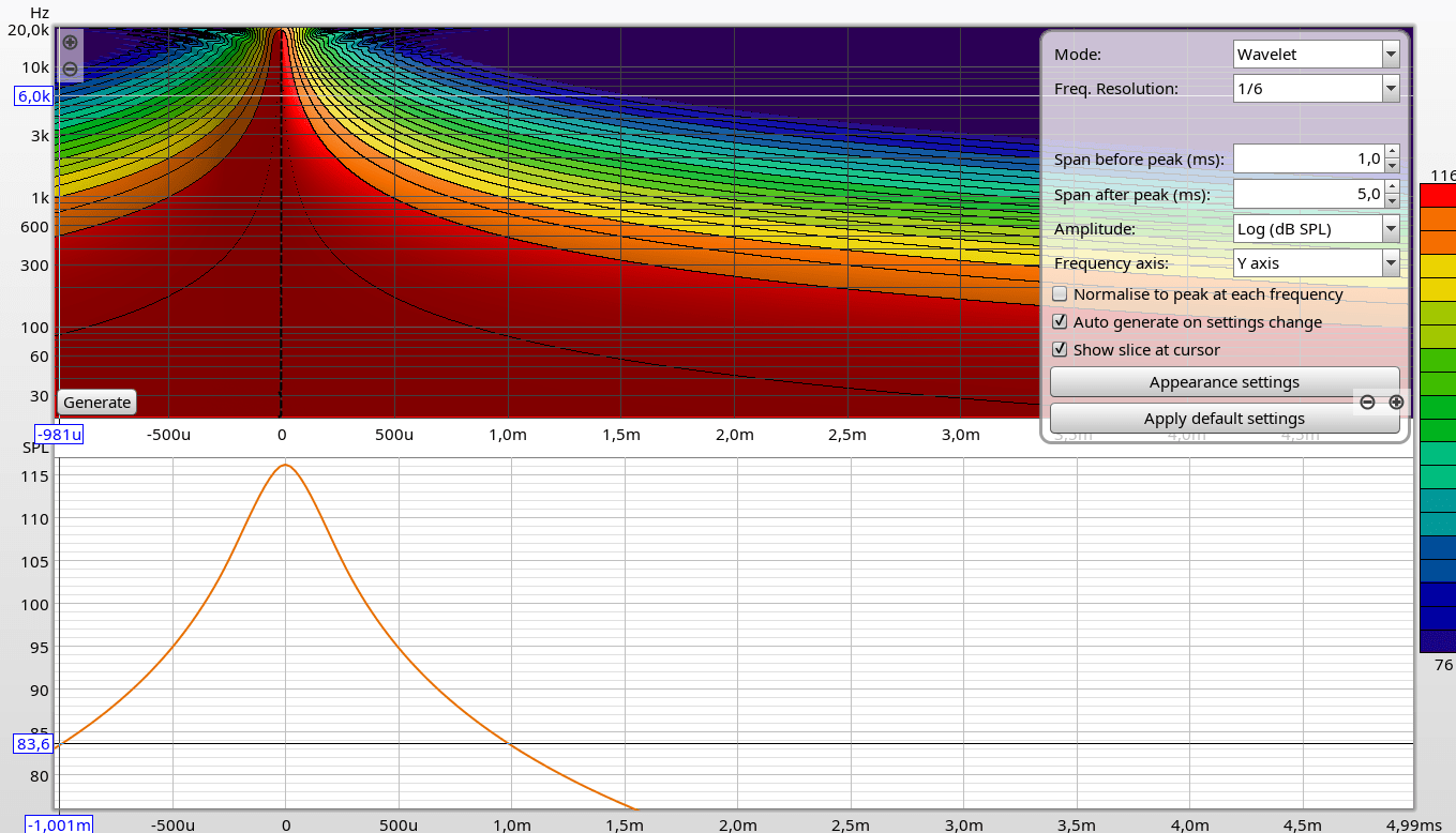

OK so double side tape all round, which are the conditions you target for the panel.
About the mic setup, how do you sent the reference signal to the sound card? Some schematic of my set up to come... I would like to see what are the other possibilities.

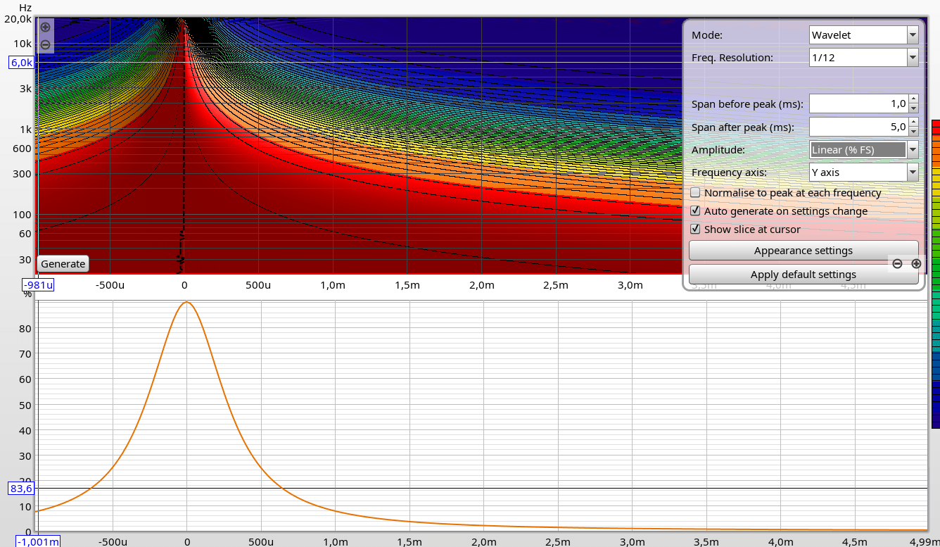

About the appearance of the spectrogram, I don't know what are your knowledge about time to frequency transformation like the wavelets but the key point is it is not possible to be precise on the time scale and on the frequency scale. So changing the 1/n octave of the wavelet change the view. 1/12 is thin in frequency and large in time, 1/6 is a bit wider in frequency but then more precise in time. So 1/12 helps to see the modes, 1/6 helps to see the reflections in time.
Trying to make so example with REW to explain that, I found a cool function of REW that I didn't know : the possibility to make slice in the spectrogram in the time direction. With that we have an idea of the shape of the envelop of the wavelets.

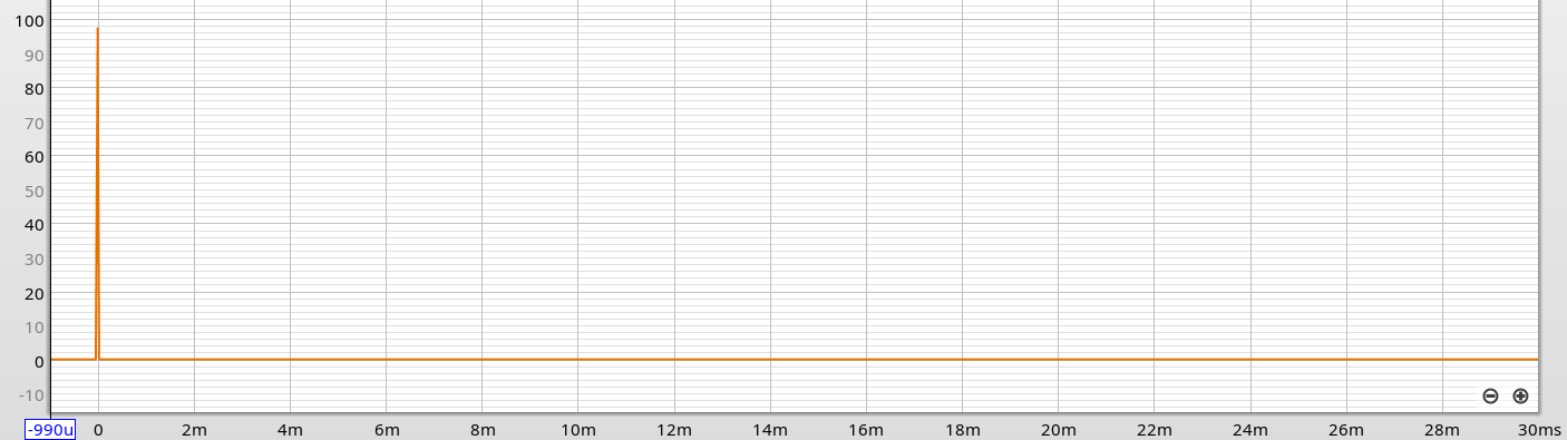

I have for test a wave file of a pure pulse (Dirac) this to check the tools (the expected spectrum is flat.
The IR
The FR
The spectrogram 1/6 oct. Have a look to the control box : frequency axis is in Y axis so the slice is in time (when frequency is in X, the slice is in frequency)
Here the slice is at 6kHz
The same in 1/12
Thinner in frequency (more selective), wider in time...
I have not found for now information about the wavelets used by REW.
The wavelet with the best compromise time, frequency are with a gaussian shape.
Changing the vertical scale from dB to % gives that (see below). So possibily a gaussian wavelet
Christian,About the mic setup, how do you sent the reference signal to the sound card? Some schematic of my set up to come... I would like to see what are the other possibilities.
About the appearance of the spectrogram, I don't know what are your knowledge about time to frequency transformation like the wavelets but the key point is it is not possible to be precise on the time scale and on the frequency scale...
Previously I have no experience with the transformations like wavelets so it is all new to me. I appreciate your example.
Regarding your question about sending a reference signal to the sound card. I do worry that I may not be doing things right. But I am doing nothing myself other than choosing from the timing choices provided on REW. I am not doing anything to send a reference to the sound card other than whatever is built-in to REW. Should I be?
In the measurements I posted, I used the choice: "use loopback as timing reference".
This morning I tried using the other four choices available:
acoustic timing reference (0 ms/0 dB)
no timing reference, 0=IR start
no timing reference, 0= IR peak
no timing reference, 0= Delay estimate
Generally, I saw very little difference, maybe a shift of 1 or 2 ms, but no more. The results with the "acoustic timing reference" and "no timing reference, 0=IR start" both gave results that were slightly more in line with my expectations than the other three options. Those two showed some small delay at 2 kHz at 1 meter exciter to mic distance, while the other three showed the delay at zero there.
I'm interested in any thoughts you have about the various timing reference options.
Eric

Steve,The other day I started thinking of ways to mount the Ali panel.
Steve.
I don't believe you are overthinking this a bit.
What is the thickness of your Aluminum panel? And what size are you thinking of? One nice thing about aluminum compared to most of our typical panel materials is that the material properties are well known, and simple (isotropic), so modelling an aluminum plate is much easier than other materials.
Your sketches A and D and F all are pretty much what engineers call clamped (or cantilevered, or "built-in") supports.
C and E are what engineers call simple (or hinged) supports.
G and H are kind of in between, depending on how firm the foam is, how thick it is, how wide it is, and (in the case of H) how far apart the two strips are.
I have played around with "clamped" edges (like A and D) with plywood panels, and have yet to find any good reason to use them. The main problem is the one you raise: It stiffens the panel considerably, in effect, making it act more like a smaller (much smaller in fact) panel, with no compensatory benefit. It's a double hit on the size, in fact. You lose the 1" or whatever that's actually clamped, and then stiffen what's left in the middle. I expect going from simple supports to clamped supports will increase the panel's fundamental frequency by a factor of between 2 and 3.
Simple supports (like C/E) give the benefits of "constrained" edges (i.e. boosting low frequency output), without wasting panel area. I've thought about trying a routed channel (like your "C"), but I think it would be hard make the fit of the panel in the channel so perfect that it acts as a hinge, but doesn't rattle. Your "E" would probably be easier to execute.
That said, I favor G. If you choose the right soft foam, and use a narrow strip, it can approximate a pure simple support very well. One foam tape I have found that provides virtually no damping is this one, especially if you use only a narrow strip.
https://www.lowes.com/pd/Scotch-Mou...Viv_ICh1r4wnKEAQYASABEgKlq_D_BwE&gclsrc=aw.ds
And if you want more damping, try this:
https://www.lowes.com/search?searchTerm=3m extreme scotch double sided tape
Eric
Hi Eric.
A. was the method I used for my rigidly mounted ply panels, I had one at 3ftx2ft and 2 at 6ftx2ft ,one of the 6ft panels used 3mm mdf.
These were full range down to 40hz, but my exciter was at its limits driving these panels.
I did try making a smaller panel but as you say it was too rigid and sounded bad.
I have thought of mounting the 3ft panel on the wall with sound insulation at the back to see if it sounded similar to the stud wall ?
The aluminium is very thin and is 2 sheets glued together, they are actually printing plates.
Two of then glued together is still not quite 0.5mm.
Gluing the two together does stiffen the panels slightly but mostly it is the damping of the usual ringing that is good about this panel.
I xo this at about 120hz at the moment but it is at its limits volume wise.
The panel needs mounting somehow to stop it flexing so much.
I could just xo higher but I want to see how low it can go if mounted correctly.
Holding the sides in my hands does not seem to alter the sound in a bad way, unlike some other materials I have tested.
I'm just curious how it will sound, I'm thinking of this is as more of a bendingwave panel than a dml ?
Or at least somewhere in between.
Steve.
