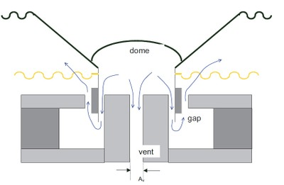

The voice coil cavity is basically a helmholtz resonators, adding extra holes will only change the frequency slightly.I doubt the "breath" is the solution. DAEX25HFE is the one has much vents (around spider and also the back center for cavity). But it is the noiser exciter I have.
If the exciter has no vent, just drill a hole on the panel under the voice coil with sponge in the hole can give the breath. However I didn't hear much improve, or maybe my 10W no-vent exciter is quite noise-free I don't know.
Opening this area up as much as possible to prevent the closed cavity is one option or using a phase plug is another.
The rear hole in the exciter magnet does whistle and I presume the ones in the coil do too.
I notice that the tectonics bmr uses very big holes in the sides of the coil former to open up this area , obviously for this very reason.
I'm sure many cone drivers use the same types of measures.
Some cone drivers use a not so fine mesh over the coil area (it is basically open) to prevent this resonance.
It is a problem that all coil drivers over the years have suffered from, it is not new.

Digging a bit on the web leads me to this article : Identifying Legitimately High Fidelity Loudspeakers: Vented vs. Non-Vented Woofers. It explains the way the air escapes from volume inside of the voice coil. Below is a drawing from the article. Quite self explaining.The voice coil cavity is basically a helmholtz resonators, adding extra holes will only change the frequency slightly.
The holes are listed in the article as a countermeasure.
In the case of the exciter, not sure there is really a vent. The "vent" diameter is very small. Might be the air goes mainly in the second direction of the drawing (to difficult to escape by the central tube).
Woofer magnets are vented mainly for VC cooling. In such a case the dust cap must be solid in order to force air through the VC and spider as in the pic. If you accidently put a permeable dust cap onto a vented magnet, then VC cooling is compromised, and power handling suffers.
If the magnet is not vented, then the dust cap has to be permeable to air. If the dust cap was impermeable, then the air would be trapped under the dust cap, and cone excursion would be drastically limited.
